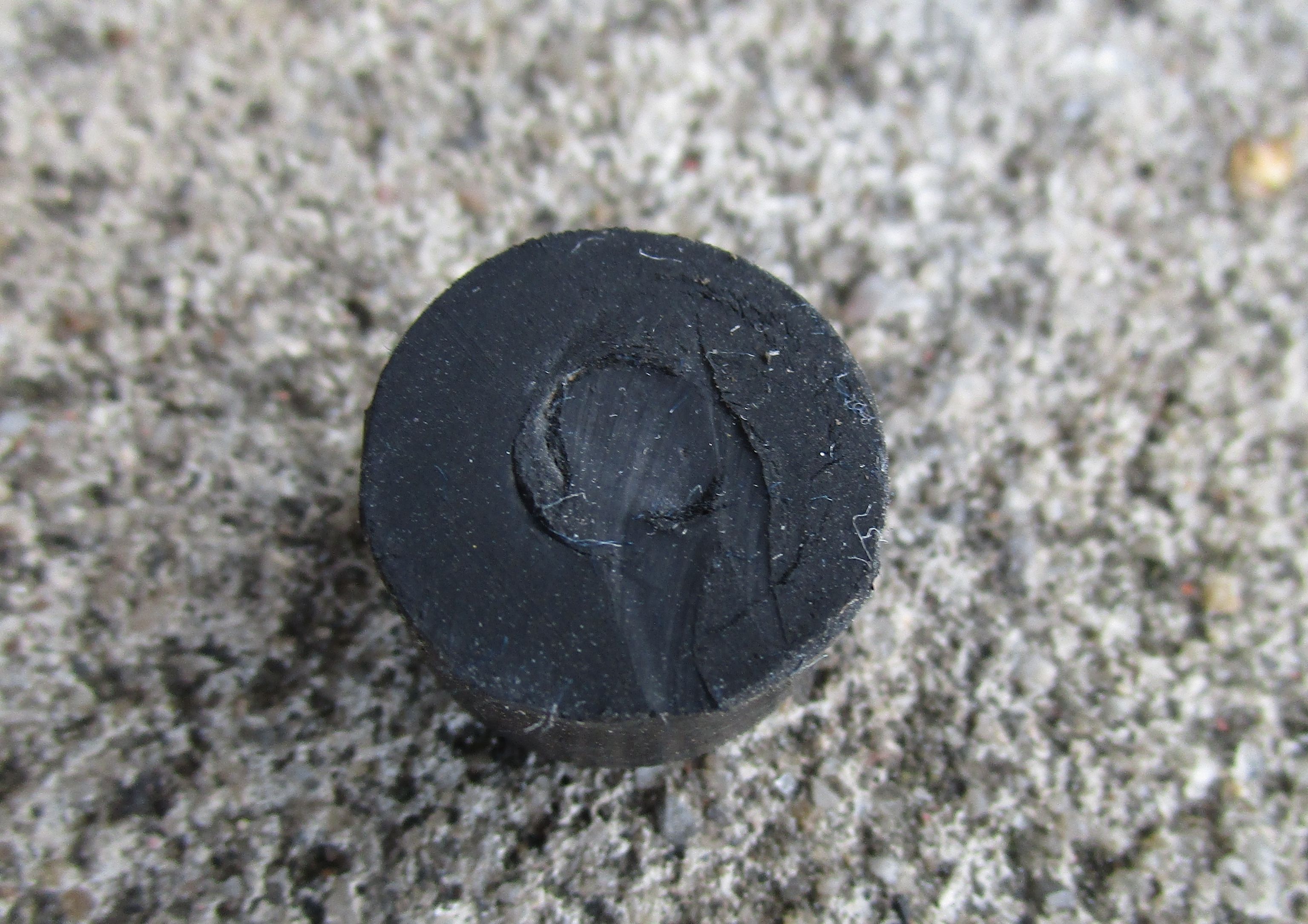

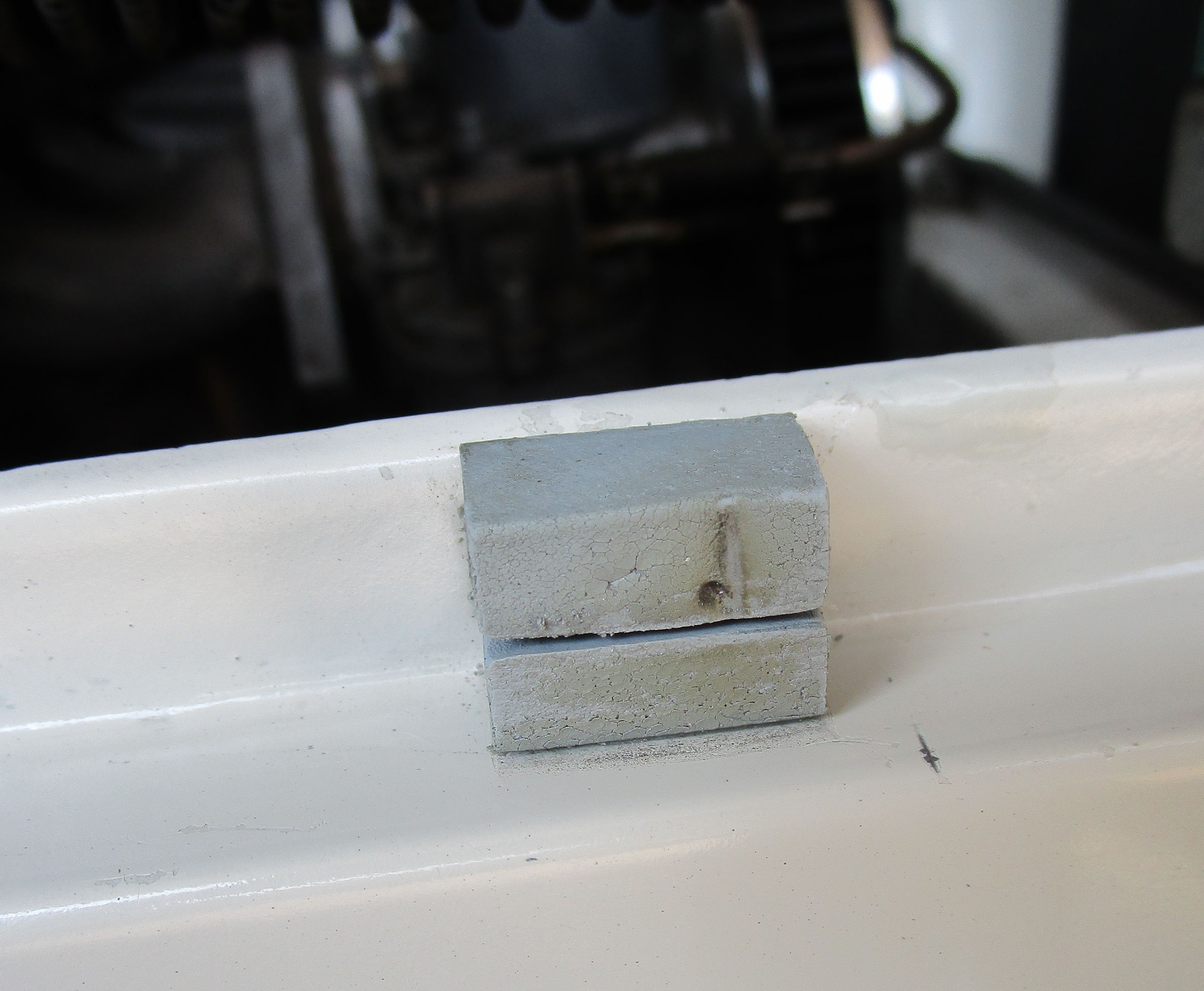

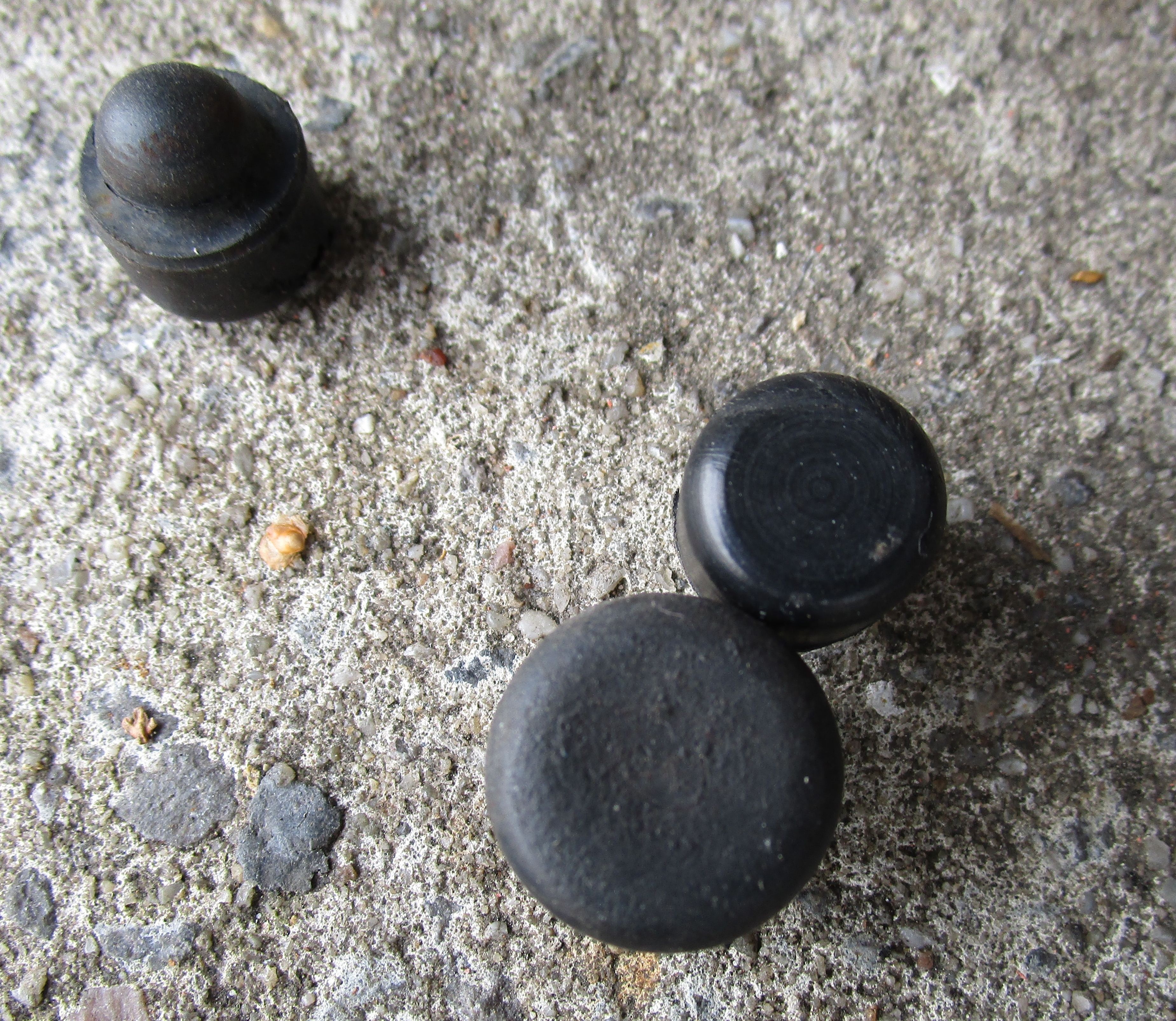

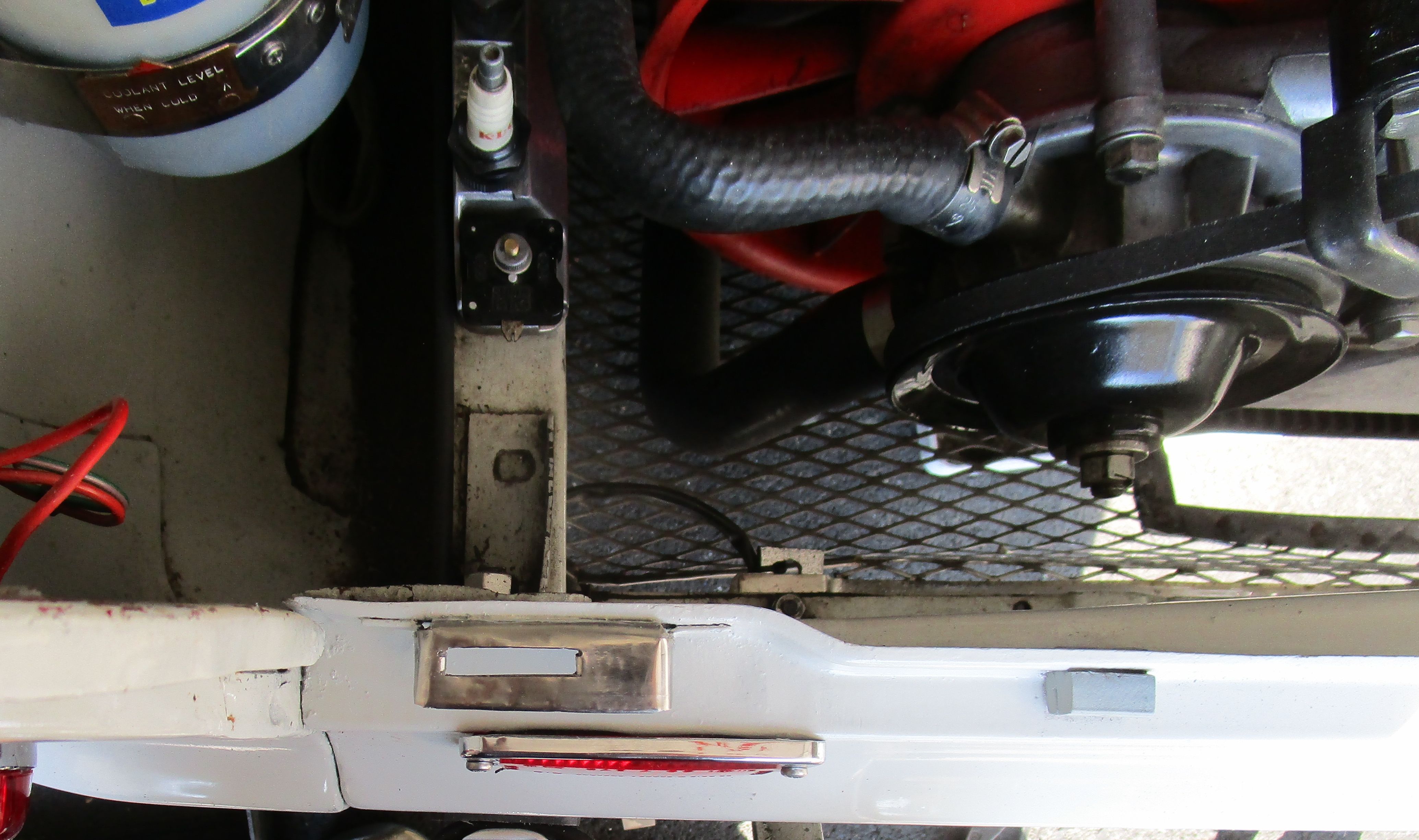

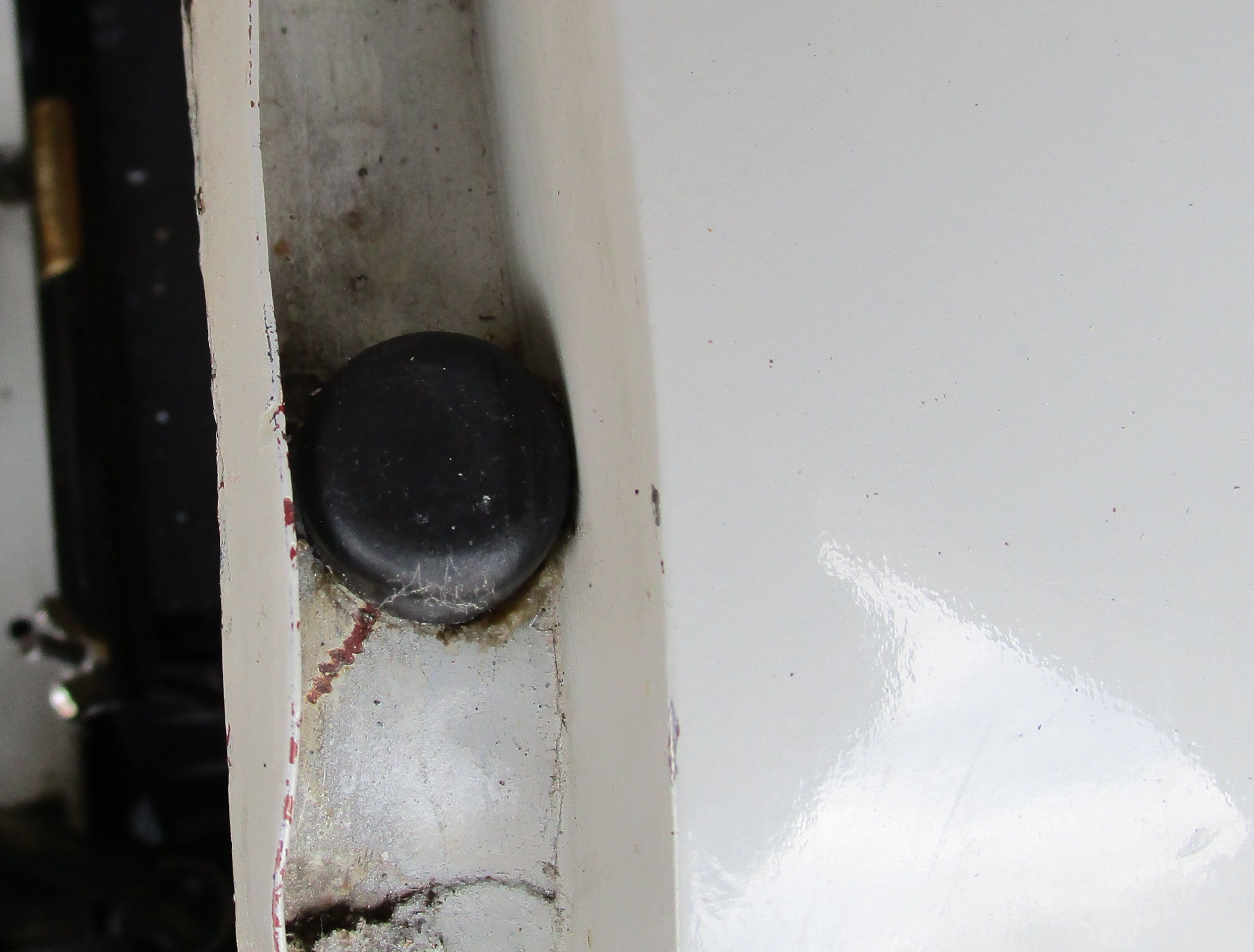

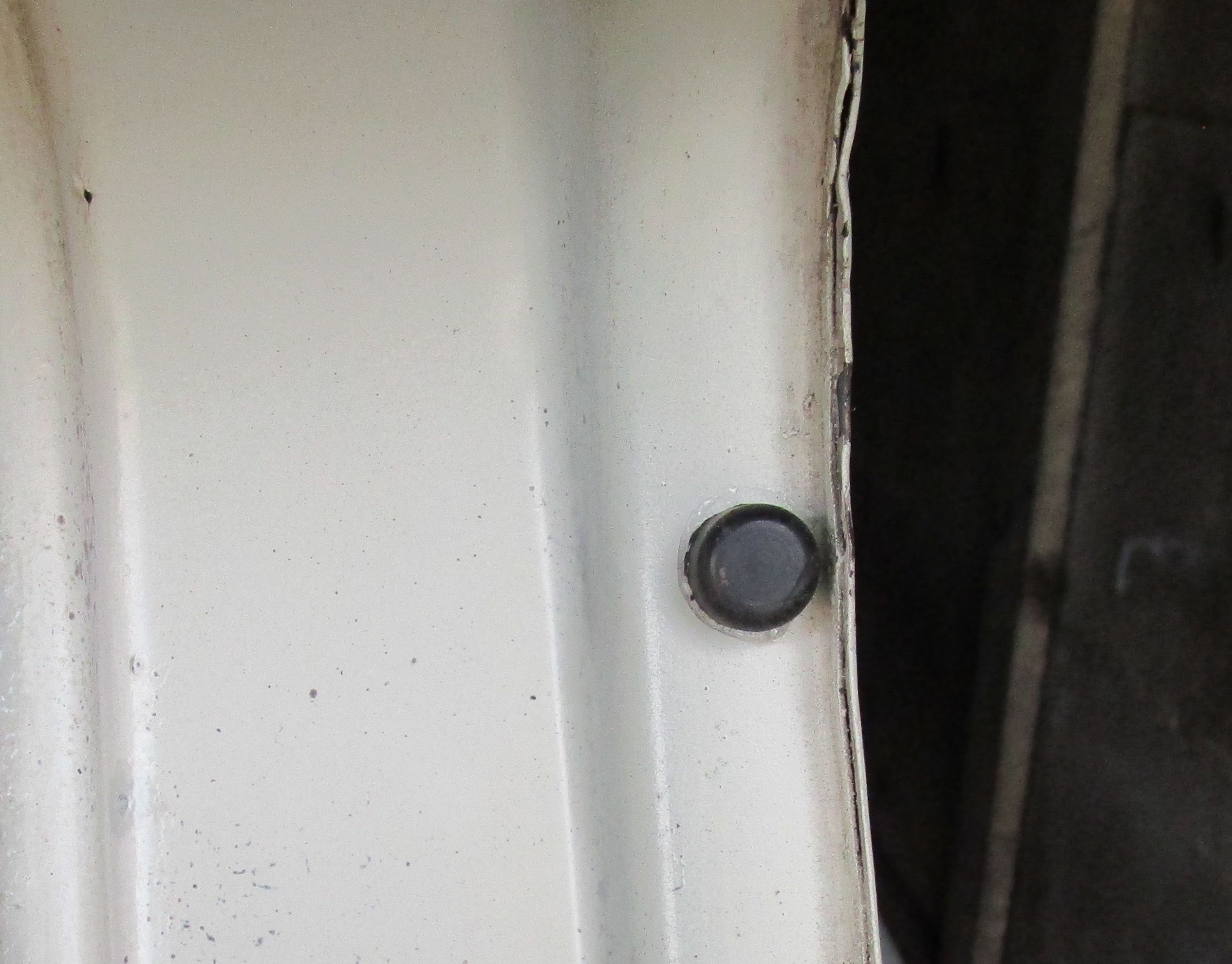

    Factory ones are all a bit vague especially the bottom ones not to mention they look a tad rubbish .

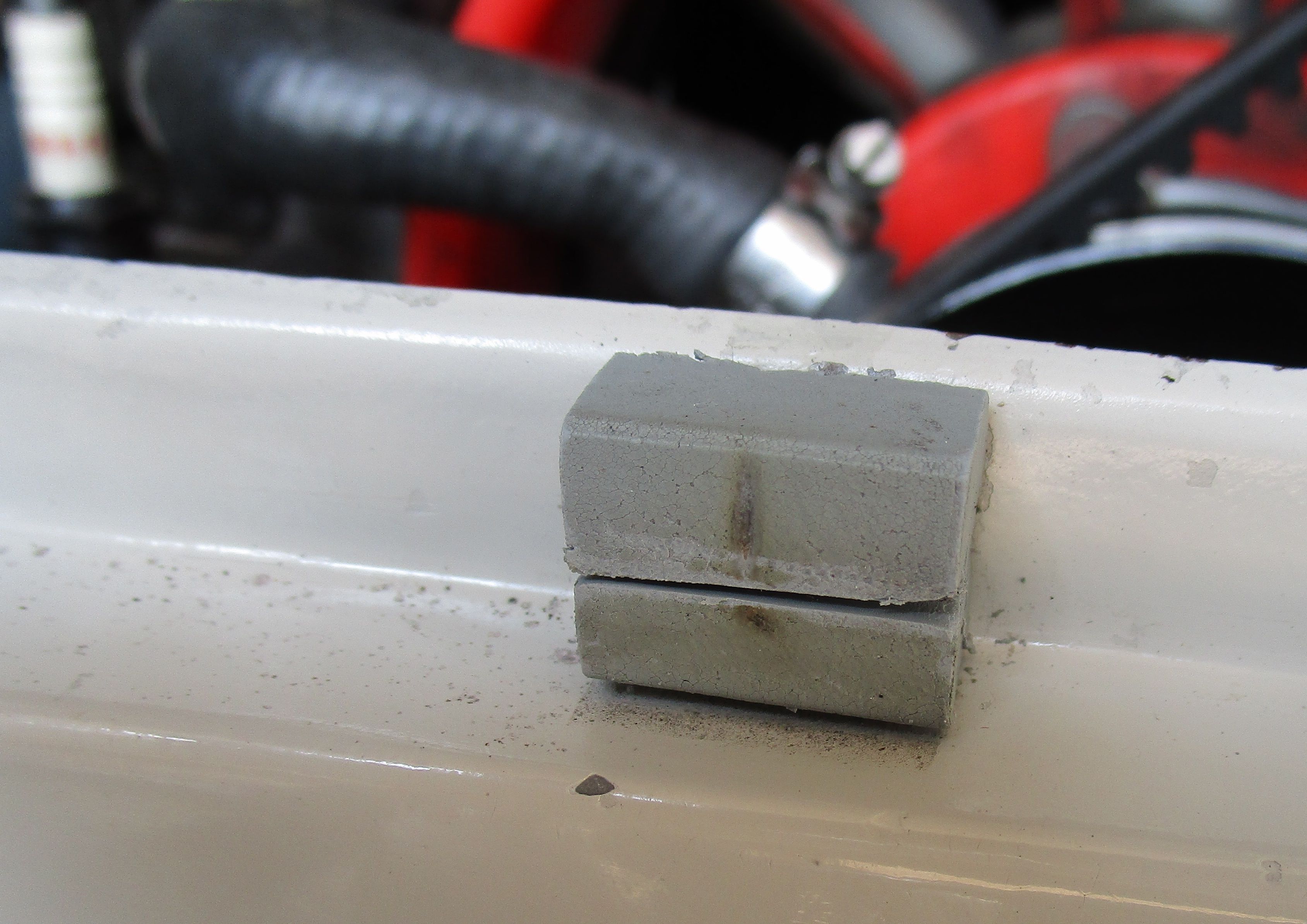

    Anyway I had some rubber feet of an old guillotine that were an identical fit slot wise as the old one .
    These i popped in but they were a tad fat - easy solution as i just cut a slot in each one for the engine lid edge .

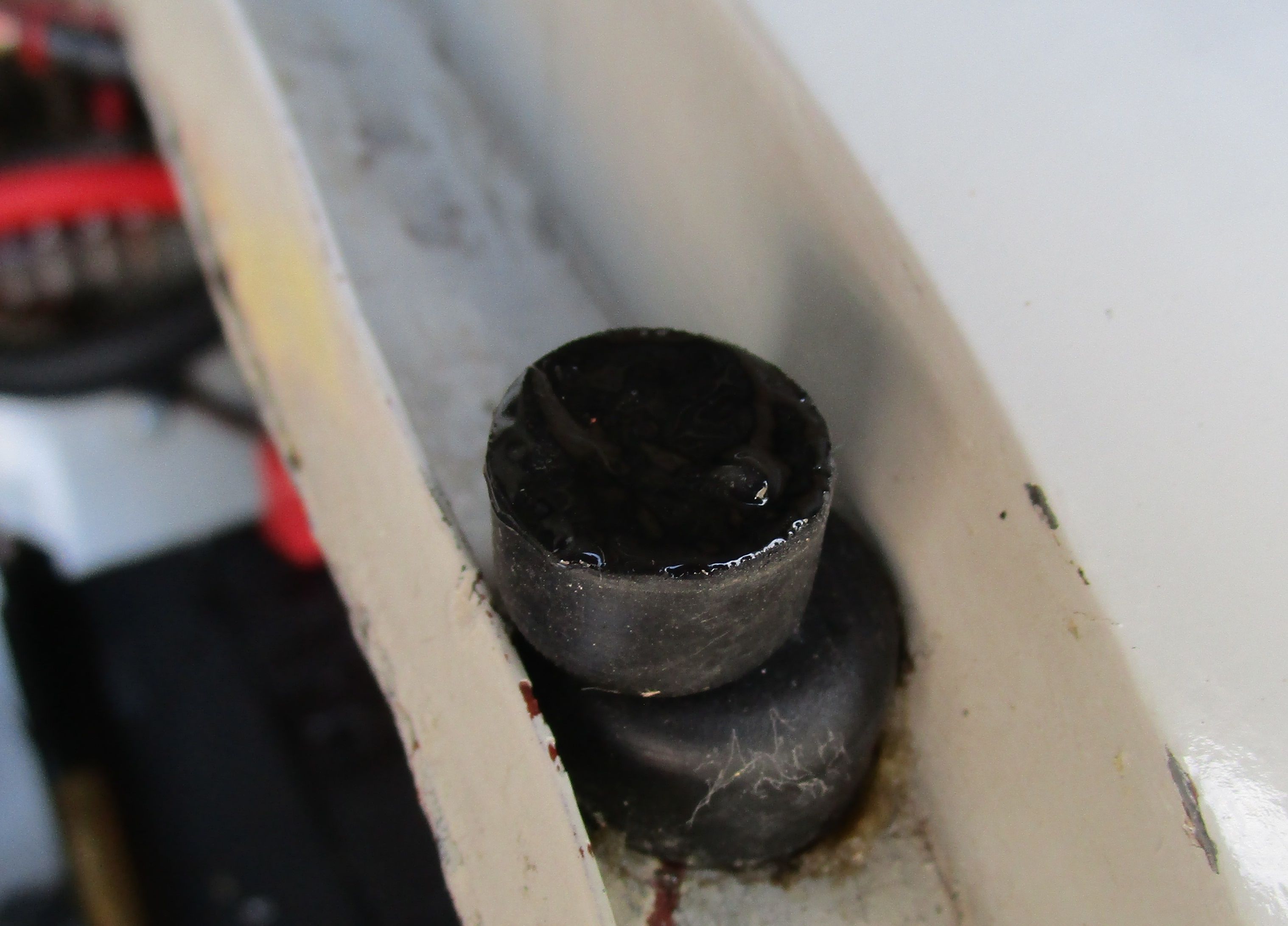

    For the top ones i fitted larger buffers then cut the legs off the old one and stuck them on the engine lid .
    Closes as before but now rattle free and held still
    Also added some thin stainless on the engine lid - protects the paintwork
    Click image for larger version  Name:	IMG_1709.JPG Views:	0 Size:	2.06 MB ID:	6535Click image for larger version  Name:	IMG_1714.JPG Views:	0 Size:	538.9 KB ID:	6536Click image for larger version  Name:	IMG_1711.JPG Views:	0 Size:	881.9 KB ID:	6537Click image for larger version  Name:	IMG_1712.JPG Views:	0 Size:	471.7 KB ID:	6538Click image for larger version  Name:	IMG_1713.JPG Views:	0 Size:	493.2 KB ID:	6539Click image for larger version  Name:	IMG_2426.JPG Views:	0 Size:	814.4 KB ID:	6540Click image for larger version  Name:	IMG_2427.JPG Views:	0 Size:	843.0 KB ID:	6541Click image for larger version  Name:	IMG_2425.JPG Views:	0 Size:	1.02 MB ID:	6542Click image for larger version  Name:	IMG_2429.JPG Views:	0 Size:	1.11 MB ID:	6543

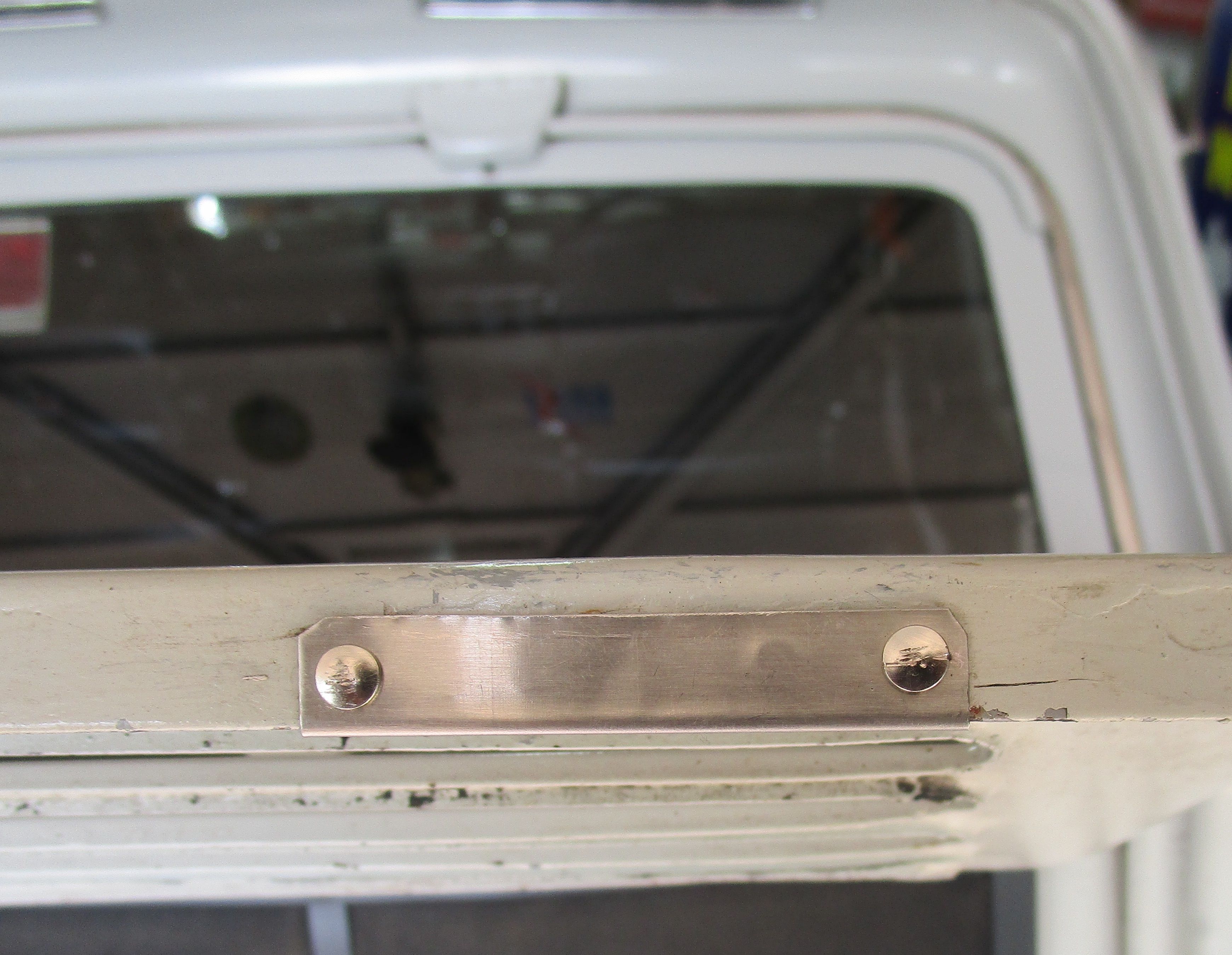

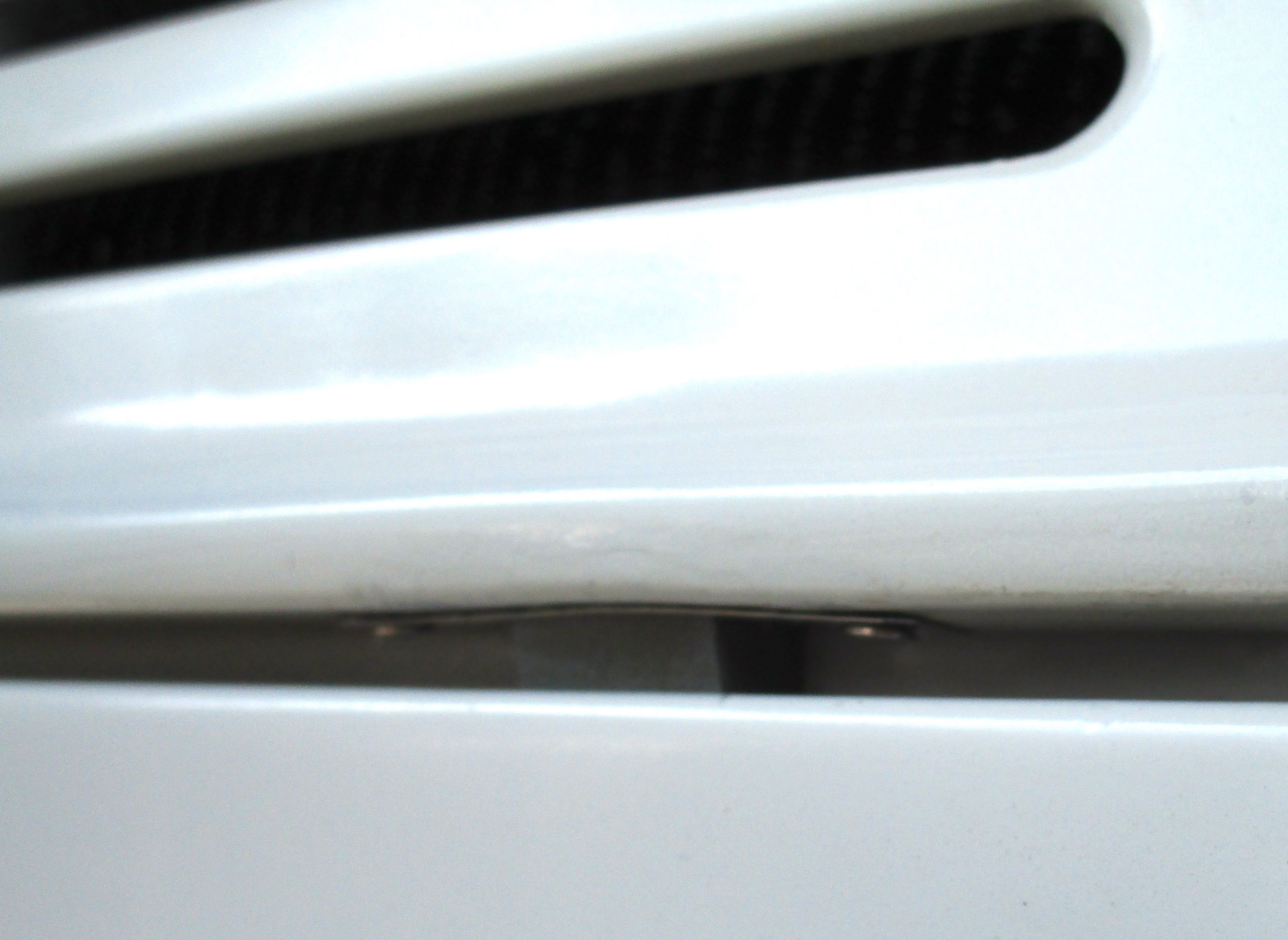

      Of course theres one other area that gets a right pasting paint wise - the engine lid catch plates on the rear panel so nout for it but make some covers , crimped and bonded on it doesnt move at all , one down - one to go

        Dave, that is indeed a top mod 9same as the bonnet safety catch area) both get the crap hammered out of them.
