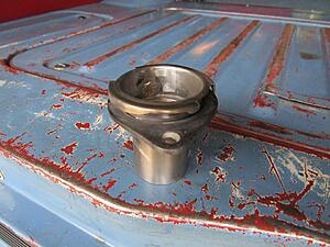

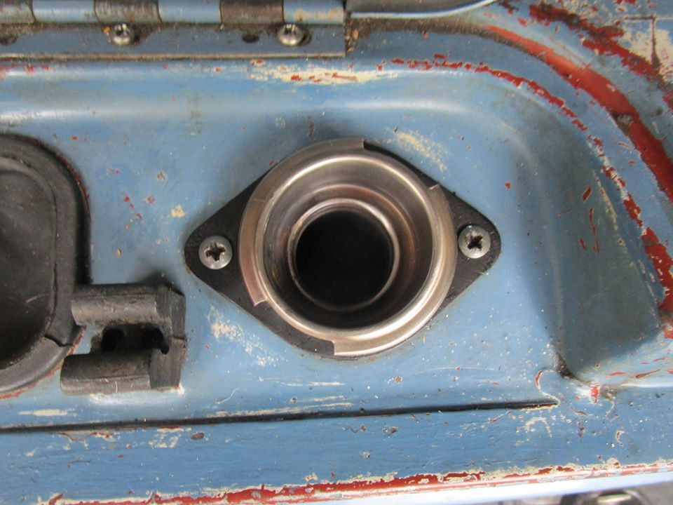

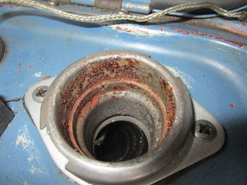

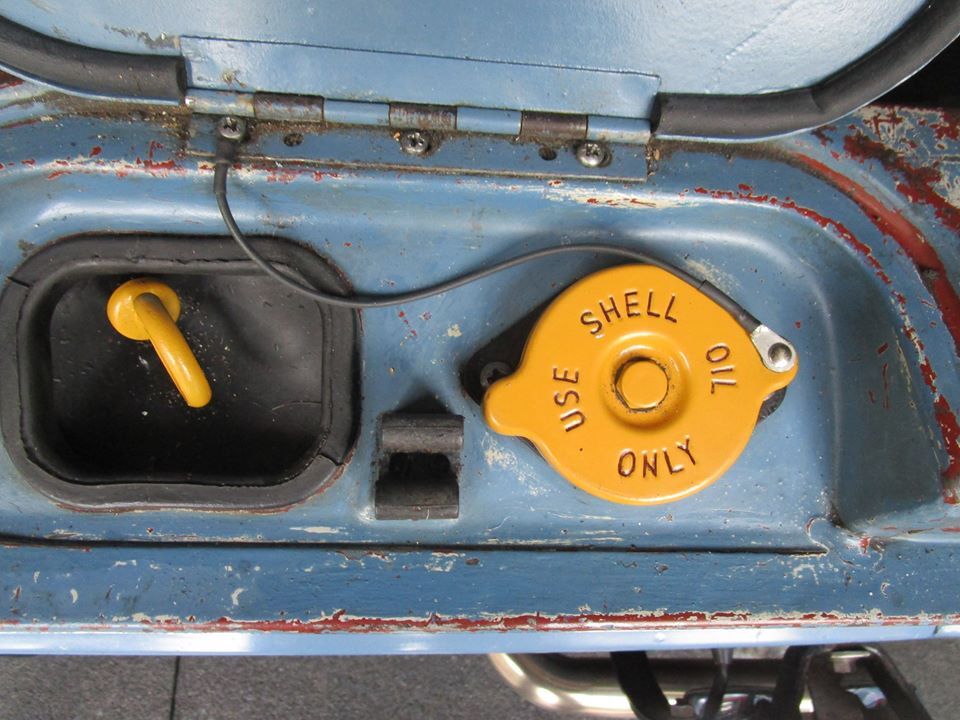

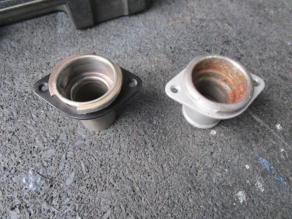

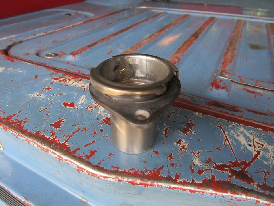

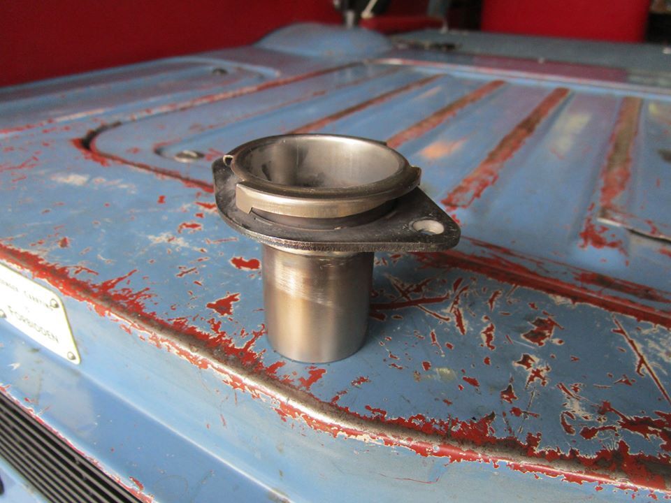

    Vuskys oil fillers gone rusty yet again - and keeps going rusty
    I guess a combo of oil and occasionally condensation from short trips kills it off .

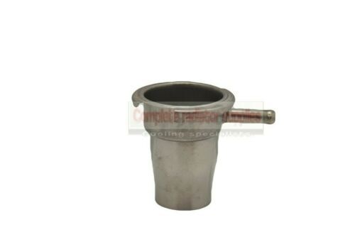

    So the way forward was obviously stainless and after a bit of hunting about a long radiator neck.
    I butchered a spare oil filler and got the bracket off it and brazed it onto the rad filler having removed the overflow - also brazed up the hole , neck was slightly too slim in diameter so a sleeve was made using a steering rack end gaiter cut down ( bound to be oil proof stuff ) then it was just a case of spraying the bracket and fitting it

    Looks like it was meant to be in there Dave, at least this one wont rot out
      Will outlive me and the Vusky
        These little mods are great. ^^
