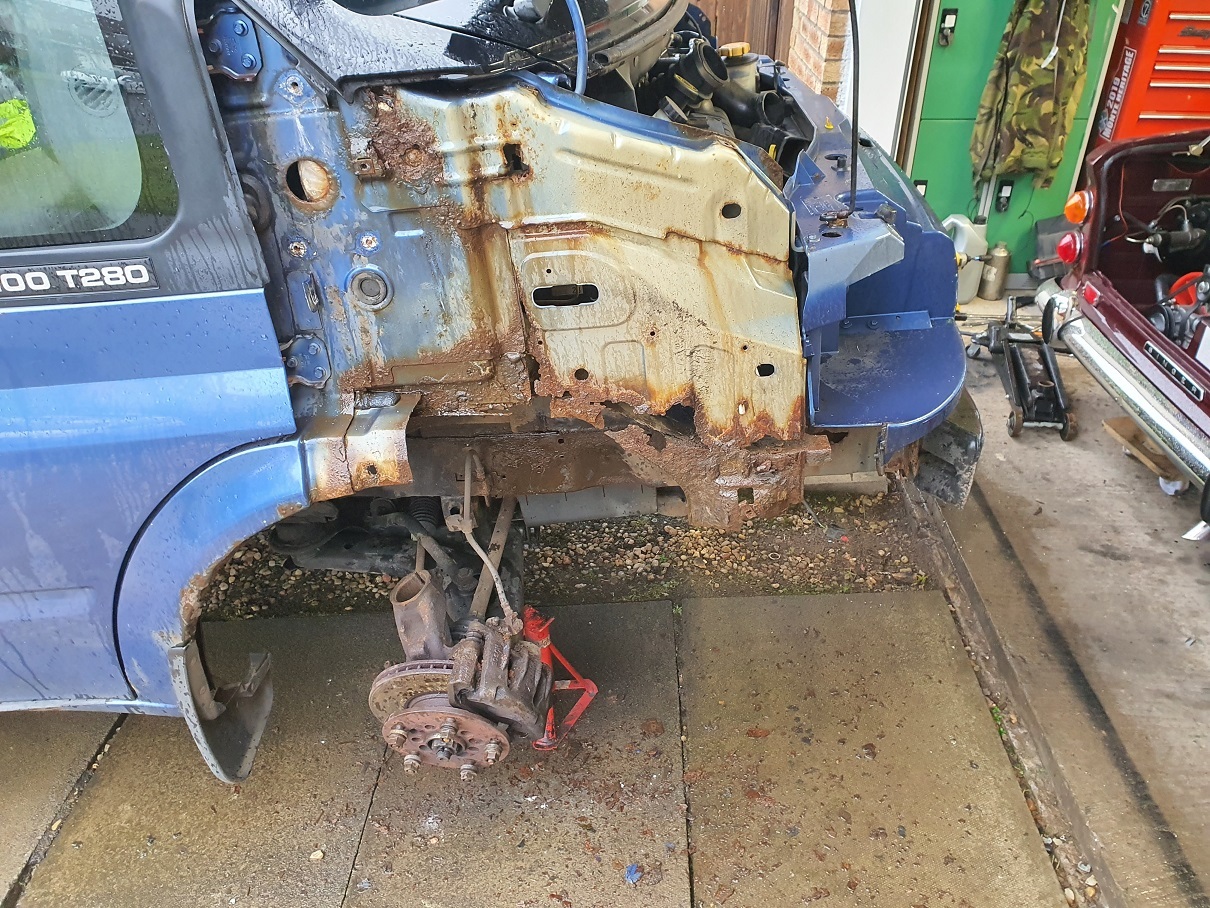

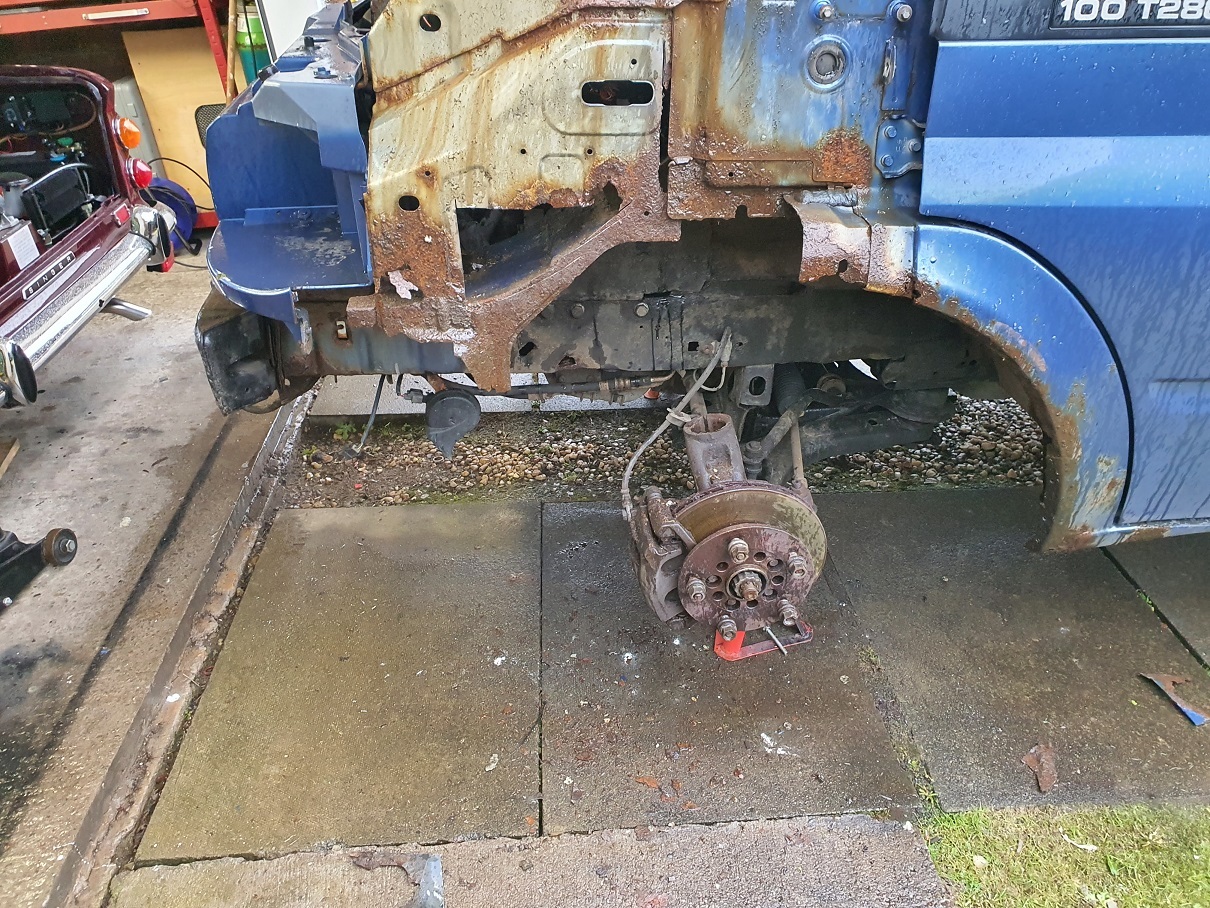

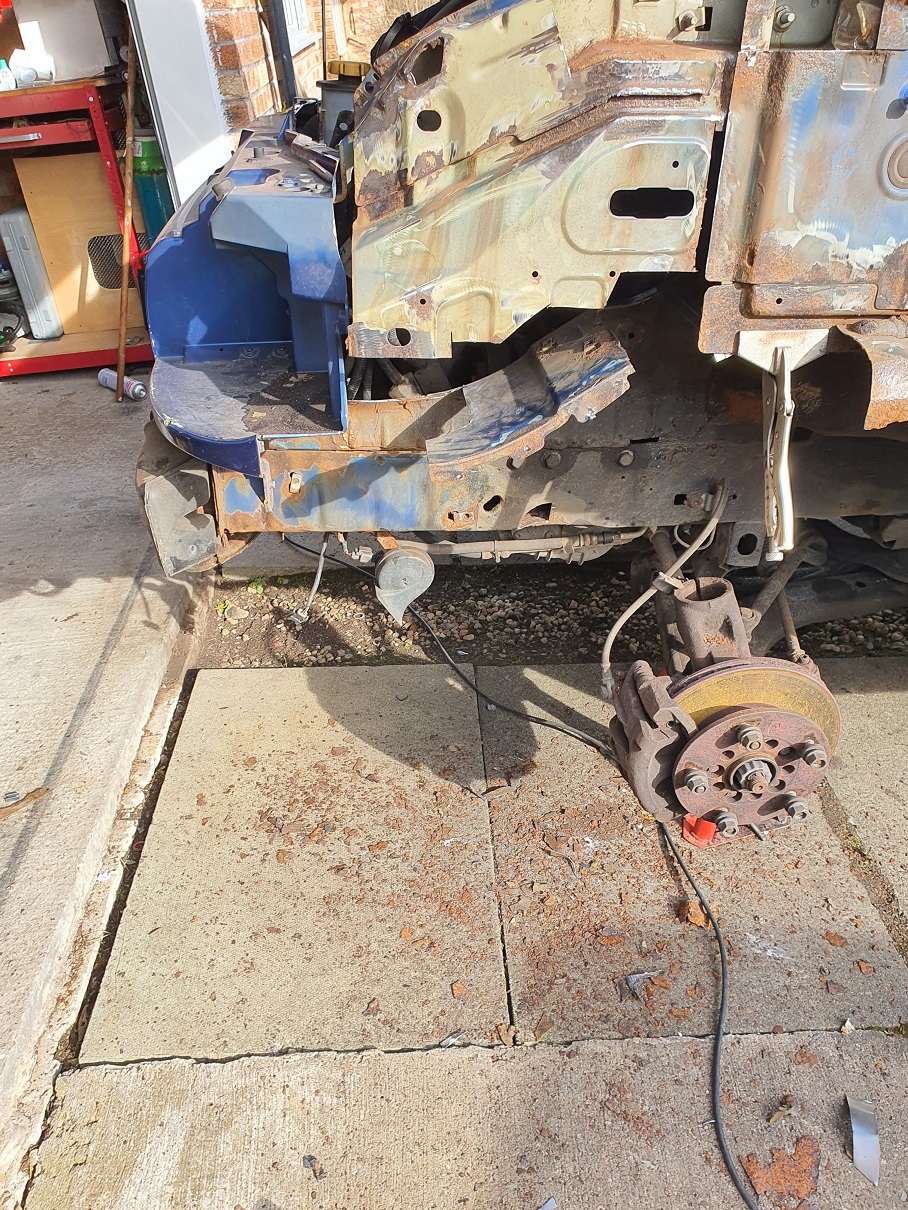

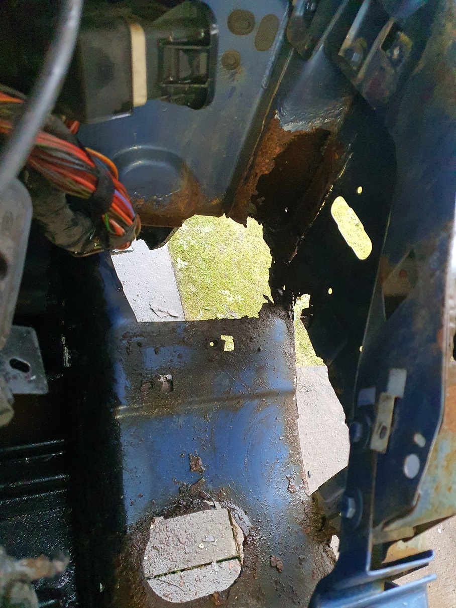

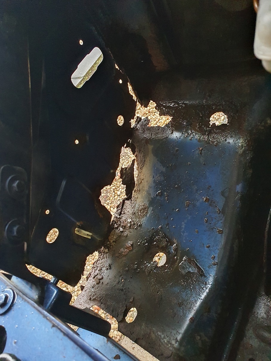

Man this is rotten as a pear, we will rebuild

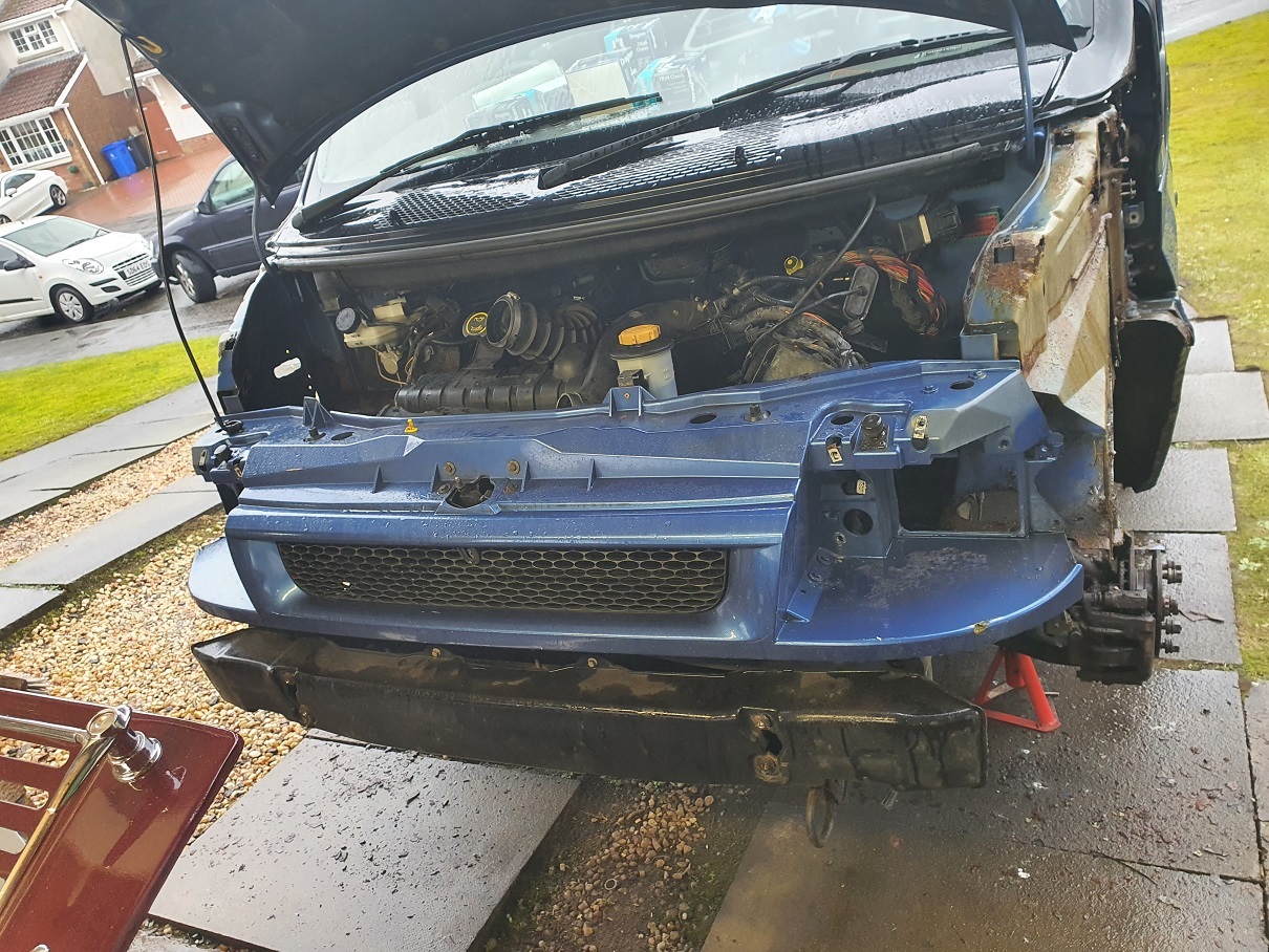

    Man this is rotten as a pear at front now, we will rebuild cant let it die after the cost of the DM clutch and FW
    Few hours today and thats it tore down, at least the bolts all came out except a few. But bloddy hell, thing the fitted those front struts then bolted dashboard on top.
    Was good to get fresh air but wish the feeling would come back in my 3 finger on right hand a bit quicker, was torture trying to grab things.
    Imp rot, not so bad !

    Transit be rather fubar
      Water soluble - Fords way of built in obsolescence
        Dave thats why we dont wash it !

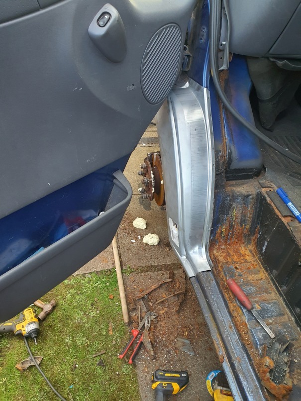

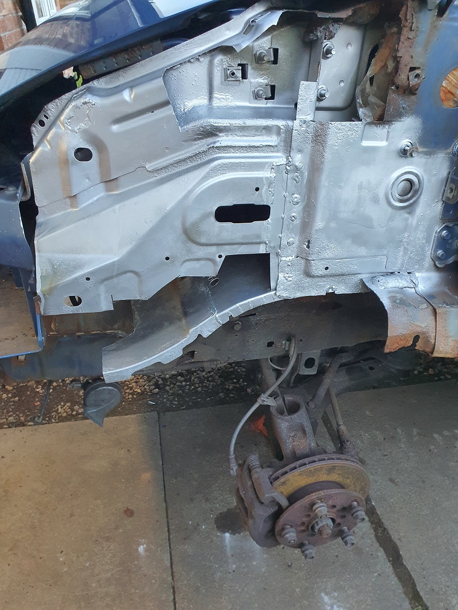

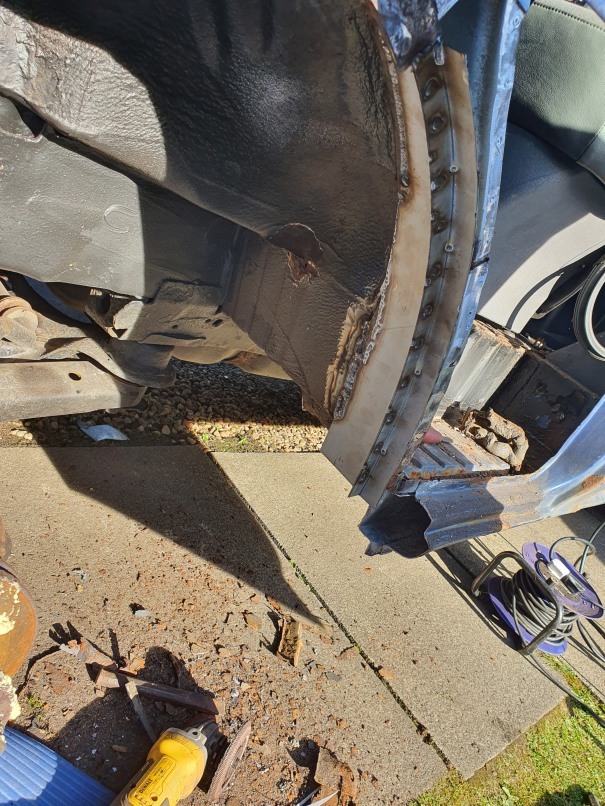

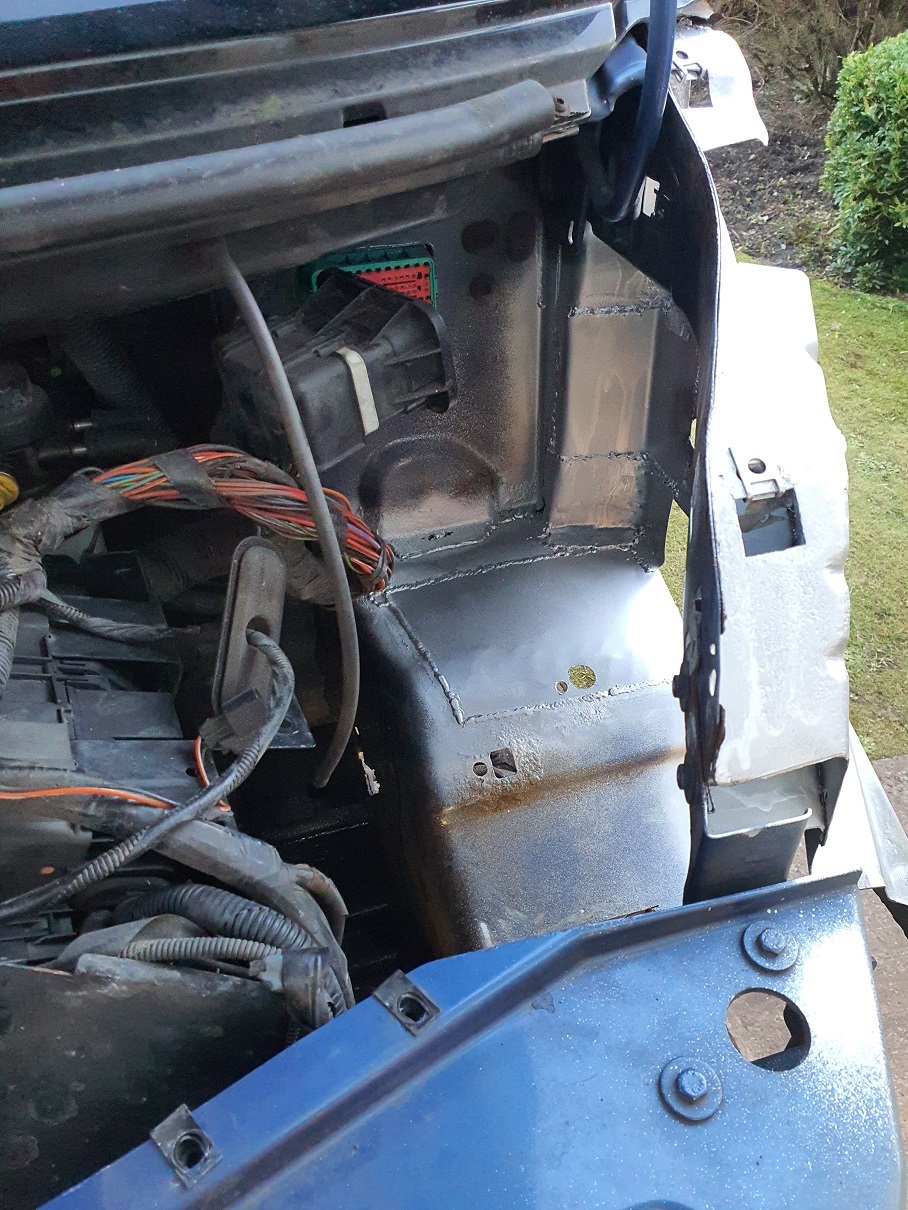

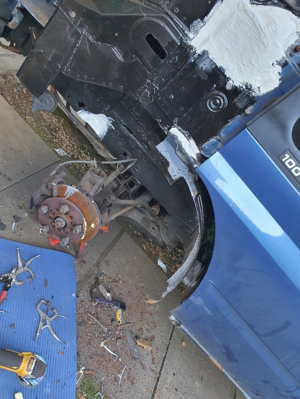

          A little progress. Inner chassis done, A pillar done, Turret Done top part of inner wheel tub, done but had to cut out a lot more as what looked like good metal was just thick paper.
          An nope, its getting a scuff up and coated with epoxy and thats as much dressing as any of the welds will be getting ! thats the way they came from the torch, thats the way they will stay.

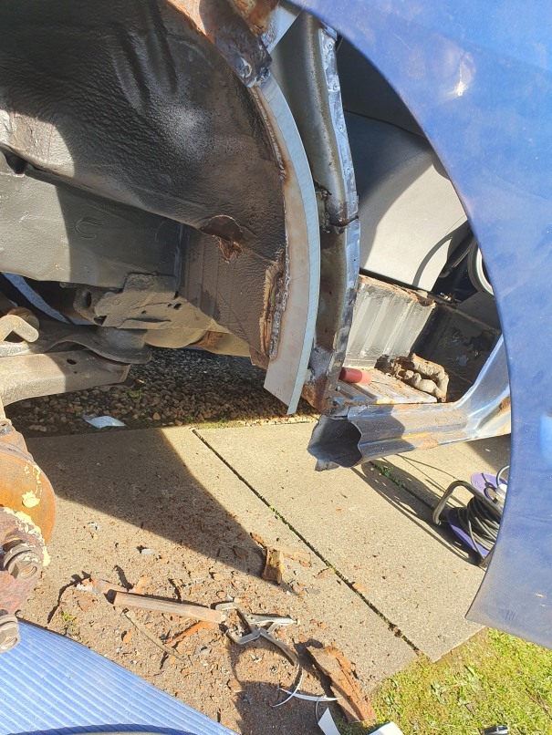

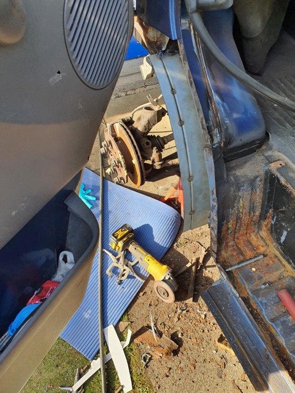

                      As some know I have not done very much for a bit, tried a little on transit the other day but paid the price for that. Completely exhausted. Should have been 2 hours work
                      Ford not being happy with using metallic coated paper for panels thought it would be good to attach the outer and inner wheel arches with a big foam strip and glue, yip, really, foam, no wonder it gets bogged down with water and rots inside out.
                      Edge onf inner wheel tub and outer wheel tub completely gone, or at least bugger all worth saving.
                      So slice and dice and made two sections, repair panel for inner wheel tub section to give same seam as original and the start of the repair panel for the outer wheel tub that meets the arch and wing

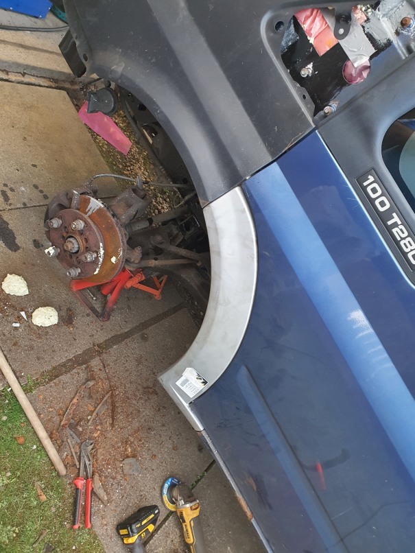

                      And a trial fit of the actual front back edge of the arch.
                      Dont worry about the step, that was rust pouring through and running down. I changed that full step section and about 10" of floor into the cab around 2016 and its still sound
                      Cheap ass pattern panel but few hits here and there and its a nice fit. Held in place with a few tek screws for moment
                      And wing in place for sanity check, lines not perfect but who really cares, now there is a life long lesson from Imps

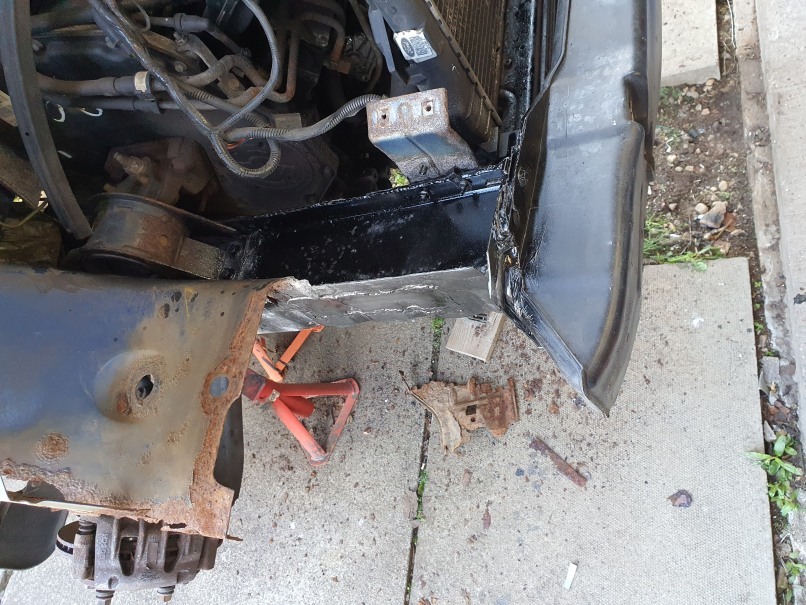

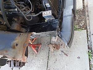

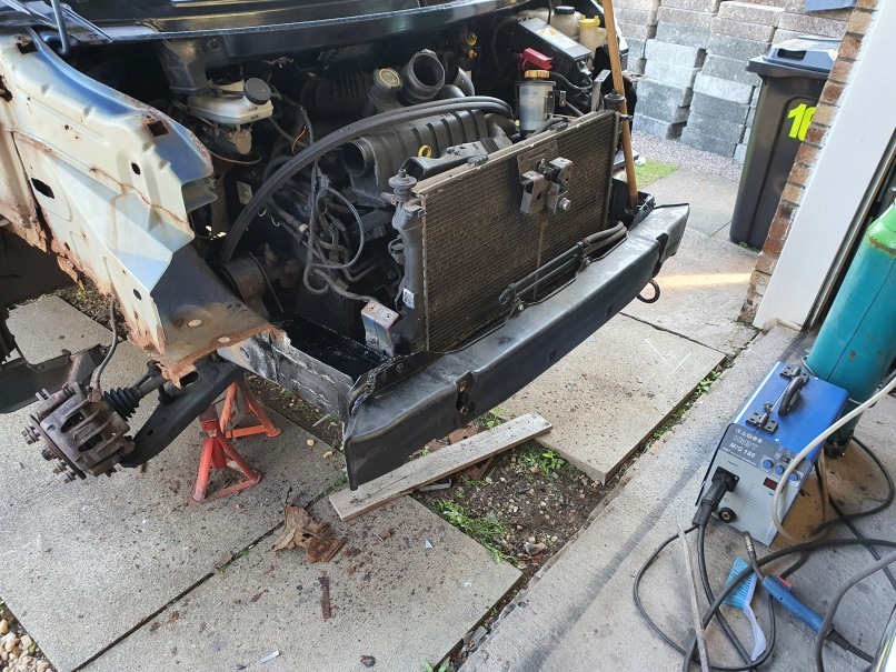

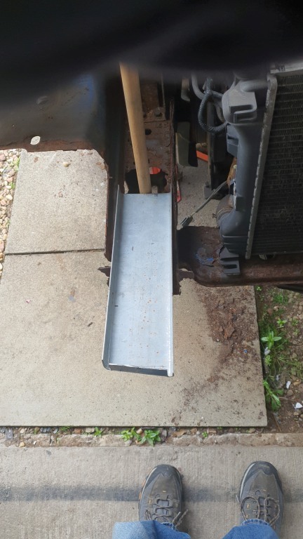

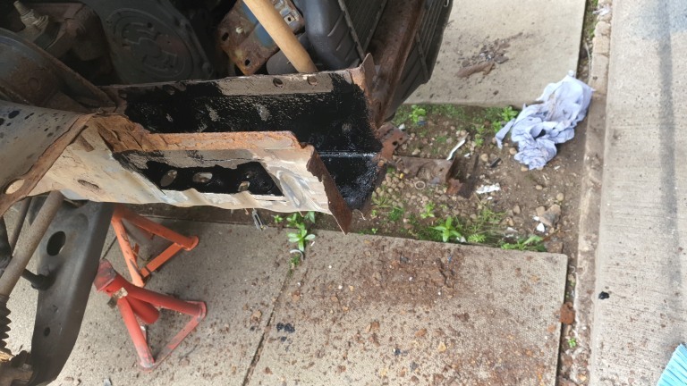

                            Well thate the passenger suide chassis end fixed, not so bad.
                            Then reconstructed the drivers side outer chassis leg and end, it was a total mess, top totally rotted out
ID:	14989 Click image for larger version
                            . OK the end is not an exact replica but as good as i can do and crash bar back on.

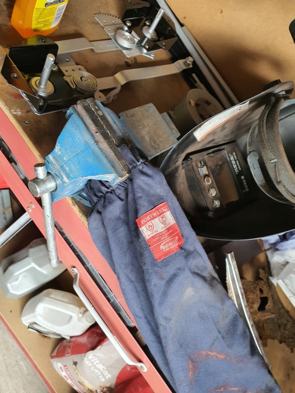

                            And who says a vise has 101 uses, well it has 102 now as I found out i cant take my welding sleeves off with one hand so if I pinch the end in the vise I can just pull the good arm out
