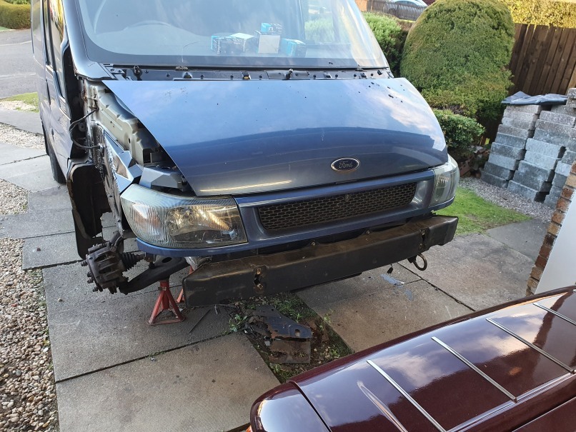

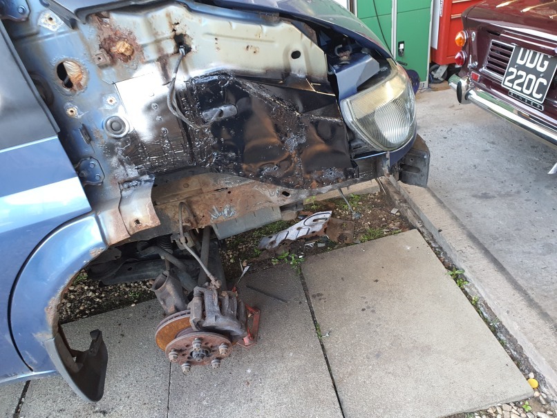

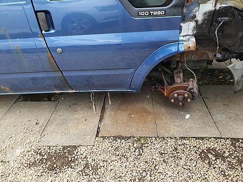

    Been desk working today, some more work was done on van at weekend.
    The drivers side inner wing structures and chassis all now repaired. Just the upper section at windscreen to do, that will be getting bonded, not welded near the screen.

    So thats both sides done and I can assemble the air filters, power steering, plenum, catches and so on.
    Starting to look like a van again.

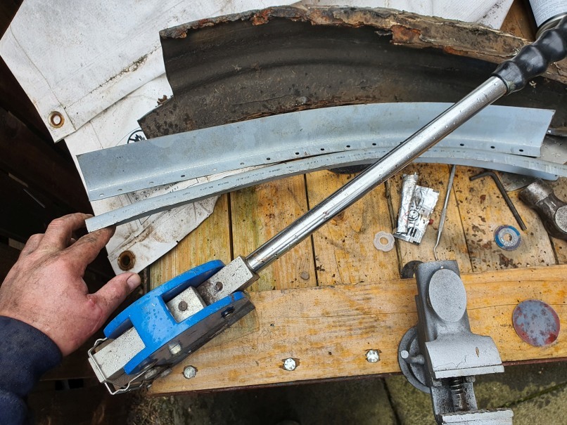

    In the mean time I created a new metal bashing tolley and clamps that lets me work on the metal, cut safely and bash bits with one hand, so managed to get the pan folder, shrinker/stretcher, camps and small ise on board.
    OK needs to live outside but with a tarp over its all good and I can work standing up as bending over was how I ended up in this mess in first place .

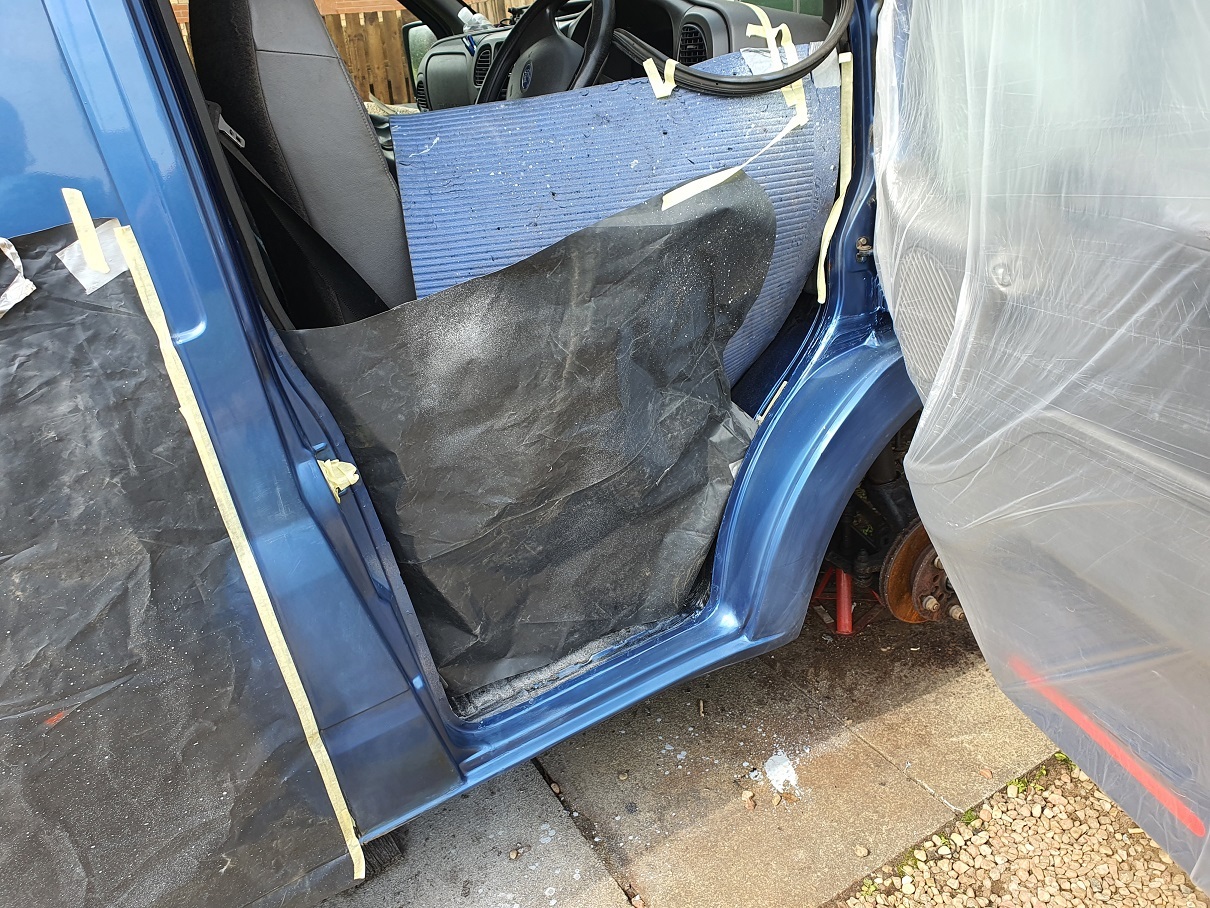

      #17
      Now passenger side back together inside and out as strut is a pain to get to.

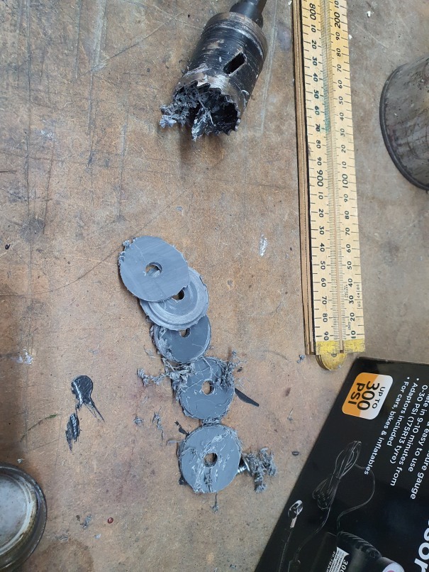

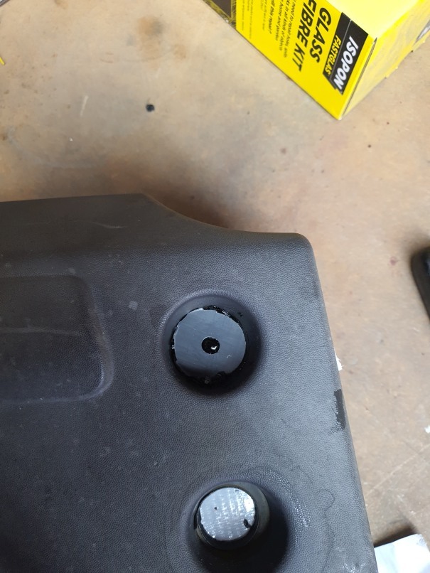

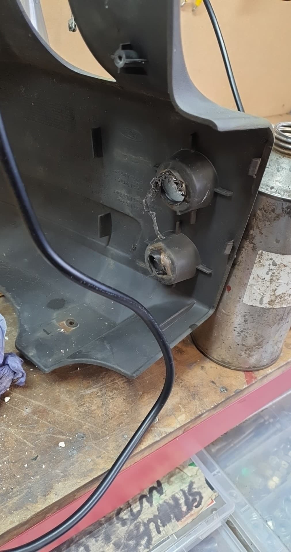

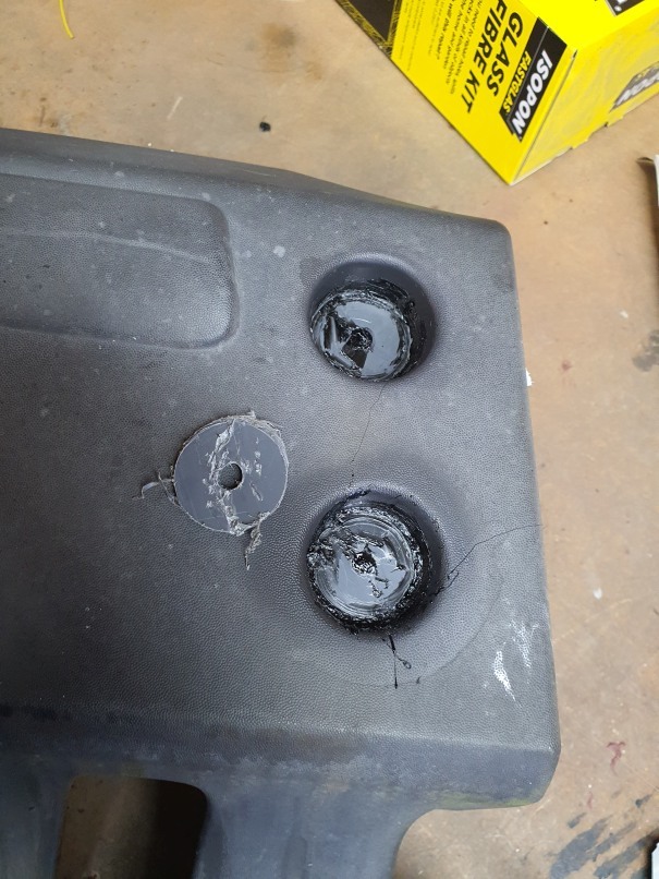

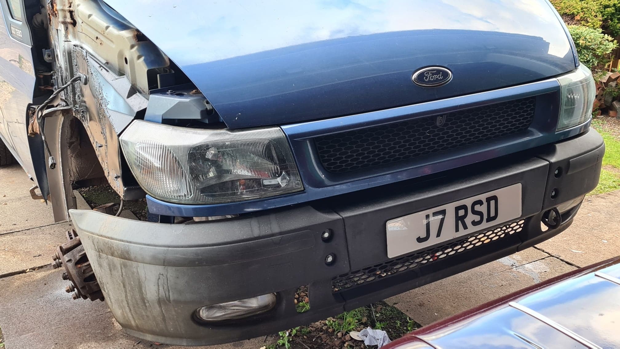

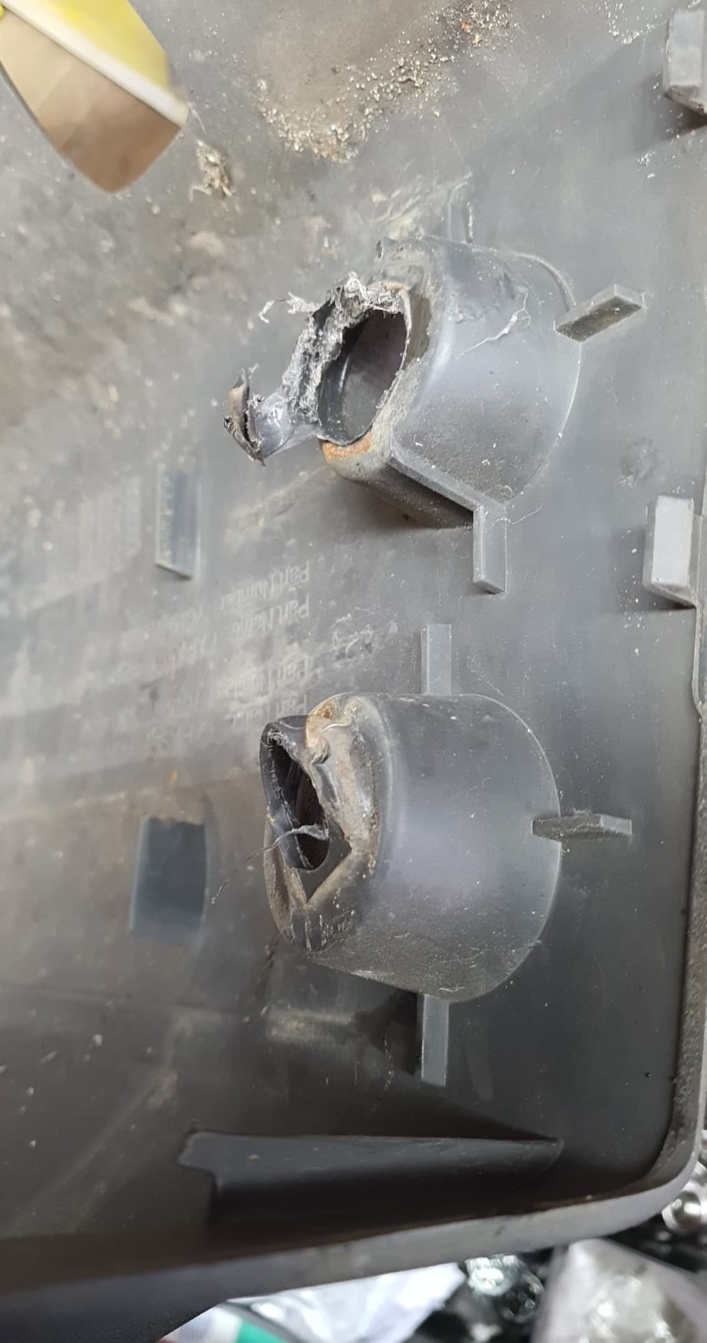

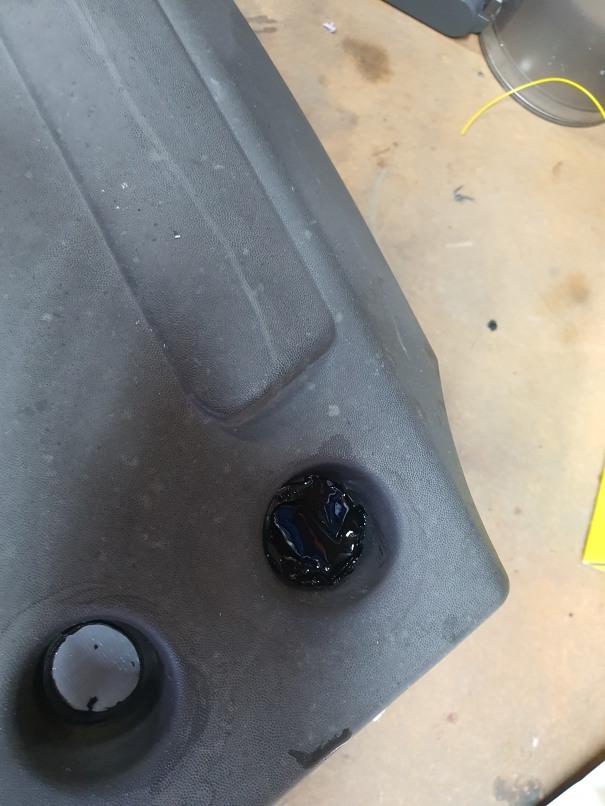

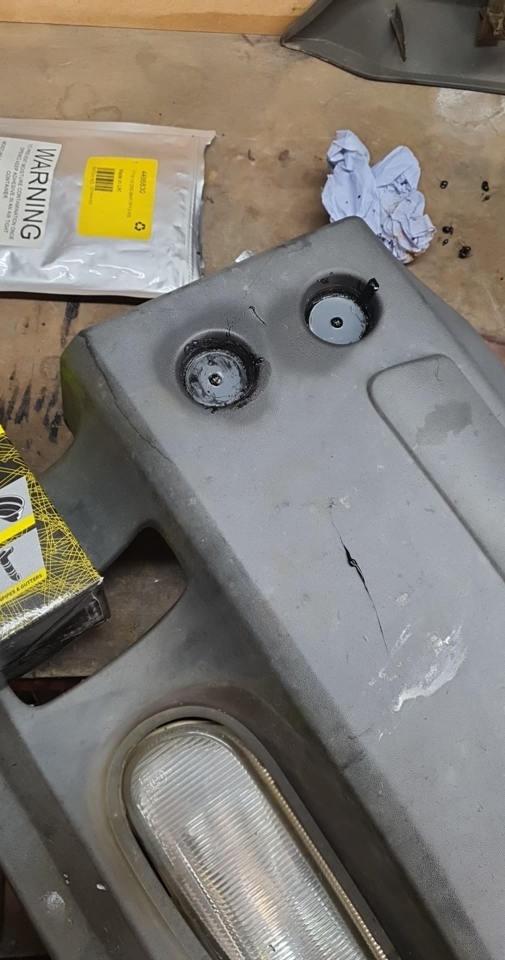

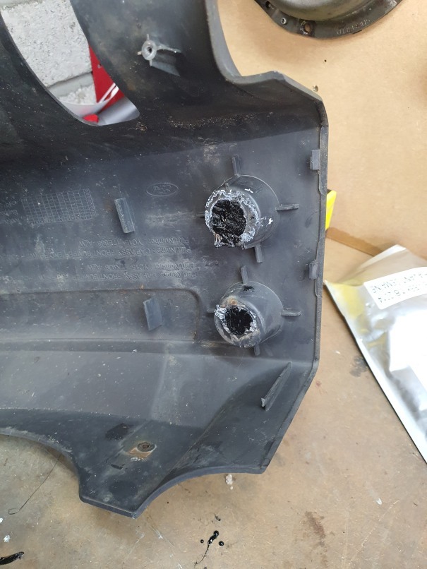

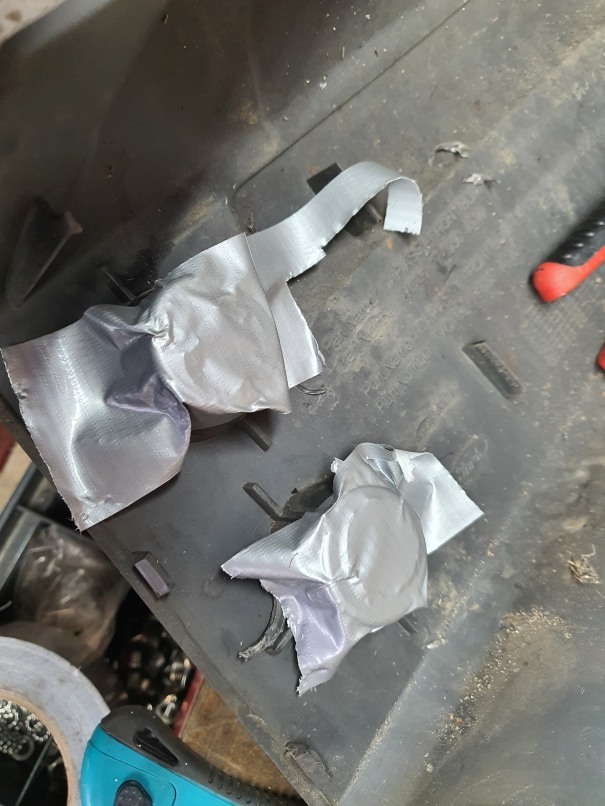

        And some plastics repair on th bumper as the retaining bosses melted away when I had to drill out th front bumper bolts.
        So make shift mould, re-enforced polyimide hot poured material, two cut 3mm plastic discs, all melted to gether with heat gun
        No more fingers were hurt due to the hot plastic.
        THIS PROBABLY HAS MORE STRENGTH IN IT NOW THAN NEW !
        Chocolate steel and ice cream plastic and every bolt seized, has to be a ford
ID:	15148 Click image for larger version
ID:	15150 Click image for larger version

          End result turned out OK, probably more solid attachment that original flimsy 2mm thick plastic.....

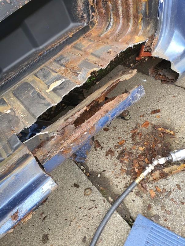

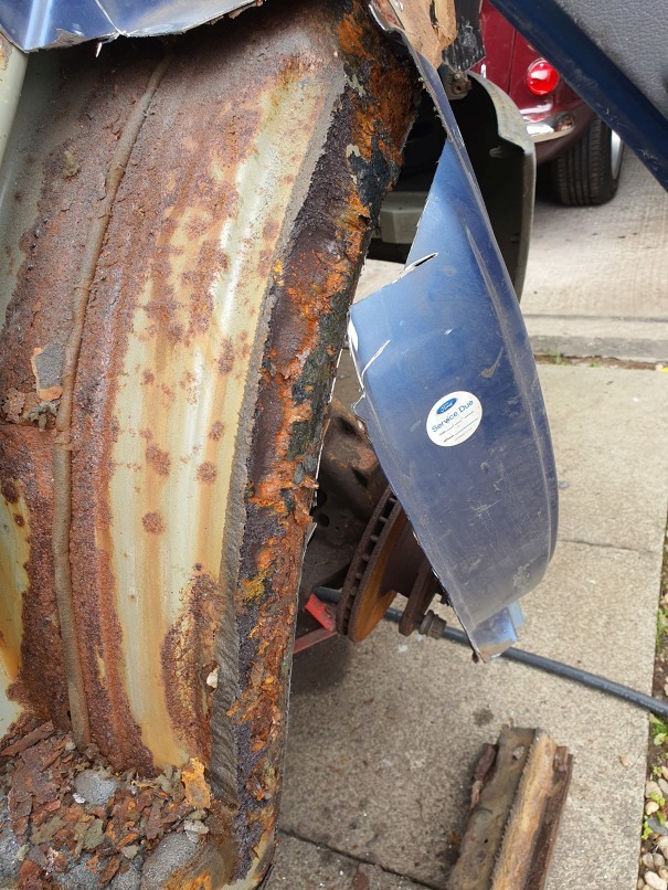

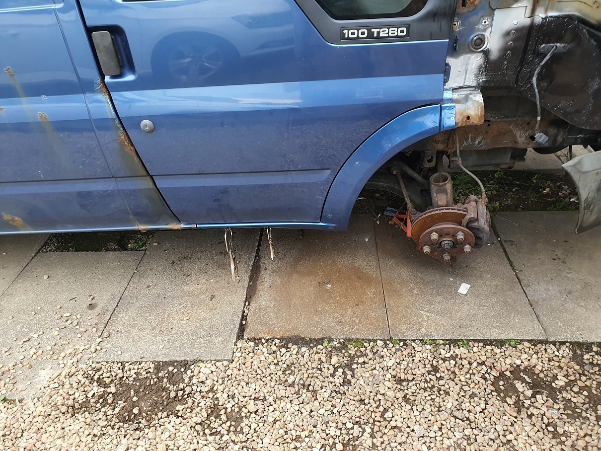

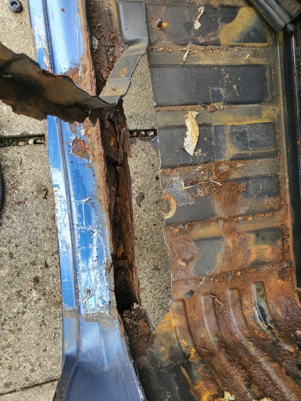

            And off with the drivers side did not take much as there was no metal, the ford underseal which is more like a 3mm plastic coating was all that was holding it.

              #21

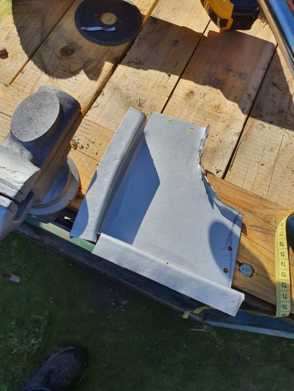

              And although I had the full step panel I decided as rest was solid just to use a section, then folder up an inner sill

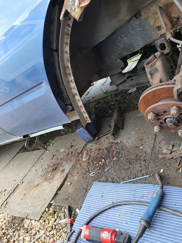

              Thats is also after removing the inner/outer wheel tub seams and making some up.
              OK, its not an imp but still a big pain in the ass on sills and wheel tubs

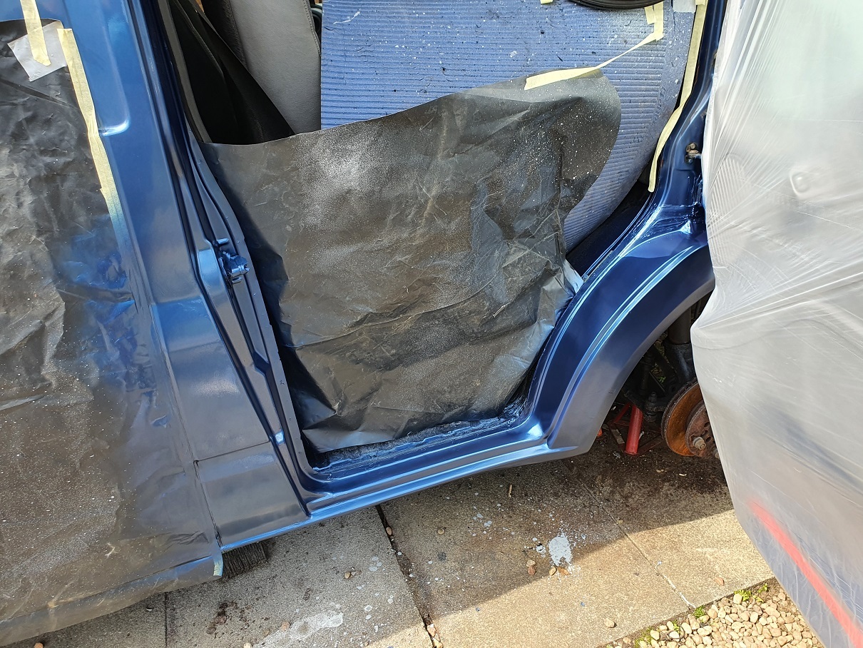

                  #23

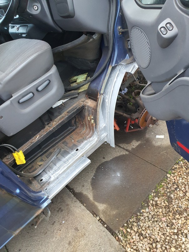

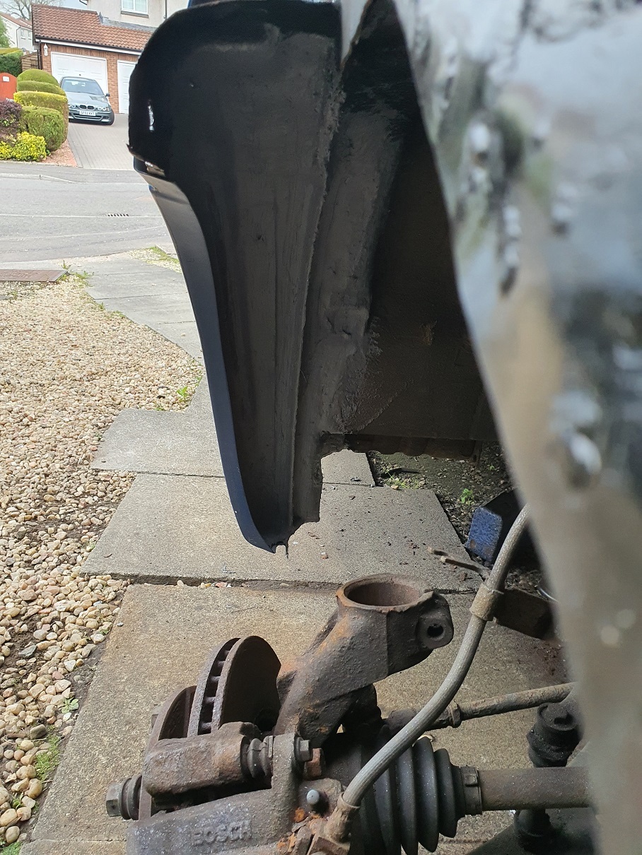

                  Well door off today and the outer arch and sill cut in, should have seen it from the photo but it measured OK, the step portion and inner sill section I made were 20mm too far up at front measurted perfect, pattern panels, pain in the arse.
                  So chop front loose and pull down/weld again.
                  Days work and back to where I was yesterday, but uglier. Not an imp but its bloody feeling like one

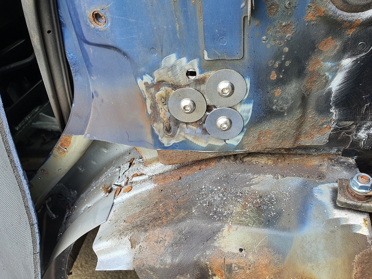

                  Another ball ache was the stress fracture and rot behind the lower door hinge I had to fix, only seen it after digging down for the hinge plate which fell inside the door pillar
                  Click image for larger version  Name:	20210527_171339.jpg Views:	0 Size:	581.7 KB ID:	15196
                  Fixed that and had to epoxy in the hinge so I could fit door.
                  End result is a fitting panel and inner lips, not perfect but looking OK.
                  Click image for larger version  Name:	20210527_195716.jpg Views:	0 Size:	517.1 KB ID:	15195
                    #24
                    Inner sill sections finished, outer wheel tub fabricated and set, seam sealed up ready for final outer attachment tomorrow
                    Another day should have inner wing and outwer wing on as well.

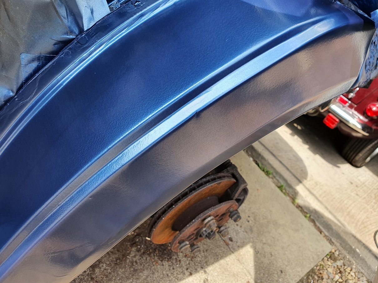

                          #27

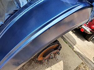

                          thats final fixed arch on (wing bolts on) and strut is back on as wheel tub, step and floor all sealed stone chiped and matt blacked.
                          Just rattle can single stage, outside with a wind but itworks plus the scabs on the B pillar are now gone.
                          Clear coat now. again rattle can

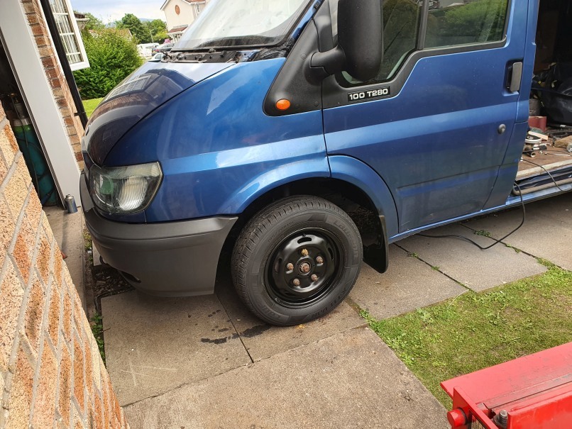

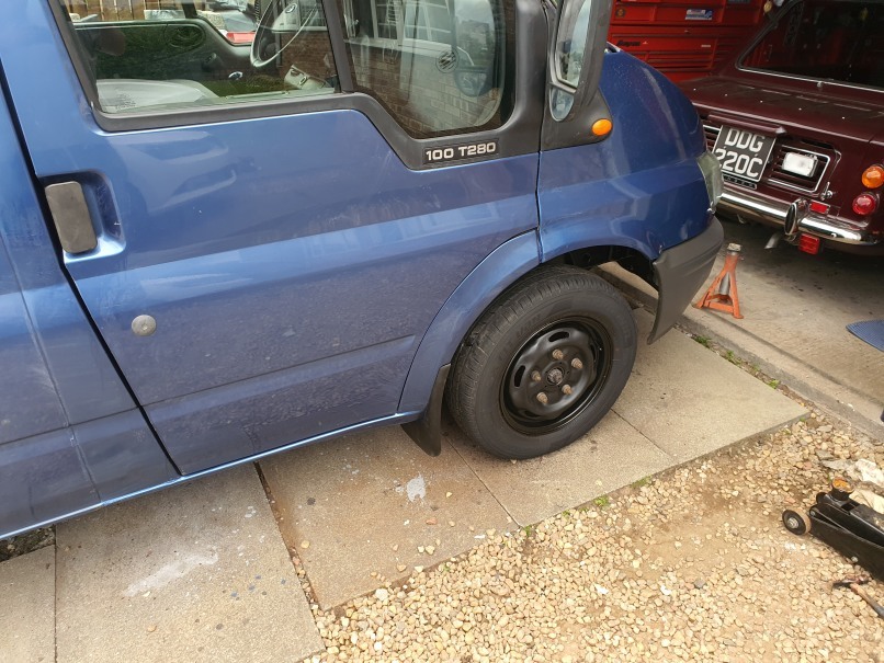

                            #28

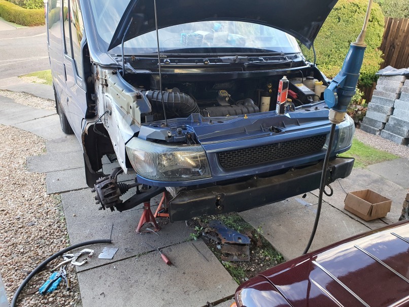

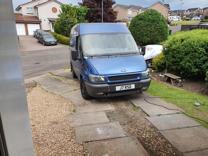

                            Well break time from the imp
                            Thats the vans front end to the back of the cab done (bar the oil leak which looks like the sump is perforated on front edge)
                            All paint and panels cleaned up, underside all stone chipped up and coated

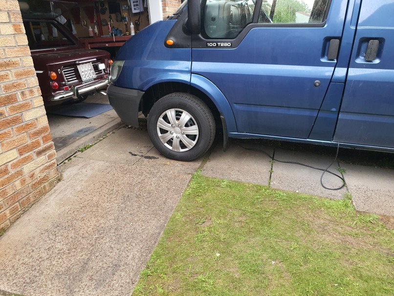

                            And finally add the wheels trims, sorted

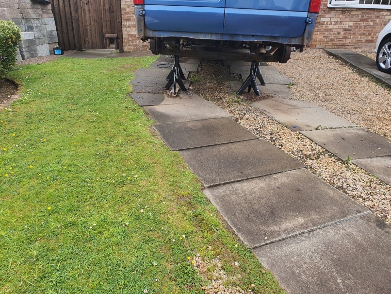

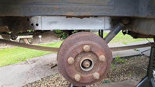

                              #29

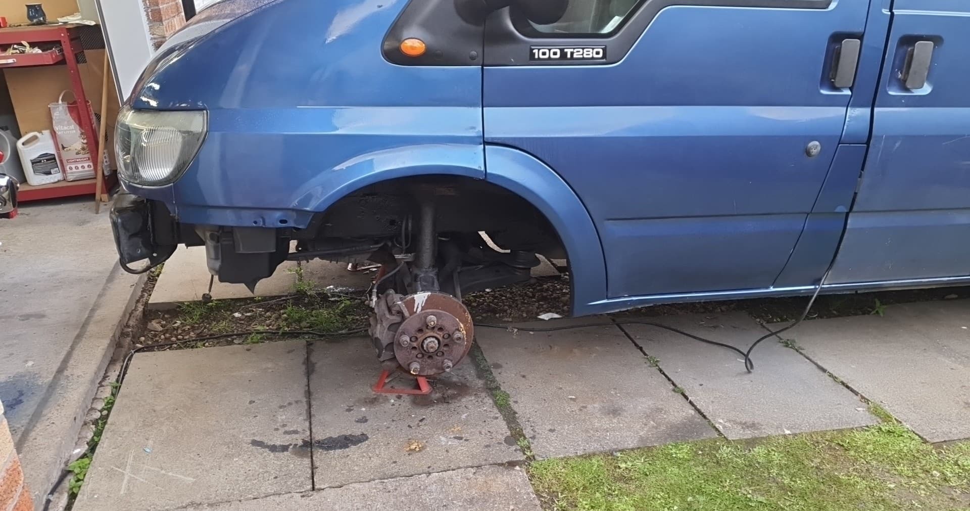

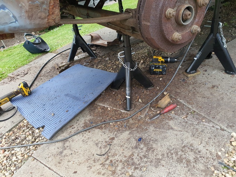

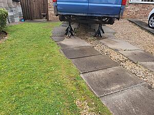

                              And then on to the back side, now up in the air
                              Plenty to do underneath, loads of ford rubbery underseal peeling off and the only thing holding metal together at some places.
                              Time for a harsh blast treatmnent to clear off all the crap (nice white salt residue under some bits) as any coatings on that is a waste of time.
                              No such problem at front as I ended up cutting all of it out 2 bad chassis bits though, found out hard way jacking it up, soft as poop

                                #30
                                Carnage ensues, feek me I was covered, really ned to get all the slaty cursty crappy underseal stuck shit off.
                                Had to pull exhaust as well, add it to the list, I will make one for it.
                                Click image for larger version  Name:	20210610_184705.jpg Views:	6 Size:	228.0 KB ID:	15414

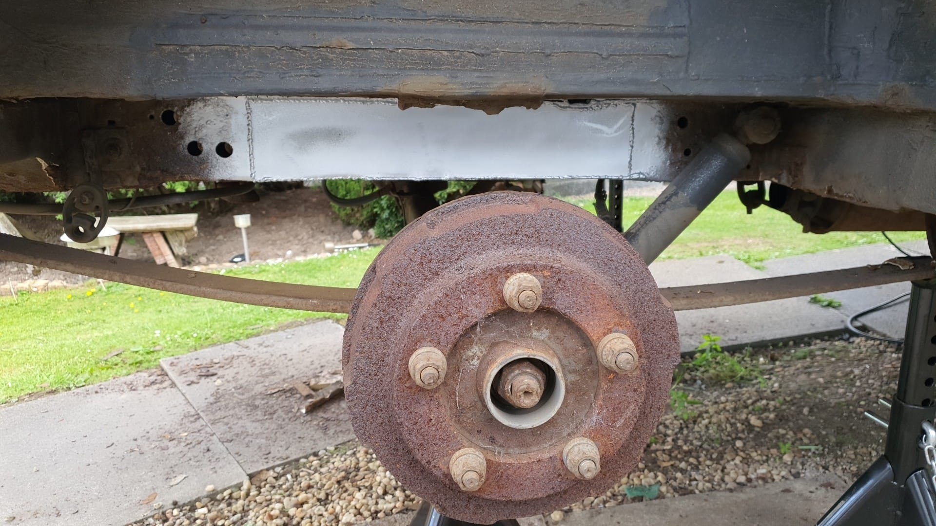

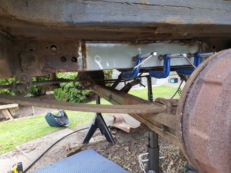

                                And some bits of chassis section in
                                Click image for larger version  Name:	20210610_184845.jpg Views:	4 Size:	181.4 KB ID:	15415
                                Cross brace and thats that side done (other side done already)
                                Click image for larger version  Name:	198262974_1890759744420976_6207716936393715768_n.jpg Views:	4 Size:	417.7 KB ID:	15416

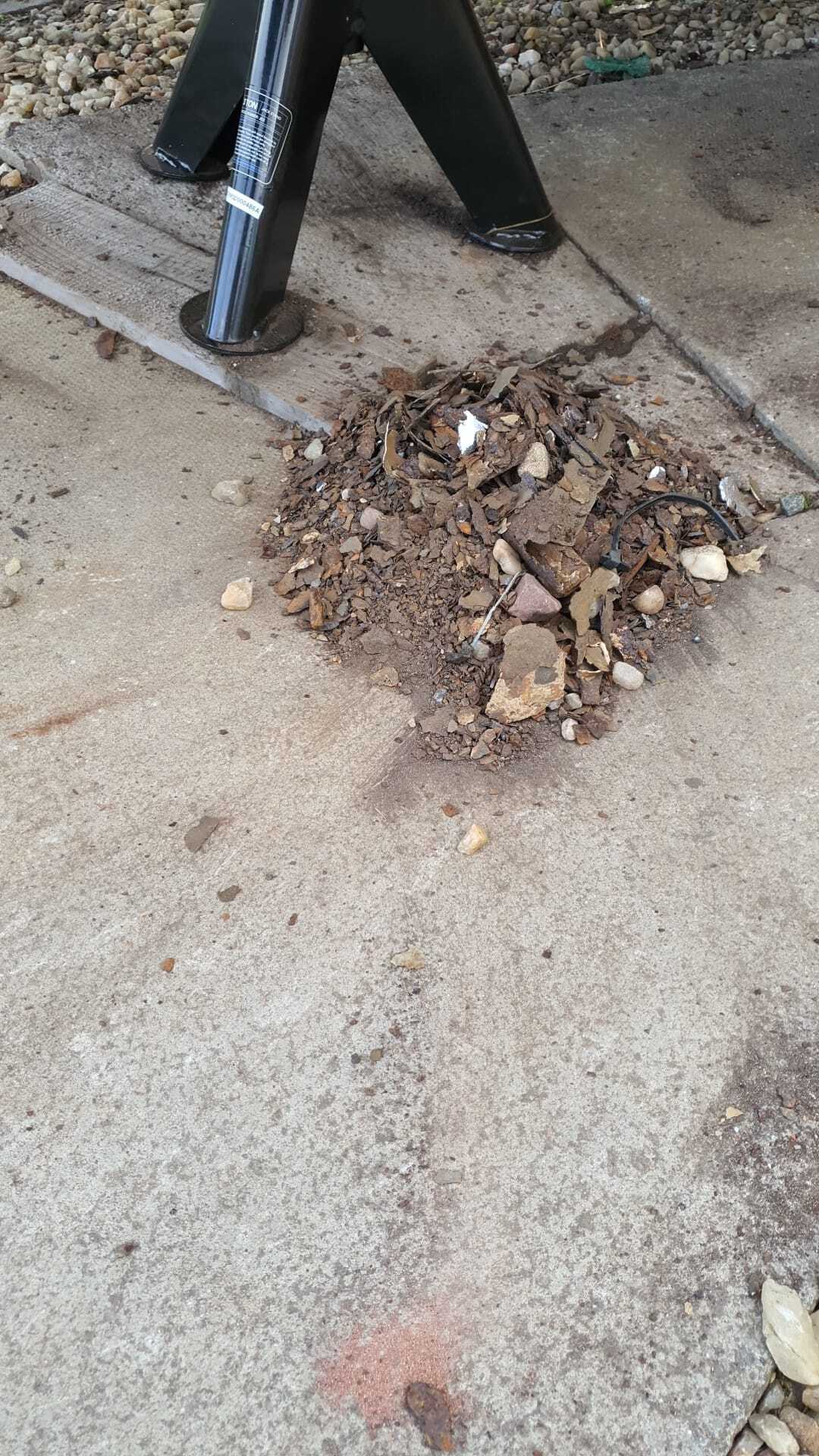

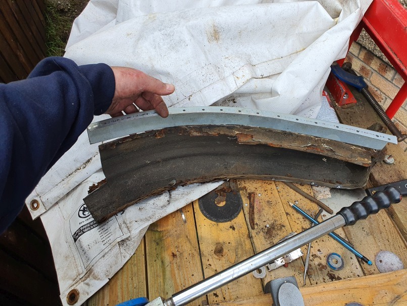

                                And the requireds sweeping up what was the chassis, some sections swollen to about 10mm thick and came away like gravel chunks
                                Click image for larger version  Name:	199252550_1890759027754381_2384454576391586332_n.jpg Views:	4 Size:	300.1 KB ID:	15418
