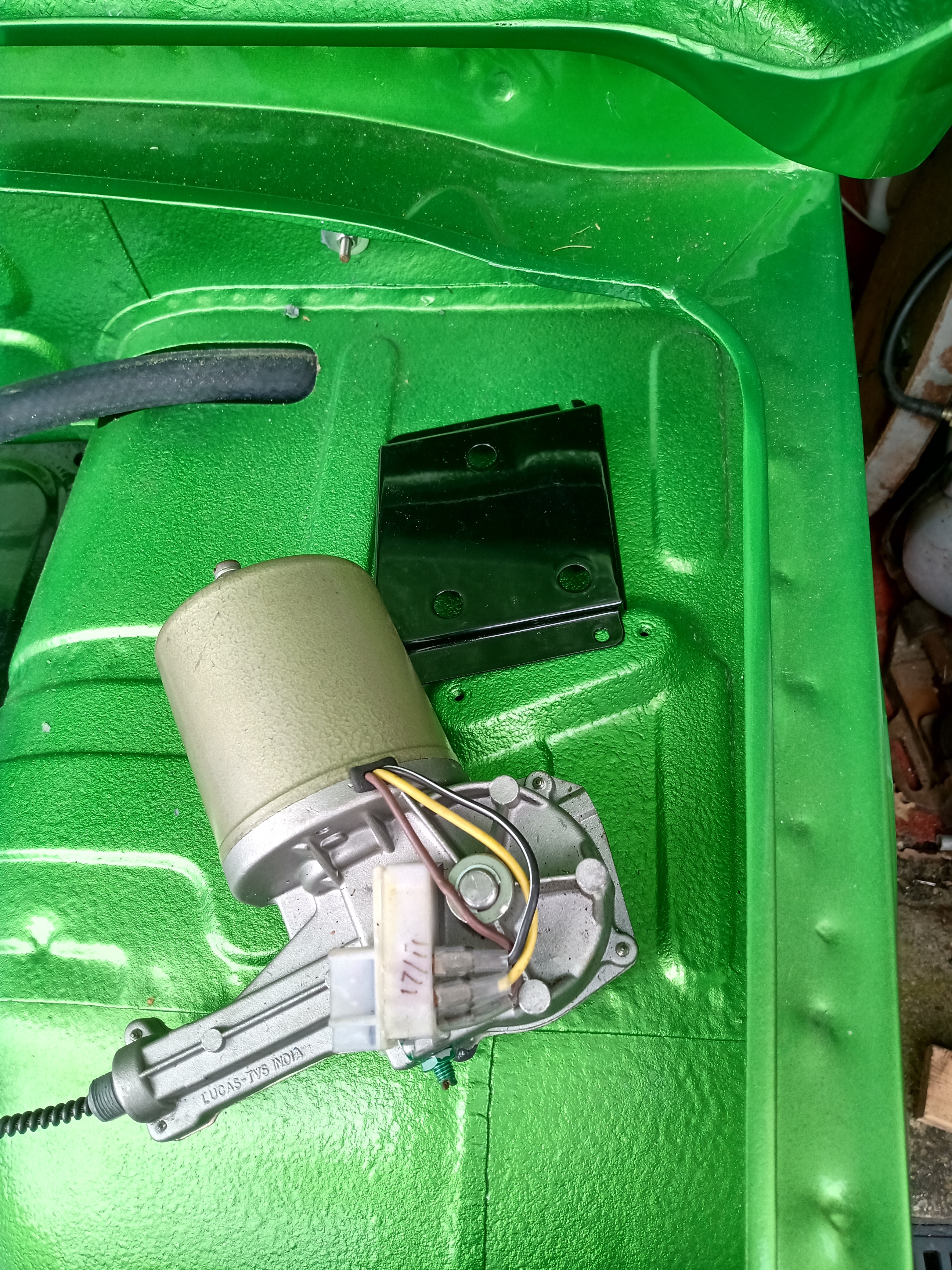

    Having bought a new motor years ago (rightly or wrongly?) looking at fitting , l know l have a strap and rubber support piece somewhere ?
    Pictured in position is the old refurbished mounting plate next to new design motor , is there another mounting plate for newer motors?
    I'm looking at it thinking l need to make a new support bracket that fits around half of the new motor assembly diameter . Click image for larger version  Name:	IMG_20210509_124149724_HDR.jpg Views:	63 Size:	4.44 MB ID:	14729
    Or do l just forget new motor and refurbish old one , might be easier?
    Assume there were different holes in shell to clamp newer round bodied motors?
    Any thought gratefully received.
    Bob, I have never had a car using the later motor but I am sure it was a large band around it. I scrapped plenty and can remember seeing some big clamps so i might even have one somewhere.
    Colins car should have the later motor Colimp66
      Yes. Found the clamp and support rubber , problem now is there are no suitable holes to fix and it's double skinned on top of wheel arch , assume l might have to use rivnuts (never used them before) if l put original plate on it would raise motor too high , have two old motors but liked the idea of having two speed (new) motor .

        Found a picture of round bodied motor clamped to a larger plate then the powder coated on in my picture ,so looks like l need to obtain one of those .
        Two large holes where wiper drives go through bulkhead , which is correct hole for wiper drive tubes , might be obvious once l have motor in position as it would be preferable to have run as straight as possible. . hole nearest nearside or one just in from that?
          Bob, hole to the left for the tube and the motor position is not super critical but needs to be pretty close.

                    You are correct John, The Pest has the later motor which is fixed with a U shaped band which rests on a rubber insulator pad. You can buy them from Car Builder Solutions I believe.
                    I lost the rubber insulator pad and was able to source through Ebay.
                    I am still using the original switch for the wiper motor.
                      I have new strap and rubber support pad , my only problem is that there are no suitable holes for using the strap (double skin at that point) am currently looking at making plate that fits to original mounting plate ,which makes area larger for fitting strap to.

                        Looks like the cars that had the round motored ones had a totally different mounting plate , looks like it's welded in?
                        l just need to make something similar using the square mounting plate l have as a plate to bolt new one to car.possibly.
