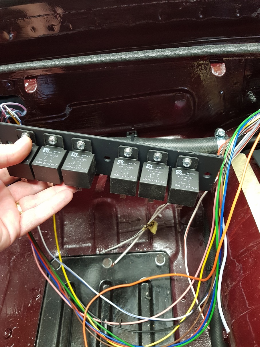

        Was going for 2 blocks for relay without fuses, possibly clipped together , shows you can clip a fuse block on the side so l'm assuming same can be said for relay block , got plenty of fuse capacity elsewhere so don't need fuse and relay unit ,
        Still thinking of putting an aluminium plate in front of water pipework to fit relays & fuse boxes to keep it all tidy ,

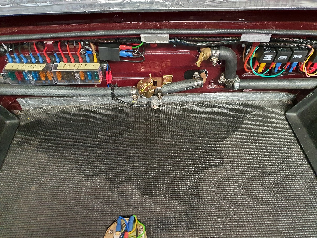

          Bob, OK so just like DDG and JDL and before

          Ignore the wtaer stains, when bleeding syystem sometimes it just happens
          The small black block on right of fuse bank is actually the electronic flasher unit, seemed easiest place to put it.
          I too made a plate for the relays, mounted onto bulkhead using spacers and rivnuts

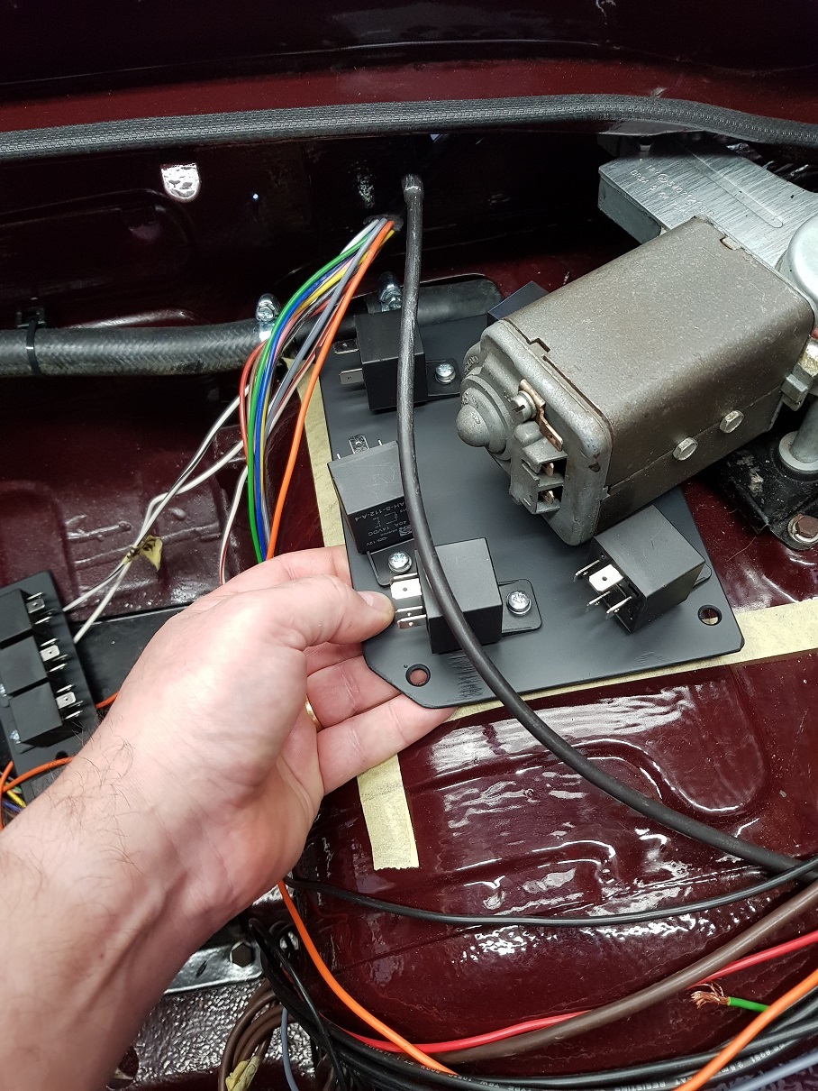

          And large plate around the wiper motor as its just wasted space again rivnuts and standoffs.

            Ah ah ,didn't think of that one , looks like l'll be making a plate for wiper motor mount so that's maybe a way forward , make it big enough to do two jobs!

              Bob, yes loads of wasted space in that area and easy access for cables.

                Yes my way of thinking was that block containing 4 relays should look neater that four relays with wiring coming out underneath , just personal choice.
                Held back some really thick cardboard from recycling today and should be able to cobble up a nice template for motor mount .
