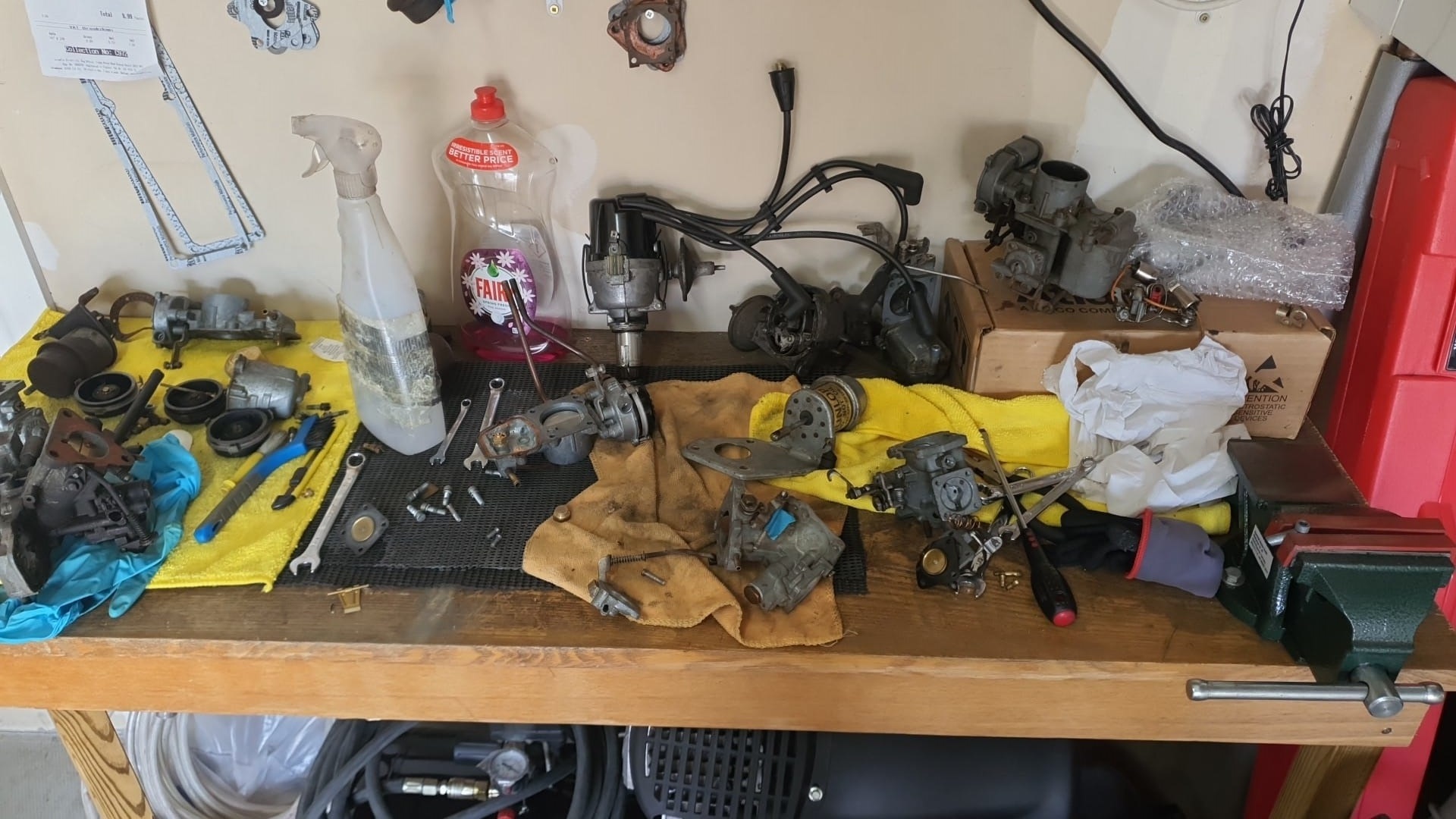

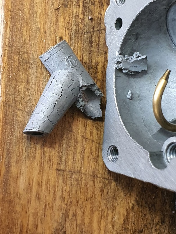

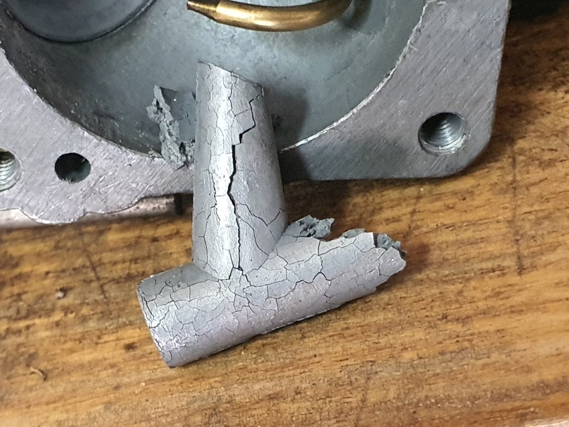

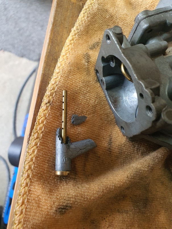

    Took it off car and onto bench, stripped, clean, blew channels through and when I attempted to remove thsi the whole casting simply collapsed
    Guess that explains the issue which sounded like an air leak and led to changing of manifold gaskets many times....

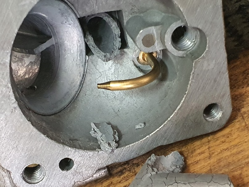

    Totally collapsed, whole composition of the casting seems to have fell apart
    So as we love the old girl, some carnage ensued with the solex casulaty dept and a frankensolex was created from the disorder.
