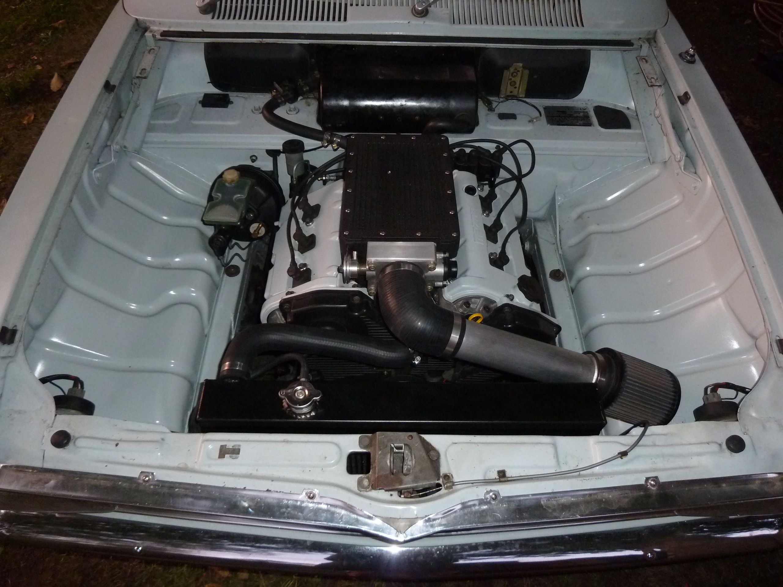

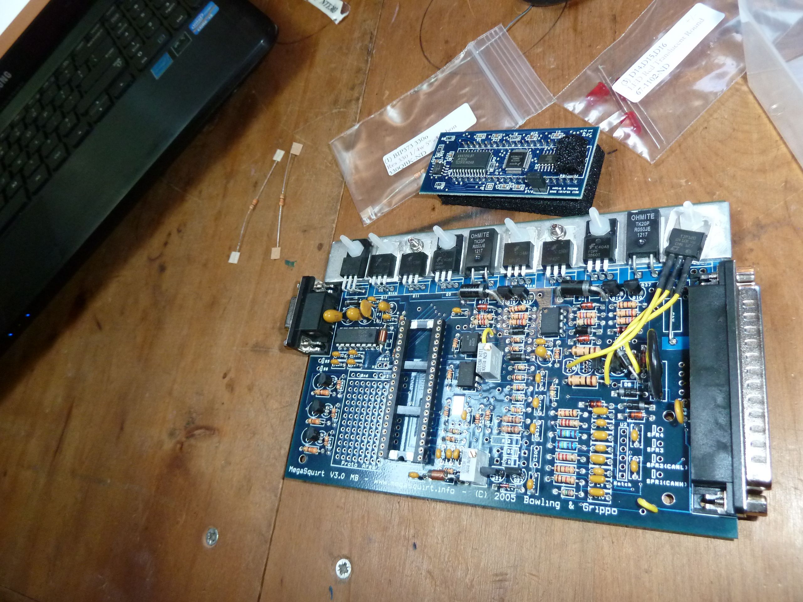

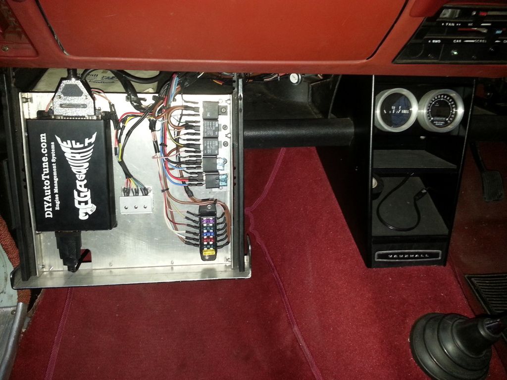

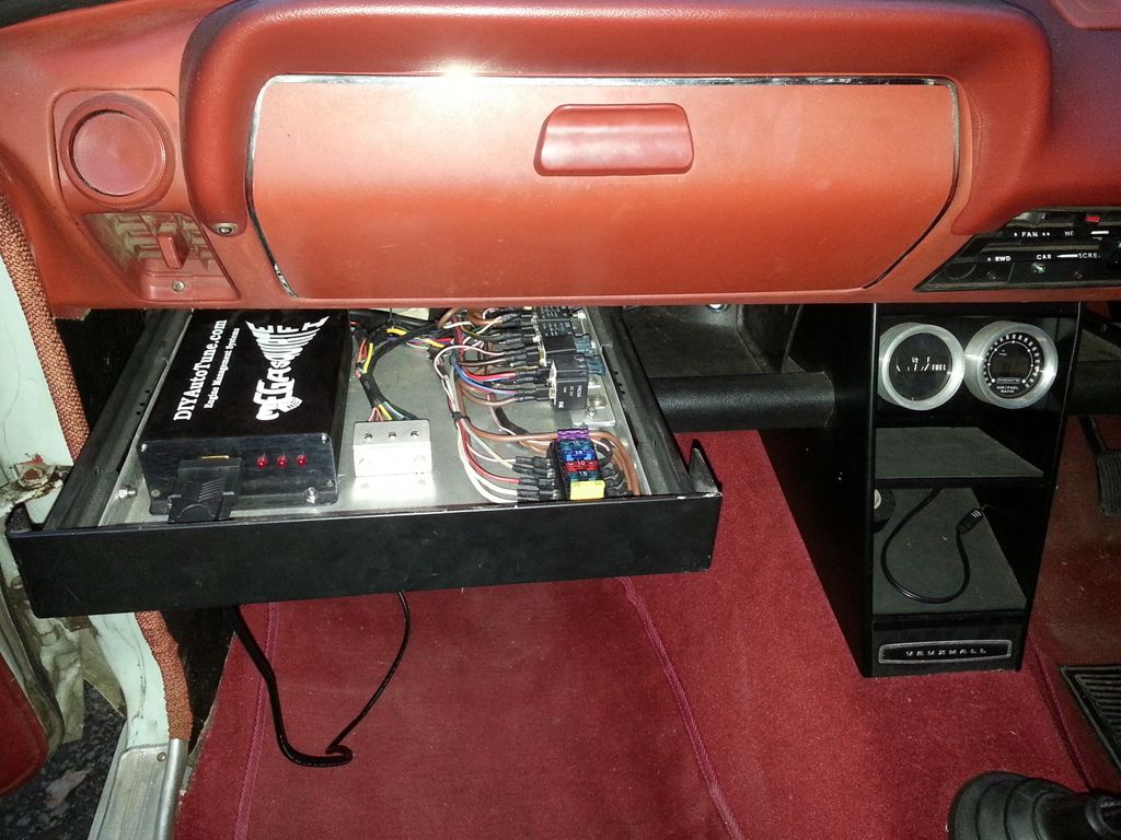

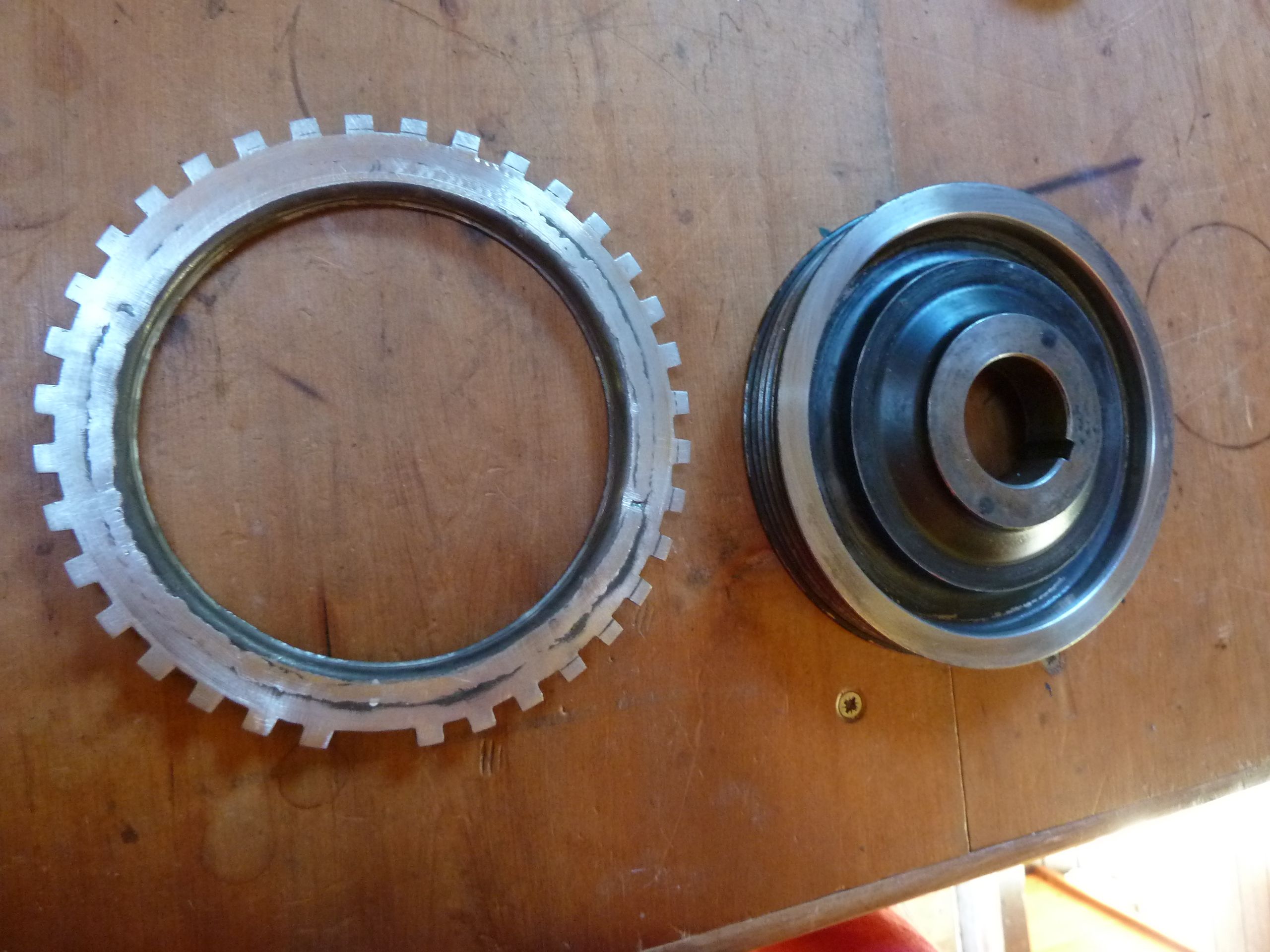

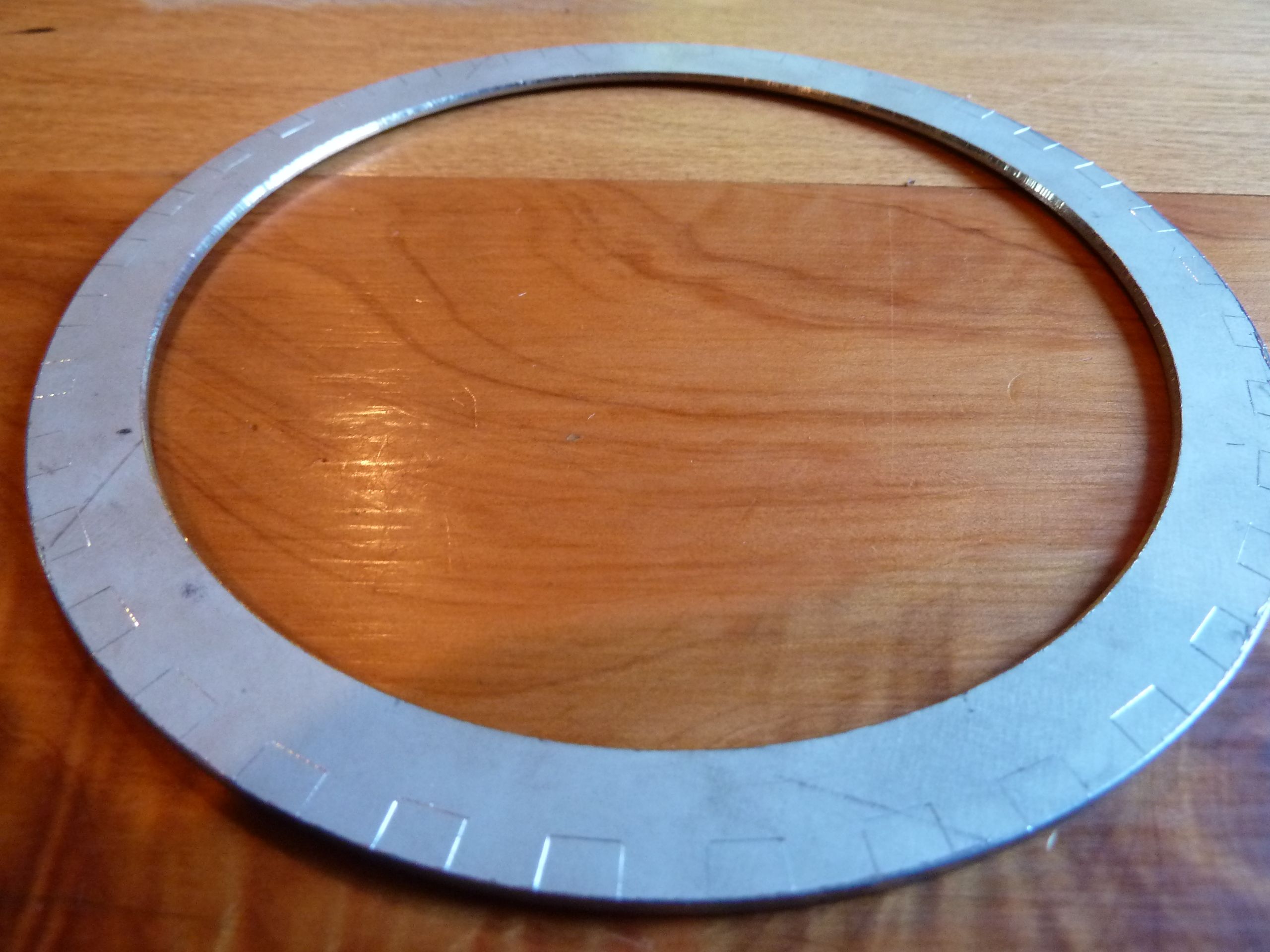

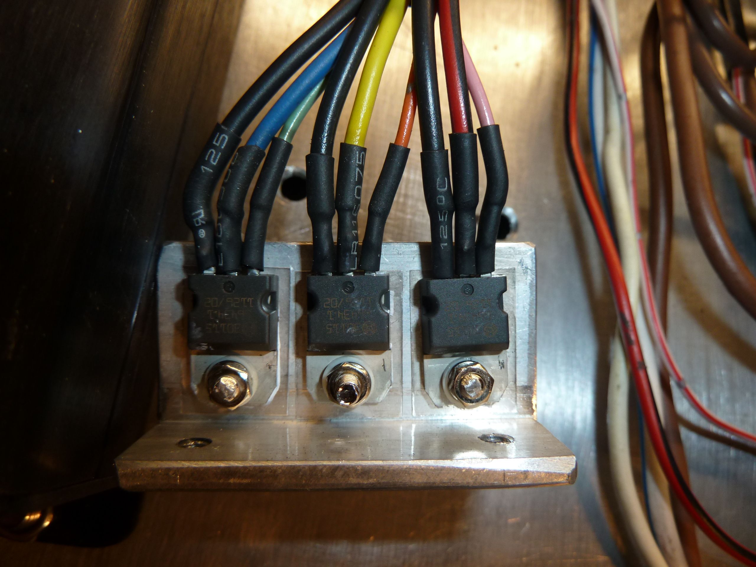

          On my Vauxhall Viva with the Mazda V6 I ran batch injection- mainly due to that fact that the ms2 ecu I built would only run full sequential on more than 4 cylinders if I added a daughter board. So all I needed was one VR sensor which i used in the stock position. I made a 36-1 trigger wheel by hand with a hacksaw and file. Printed the tooth pattern on paper, made a stencil, traced the pattern onto a steel disc I whipped up in a lathe. Tigged the wheel onto the back of my pulley. You dont even need to get it perfect- the teeth or the placement in degrees. In tunerstudio, as used by speeduino or megasquirt one can 'adjust' the position of the missing tooth in a drop down window. Soooo easy
          But next time I want to run full sequential. Power is easy with injection. It is with carbs too. But making an engine run super smooth at idle, just off idle and in all other daily driving conditions is the tricky bit which is also more fun trying to attain. I had it pretty good but batch injection just cant match sequential. Also extra mpgs can be had with finer control. Especially on a 6.

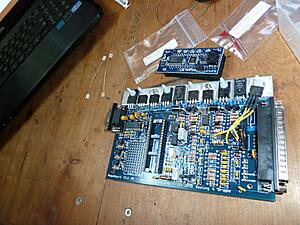

          My ignition was wasted spark with an old mitsi coil. I mounted my ignitors (bip373) outside the ms case onto an alloy heatsink for two reasons. They run fairly hot so why not move that heat away from everything else. It allowed me to run much fatter cables too and from the board and to the coil rather then silly little things through a terrible plug (the lovely DB 37 that ms use) The V6 was so smooth and quiet when cruising that we could actually hear the clicks from the transistors switching (the magic they do inside)
          On the Imp, whether its the Datsun I inject, or later on a bmw, or possibly a different engine, I'll be going for full sequential. I presume that the Bimmer K engine doesnt have a cam angle sensor if from what I have learned they just run batch injection? Its certainly not that hard to add one in somewhere though if you can do a little bit of fab work within the cam cover etc. Or on an Imp engine the dizzy shaft could be used.

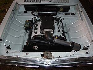

          I'd not bother trying to run ignition through a dizzy when full dizzyless ignition is so easy. Makes for a better spark, cleaner engine bay. Coil packs mount nicely away under the rear parcel shelf eh
          Here's some pics of my first foray into diy engine electronic management lifted from my Viva thread over on oldschool.co.nz Its just so much fun!

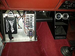

            Alex, I seen the pictures on the wiring at the other place,some serious fine work, makes some of my cabinet work look positively untidy !

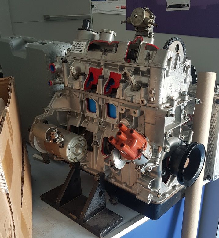

            Over here you should see what gets picked out the back of an imp after a good run around in the wet not really wet friendly however the original later engine from rootes did come with electronic ignition.

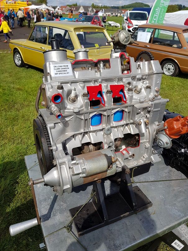

            I borrowed this cut away engine from Clark for a show a few years back, hall in the dizzy and locator for another on the pulley. I have no idea what was ever fitted but a simple CDi would be all that is needed
            Might try and see what would have bene used.
