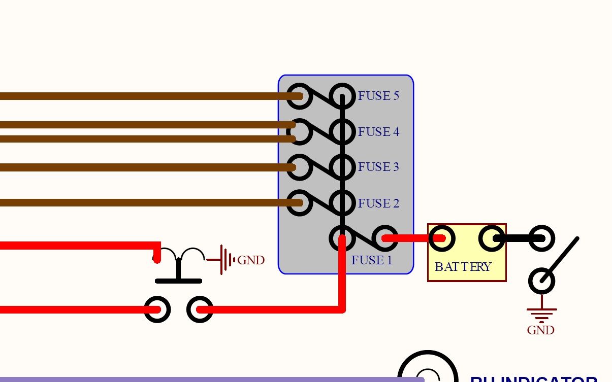

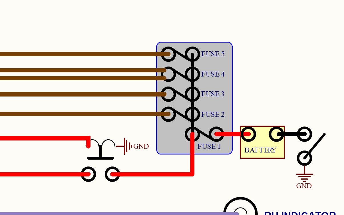

    Click image for larger version  Name:	fuse-simples.jpg Views:	0 Size:	74.8 KB ID:	3306
    Fuse 1 is a mega fuse to protect any issues on alternator or a dead short on a high current wire, this feeds the solenoid and starter
    Fuse 2 is the return supply from the alternator so next time you short the wire out to ground or snag it you dont put the loom on fire !
    Fuse 3 is a live supply which will be switched by relays to supply an ignition switched 12V
    Fuse 4 is a split supply, one for side lights and dip/main beam and other for things like horn, heater, front screen heated etc.
    Fuse 5 is the other for things like spotlights and so on.
    As all feeds come direct from the battery and go directly to point of load via realy, switch wear, cable loss are all kept to a minimum and all cables are rated way above what is needed so that voltage loss is fine even at 70-80 deg besde heater hoses.
    This is part of a whole new wiring system I designed for DDG220C based on what i have done before in other imp restorations and lessons learned. Sometimes you never stop learning
    The first articles will be based on a complete rewire, it will not be a stock rewire so if you want to do a true restoration, its not for you.
    The latest itteration includes facilities for things like heated front windscren, heated rear windscreen, electric fuel pump, spotlights, fog lights, reversing lamps as well as auxilliary connectors in bonnet and engine bay with courtesy lights.
    These will be based on standard binnacle dash structures as that is what I am most familiar with. Saying that it is easilly modified for any other instruments as it is only the instruments that change, senders and so on are always the same on an imp engine.
    As a snippet here is a quick screen shot of the battery/interface to car, these are all fused and if fused correctly can protect the rest of teh car to a certain degree, certainly better than stock.
