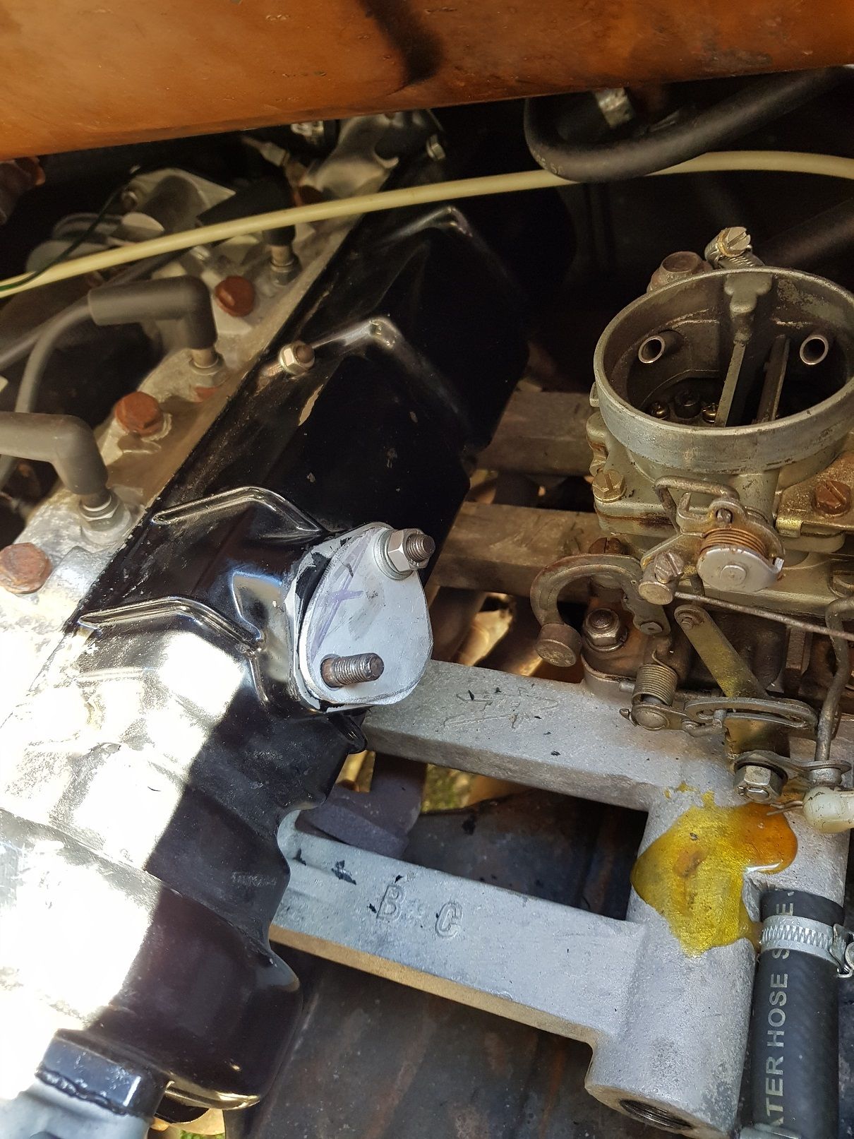

    So Boris fuel pump bodge (and it was a bidge) got a revamp today.
    So reclaim time for the billet blanking plate and fitted back on DDG
    New blank plate "bodgerised" from som 3mm plate

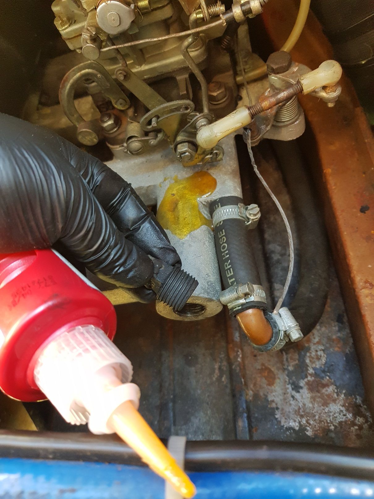

    And when removing the air pan which uses a nut welded to the blanking plug on the end of the Nikki manifold I find the blank plug comes out by hand, that will be the odd cough now and again found then !
    Some thread sealer and we are good to go

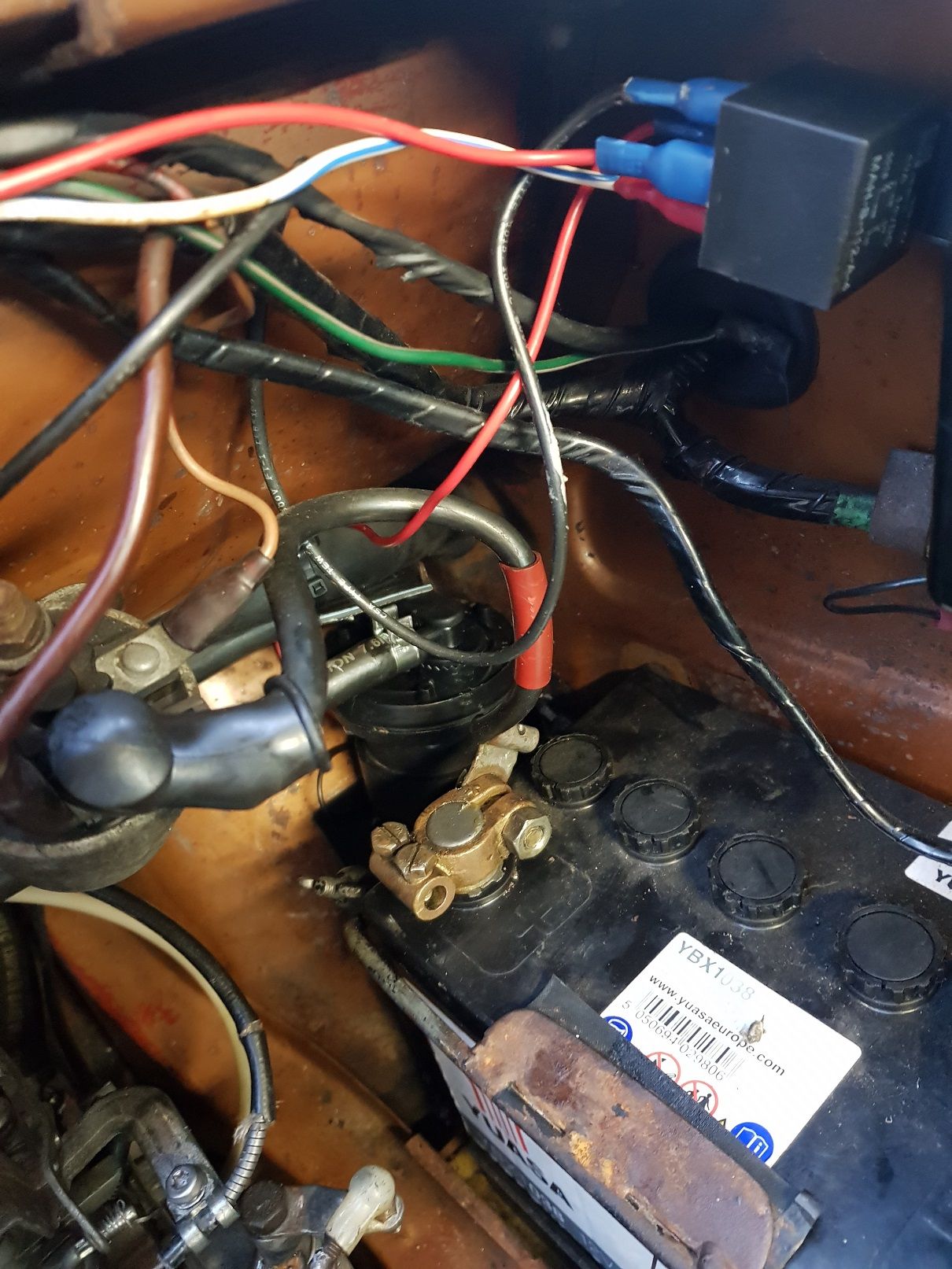

    New pump better suited for mounting in the engine bay this time bolted to the inner wing. Safety relay wired up differently.
