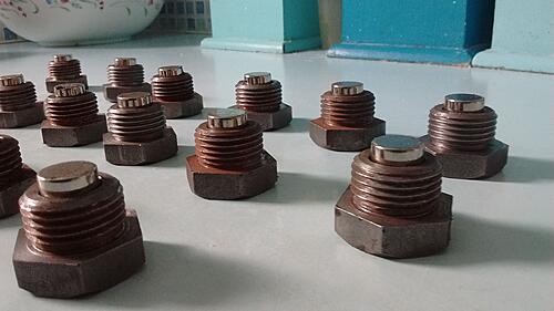

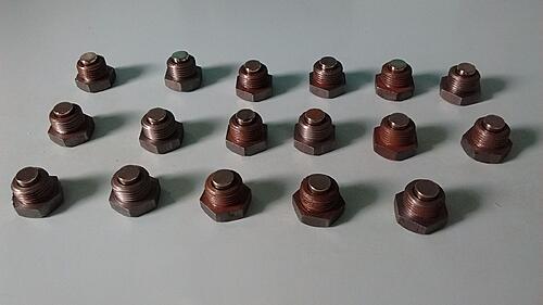

    Plugs to fit sump & gearbox, stronger magnets than the in tank filter magnet, there's no way these magnets will not pick up metallic debris in sump or gearbox oil.
    They are removable from plugs for cleaning ,should you feel the need , but you need a vice , haven't tried mole grips ,might work .

                Magnetic plugs have been tested by me now having only made them a few days ago , the hexagonal head of my plugs are bigger than the originals , l used a 1" socket with no problem .
                Inserted one of my plugs into gearbox and levelled off gearbox , tilted box to remove plug and it was covered in iron filings , shocked me a bit .

                      Ordered more plugs to modify , next order more magnets and washers, Only 4 cars worth left on shelf now.
