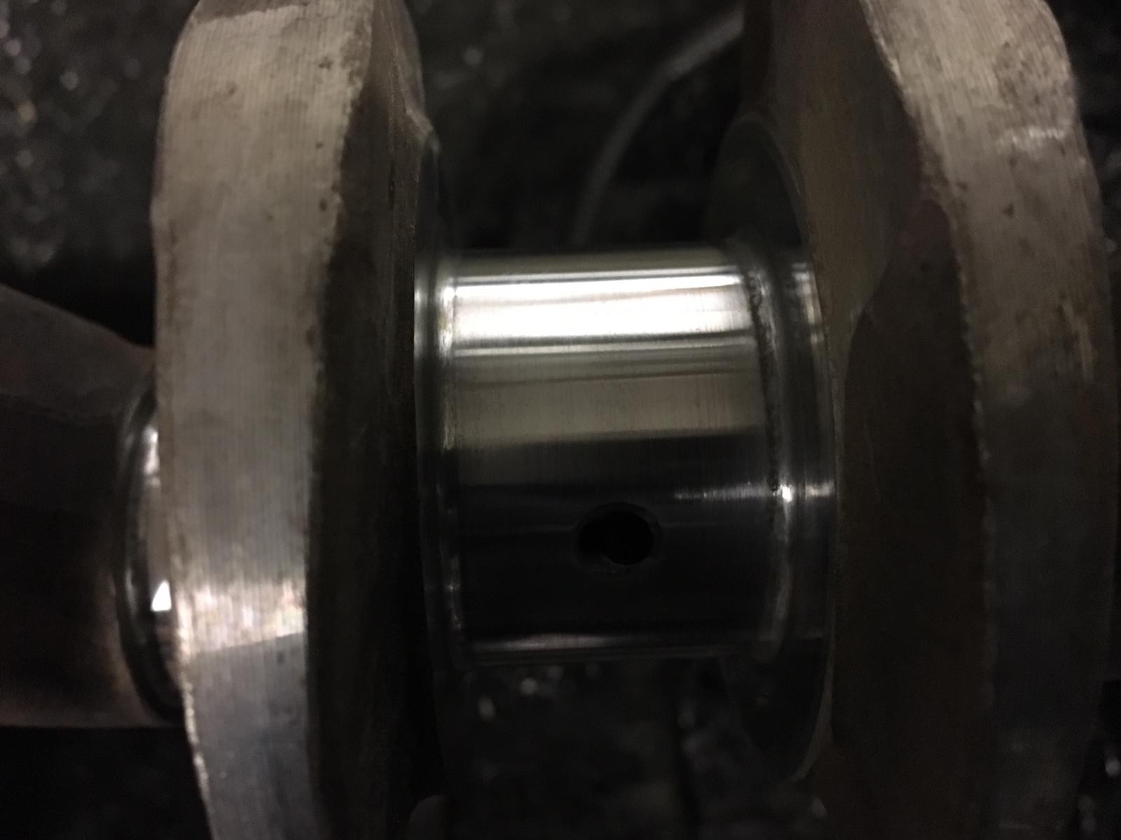

                        Time to get onto other parts now, crank polished.
                          #13
                          Crank looks as good as new.
