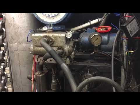

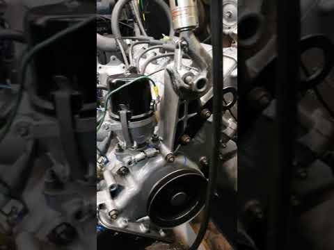

        Engine back together on the bench and doing some test runs.
          #34
          Previous one was before a further strip down, has since been bored out +20 thou and fitted with new pistons.
          Sounds a little tappety as there is a little bit of wear on cam buckets, will see how it sounds when it has heavier oil in it (thin stuff in at moment)
          If need be we will replace the cam buckets and tighten the gap to eliminate any tappet sound.

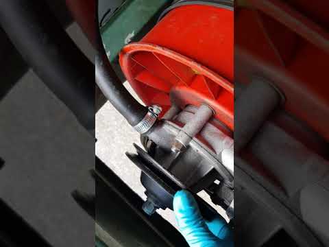

                    Noticed a bit of a strange noise when we got back to Birds and Bees (pub Stirling & District Classic Car Club SDCCC) last night form Glasgow and I went to park.
                    Just been out to investigate and got a wobbly water pump pulley.
                      #40
                      With the fan belt off we can see it.
