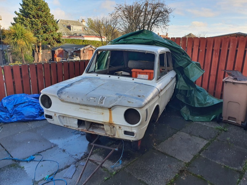

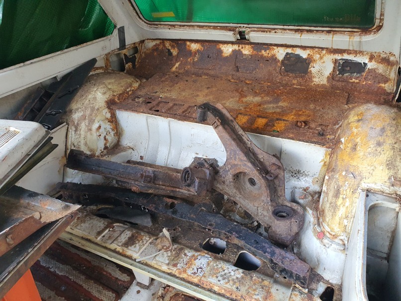

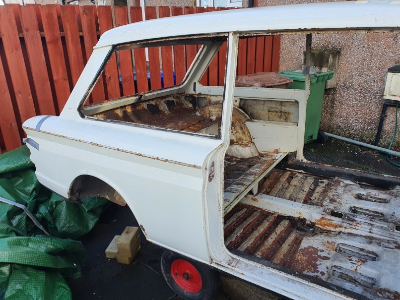

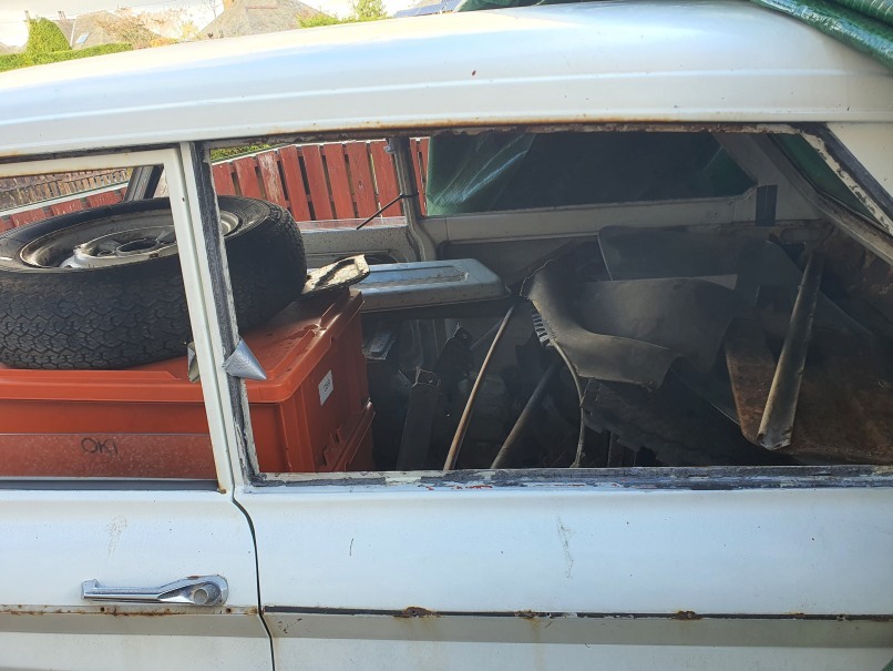

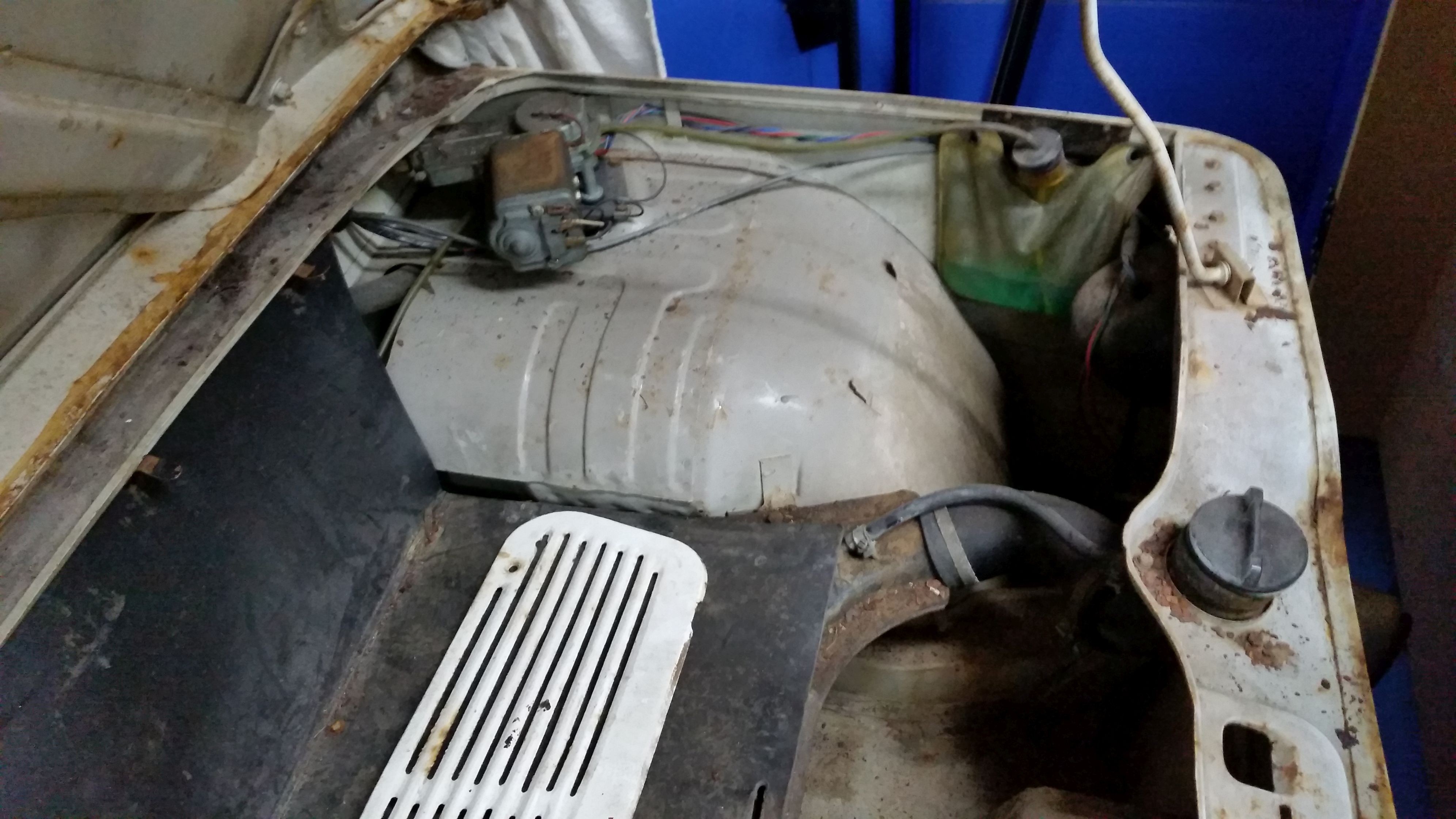

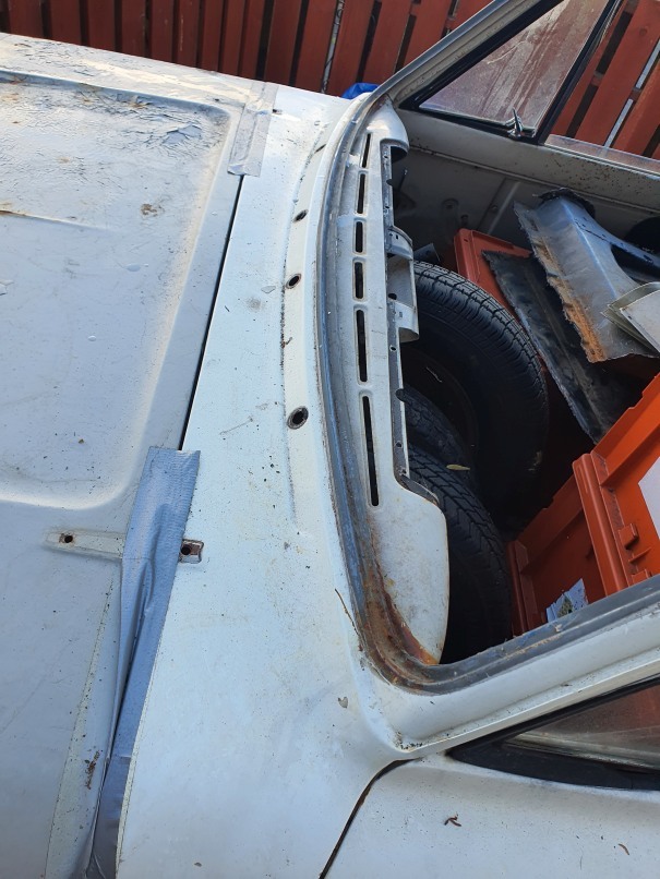

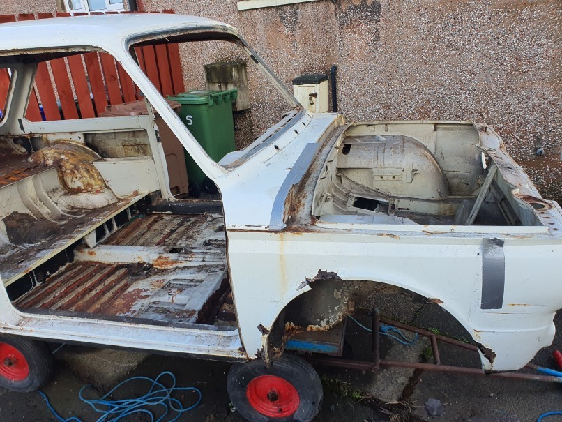

    And a few more pics the car overall looks like it is in reasonable condition but actually the floor edges have been repaired with B 7 Qs finest sticky stuff then dummied over with under seal. It is actually quite a good cover up ! and actually had even me fooled until I tried to scrape it off.
    So the restoration of this one went to back of the bus.
    Project for 2020 and the last imp I will be restoring ( in the world ever ! )

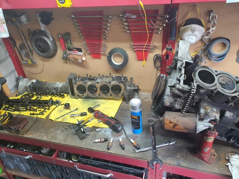

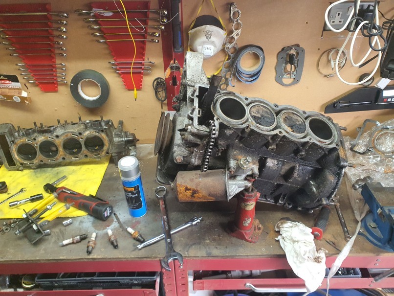

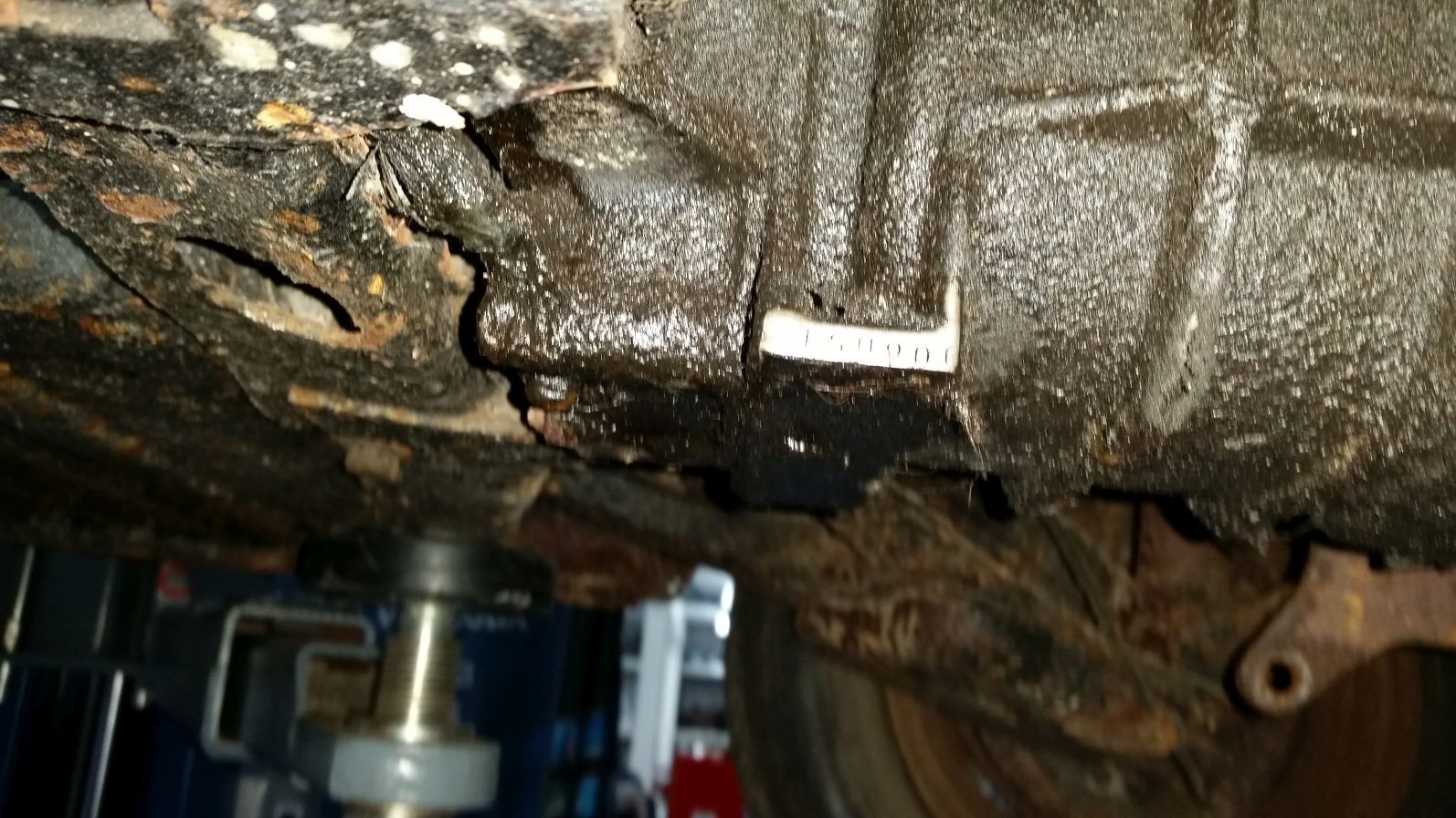

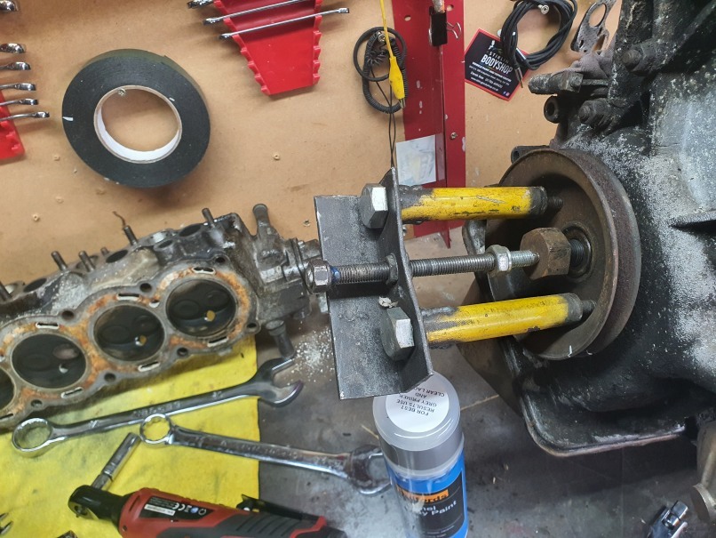

        Time to look at the engine that ahs been lying for so long
        Not good news, not sure if I will get away with the scoring but head bolt bosses on the block one needs attention.
        Clean up then check rings and bores. Looks like I will need to be hunting another curly engine though as this one might only be fit for a rebuild

          Decided to look at the engine that was on Doris
          Broken top of liners in that one although the crank looks OK even although -10.
          So thats the spare engines checked and no good
          Looks like I will need to go buy an engine now damn damn damn

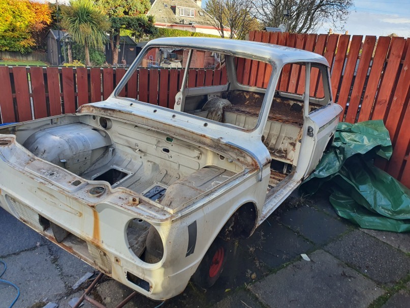

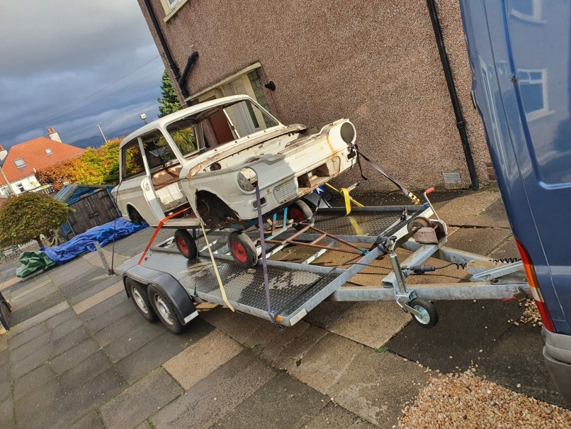

            Doris has seen the light

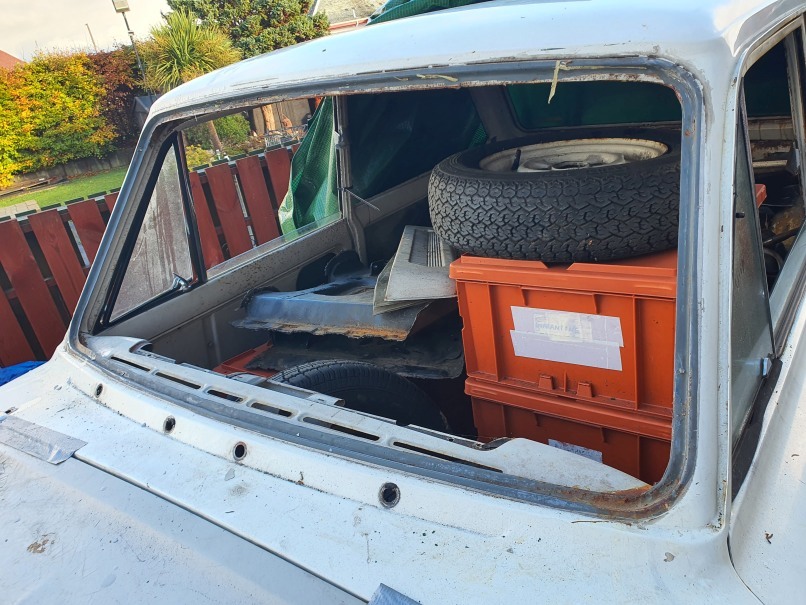

            After years of storage that is Doris emptied and torn down ready to trabnsport to the workshop

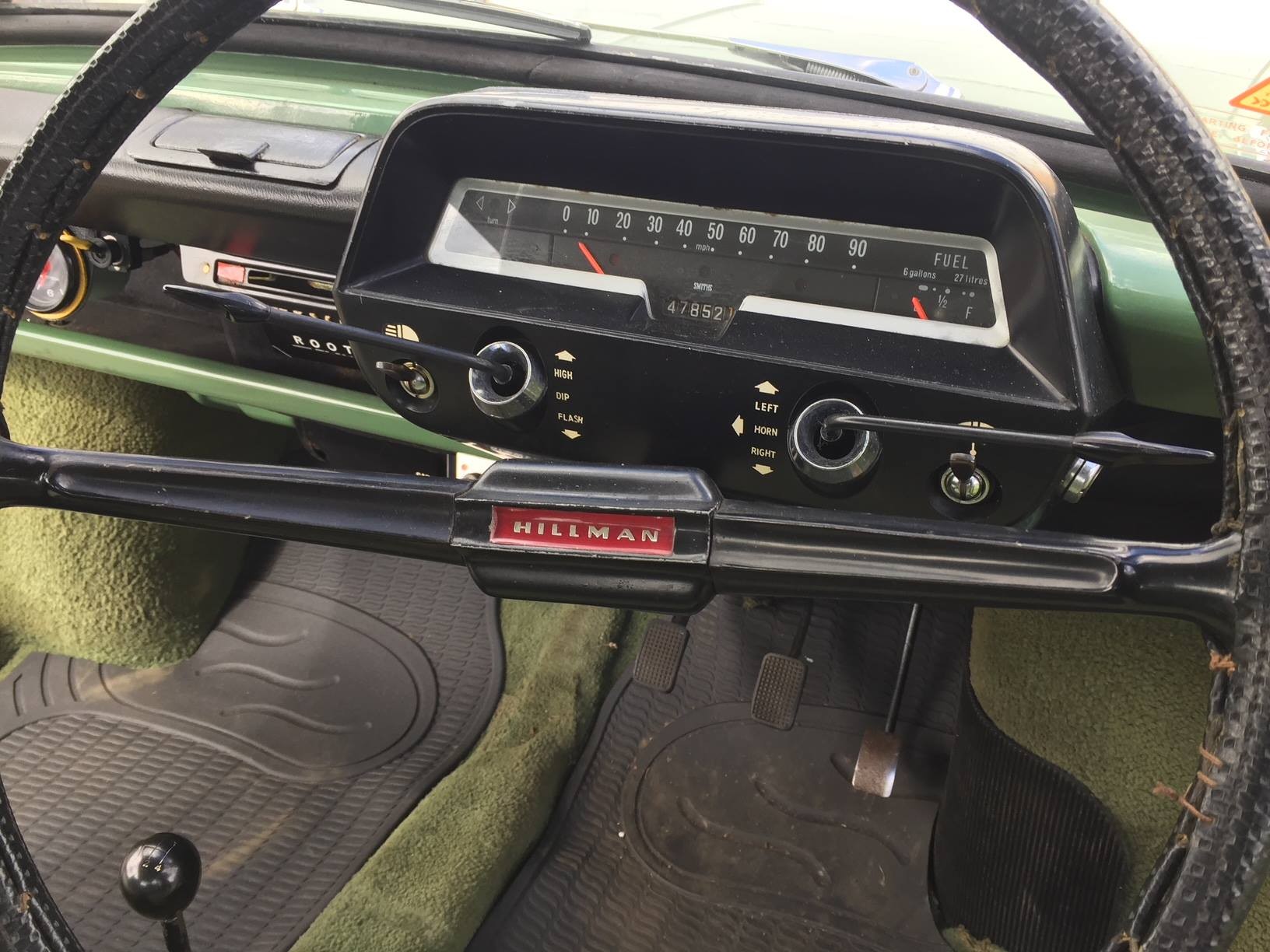

            Shocking how many parts are NOT on a Mk 1 imp compared to the Chamois model that we all love.
            No dash to speak of, no door cappings, no door cappings...... nout

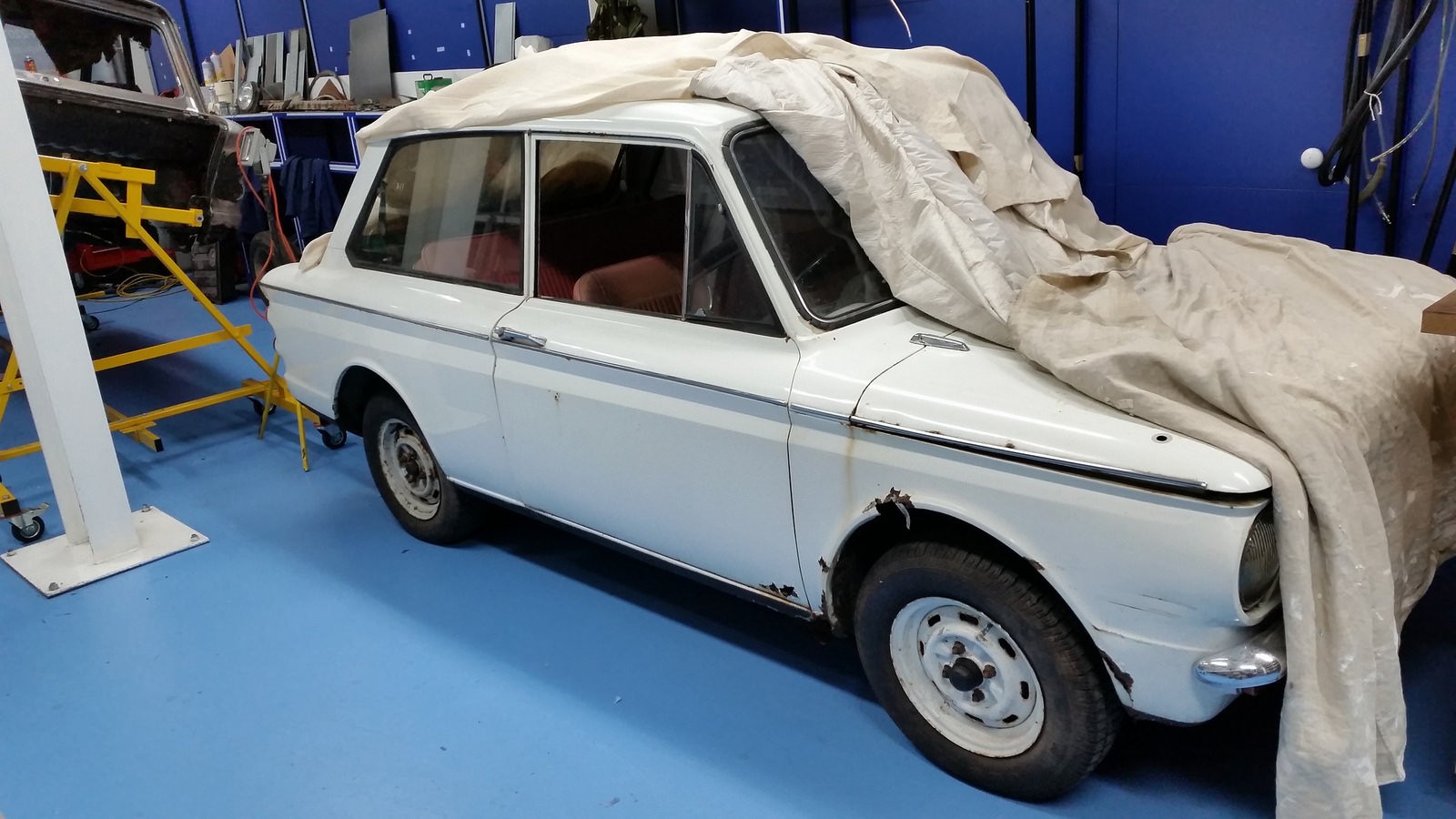

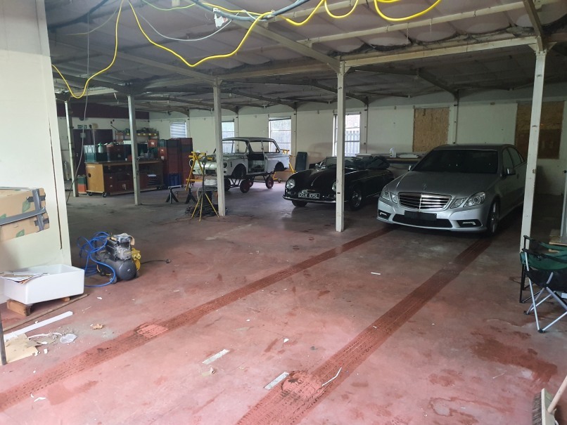

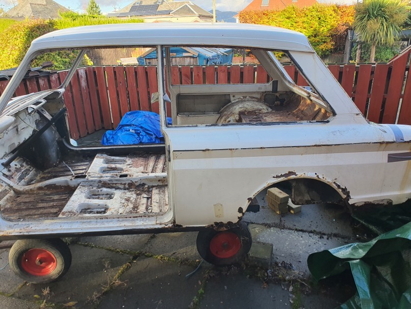

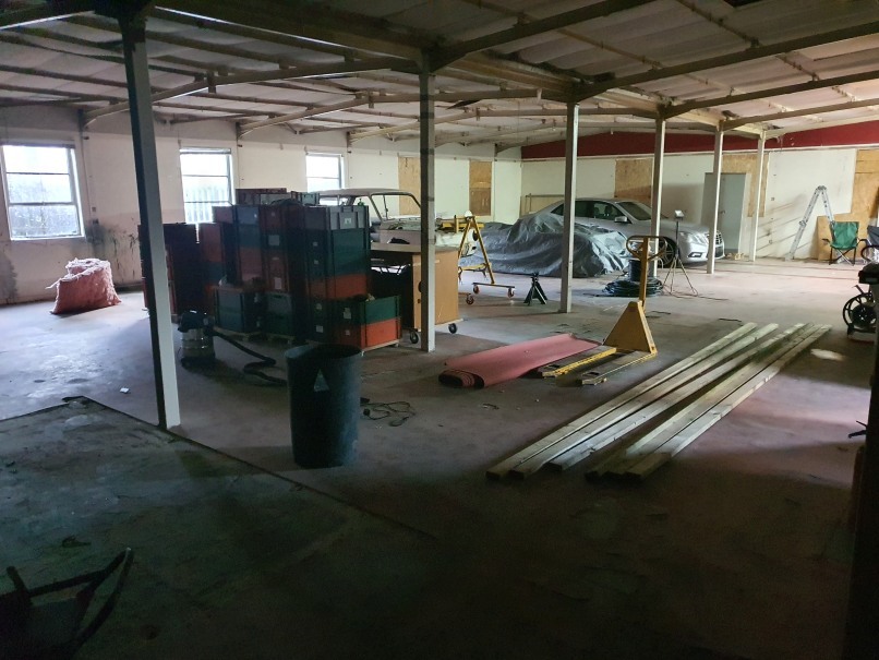

                    Doris has now landed in the workshop
                    The workshop is pretty much "work in progress" like the car itself
                    Click image for larger version  Name:	20221108_124148.jpg Size:	195.0 KB ID:	20409

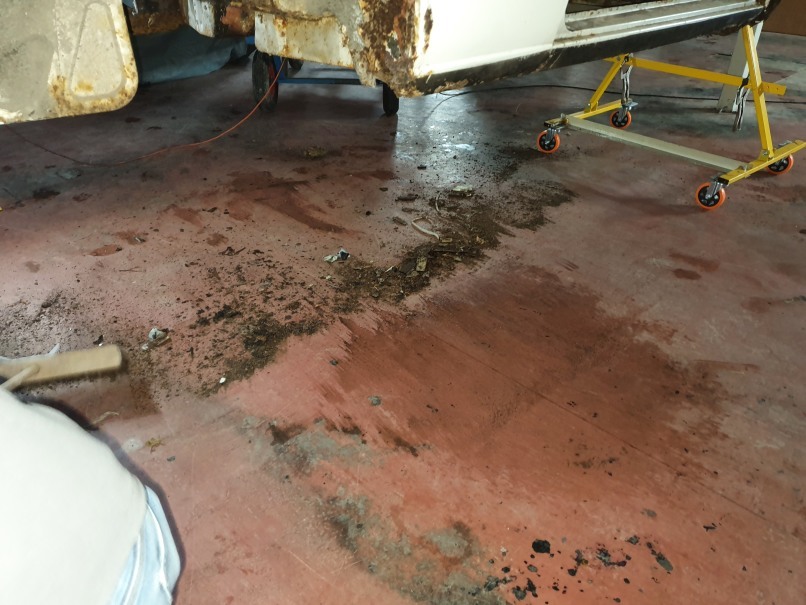

                    And of course the imp leaves a mess wherever it goes and needs swept up
                    Click image for larger version  Name:	20221108_130906.jpg Size:	188.0 KB ID:	20408

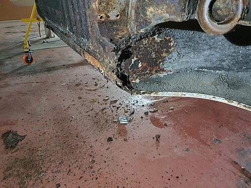

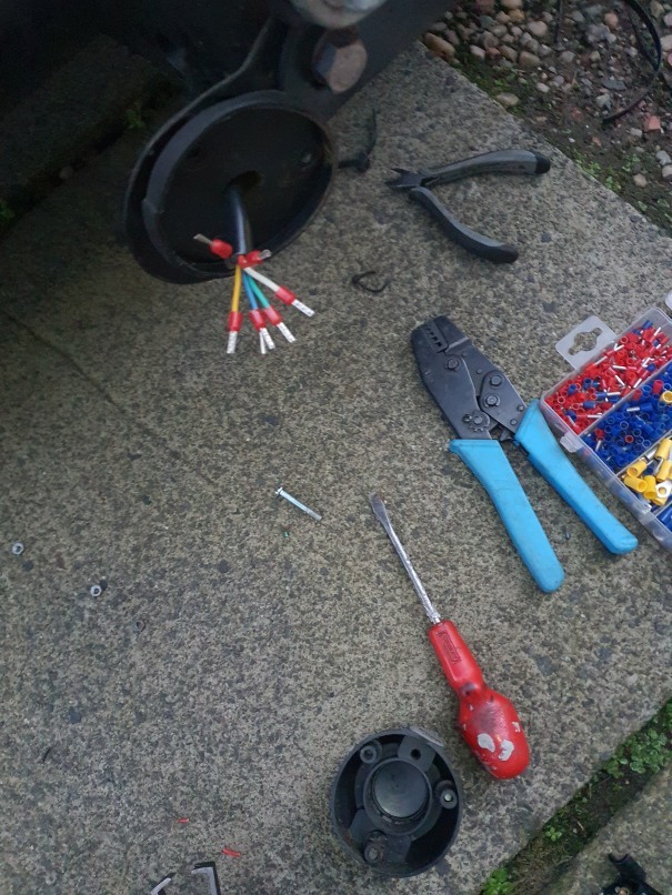

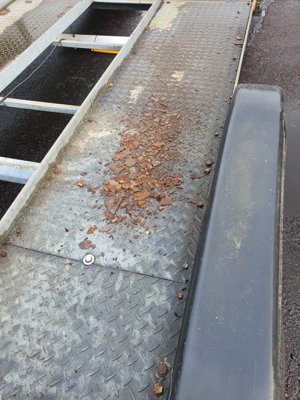

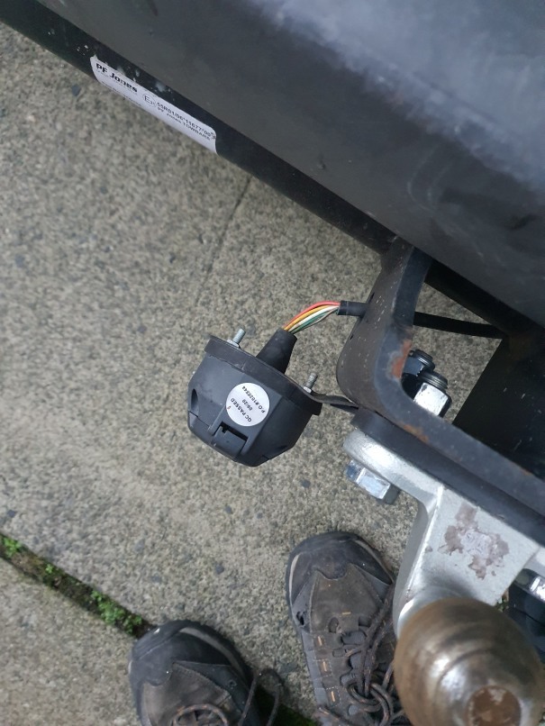

                    Wondered why the lights on trailer failed, seems I must have bent the socket or it got fouled
                    Click image for larger version  Name:	20221108_161724.jpg Size:	120.3 KB ID:	20406
                    Click image for larger version  Name:	20221108_162724.jpg Size:	177.8 KB ID:	20407
                    Man why do companies just stuff wires in a hole and screw down on them breaking strands, cant have that can we

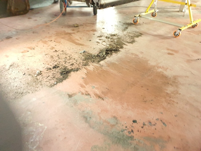

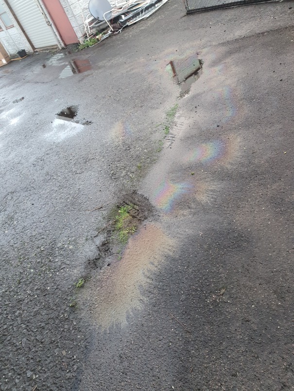

                    Plus seems I have sprung a leak
                    Click image for larger version  Name:	20221108_155803.jpg Size:	206.1 KB ID:	20405

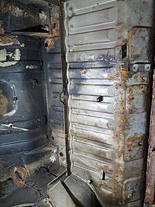

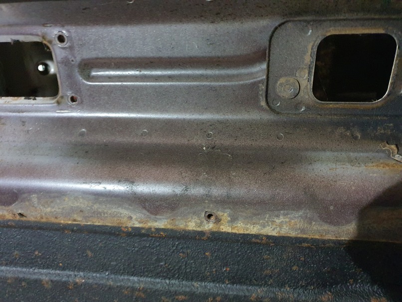

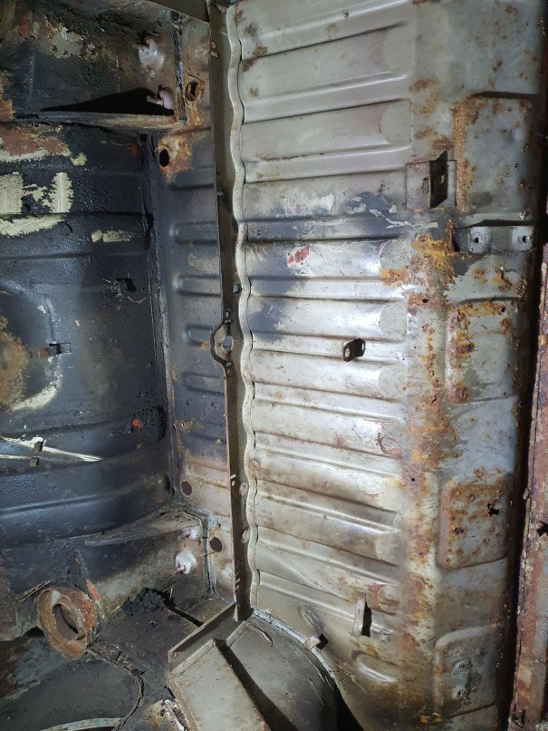

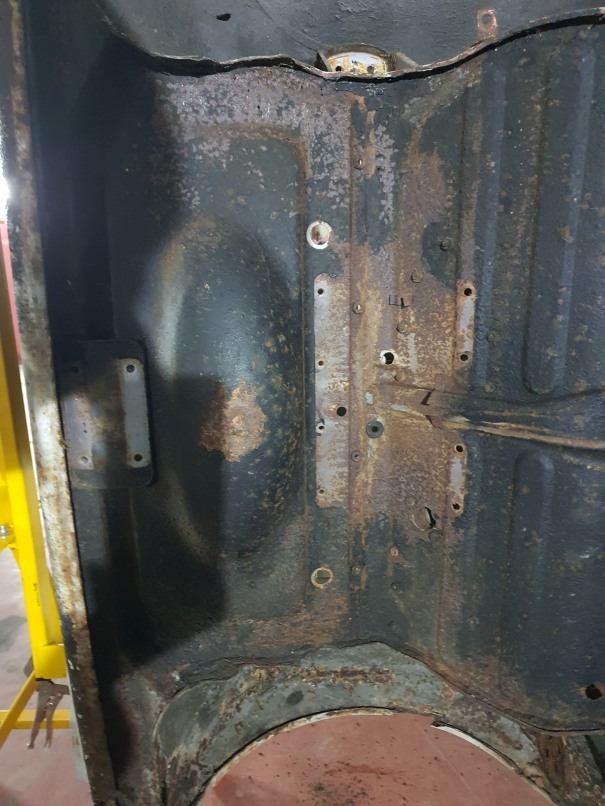

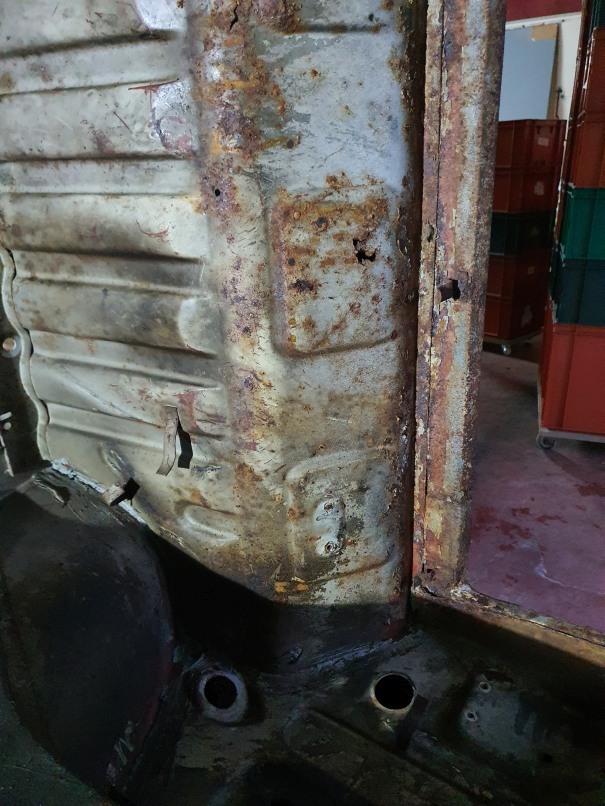

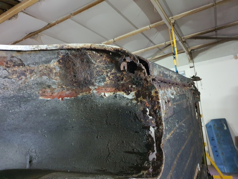

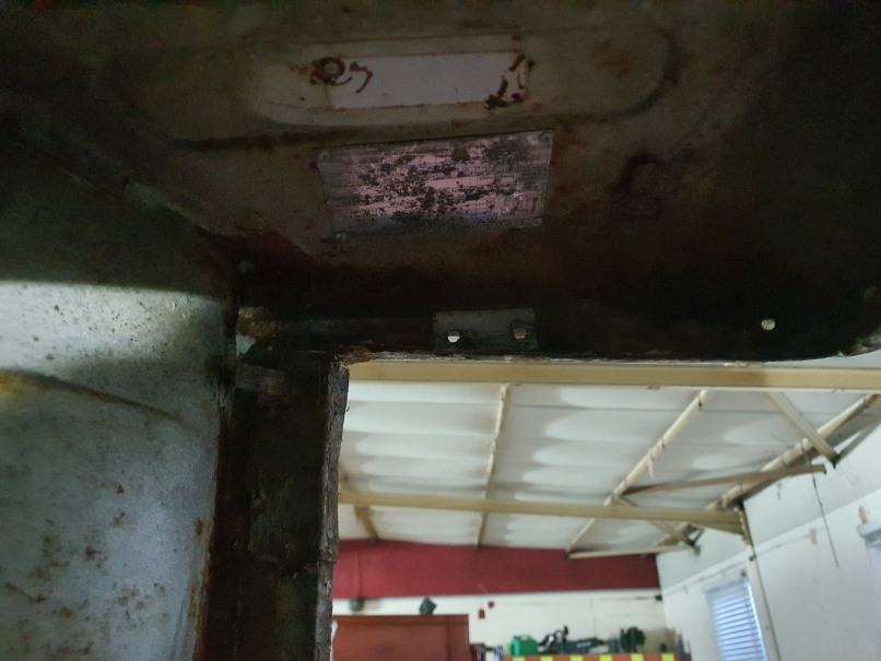

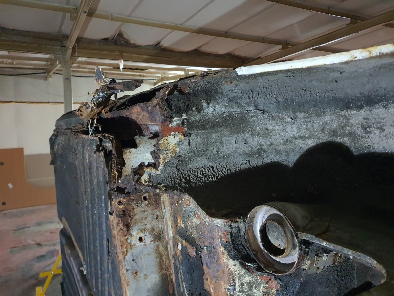

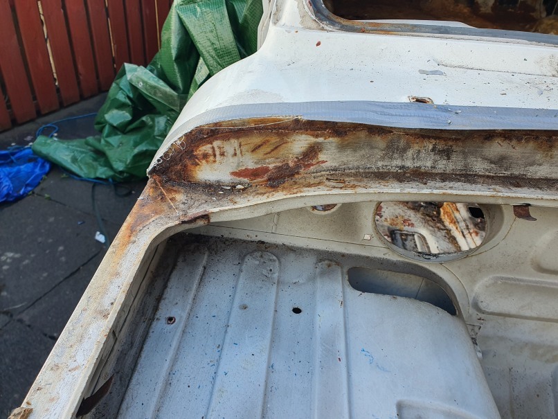

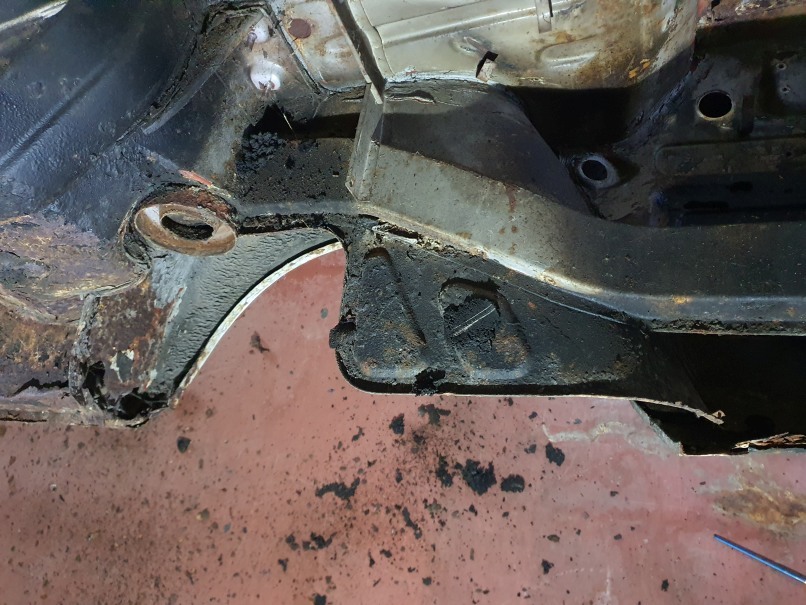

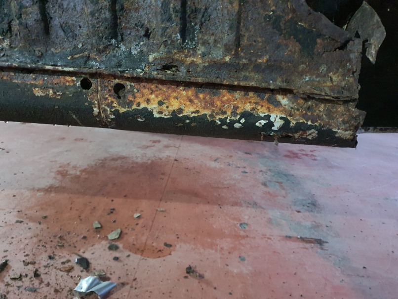

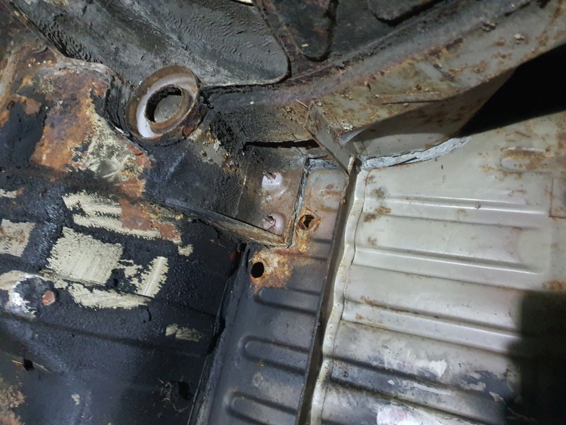

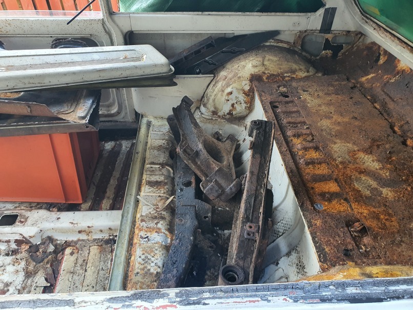

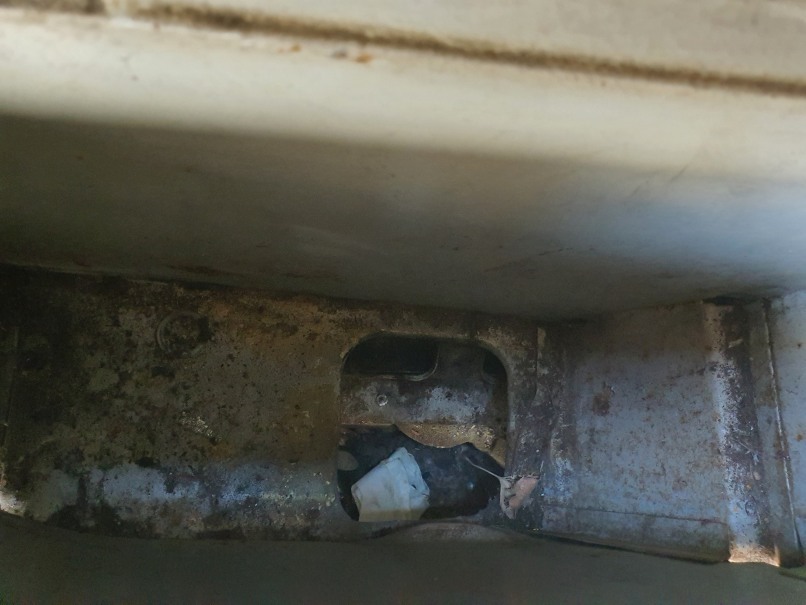

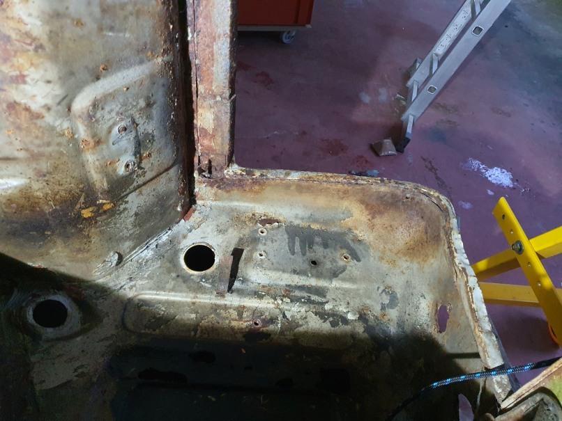

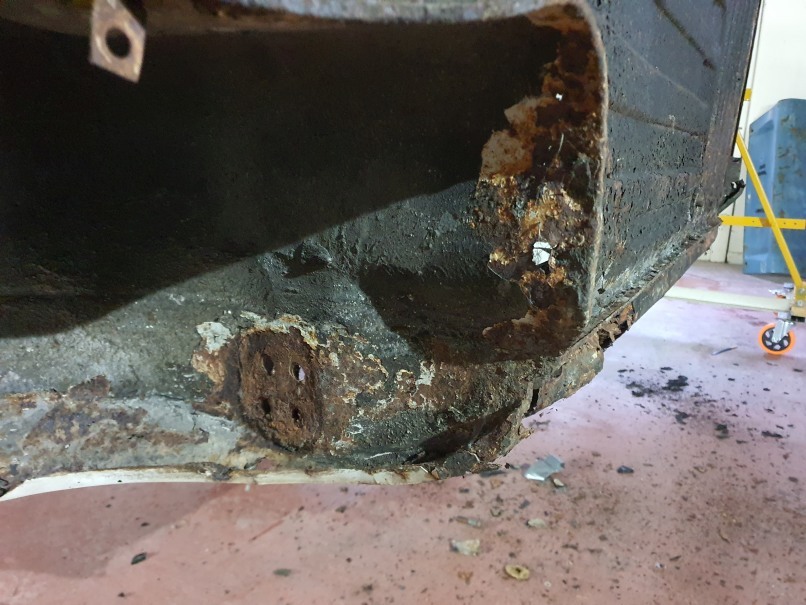

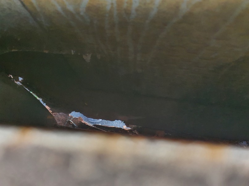

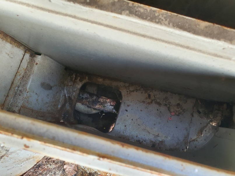

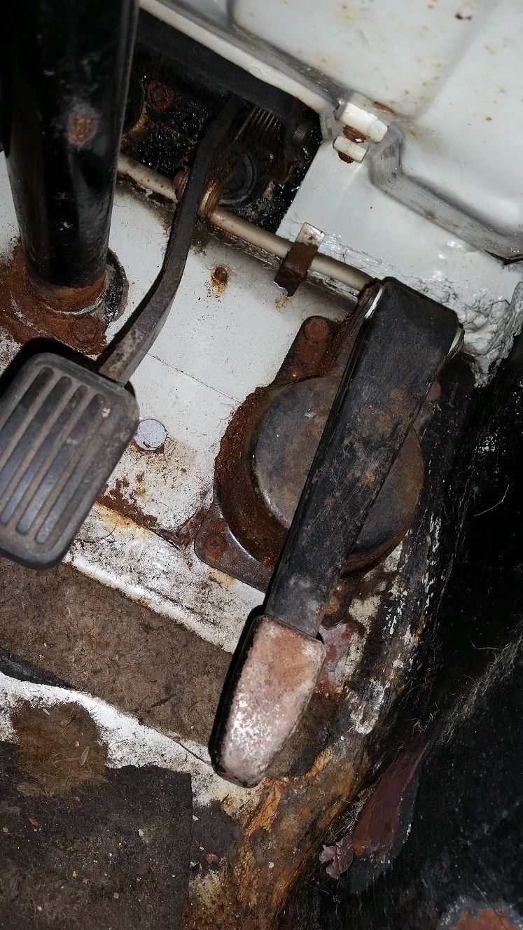

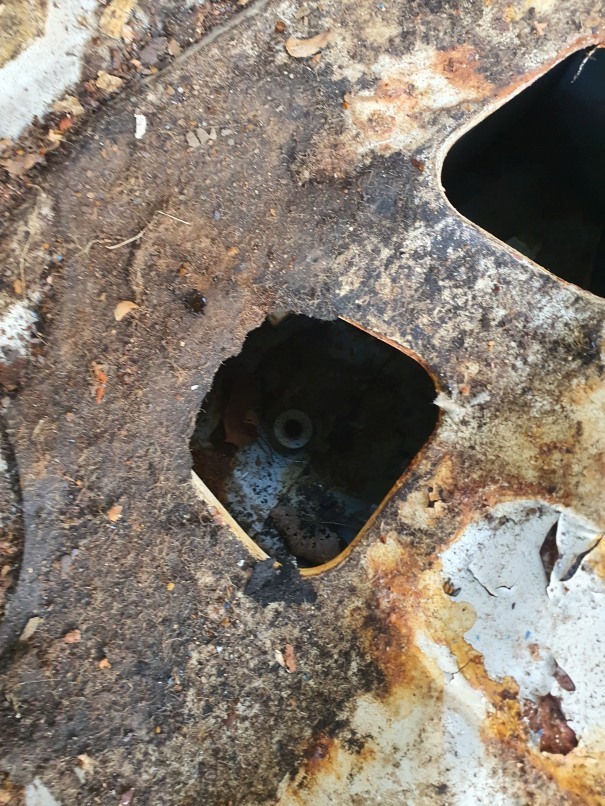

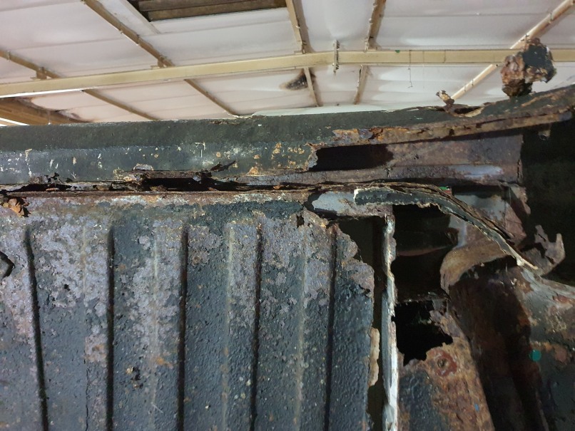

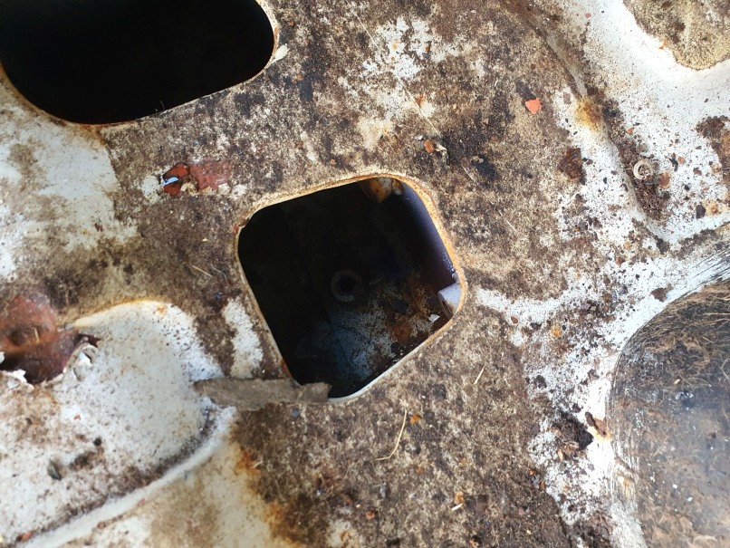

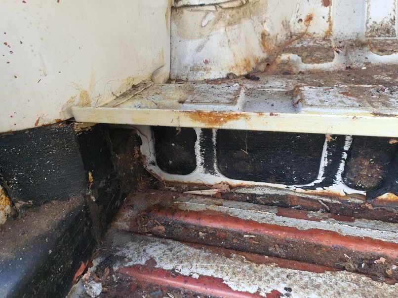

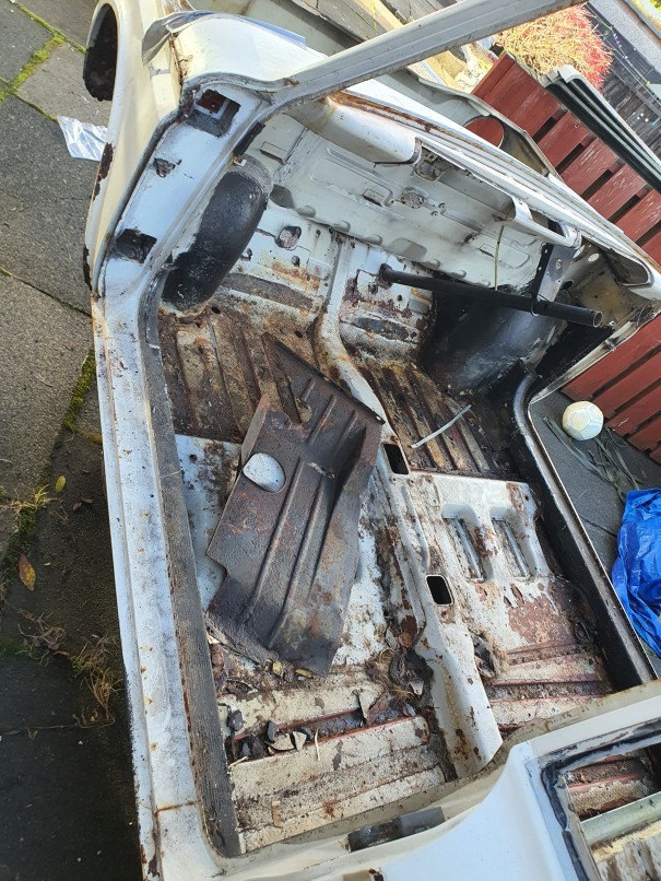

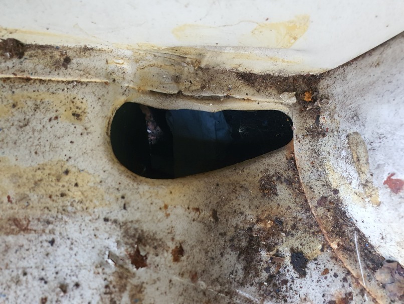

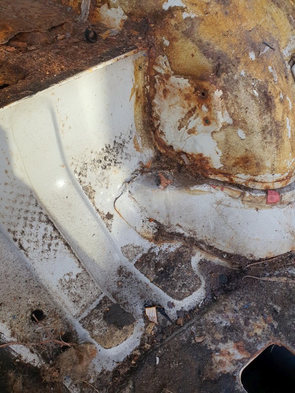

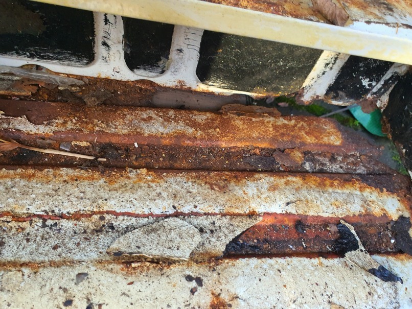

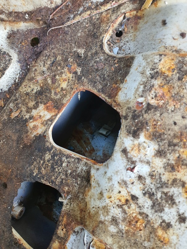

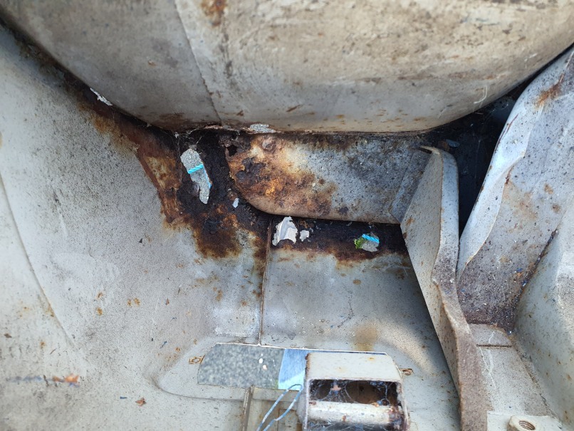

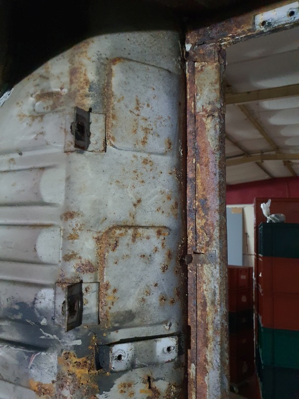

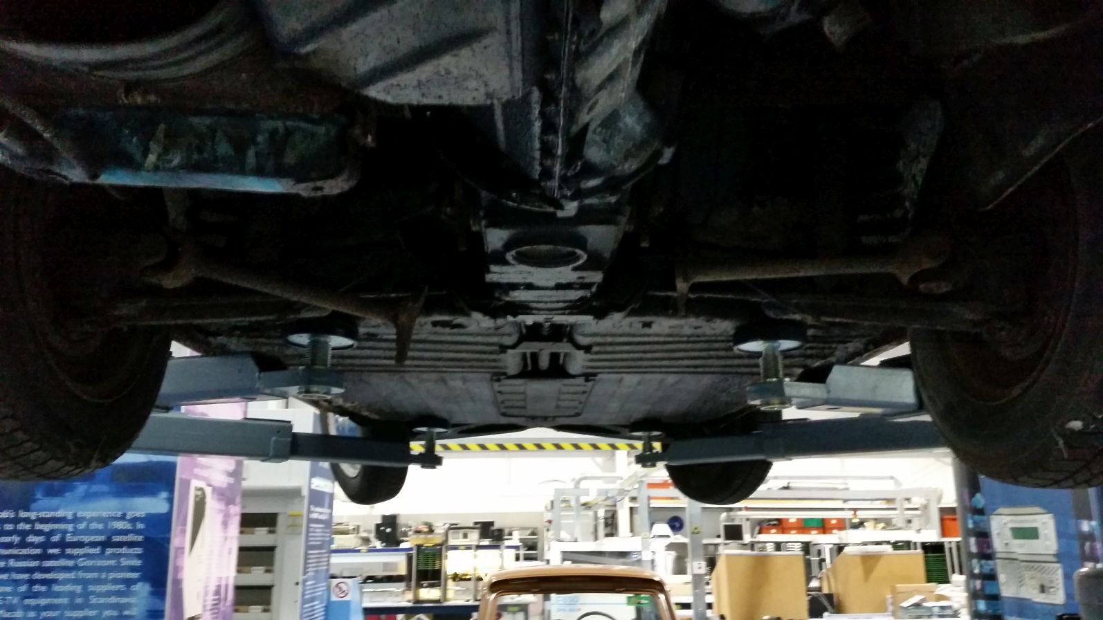

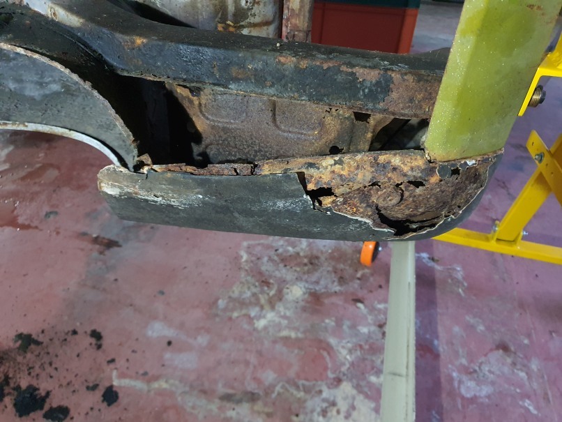

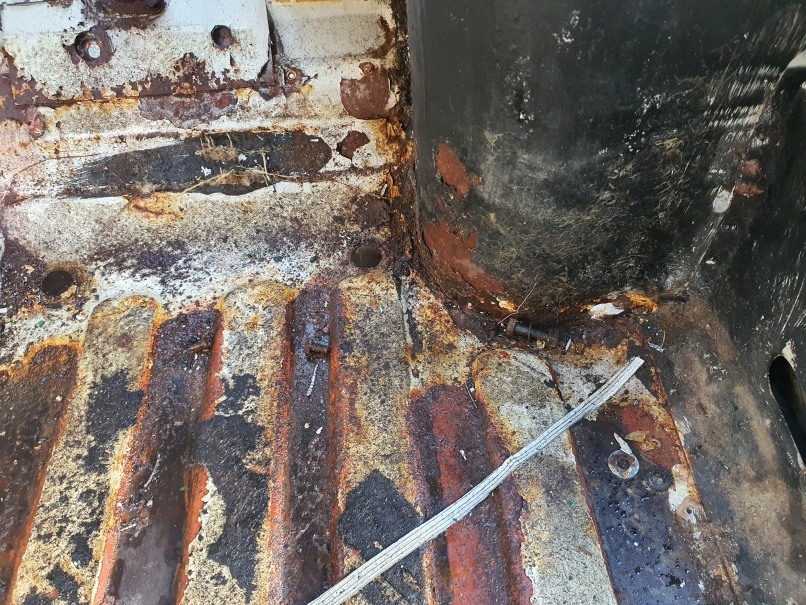

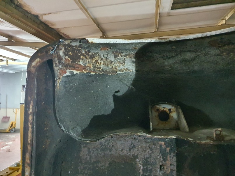

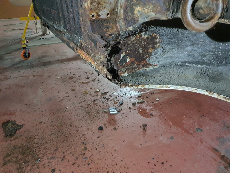

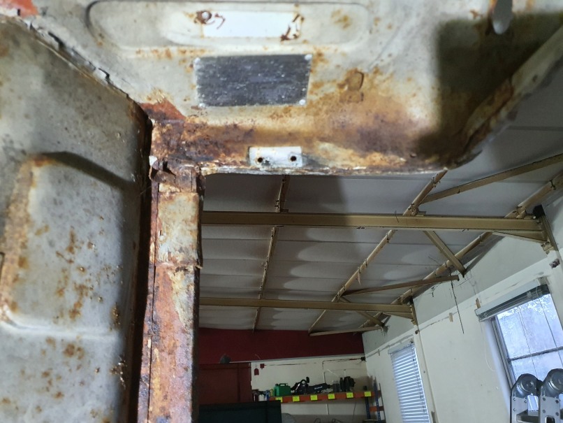

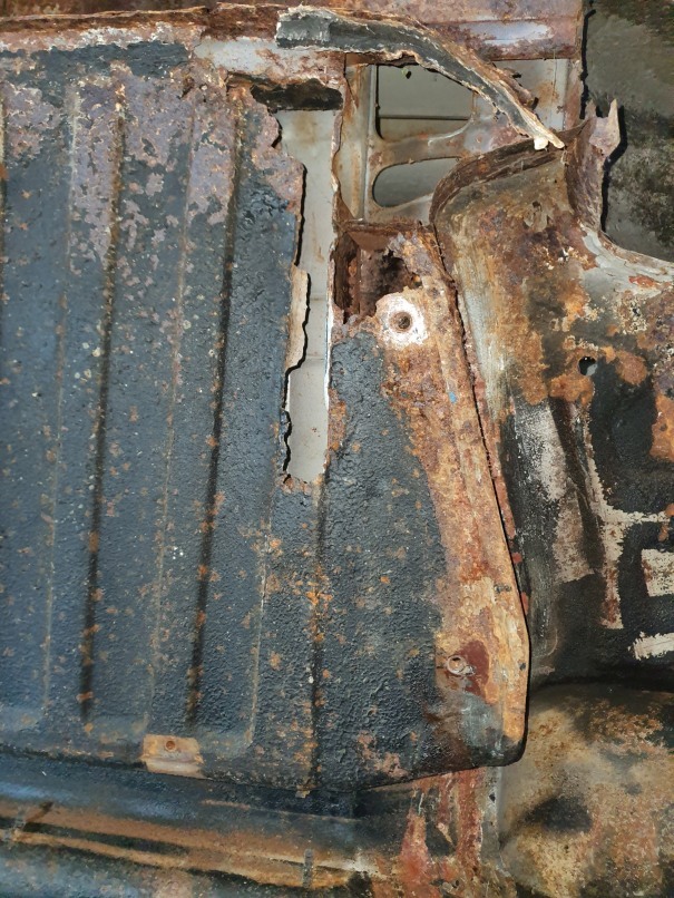

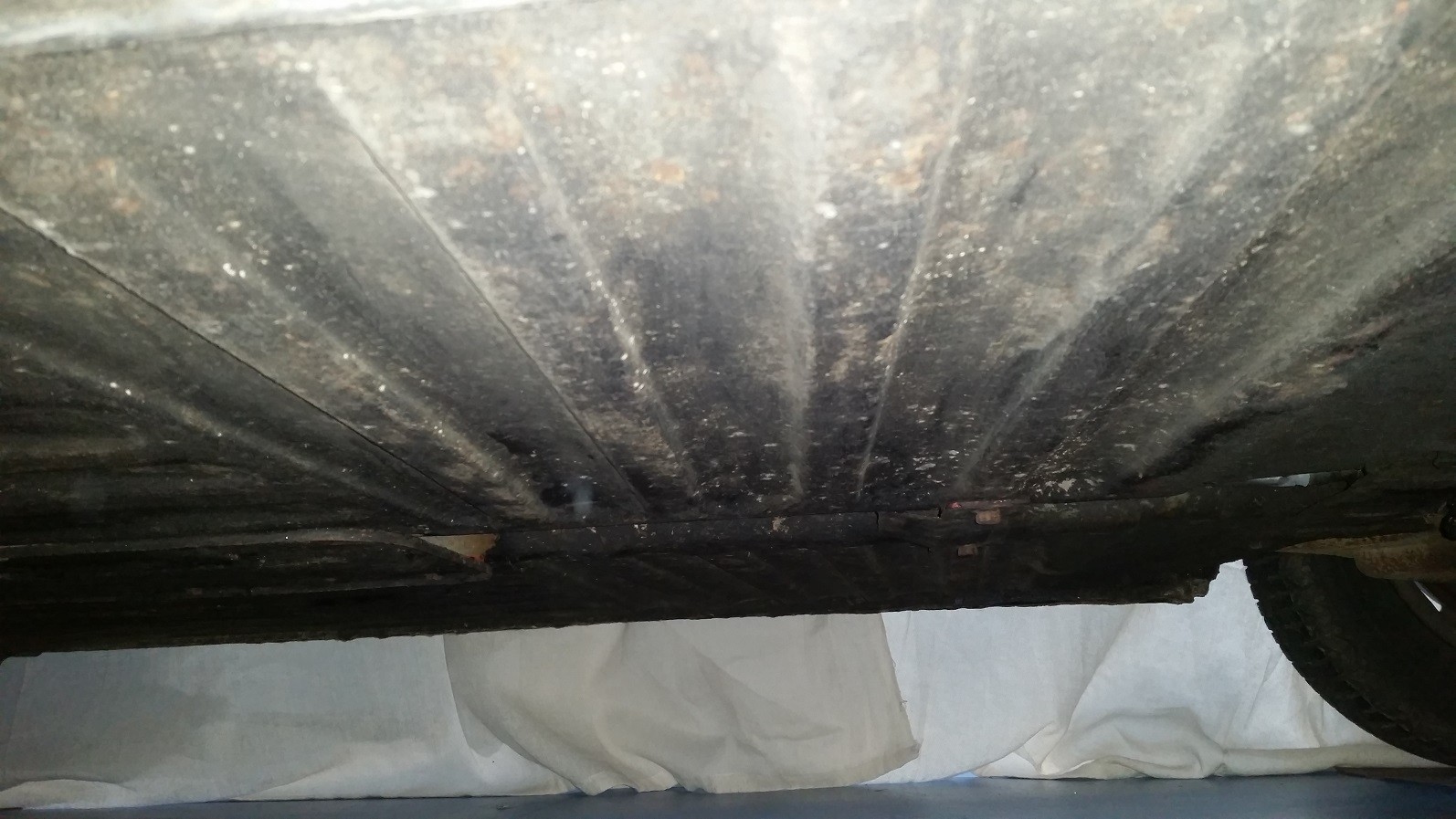

                      Primary survey now done after getting it on the jig. Not as bad as I thought, all the usual suspects
                      The passenger rear floor was as bad as though through and the usual sweeping the car off the floor

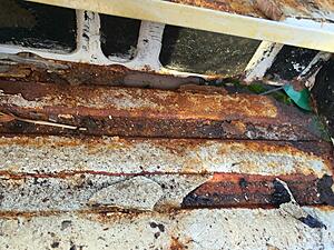

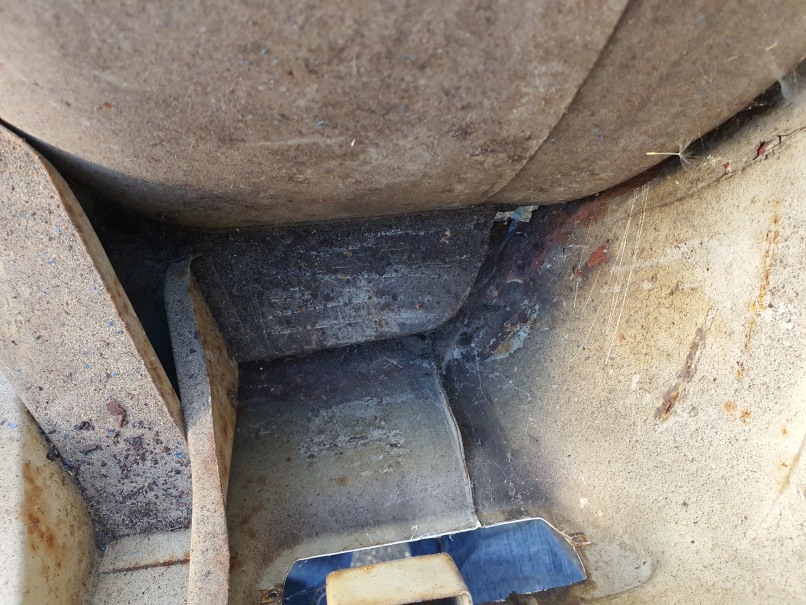

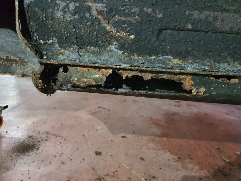

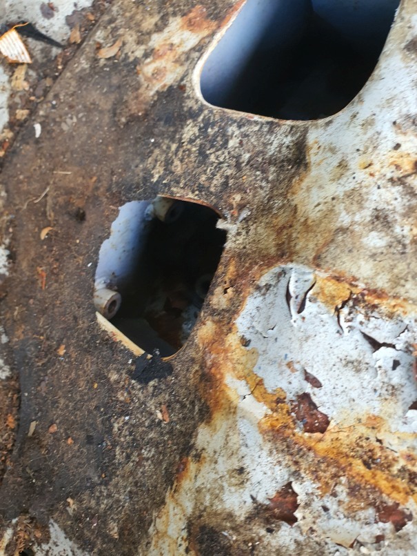

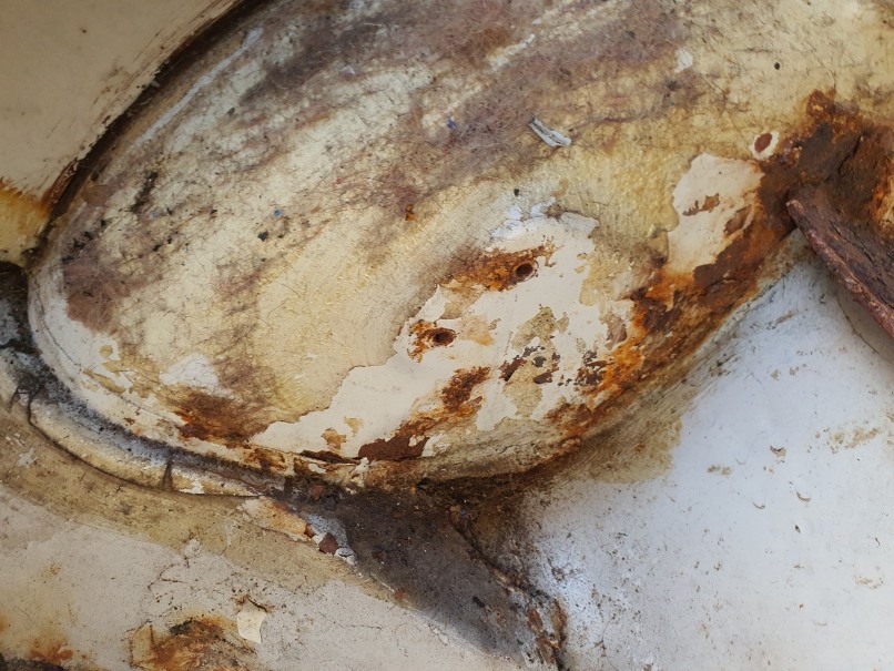

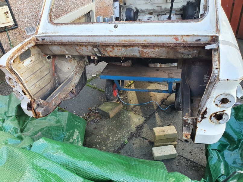

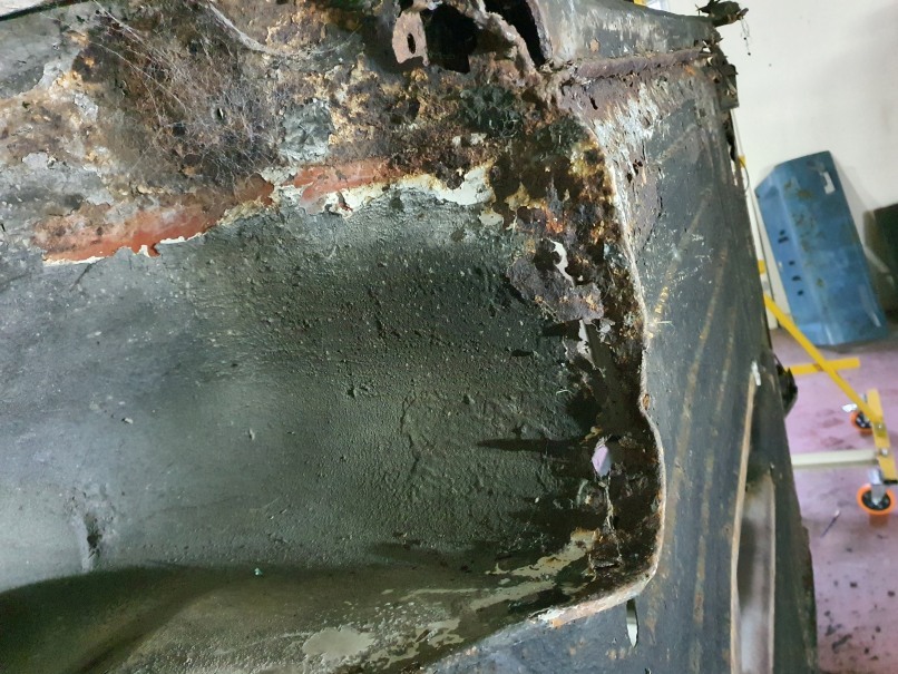

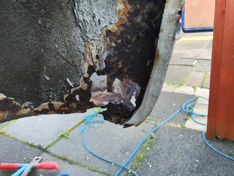

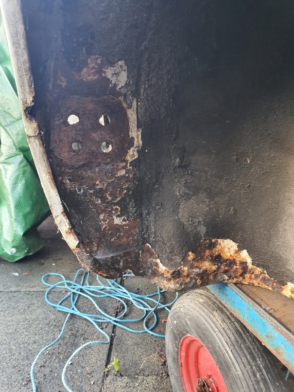

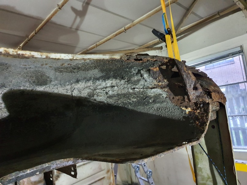

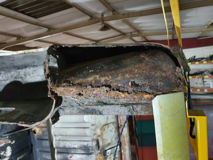

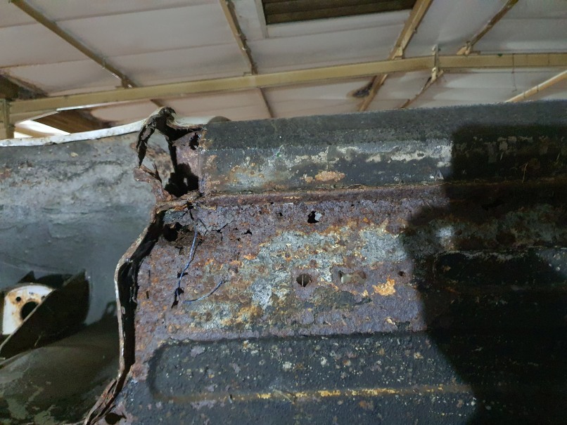

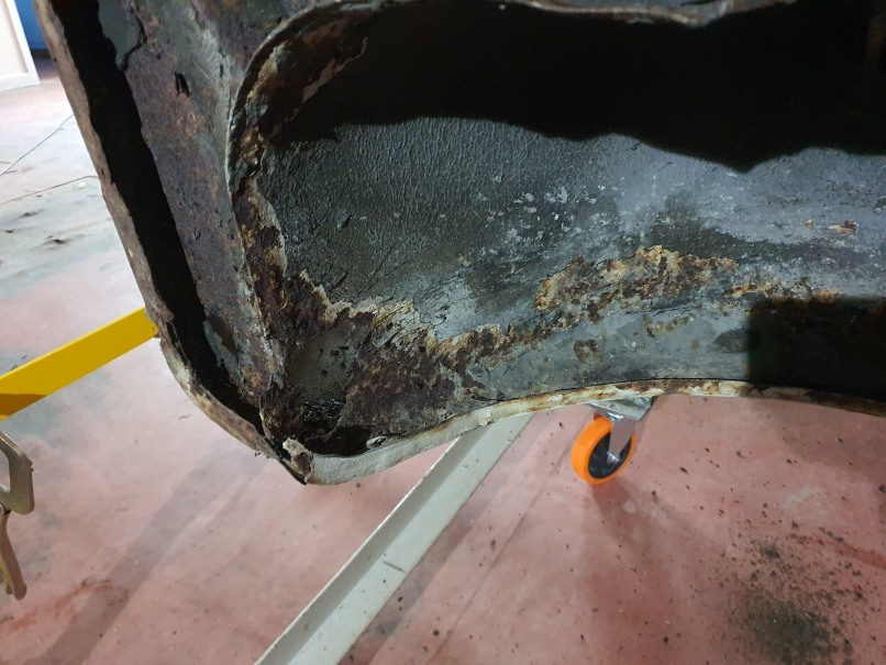

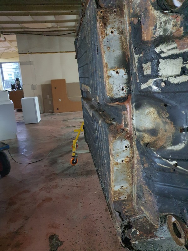

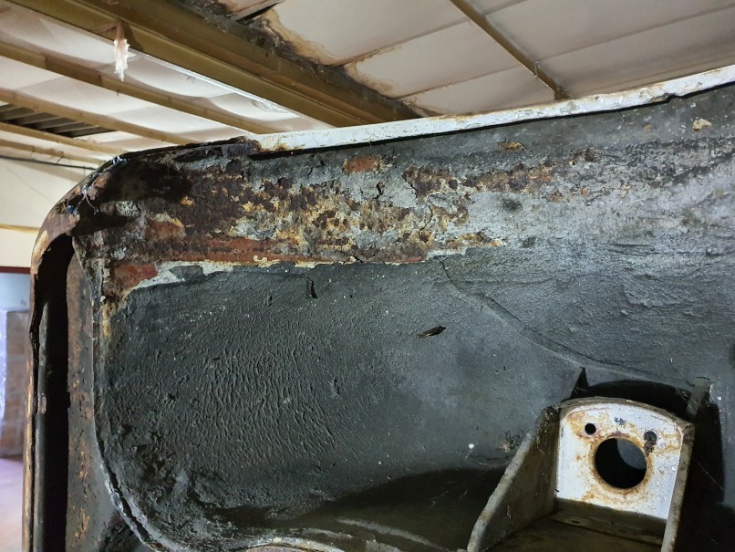

                      And onto the body when tilted

                        #12

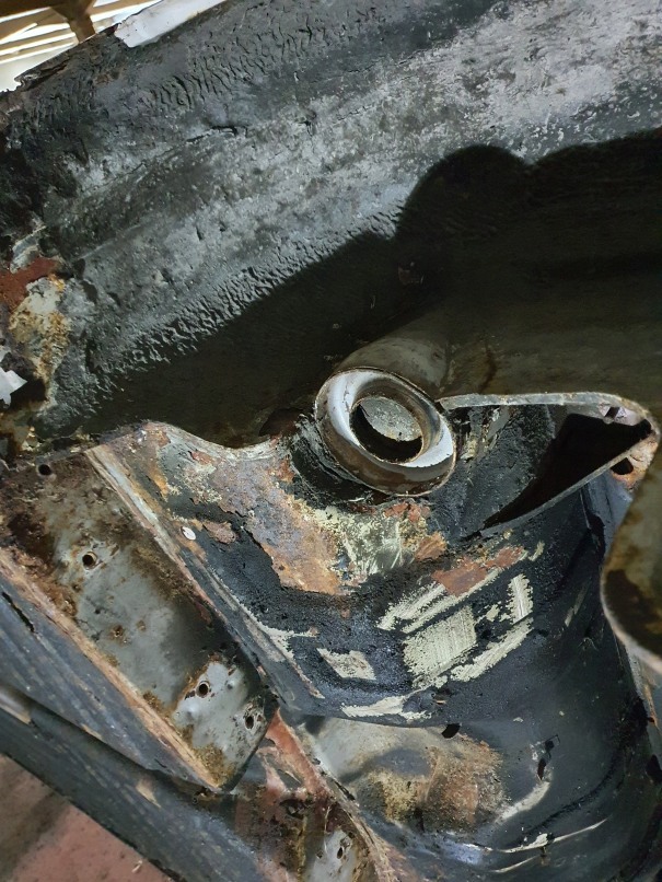

                        And always more

                          #13

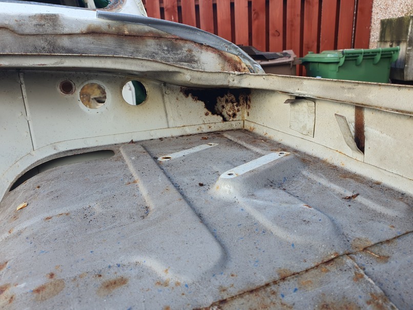

                          And more of the same born stuff

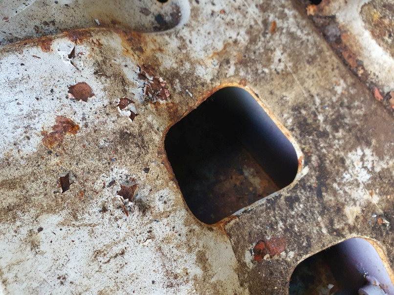

                          Very surprising but the front valance is nowehere near as bad as I though, certainly not worth a 1/2 valance or the full NOS front panel I have so thats 2 spare panels to sell on
                          Click image for larger version  Name:	20221117_152351.jpg Size:	140.4 KB ID:	20492
                          Click image for larger version  Name:	20221117_152032.jpg Size:	121.7 KB ID:	20493
                          Click image for larger version  Name:	20221117_152223.jpg Size:	171.3 KB ID:	20494

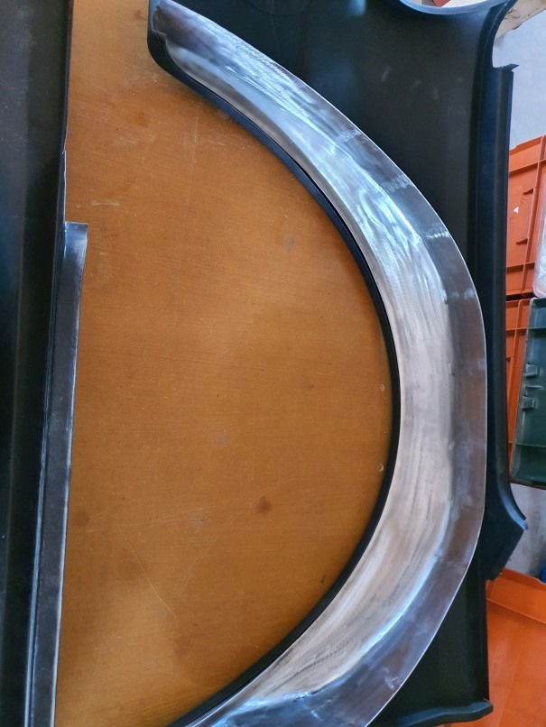

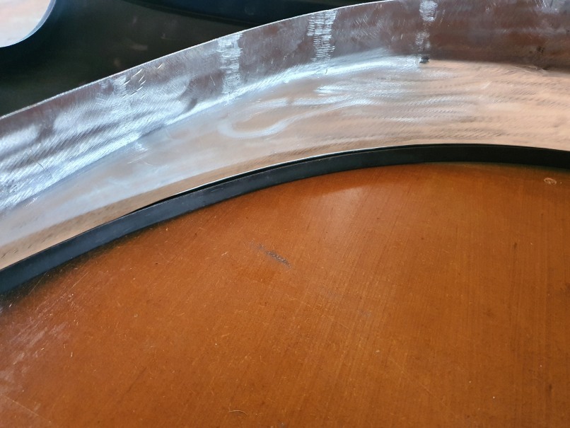

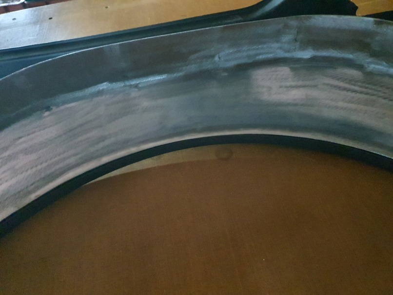

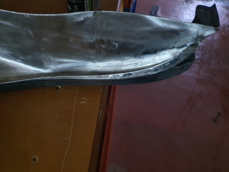

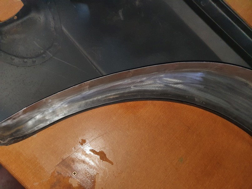

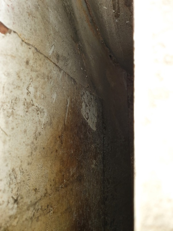

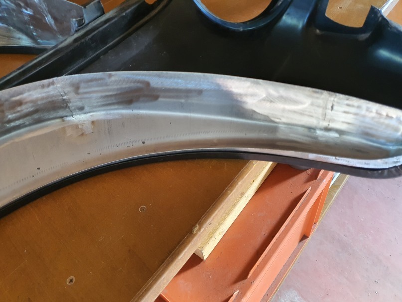

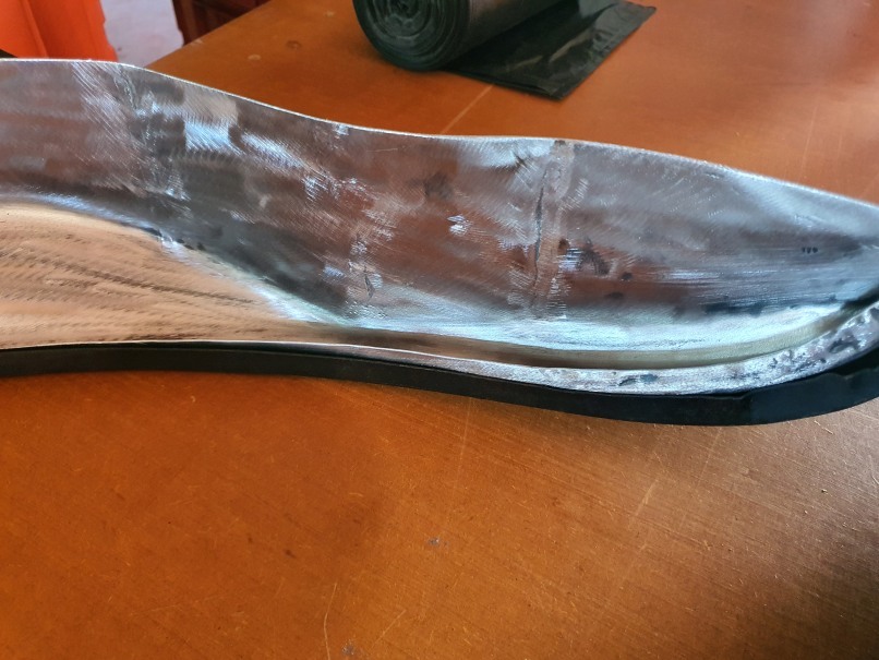

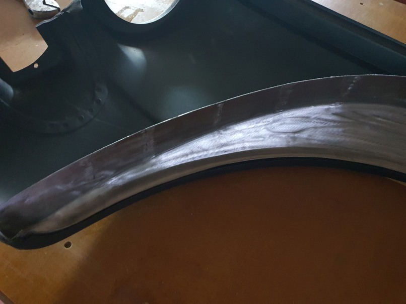

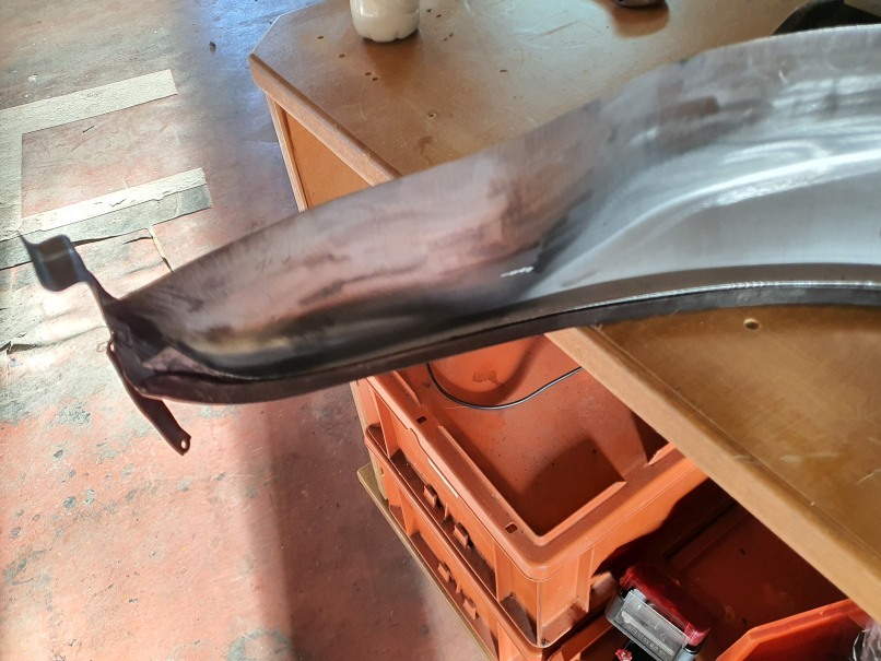

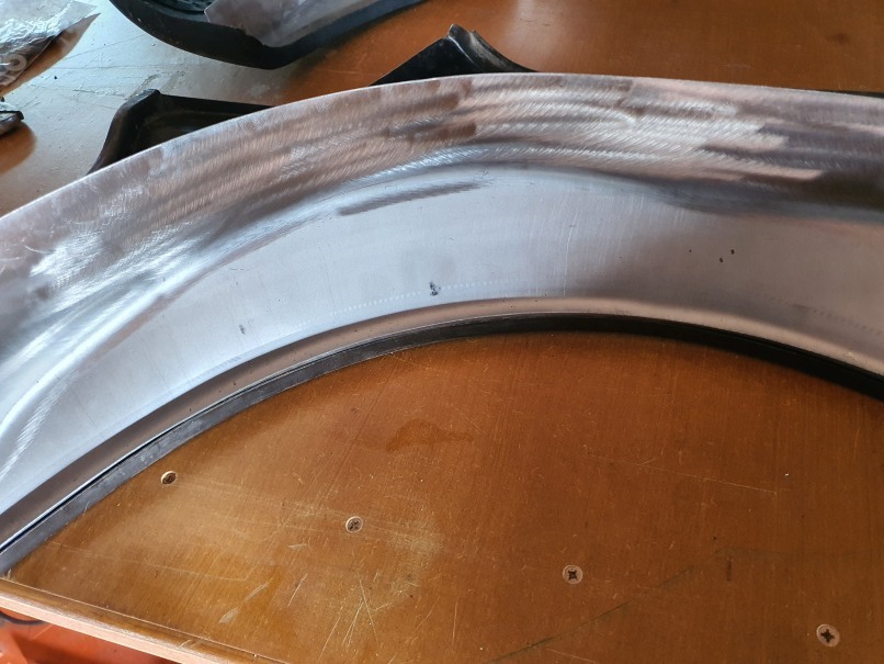

                            The inner wheel tub outer repair sections also arrived from ESP so tried them against the factory front wings.
                            A few small tweaks and at least the inner arch section will seat perfectly, a lot better than the one I tried a few years back, we really are starting to get much better quality panel availability now

                              #15
                              Hey John,
                              No need to ask what you will be doing over the festive period then? ,
                              Think you are going to be kept very busy with the cutting disc, grinder and welder for a while.
                              Good luck with Doris.
