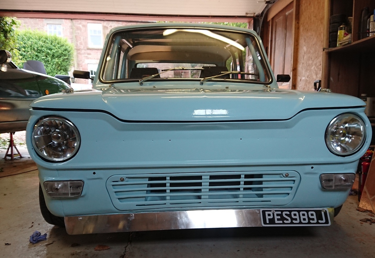

Fitted the from bib spoiler I made up and the number plate.. (A bit wee possibly officer???)
