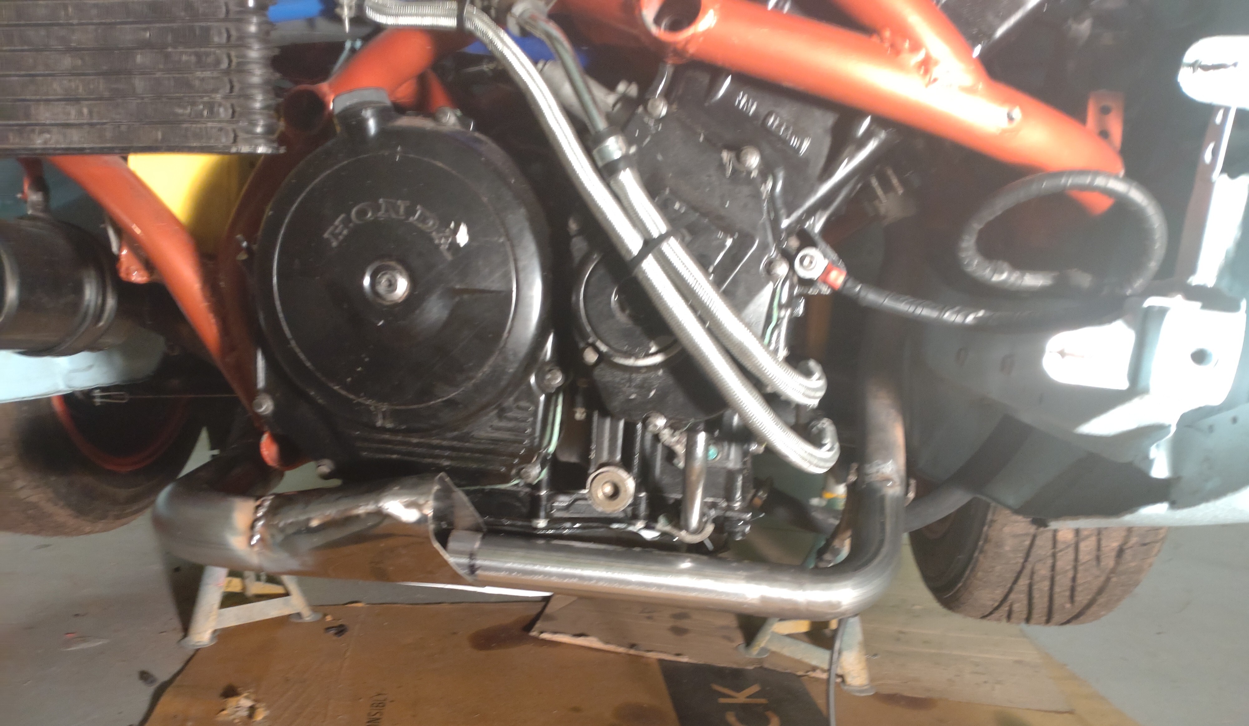

I completely understand where your coming from and your concerns of modifying away from the manufacturers design. Some of your thoughts I have also had and agree with. The volume I have taken out from the bottom where I have cut is replaced by the extension to the left side on the first photo above where I have drilled more holes for oil to flow and for the shortened pickup to be repositioned. The original pick up is like an S shape as it comes from the left to the deeper part of the sump(the removed part).This will be shortened but with the pipe being vertical instead of the S shape With me shortening the sump and using the left hand side I have actually gained volume for the oil capacity not by much but around 300ml. Sump volume has increased slightly which is a wee win.

Rains the engine is out of the question as I have no room above the engine with the cars b /airbox being close to the underside of the rear window. A sump guard is an option and can still be done this way but would reduce the ground clearance by a bit below 4" that I have at the moment for the sump but could offer protection all the same with considerate driving.

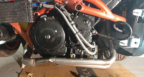

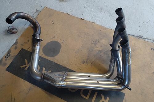

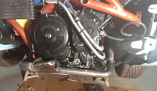

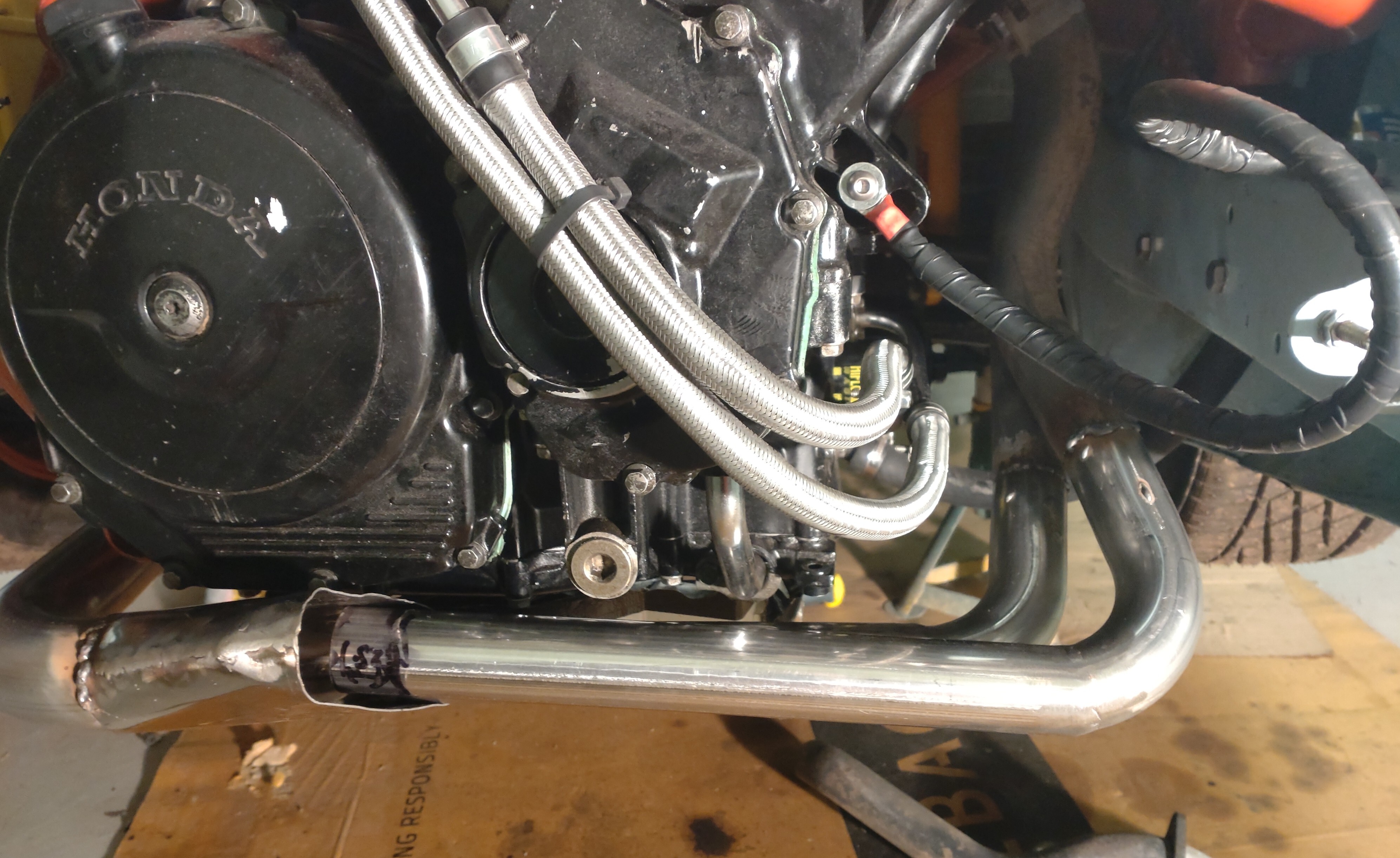

One thing that has to change is the exhaust as this does sit very low at 3" of clearance and already rubs a bit on the ground when there is a slight incline which I hope to be tackling sometime next week.
I will post photos of the clearance for some thoughts.
