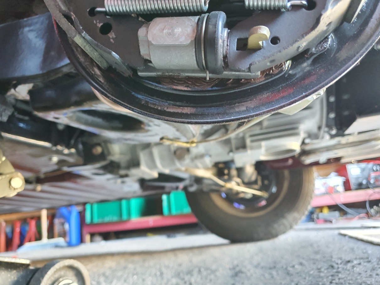

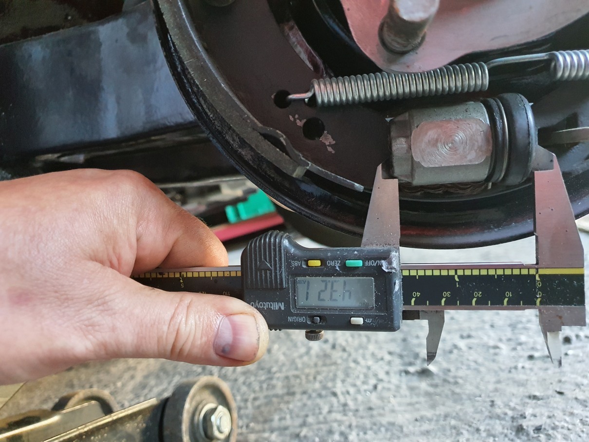

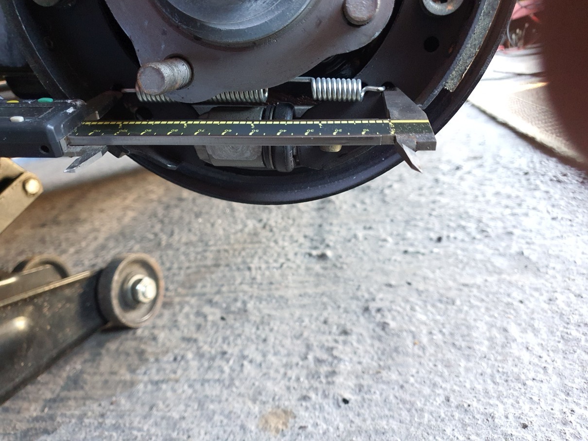

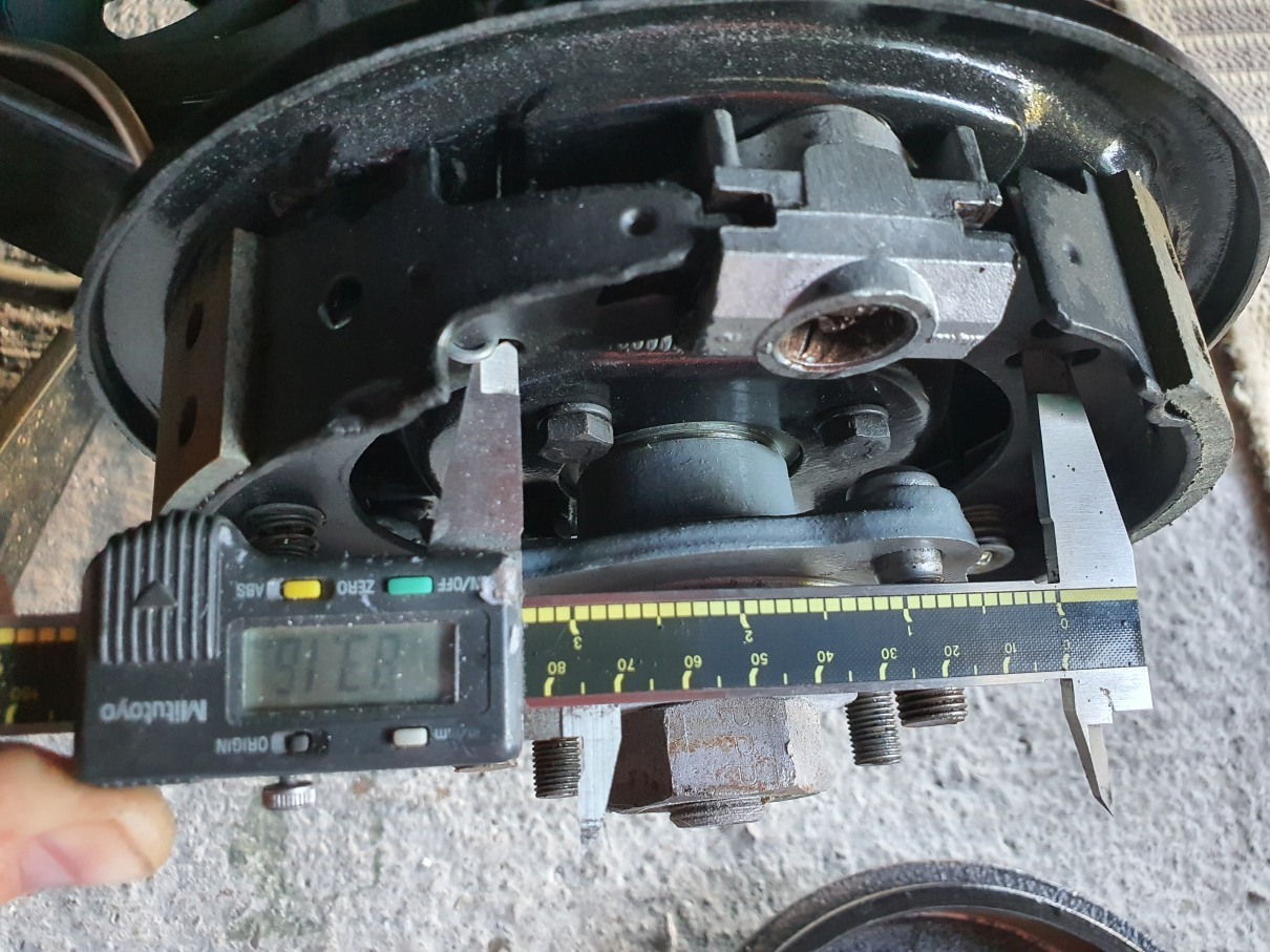

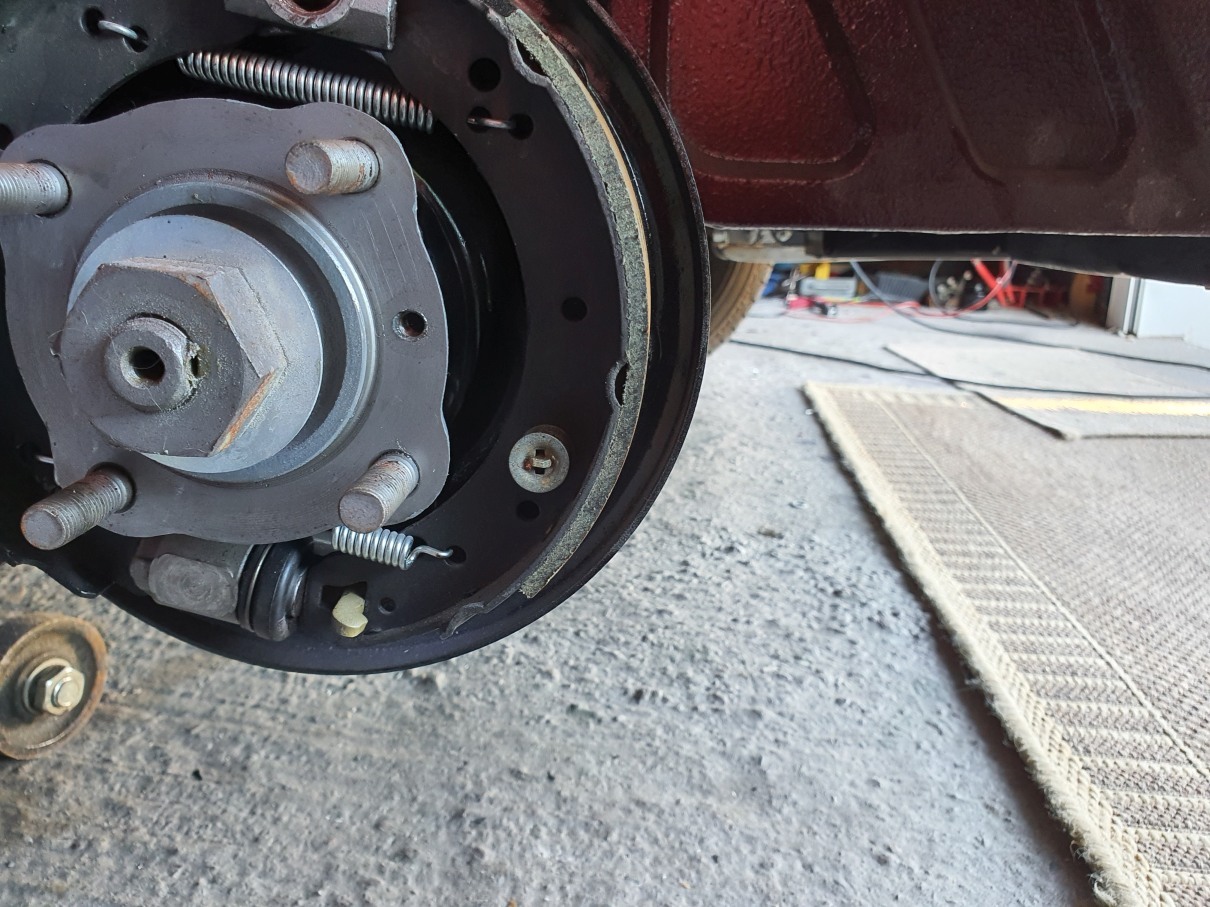

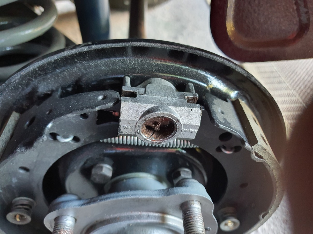

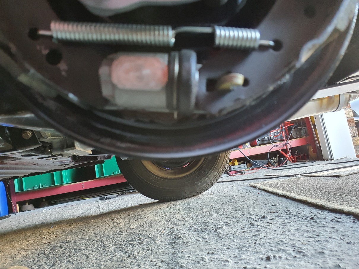

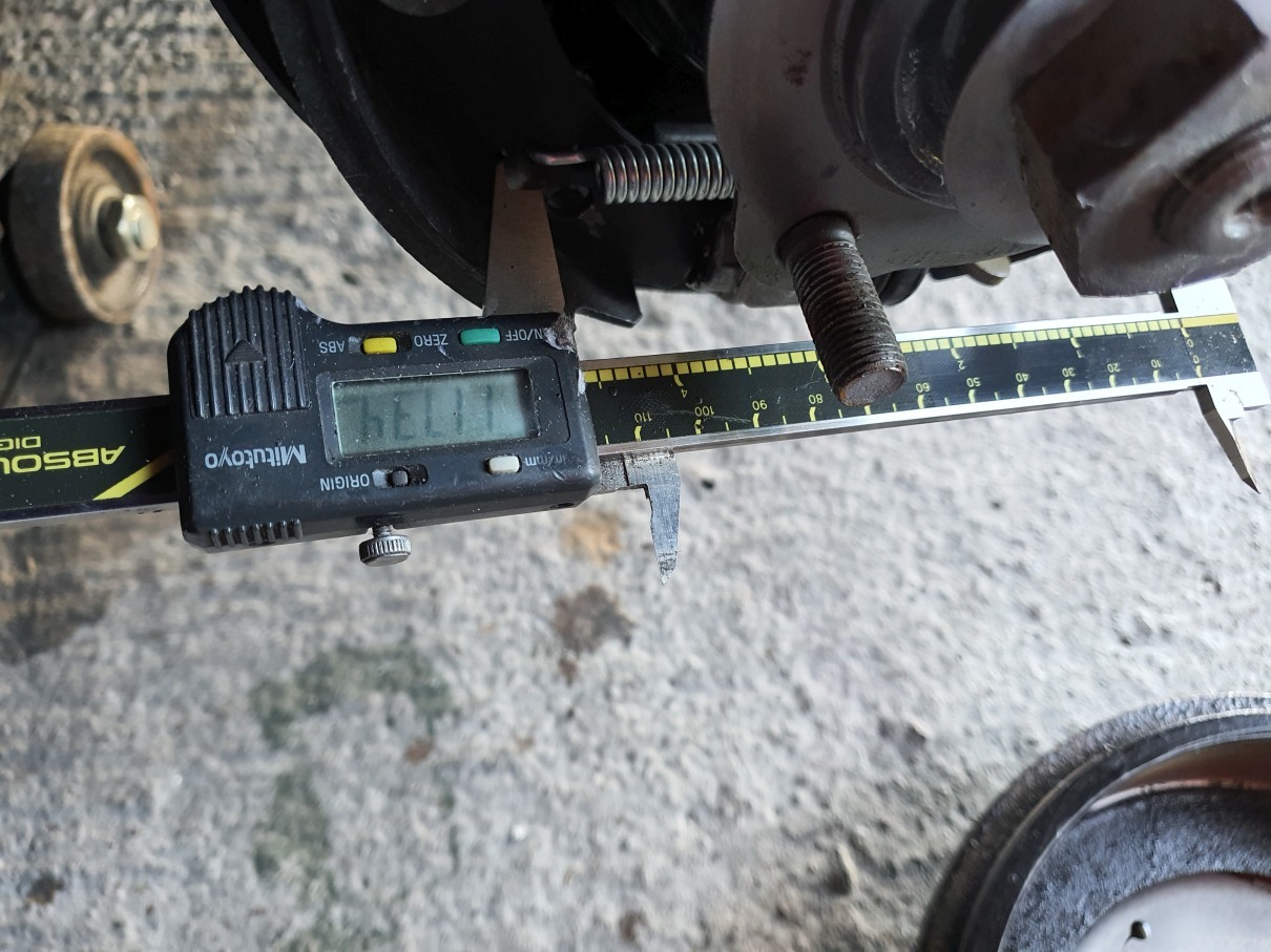

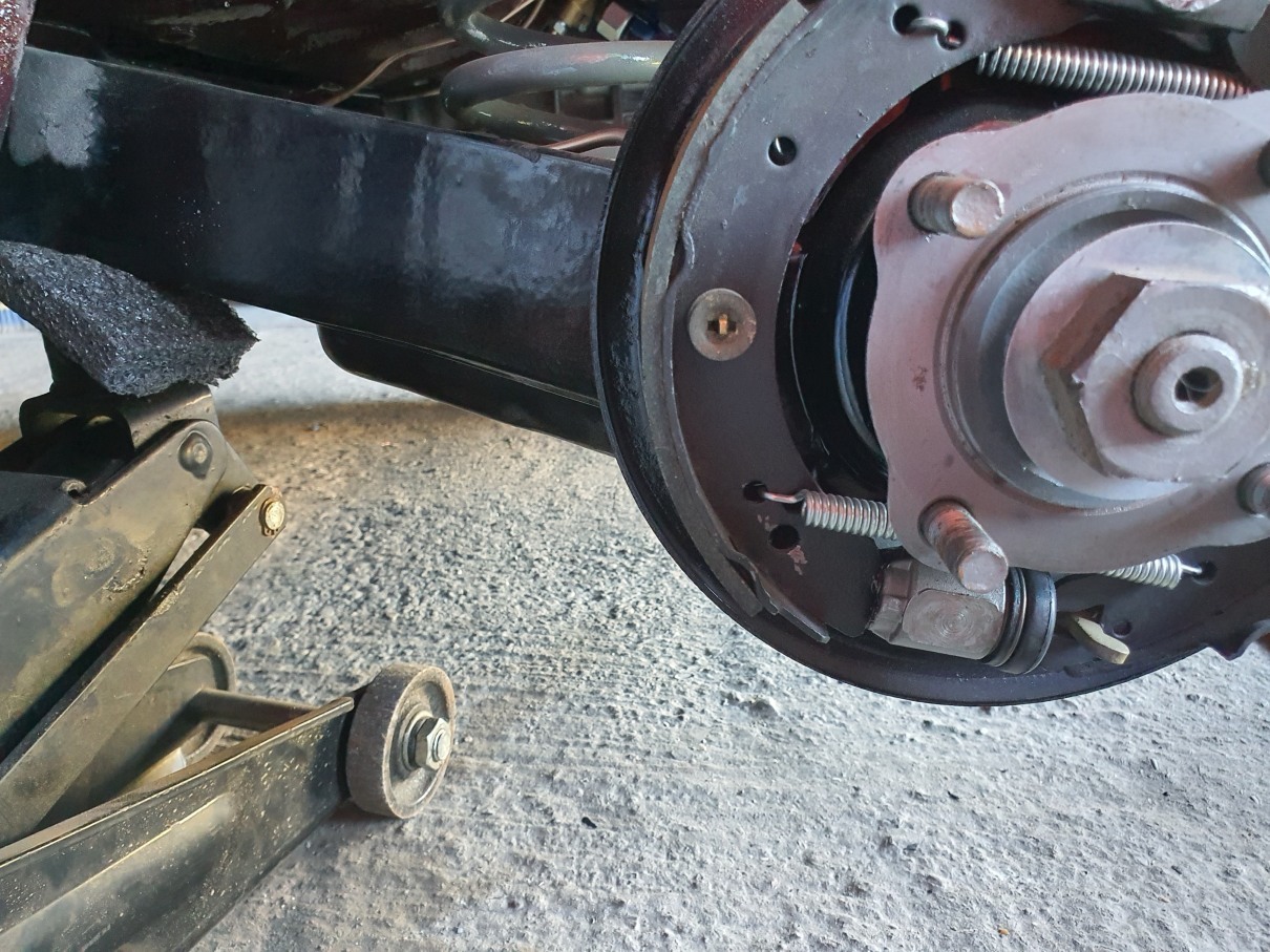

I can get the drum on but ones on extremely hard to move. The drums and shoes are new ones from mike dent.

Should be OK then. Let me get the pics for you Dan.
You sure the shoes are just not sitting too low and need centred up, they should follow the same circumference as the pressed ridge on the backplate

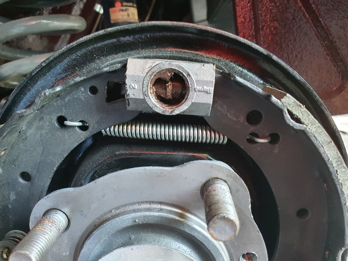

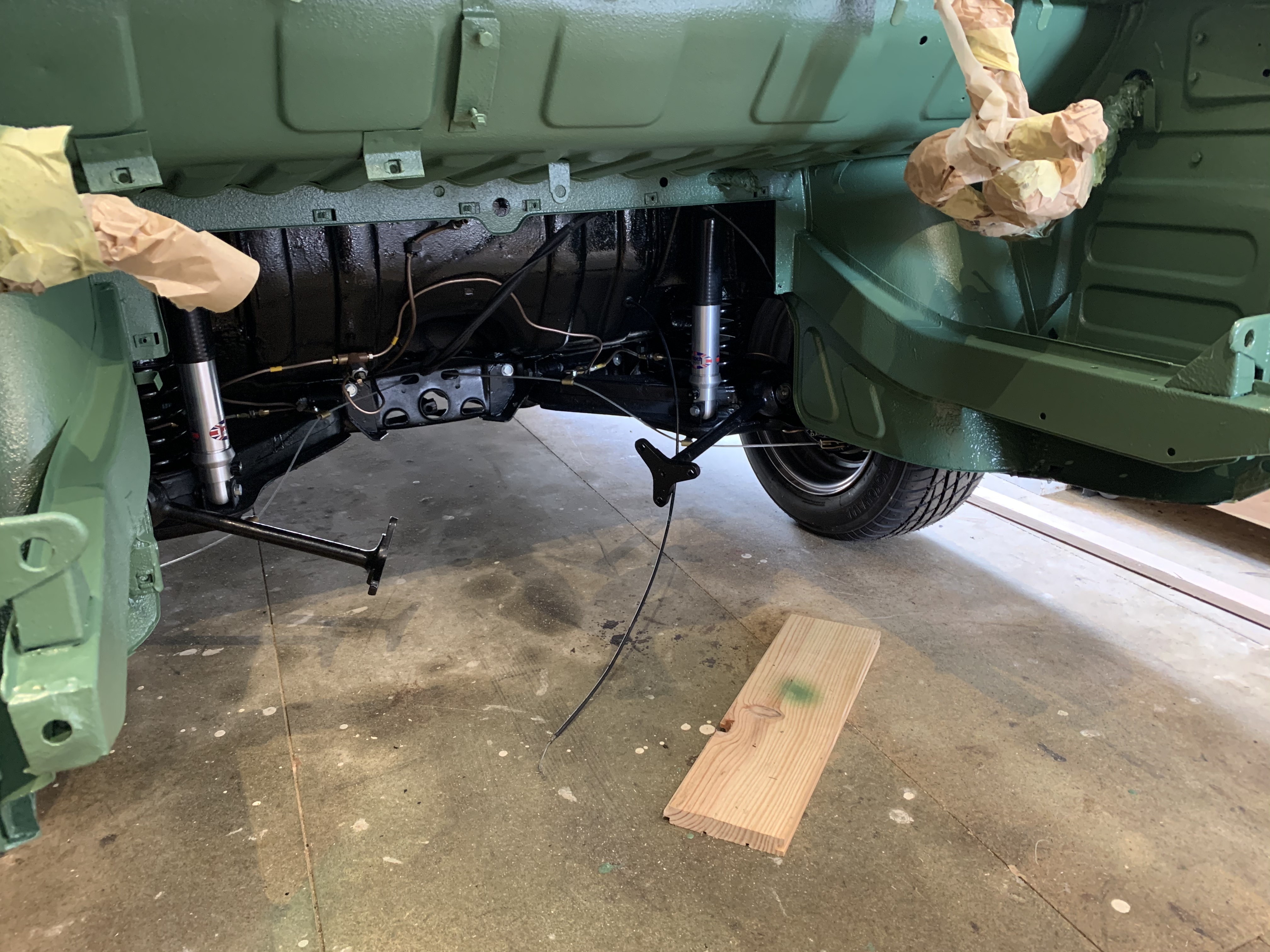

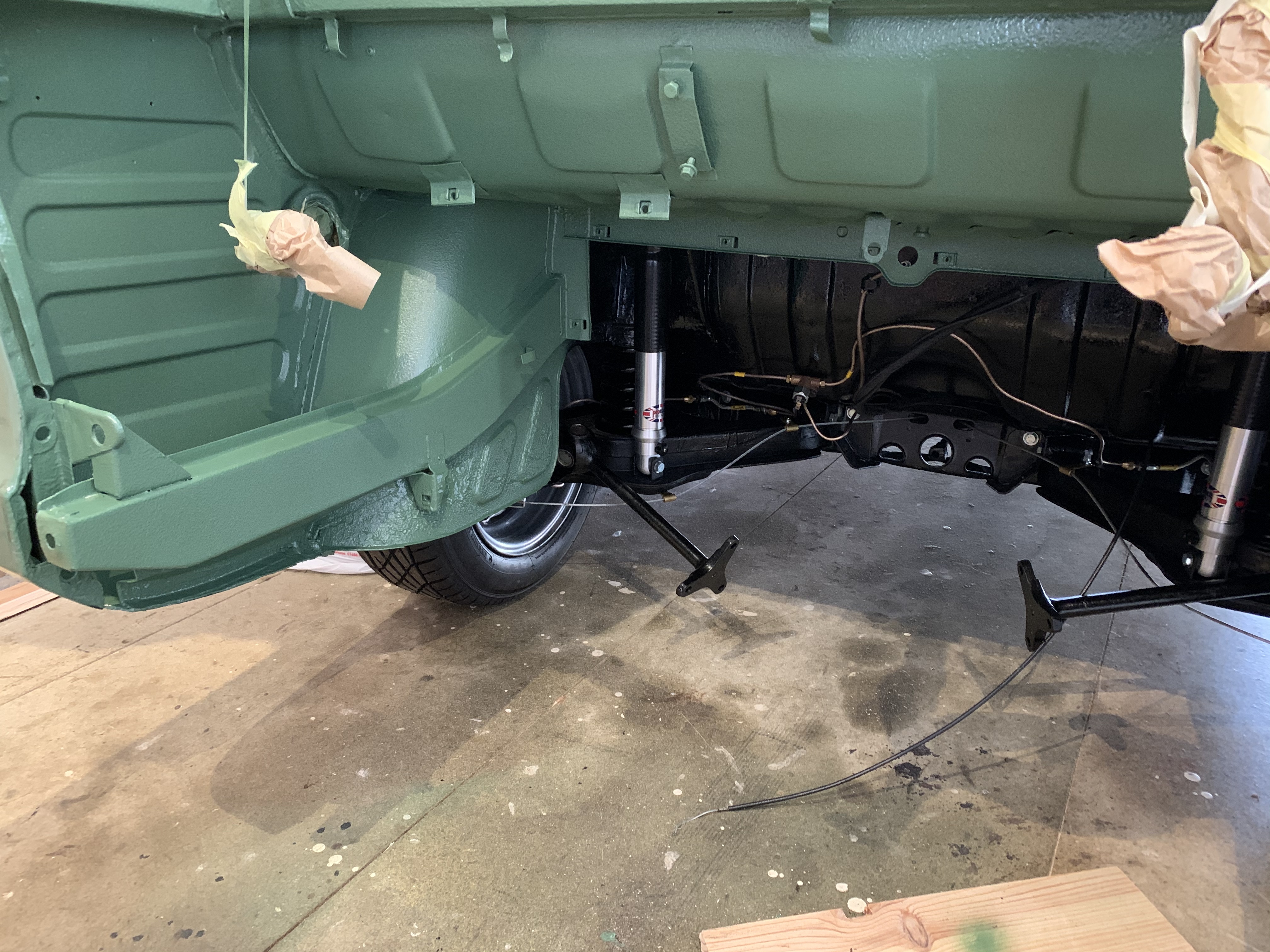

Looking at the back end , the position of brake light switch union , did you need to put a hole there to bolt it on ? it's just that my pipe from front is just about that position but the hole which l thought union bolted to is way over to the near side , pipes were supplied by Bob and l was wondering it this pipe which is part of a complete set was too short for some reason , suppose another way for me to check is by putting rear cross ways ones in place and see if l can figure out whats wrong by looking at them.
Not averse to putting union where yours is but just seems odd. Was there two different system layouts for some reason?
