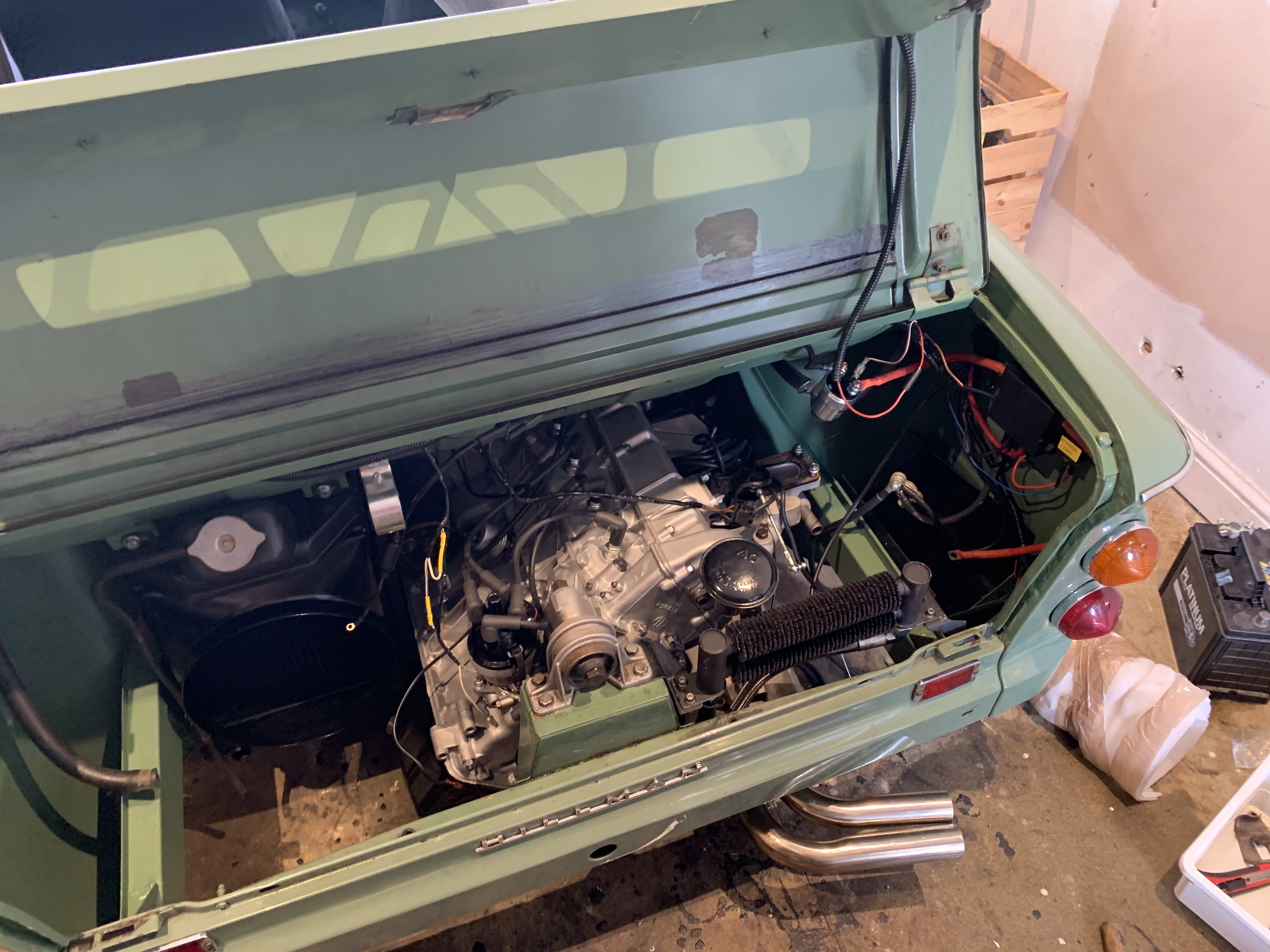

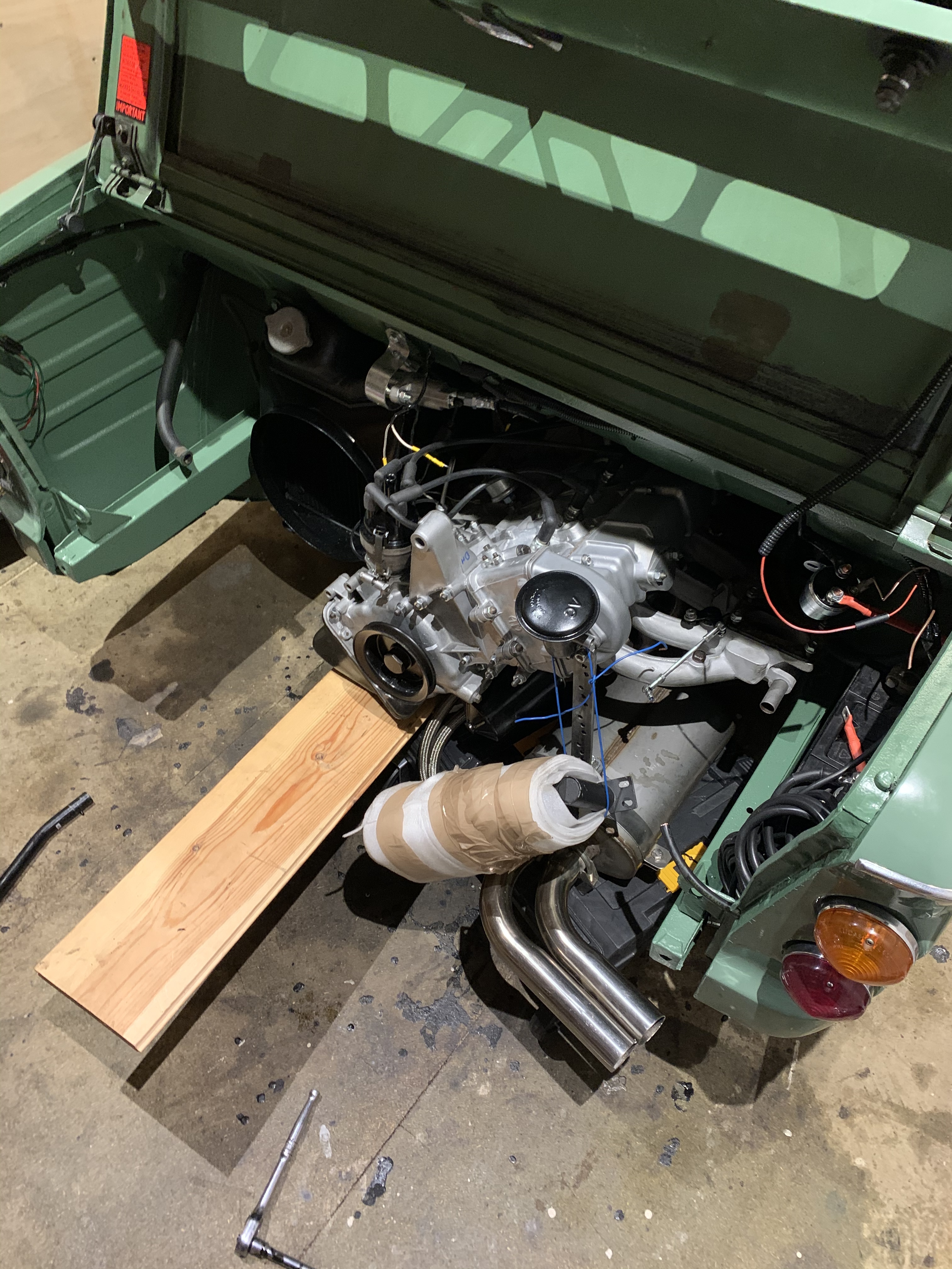

End of a long day Tavistock to Manchester and back but now have a Andy Jones rebuilt engine in the garage! Looking forward to getting it installed at the weekend.
Looks good, top bloke Andy..

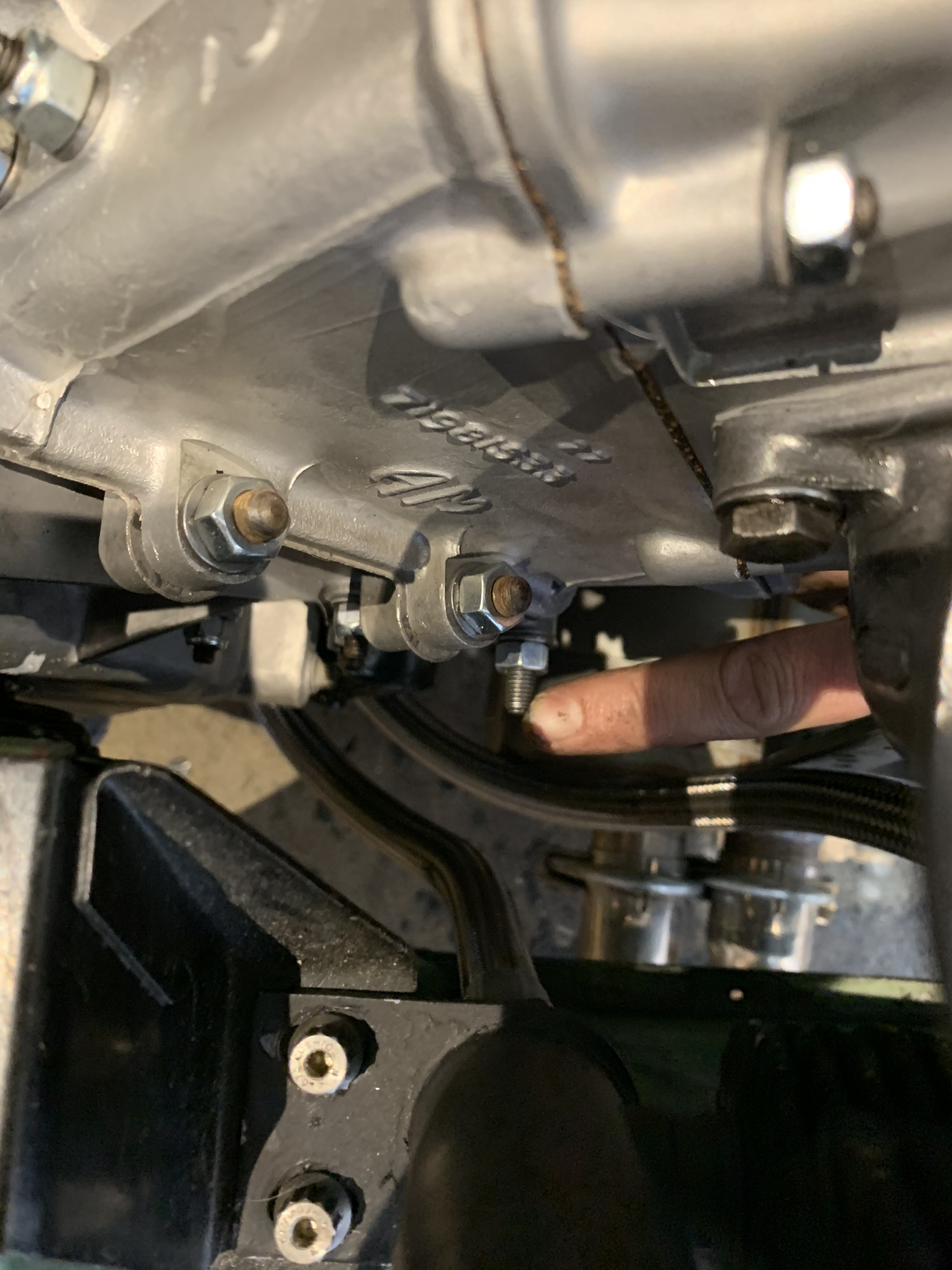

Would this stud work for connecting the engine to earth? As I have removed the old manky earth strap at the gearbox.
Would think this would be ok, I think on Mildred we put a strap from the battery to the engine and rear cross member, also fitted a new one at the gearbox too.

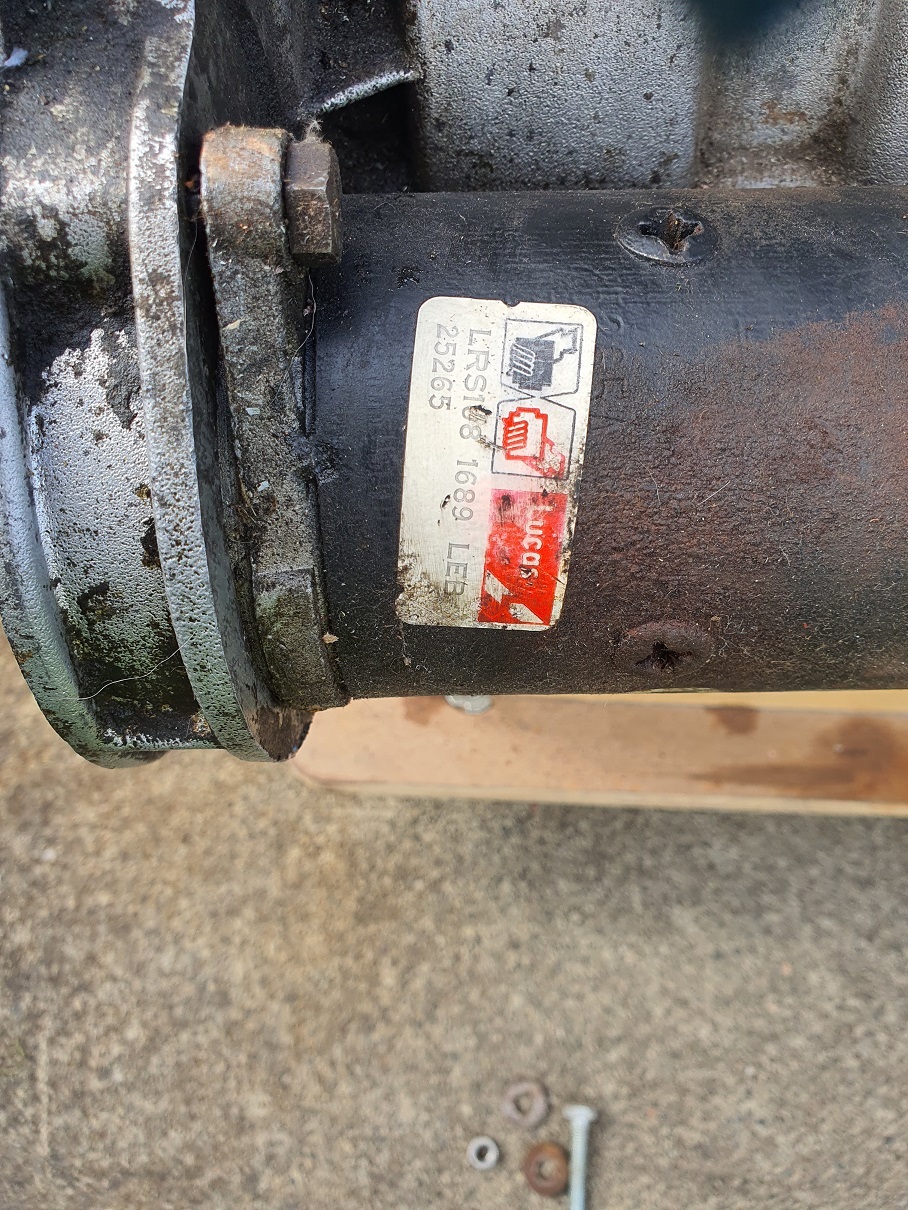

Robin does a pre-engaged version Dan, although if fully refurbished and a good pinion these starters do last a very long time as they are.
I have never found the need for a high torque or pre-engaed starter anyway.
Dave Dave Lane any suggestions for a refurb or where to get an exchange ?
We can referb them at work , proper job it would be too but it wont be cheap , you can get Chinese copies but they are rubbish IMHO , Im running original Lucas ones i referbed yonks ago , they run perfectly , BTW technically on pre engaged you need to turn the ring gear around
