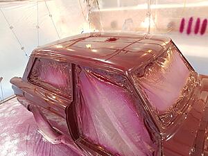

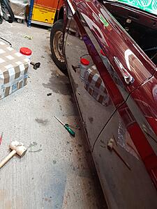

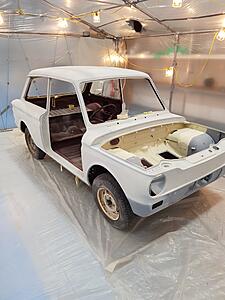

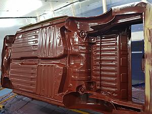

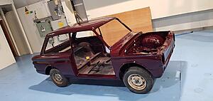

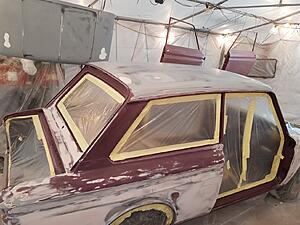

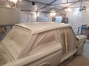

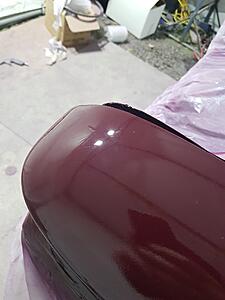

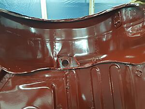

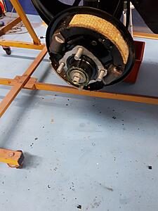

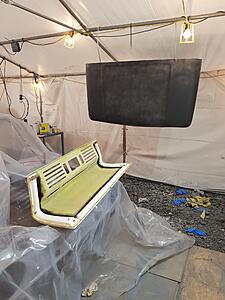

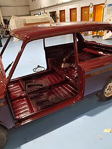

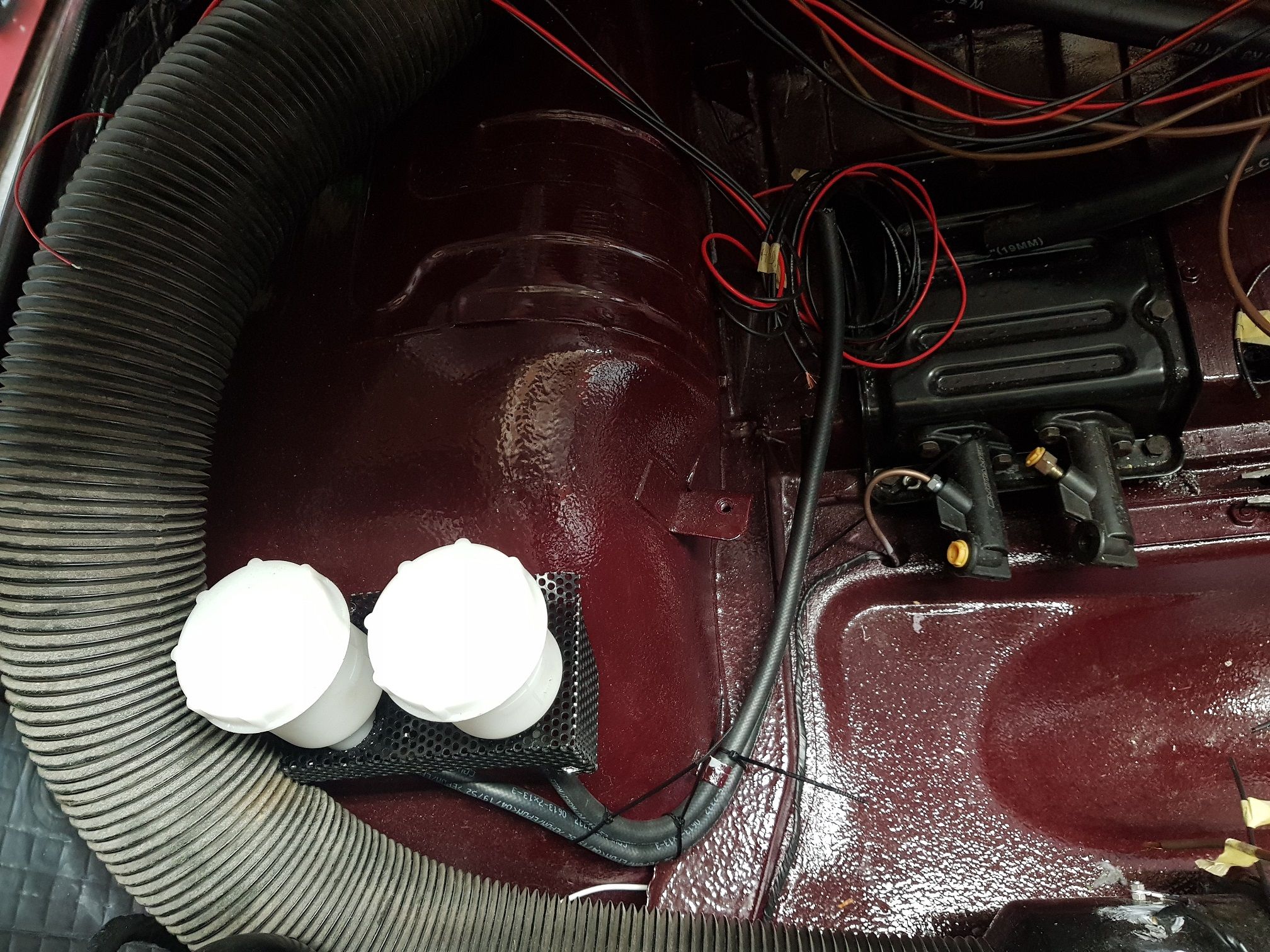

Getting closer to paint day !!

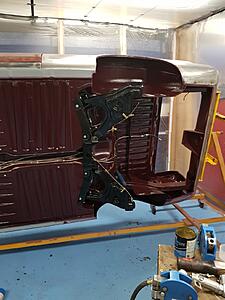

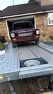

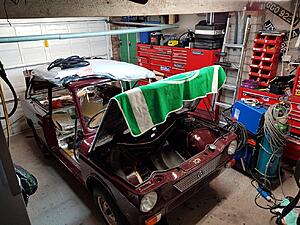

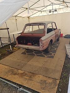

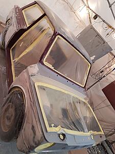

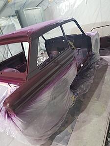

A long way from the beginning

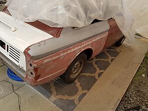

Still plenty to do though

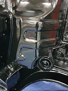

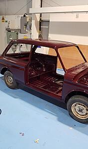

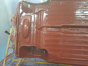

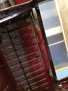

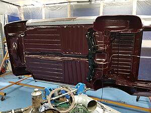

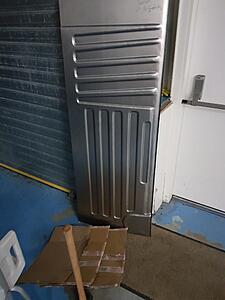

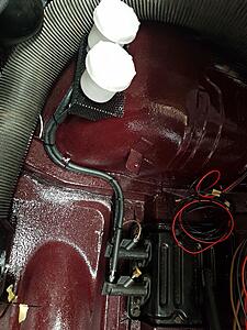

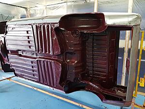

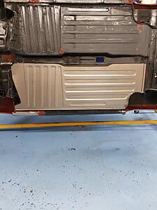

In case anyone did not know there are 1/2 floor pans available from Bob Allan at Imp Club Spares
The Imp Club can however only sell to members, an unfortunate limitation on non profit and tax status
They are however only ยฃ75 a side ! well worth paying membership if you need these.

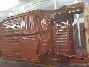

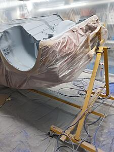

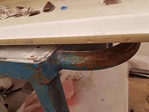

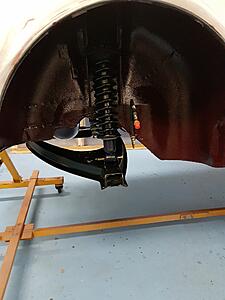

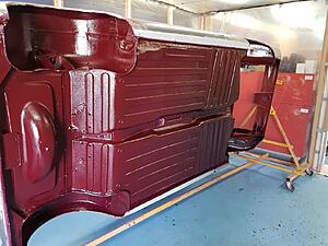

I took the oppertunity while there was a car on the jig to trim the panels to fit, so here you see them on stand alone and trimmed to fit.
It would have been nice to have them in a heavier guage and in Zintec but seems that was not to be so before fitting these they would need ripped, stripped, etched and coated..... as many areas are not accessible after fitting.

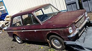

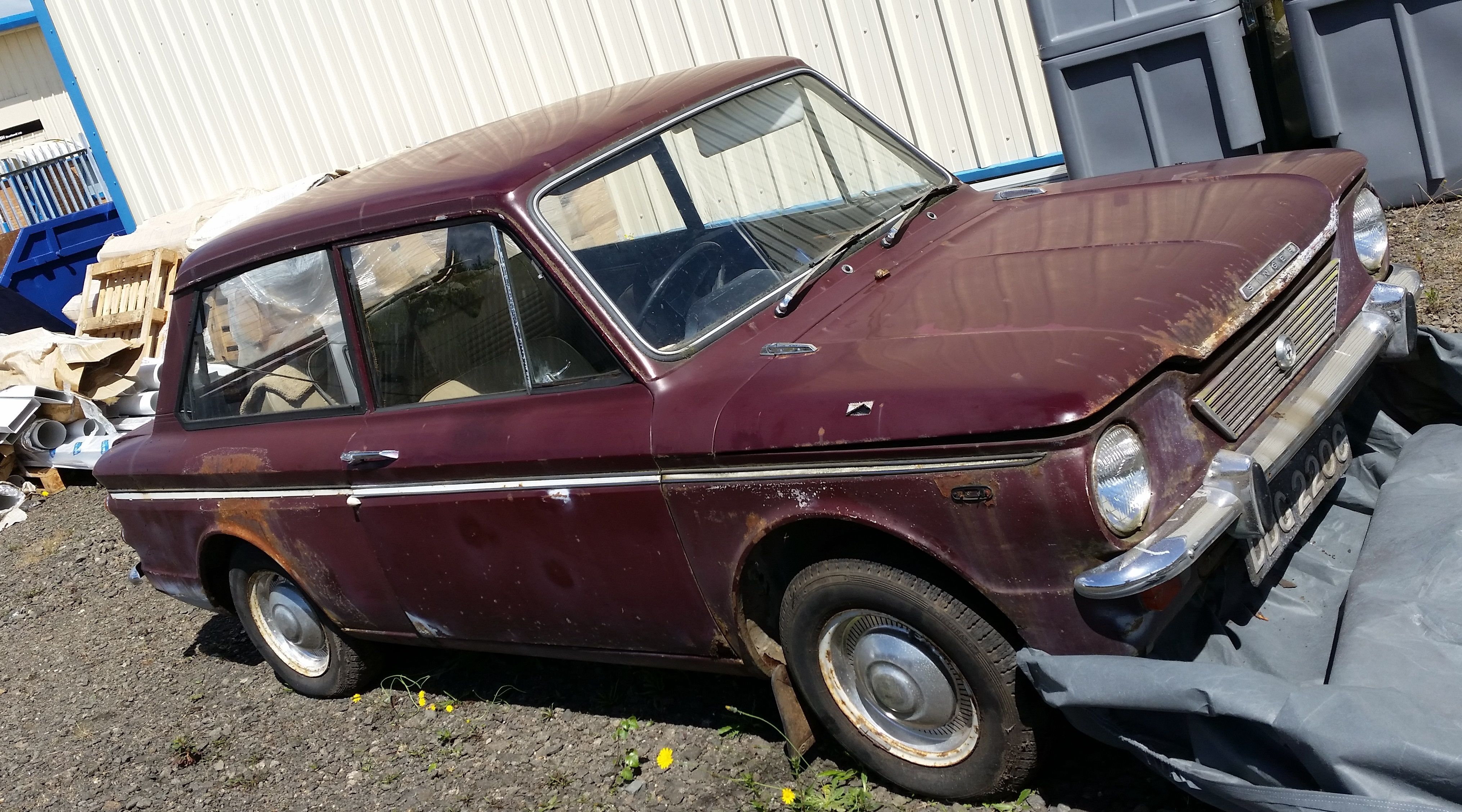

I do not need these for this car but do need them for my next car, a June 63 MK 1 (look up Doris)
