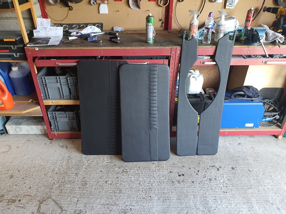

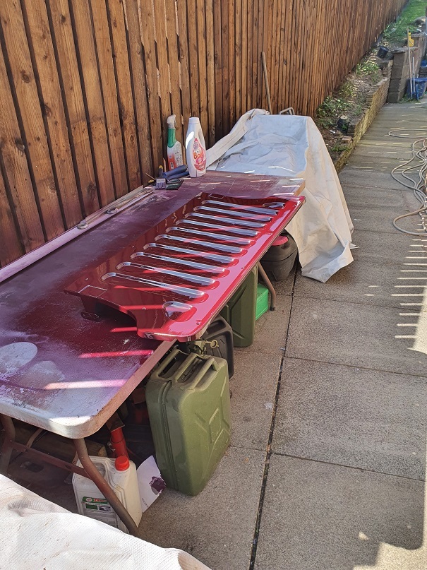

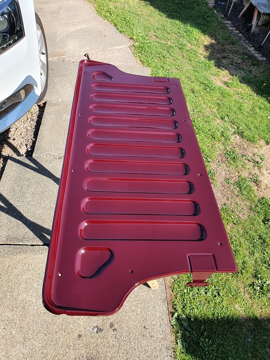

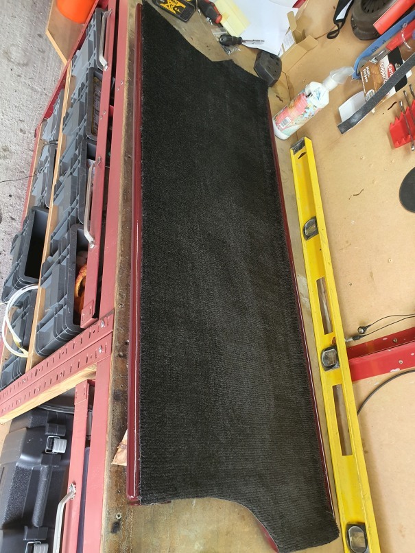

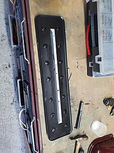

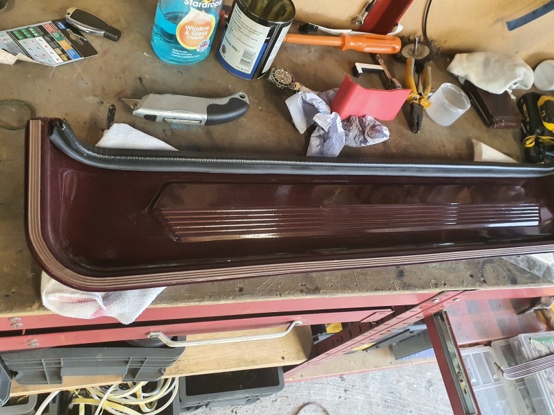

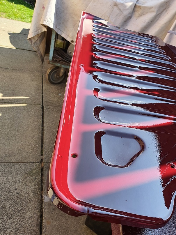

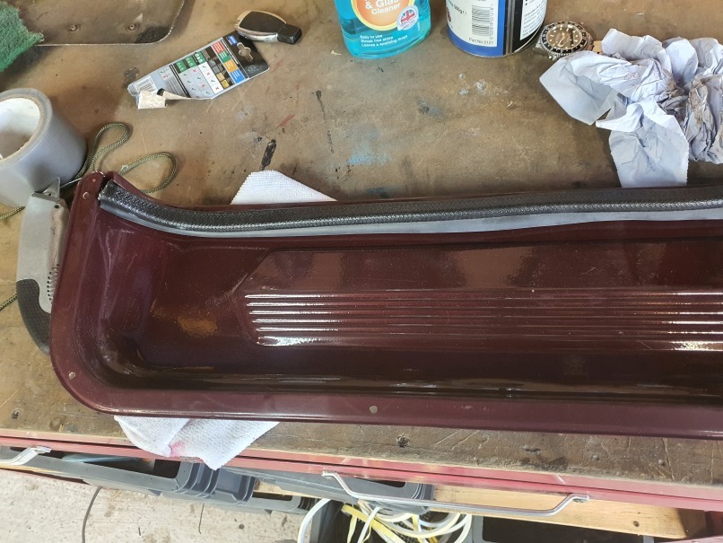

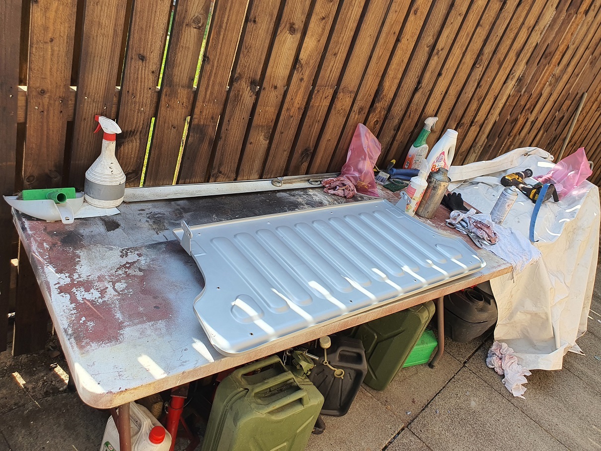

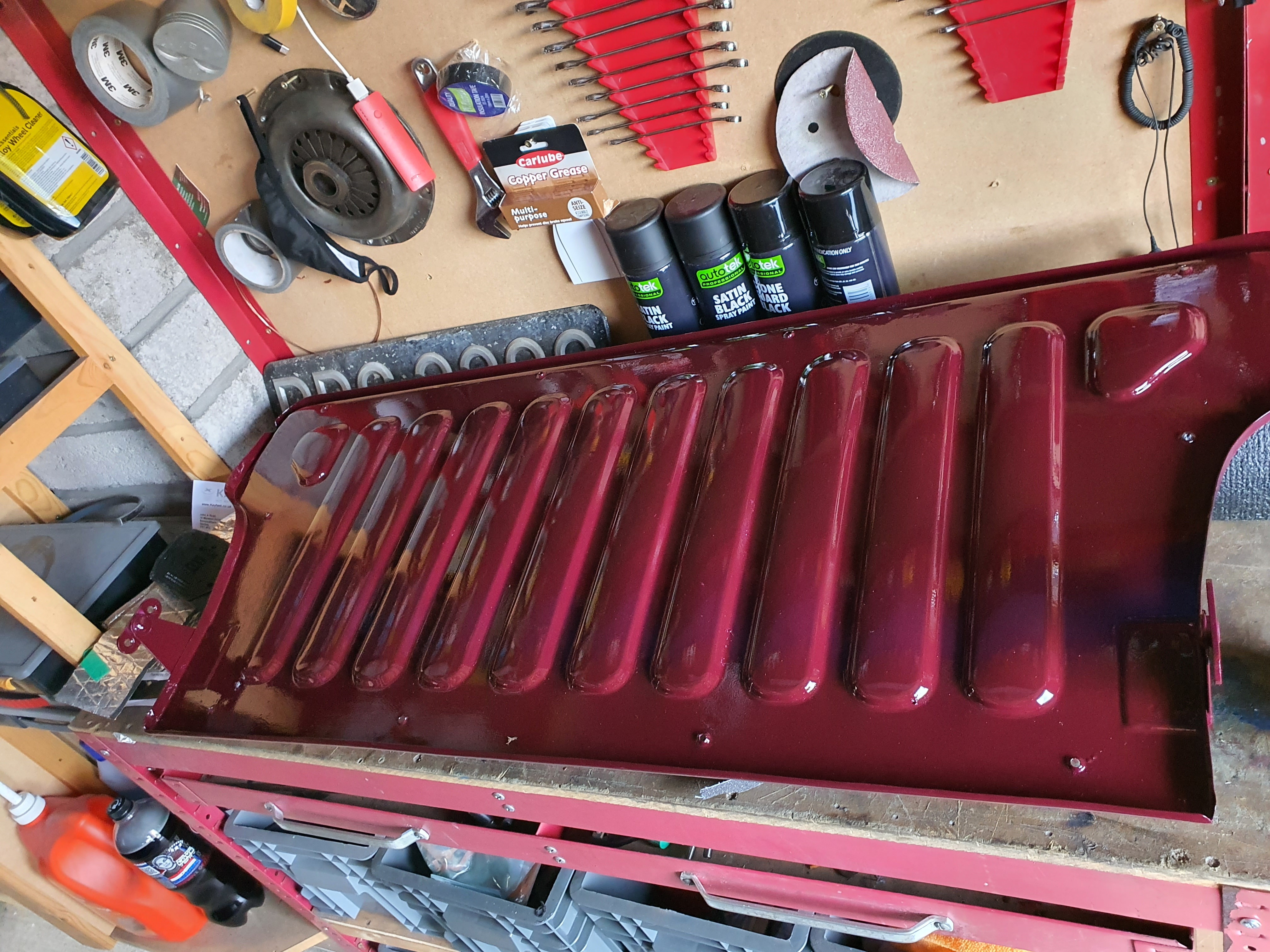

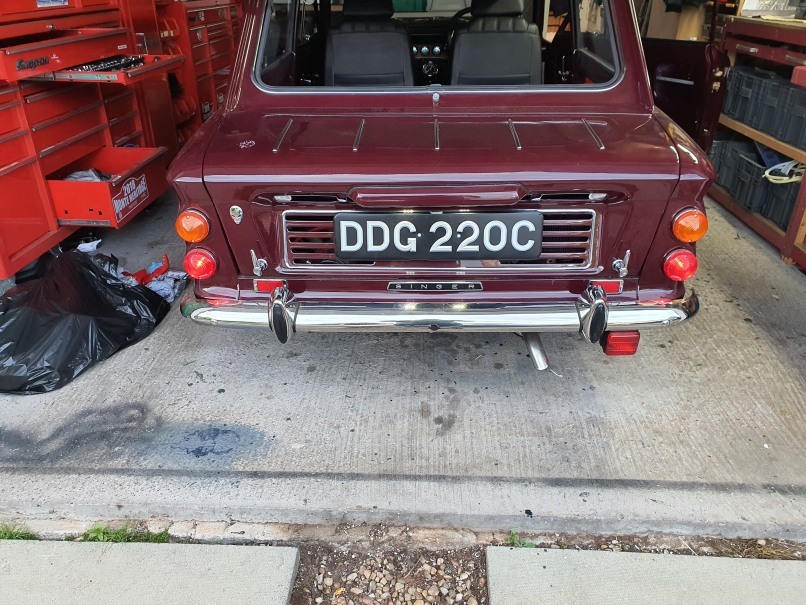

And something I always wanted to do.
1. put all those wasted seals for the doors to some use "later
2. Finish the edge of the door pockets a bit better
3. Add a gasket to the door pocket to stop those feeking rattles when the self tappers let loose

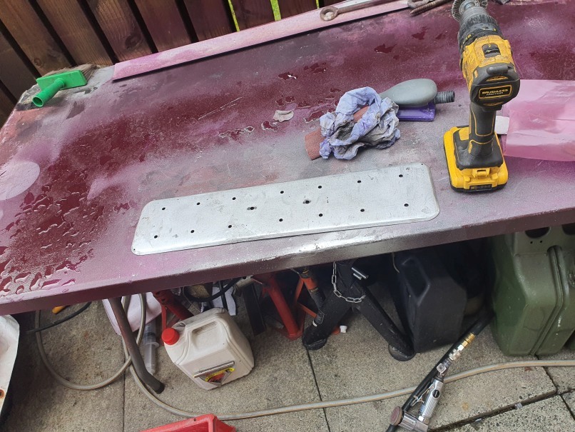

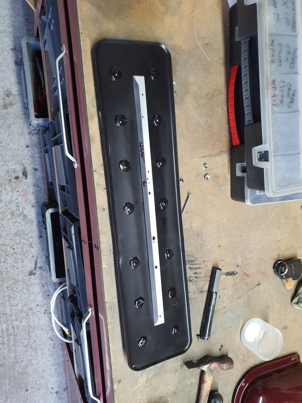

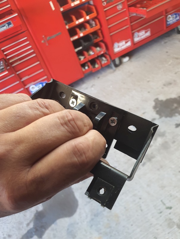

OK, rivnuts should sort the self tapper issue
So I did these
The door seals are a fantastic fit, much better than they ever were on the door thats for sure !
So I did these
