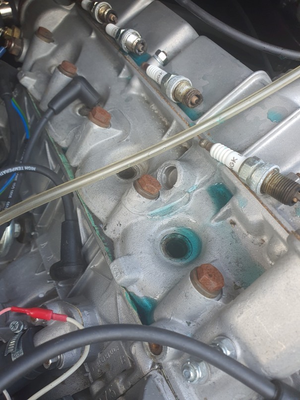

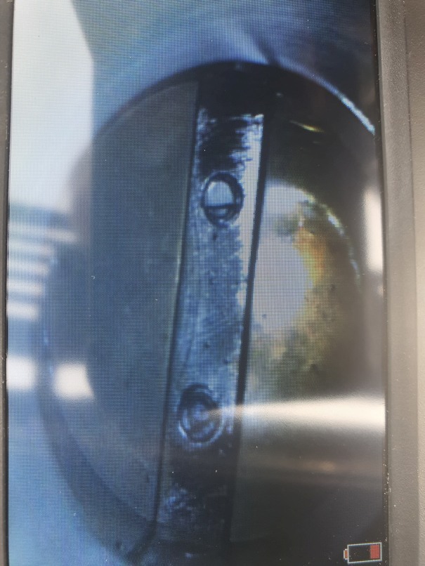

Had a great tip from Andy to check the screws on the butterflies on the 28/36 but all there, managed a couple of pics before the battery gave out
So out with the plugs
CYL4,3,2 all dry and CYL 3 looks as if it has something going on but no dents in pistons anyway
CYL1 though, thats the rings now completely gone I reckon as this was the greeting at TDC, not a drip any more, a flood !
So best case it needs stripped and cleaned now

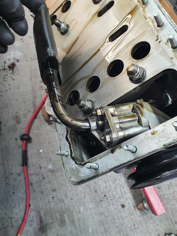

so looks like new crank or at least new bearings or I take the damn thing and toss it in teh skip.
