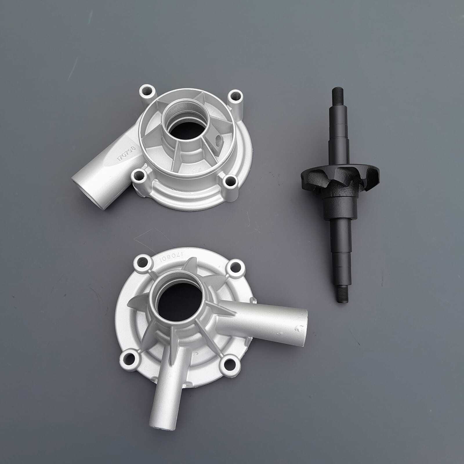

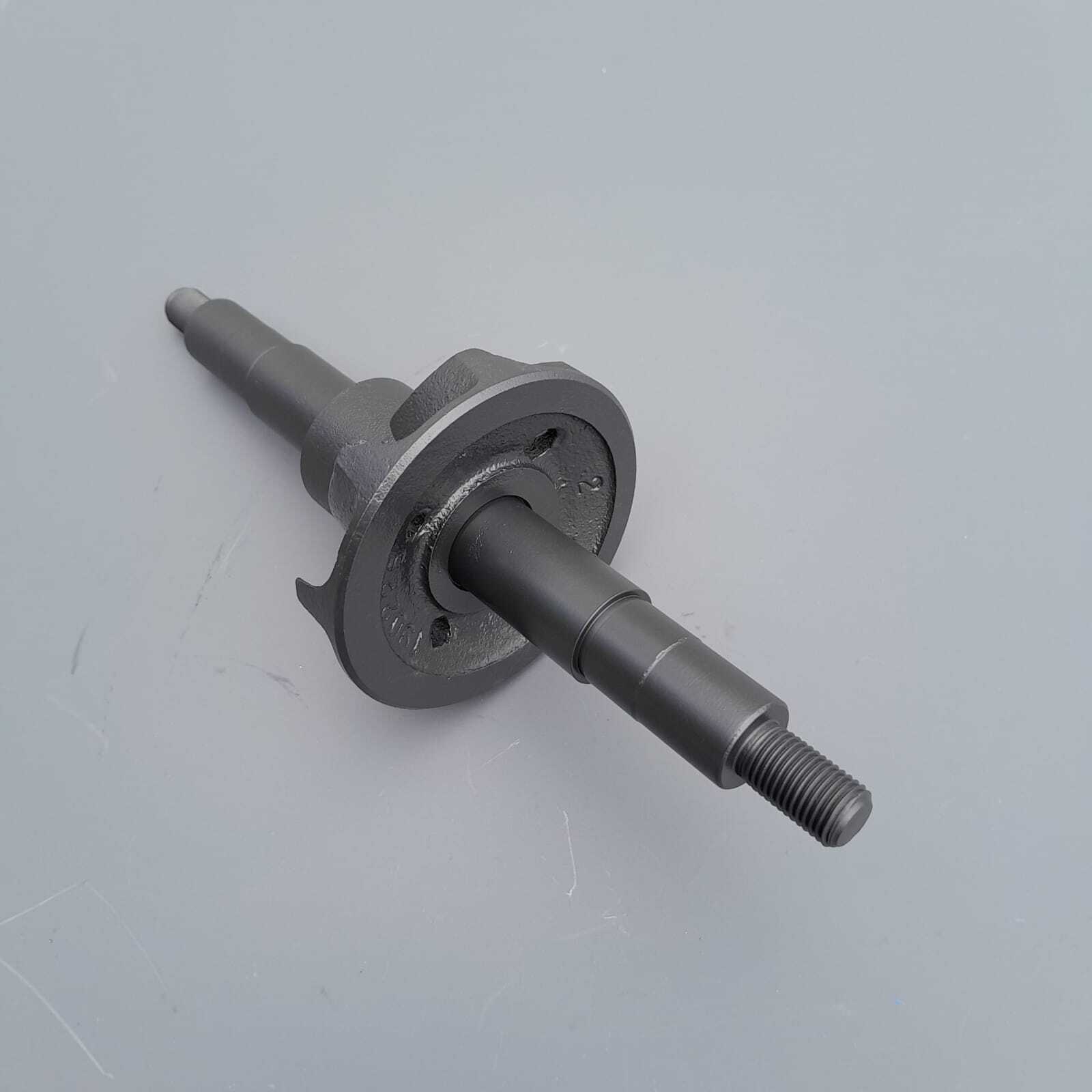

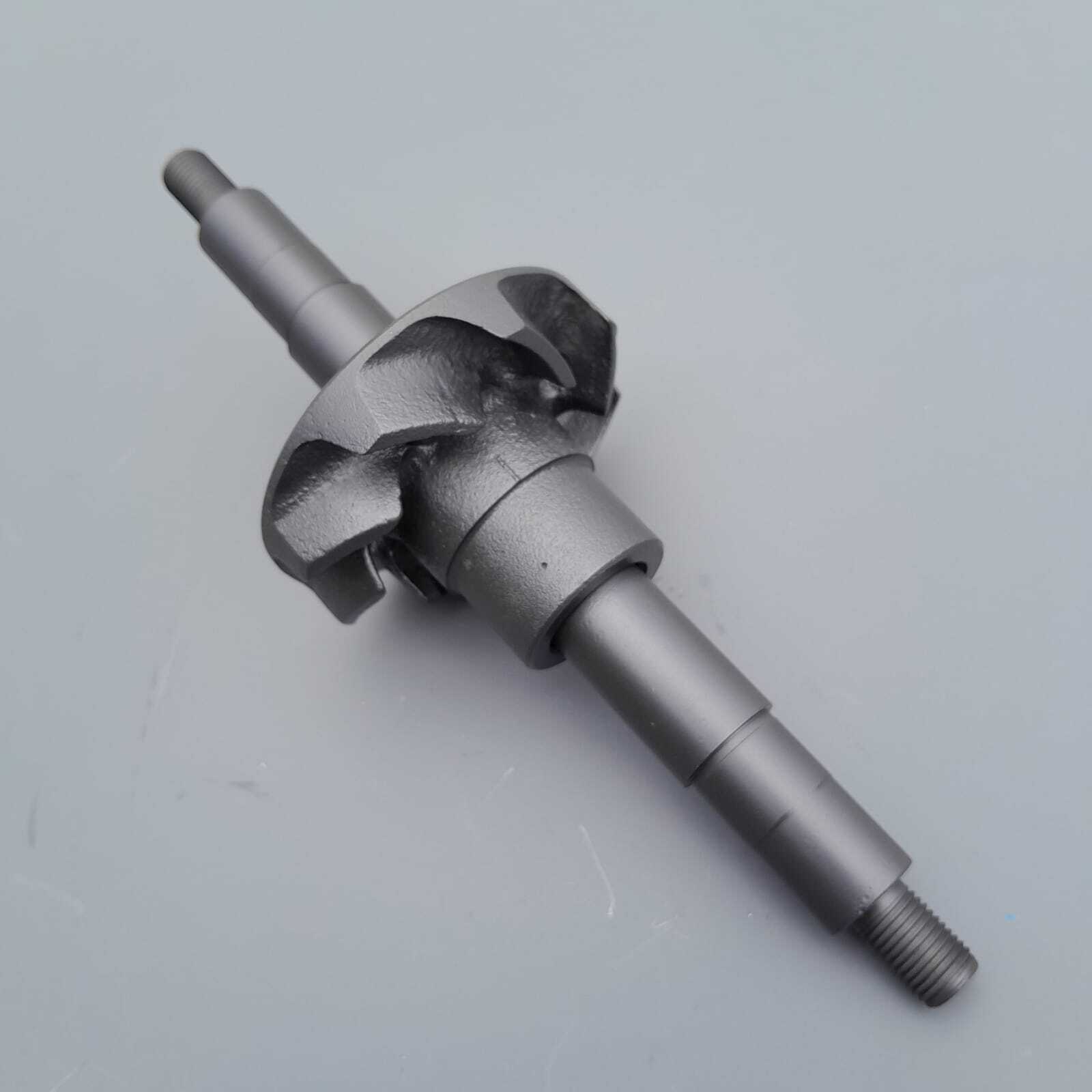

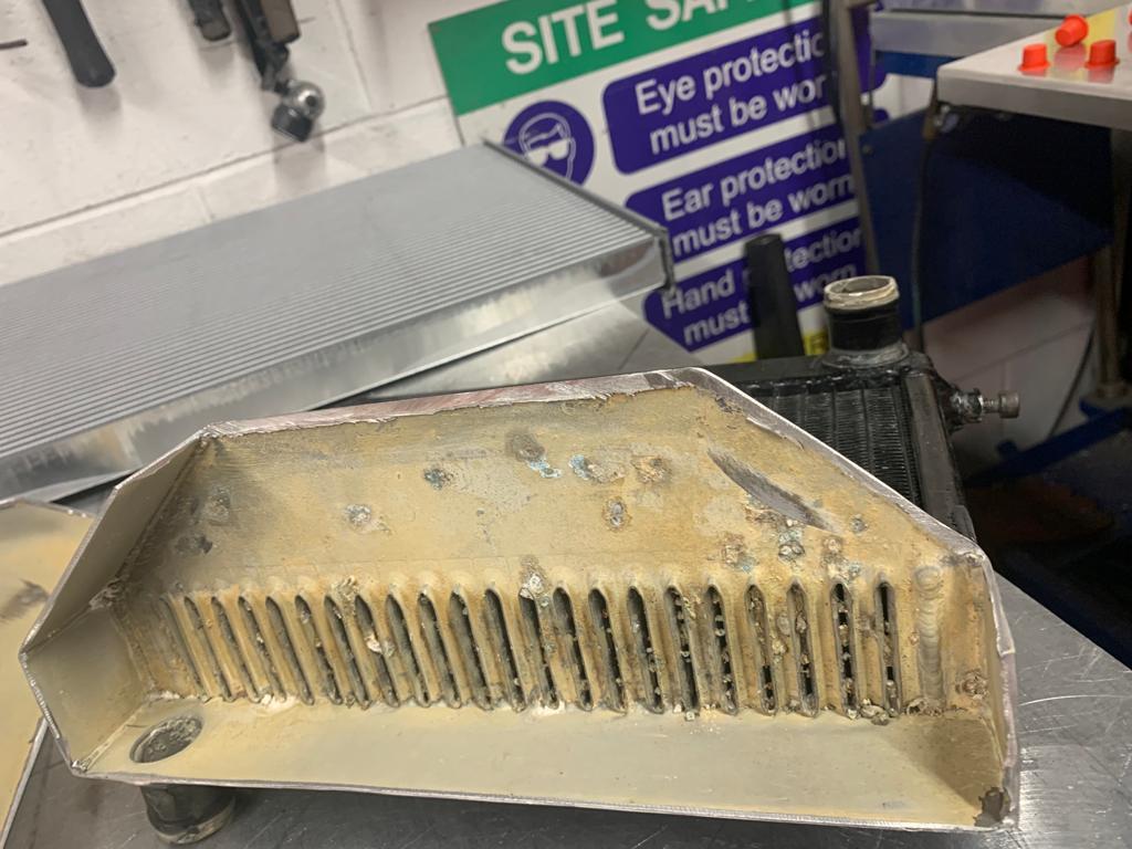

    70/30 Bluecol and change it at recommended intervals. The less anti-freeze you have the more efficient the cooling but you need it to prevent corrosion so add just enough to prevent that. It is not a big job to change and flush the system every other year also not expensive to do and the flushing ensures a clean system. Using de-min water also helps. An overflow tank ensure the system can be filled to the max with the least amount of air in the system as you want to remove as much air as possible as liquid cools better than air. I currently have on test a pump that I have cerakoted and added stainless steel faces to the shaft for the seals to run on. Also there is a picture of a brand new rad 12 months later that suddenly caused very rapid over heating on a imp rally car the owner used Volvo long life coolant! You need to be very careful thinking more modern is better. On some things yes but the quality of anti-freeze and oil for example now compared to the 60's is far superior so no need to change the spec thinking it will work better. The Volvo stuff is designed to go in a car capable of doing 200K miles used daily and with a higher pressure system completely sealed from air intrusion. The use most classics get the Volvo stuff is no good. Will do a post about overflow tank and how this improves cooling.
