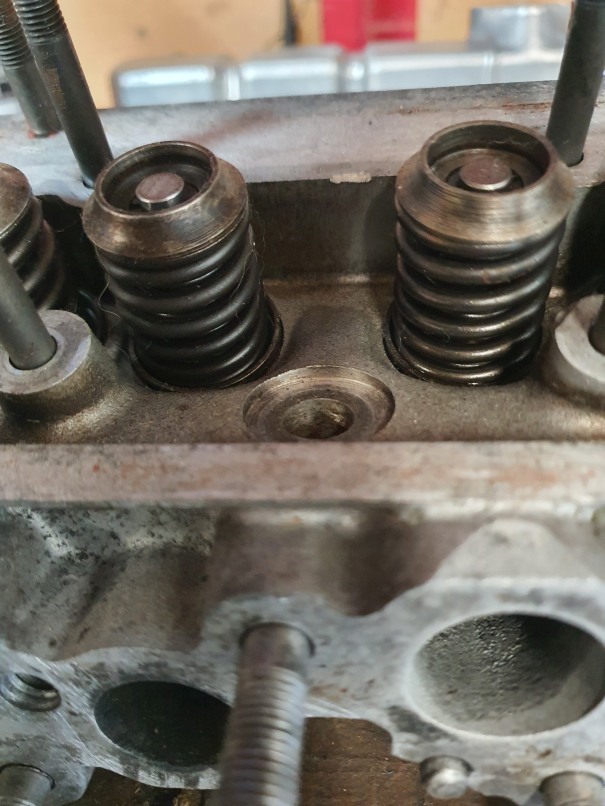

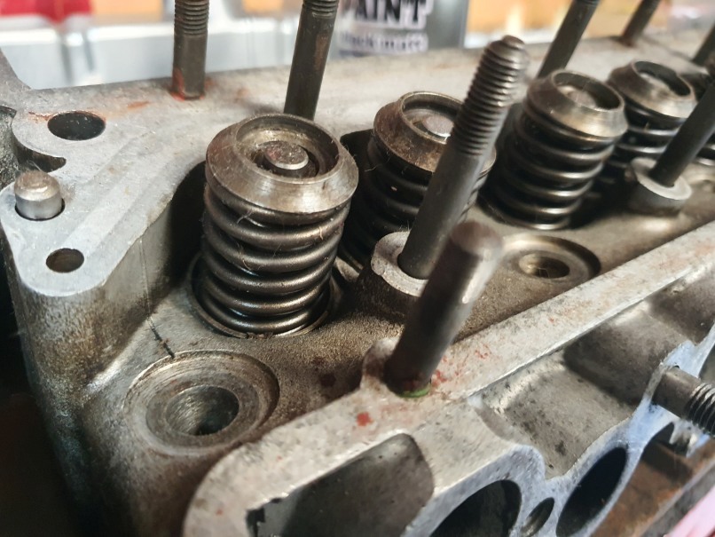

    I have always had cups under the springs on mine, only difference is the double springs
    I just checked my spare 107 head and it has cup on bottom (so springs dont hit the alloy) but no extra cup at top, only the flange and collets

          See below, couple of pics from an assembled 107 early sprot head pulled off a good engine in favour of a big port head about 6 months back
