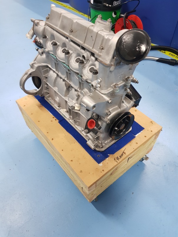

    Below is my own take on it.
    First I used one of these bases from Lidl / Aldi cheap, already has a handle and 4 castors, just drill to suit. The amount of fixings are up to you.

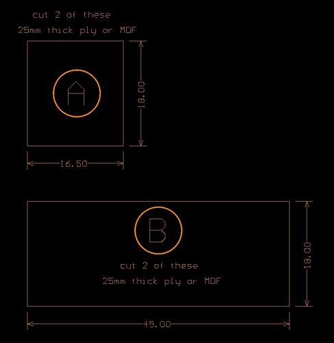

    Cutting list, 4 sides, use fixings as needed
    DIMENSIONS ARE IN CM
    Cheers Jim McKenzie for noticing the missing dimensions on first posting, my bad !
    Click image for larger version  Name:	box 1.jpg Views:	0 Size:	55.8 KB ID:	12289
    Click image for larger version  Name:	box 2.jpg Views:	0 Size:	102.7 KB ID:	12279

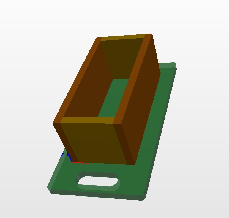

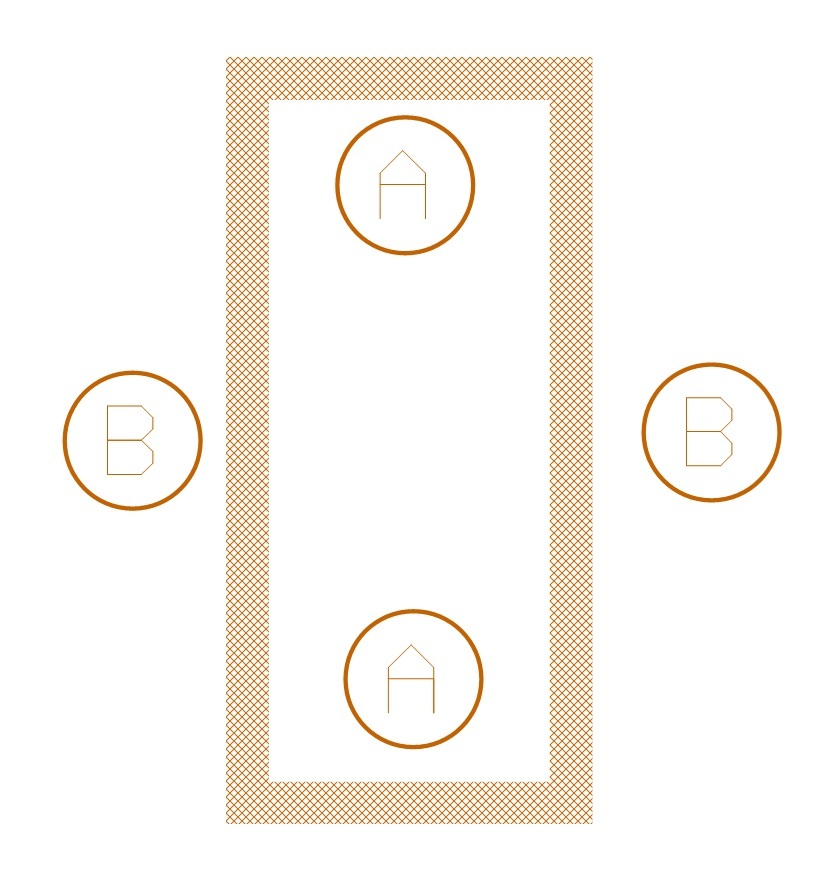

    And here is the 4 sides ready to screw together and in 3D
    Click image for larger version  Name:	box 3.jpg Views:	0 Size:	33.7 KB ID:	12277
    Dark brown are the B cut sides, the lighter brown is end sections A
    Put together to fit as shown
    Just a word of warning
    Imp engines on these type dollies are TOP HEAVY do not push them around on rough surfaces in case you hit and obstacle as they will topple over.
    I often thought of dropping the height and cutting out the bottom
    Oil will end up everywhere, dont ask how I know

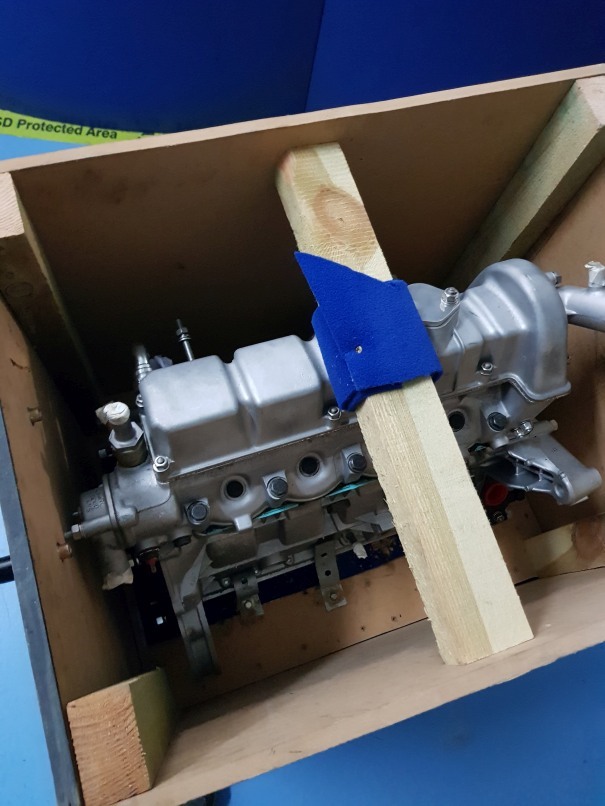

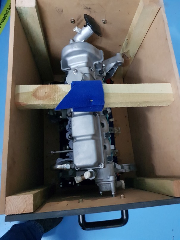

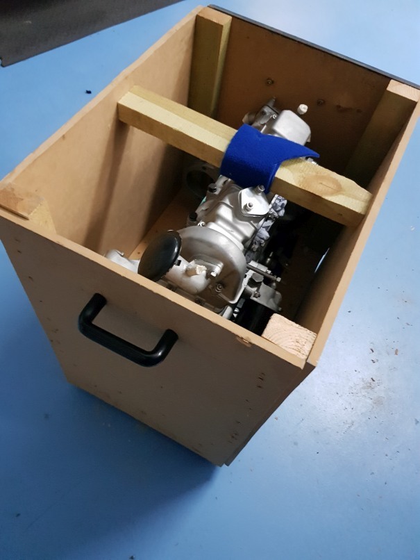

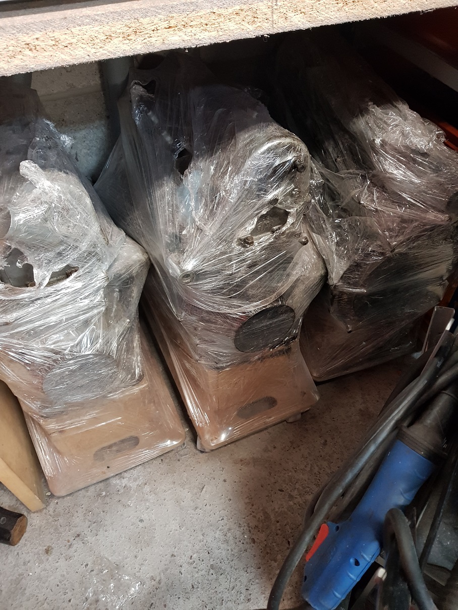

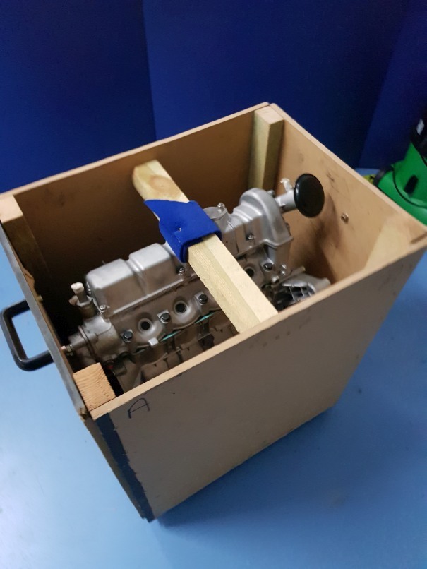

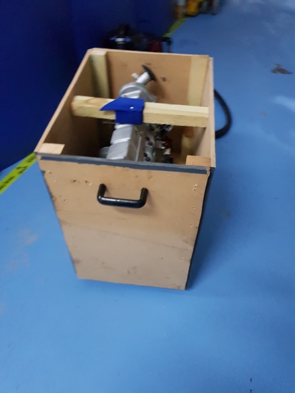

        This was MK 3 version for storing/shipping/moving engine around stable
        Much more complex but can be pout on a pallet
        Truly a "crate" engine
        It is same basic design except it has a wider base and a hole cut in for the sump to sit in with a lower centre of gravity
        The shell can be scrwed on around the base.
        This is how I have the spare 998 stored in the garage wrapped up.
