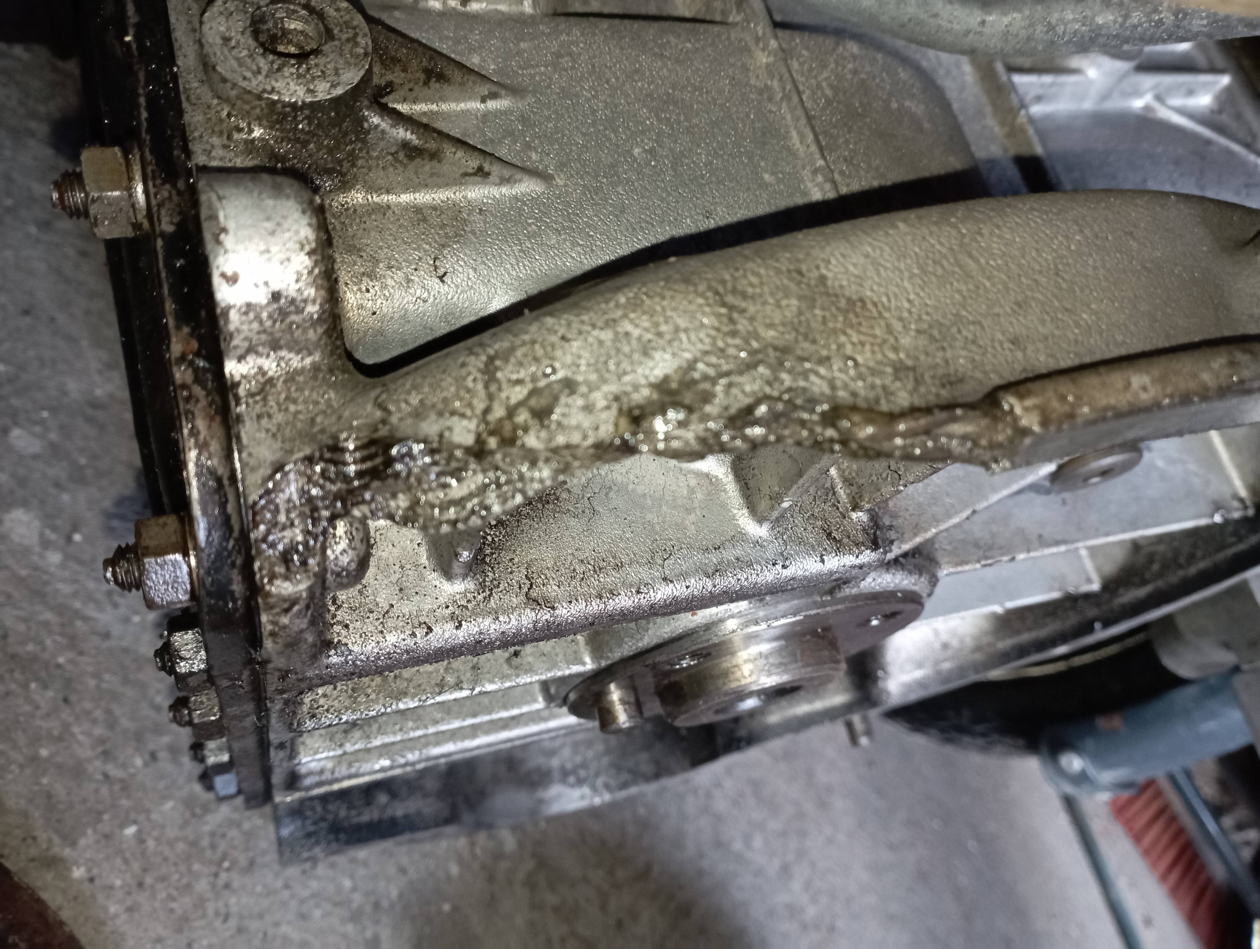

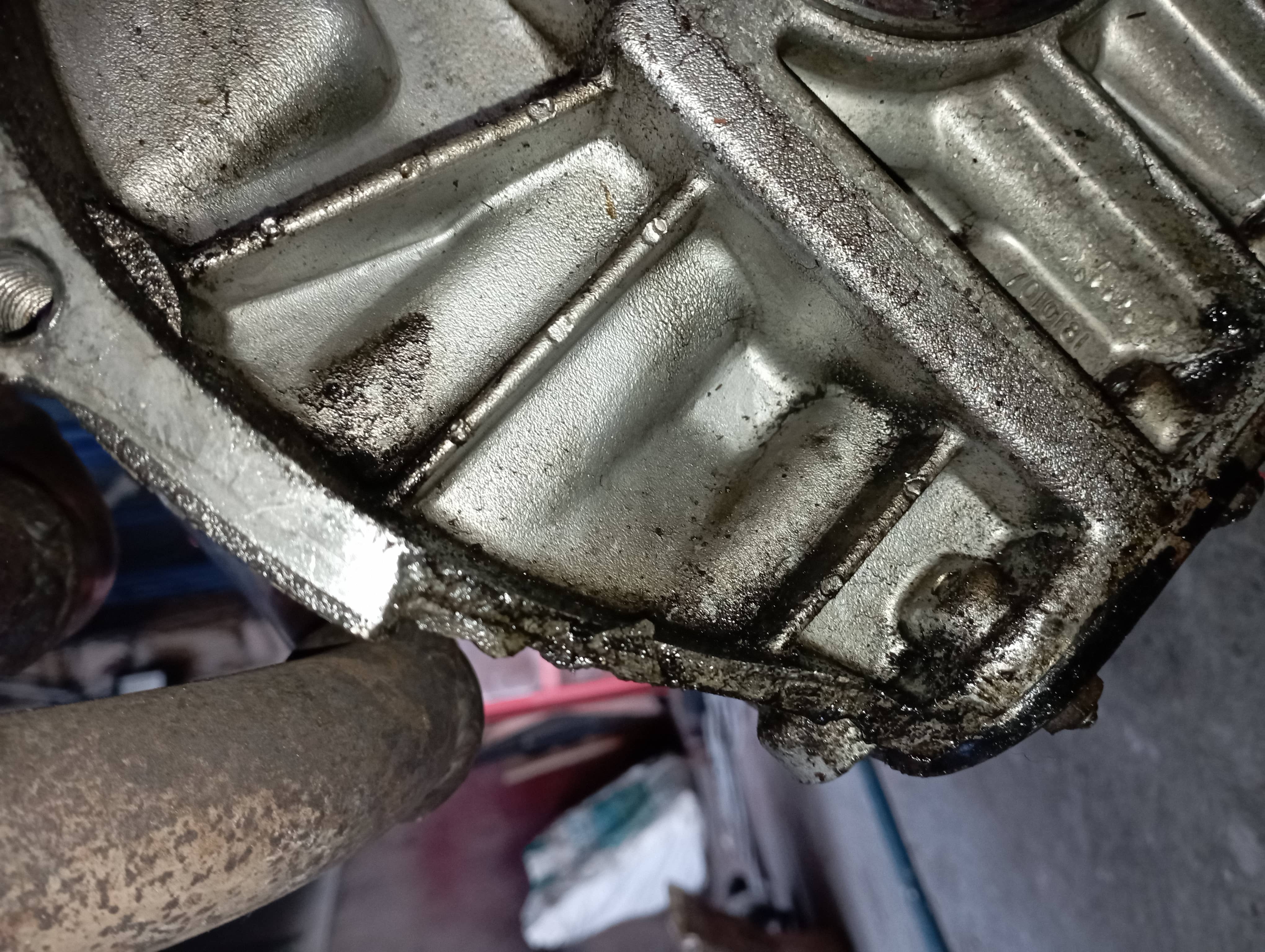

    i bought from a french gentleman a supposed very good condition 875 sport engine with low milage. And that is true, under certain angles, it was looking good.
    After closer inspection i found that flywheel that was appart, was a useless for me as it was a 930 one, and that block got lighter after meeting the pavement or a rock.

    You only have one bolt missing, the other small hole is a locating pin / dowel to locate the faces together (centre the crank to input shaft on transaxle)
    Thats a lot of ally though to fill, you would need after this to mill the faces flat.
    I am not sure the alloy but I would suggest perhaps finding a scrap block and
    Cutting this section out of scrap block but slightly oversize
    Trim your old block to mate the two together
    Bolt to transaxle bell housing to use as a jig
    Fillet the edges
    Weld in the fillet
    Problem is you will need to tear down the engine and bolted down as ideally you want the block hot to do this
    I find the cast to be reasonably soft so if you decided to just build up the area na dthen flat it off, its do-able but thats a lot of time and rods
    Bob knows a lot more about castings, blocks, fixing etc. than me
