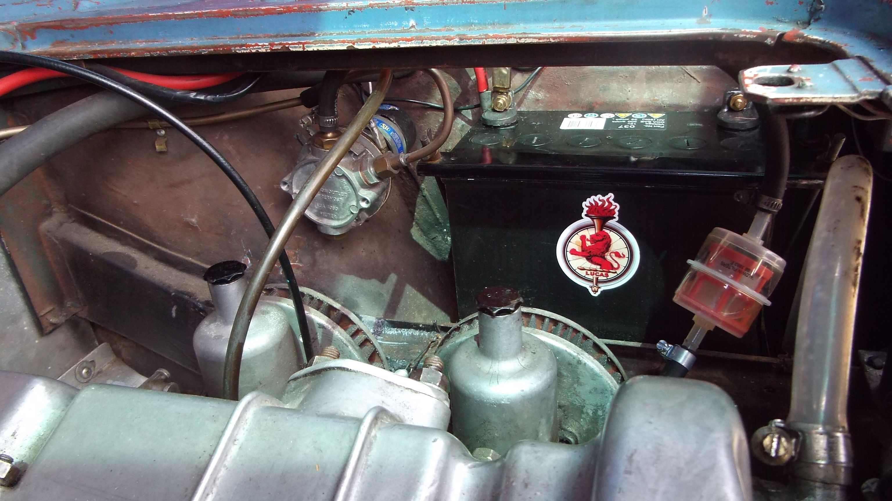

    Anyway theres two real places to fit them , either in the engine bay or up front . theres for and against on both
    Engine end pros - easy to fit - easy to connect up with nout to do at all at the tank end

    Ive done both - one on each car , Singer got a tank end one and the Vusky engine end , mainly as its no show car and therefor what it looked like didnt matter .

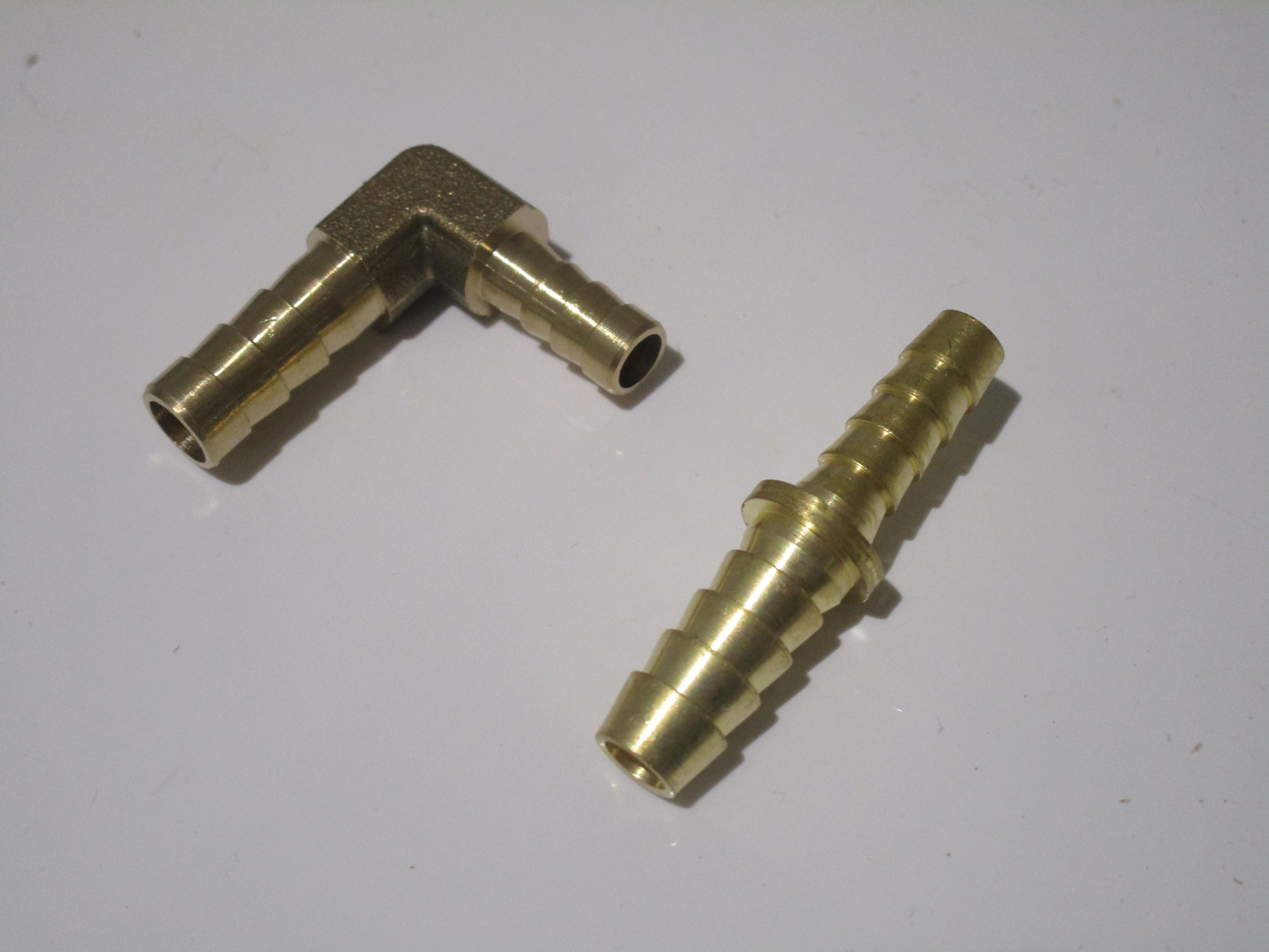

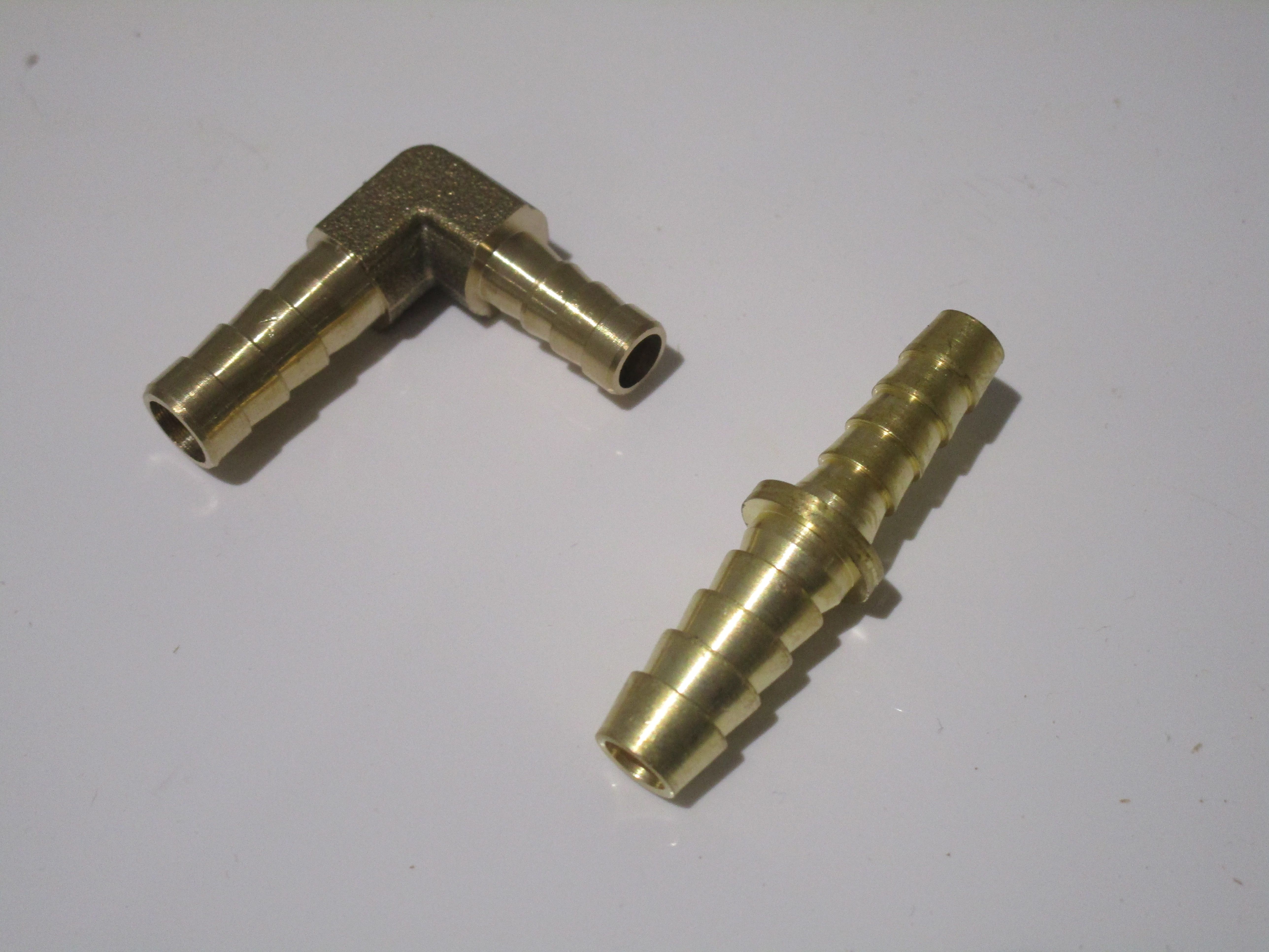

    Theres various pumps on the market , Facet and SU being two - Facets can be noisy so i went with SU ones but the choice is yours . On the tank end one however the outlet pipe is 8mm and of course the main front to back pipe is 1/4 inch ( 6mm ) so i needed an 8mm to 6mm connector , these are available in straight or 90˚ bends - i fitted the 90˚ one on the Singer . fit a cover over a tank end pump to stop it getting hit with all the spares we tend to carry

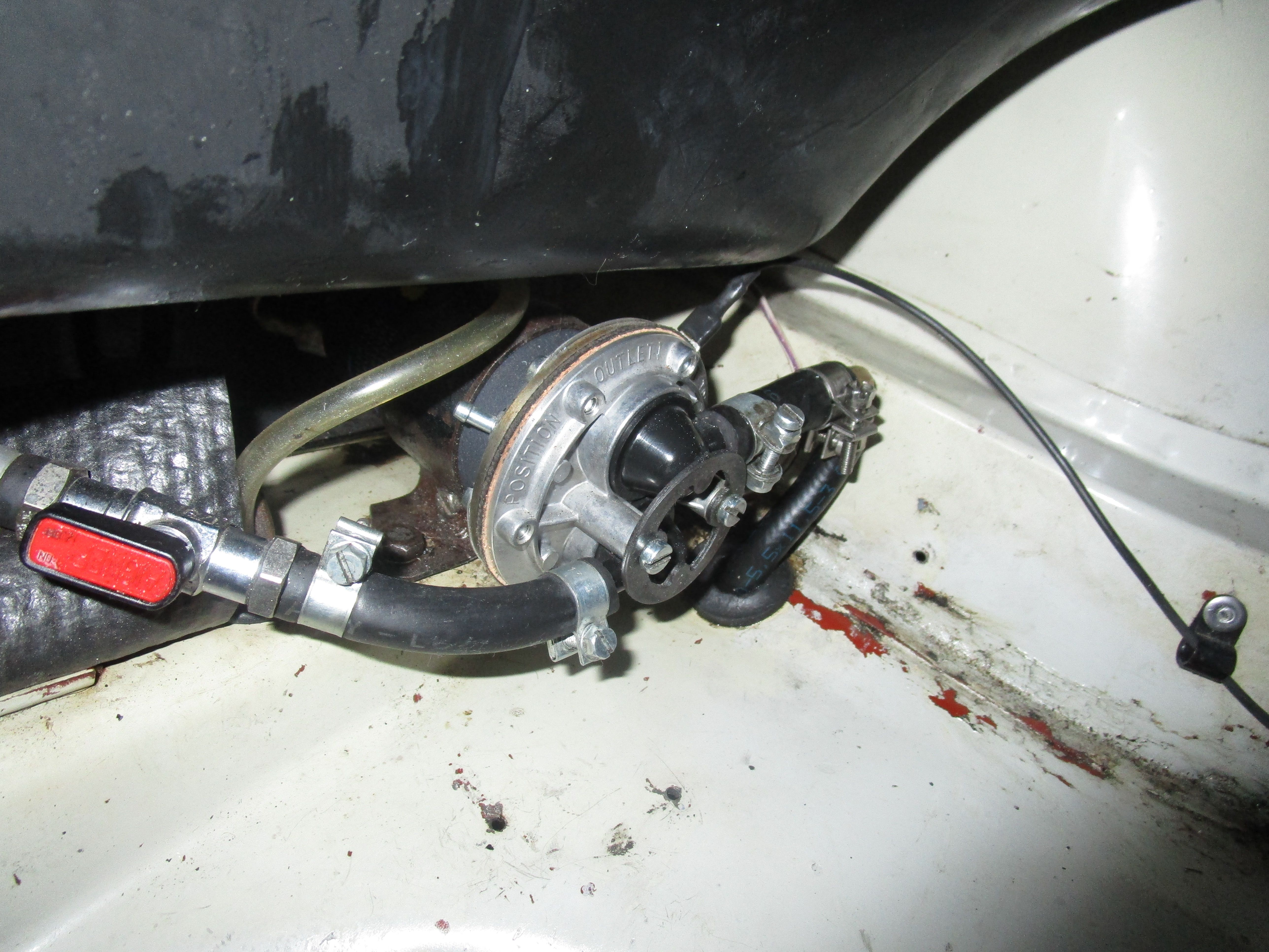

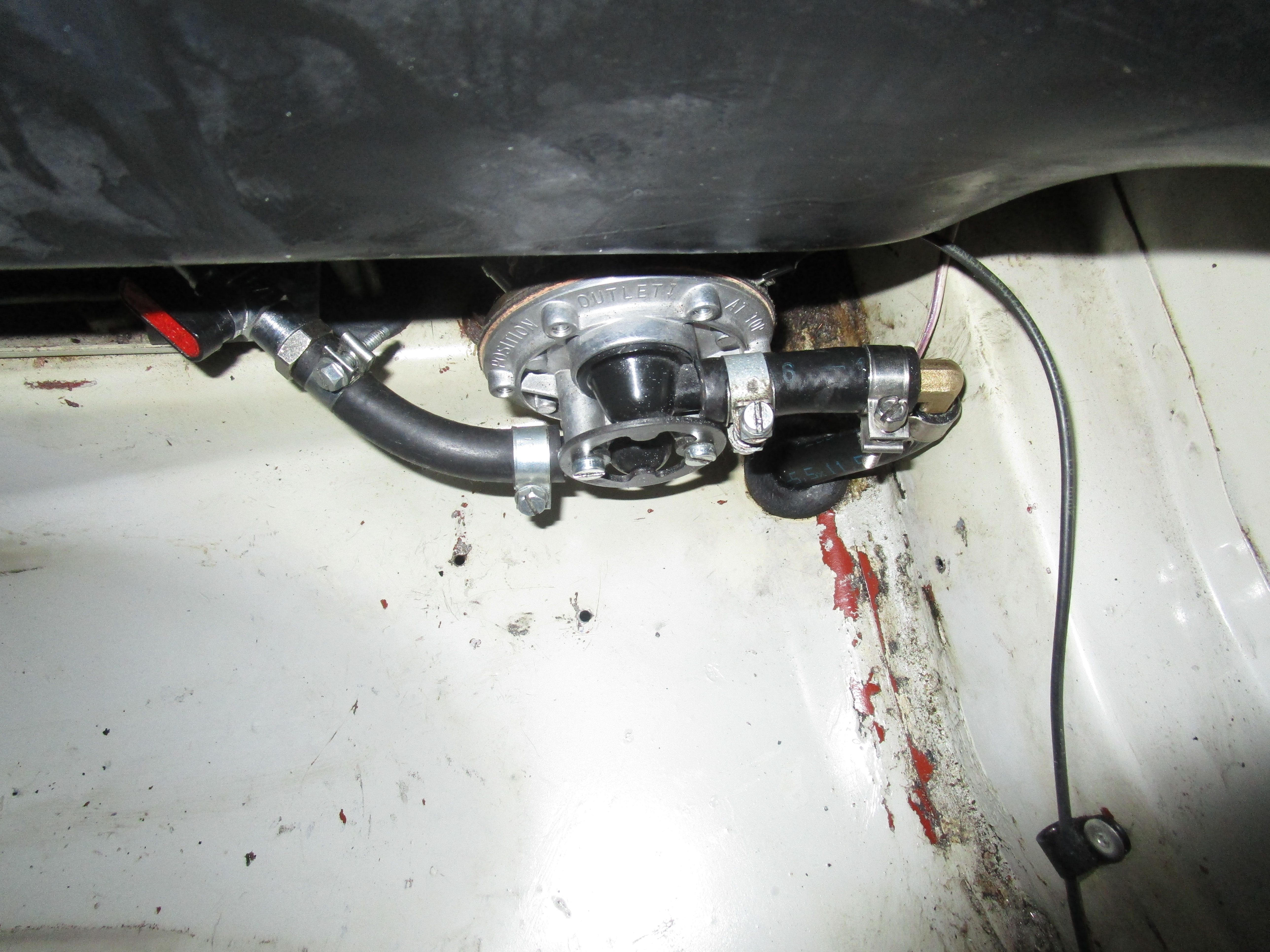

    Pump fitted well here under the tank - not the shut off tap

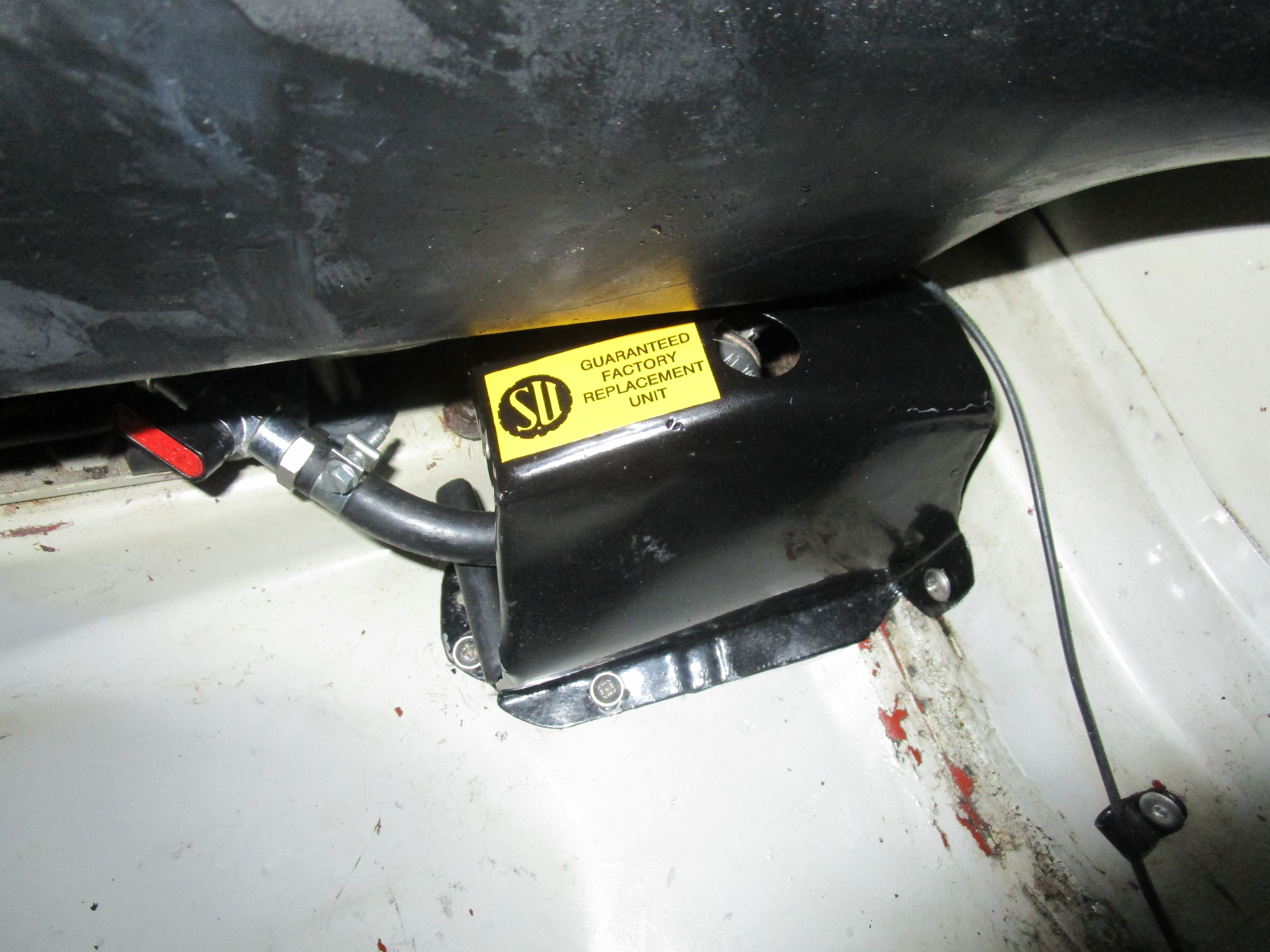

    Cover added

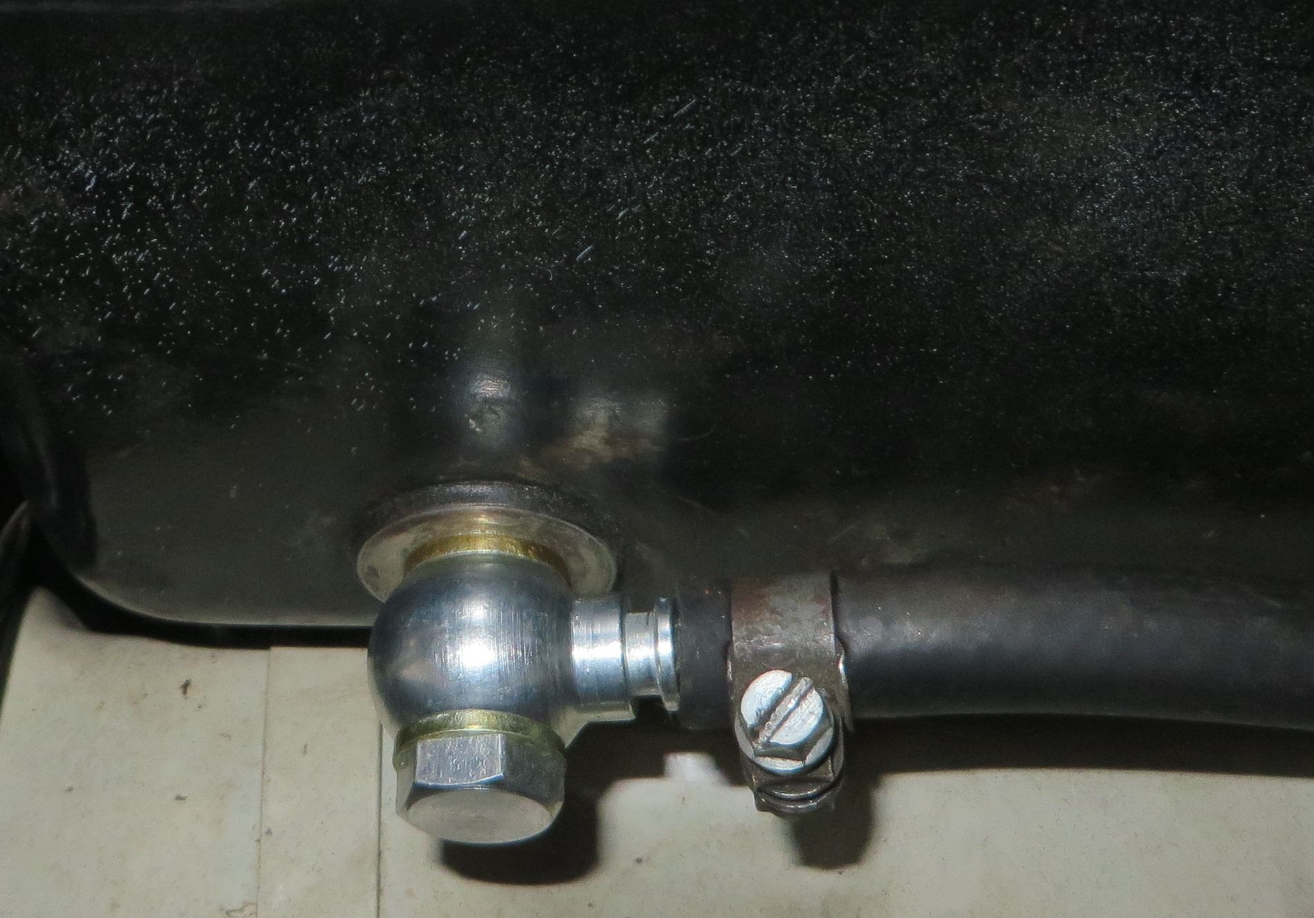

    Banjo tank fitting

    8MM to 6MM connectors
    Click image for larger version  Name:	IMG_2042.JPG Views:	0 Size:	2.01 MB ID:	3036

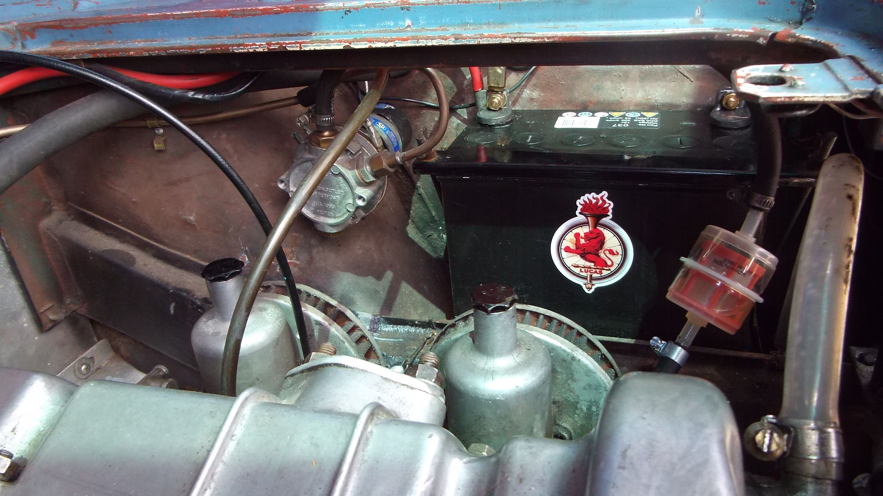

    Engine end set up
    Click image for larger version  Name:	DSCF3302.JPG Views:	0 Size:	618.4 KB ID:	3037

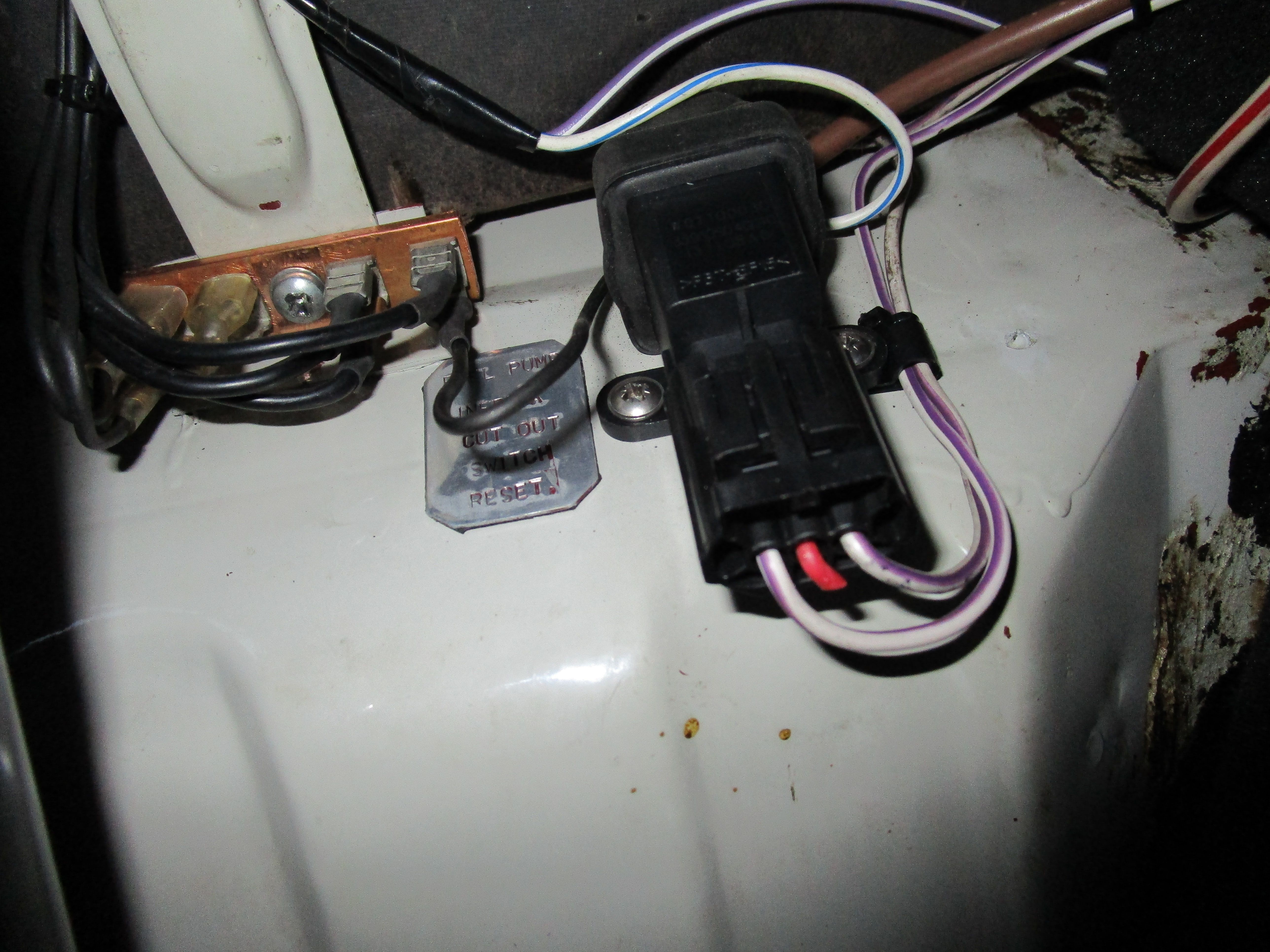

    Forgot to add this . its the inertia switch for the pump , you might spot the common earthing point above it , more on this another time Click image for larger version
