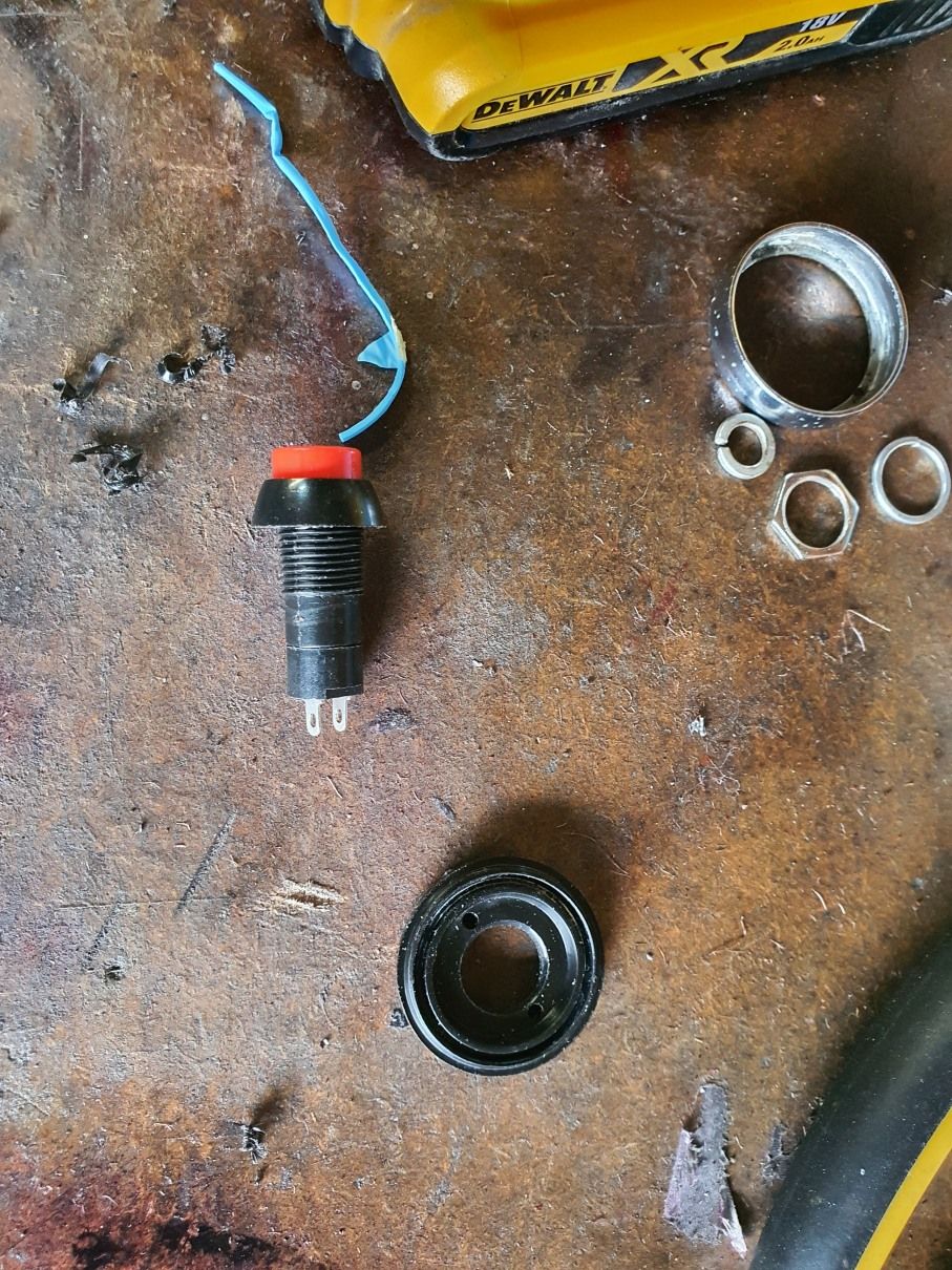

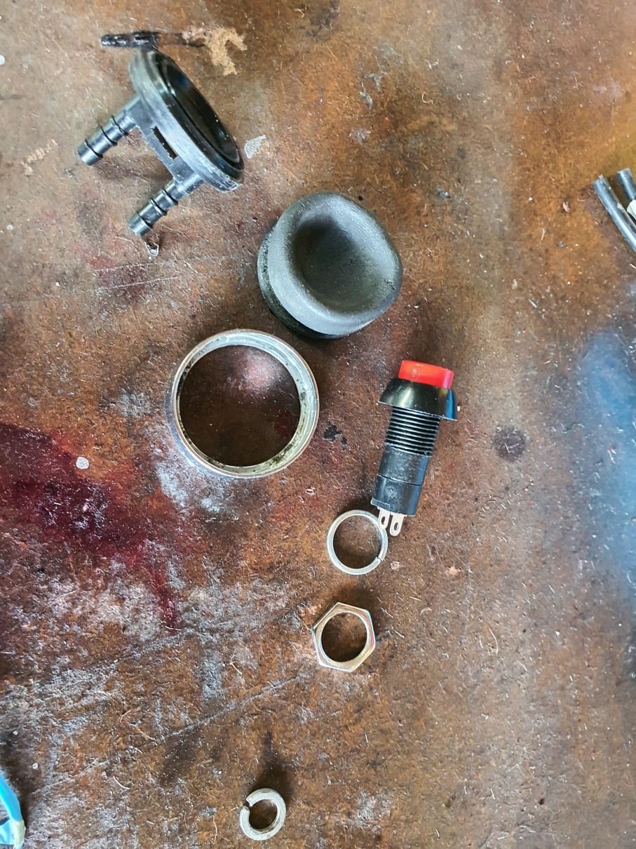

    First we start with a punctured washer button, its pretty tatty but does not ned to look mint.
    Button split and here we have the push button switch for the washer

    Ends now cut off (binnacle needs drilling for the switch so retainer not needed) and flattened off

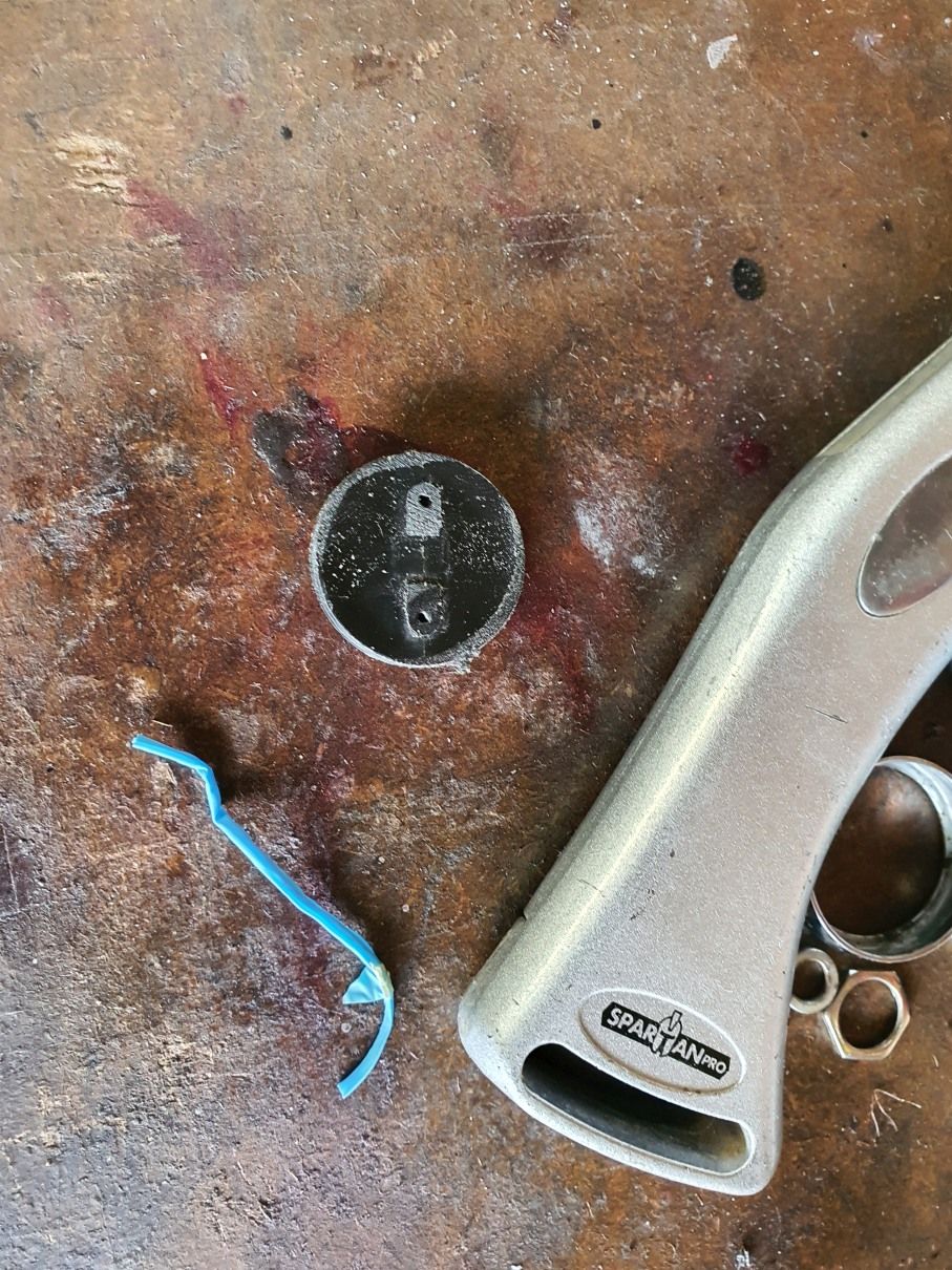

    Hole drilled in the base of the washer button to suit the switch

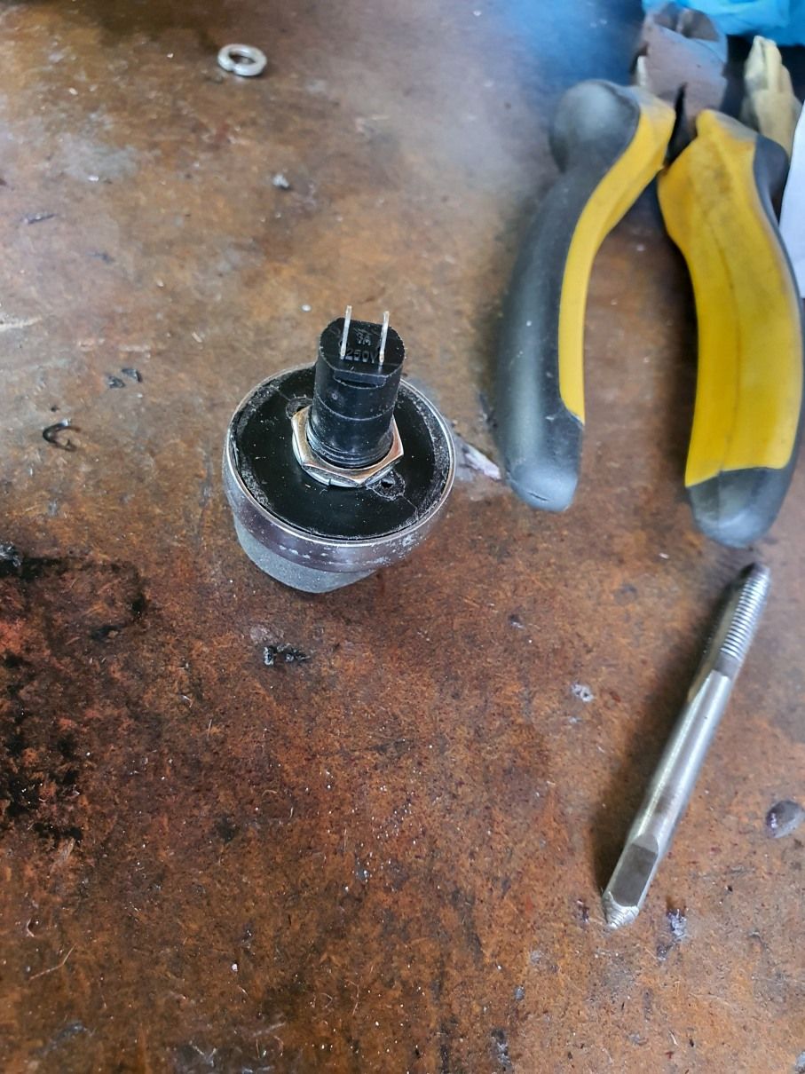

    And now install the switch then re-assemble the button

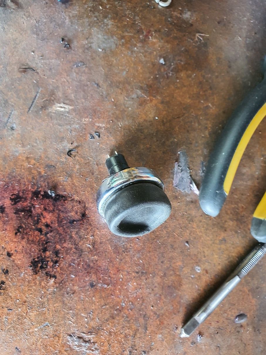

    Deed done, a bit of a clean up and drill matching hole in binnacle and the whole button will be hend in place with the new push switch
