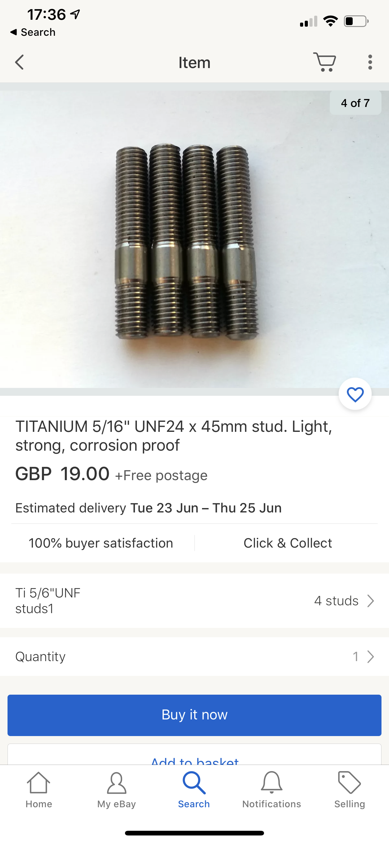

    Titanium replacements on there way!

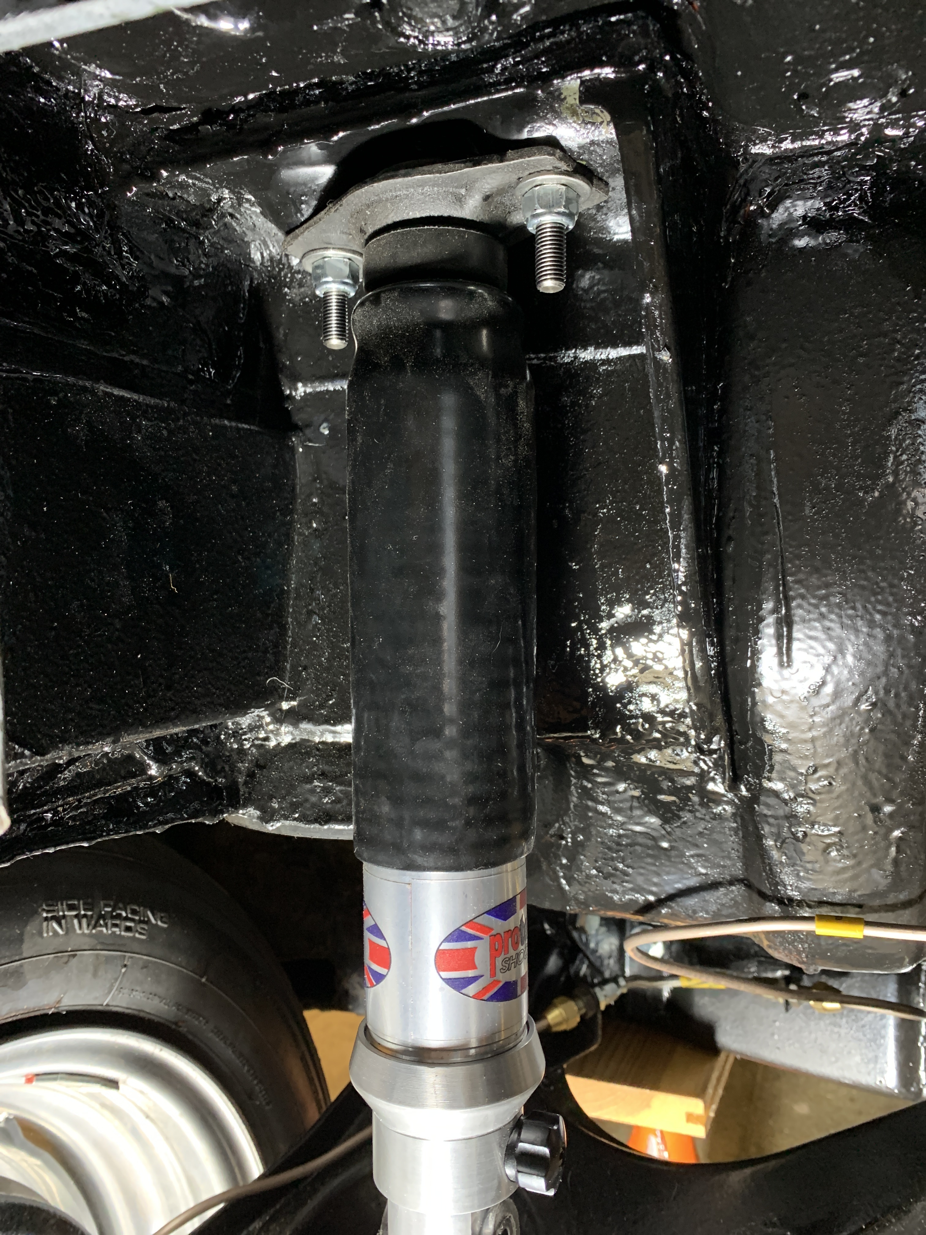

              Hi both, all fitted now and working perfectly, unf both end of the stud. Thanks for the warning bob. That was initially my concern that the threads would be different.

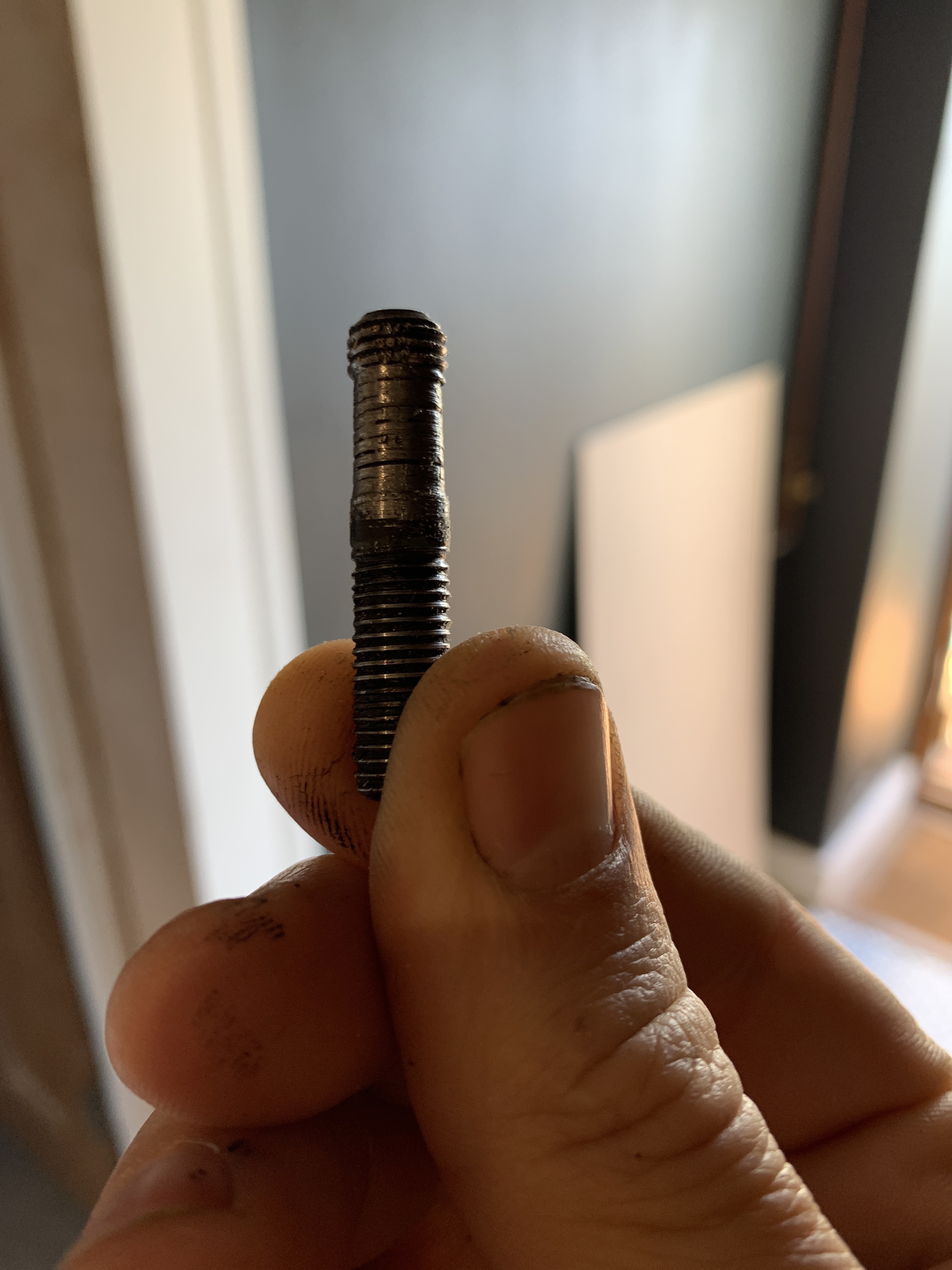

                High_dan do you have picture of the studs you removed ?
                look at the threads that went into the body! Was only a couple of threads holding it in.

                  That's horrible , my guess would be that the stud has been turned around at some time in it's previous owners life ? stripped a nut on the damaged section ,so turned stud around so as to be able to get a nut to lock up.SOD the safety
                  Which way around are you fitting them ? l would check the depth of thread as l would prefer to put long threaded section into car , it makes sense to me , also worth checking thread in the hole that stud came out of, if it's been rattling about could have damaged thread but if you wound it out ok those good threads might have acted like a chaser or thread restorer .
                  There is fresh air above the top of damper and the floor isn't there? Mike pointed out that to me, l also found that the original mounting plates had too small a hole to accept the rubber bushes properly , holes were 16mm but spigot on rubber bushes is 18mm so l opened them up.So rubber bushes fit snuggly into mounting plates.

                    Thanks bob, I cleaned and chased all the threads. The longer section was too long so had to use the shorter end but more than happy it’s connected and safe with blue loctite. Was shocked when I saw that stud, threads still in tact on the captive nut so must have been put in like that.

                    Did have to trim a couple of threads of the end of shock tho as was contacting the body.
                      I didn't want do that so made a 4mm spacer which sits above gaiter .
