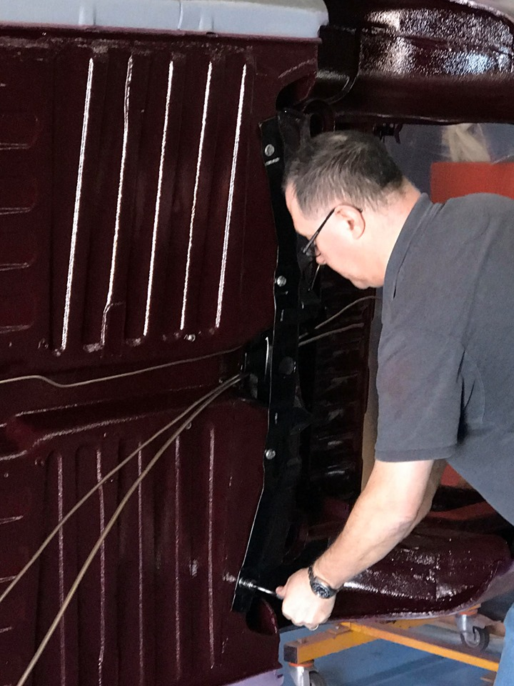

    I have 2 build threads in another category for DDG220C and JDL889F which have the car on its side showing the routing of the brake lines.
    Sorry if you had trouble posting images, it should be easy, just checking it below

      Thanks John, I did find a pipe route map you had posted which confirmed as I thought it should be.
      Had to order new Tee pieces for the front and rear but they'll soon be here so can carry on plumbing.
