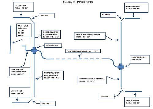

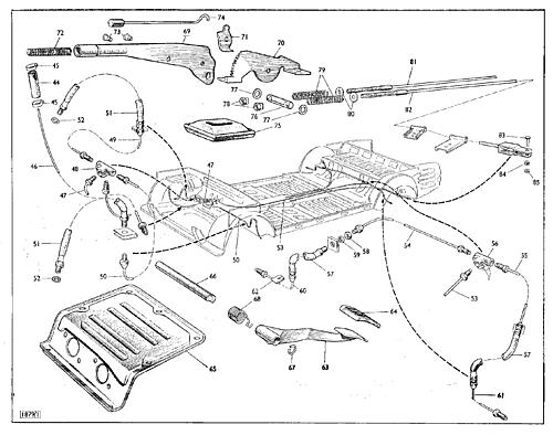

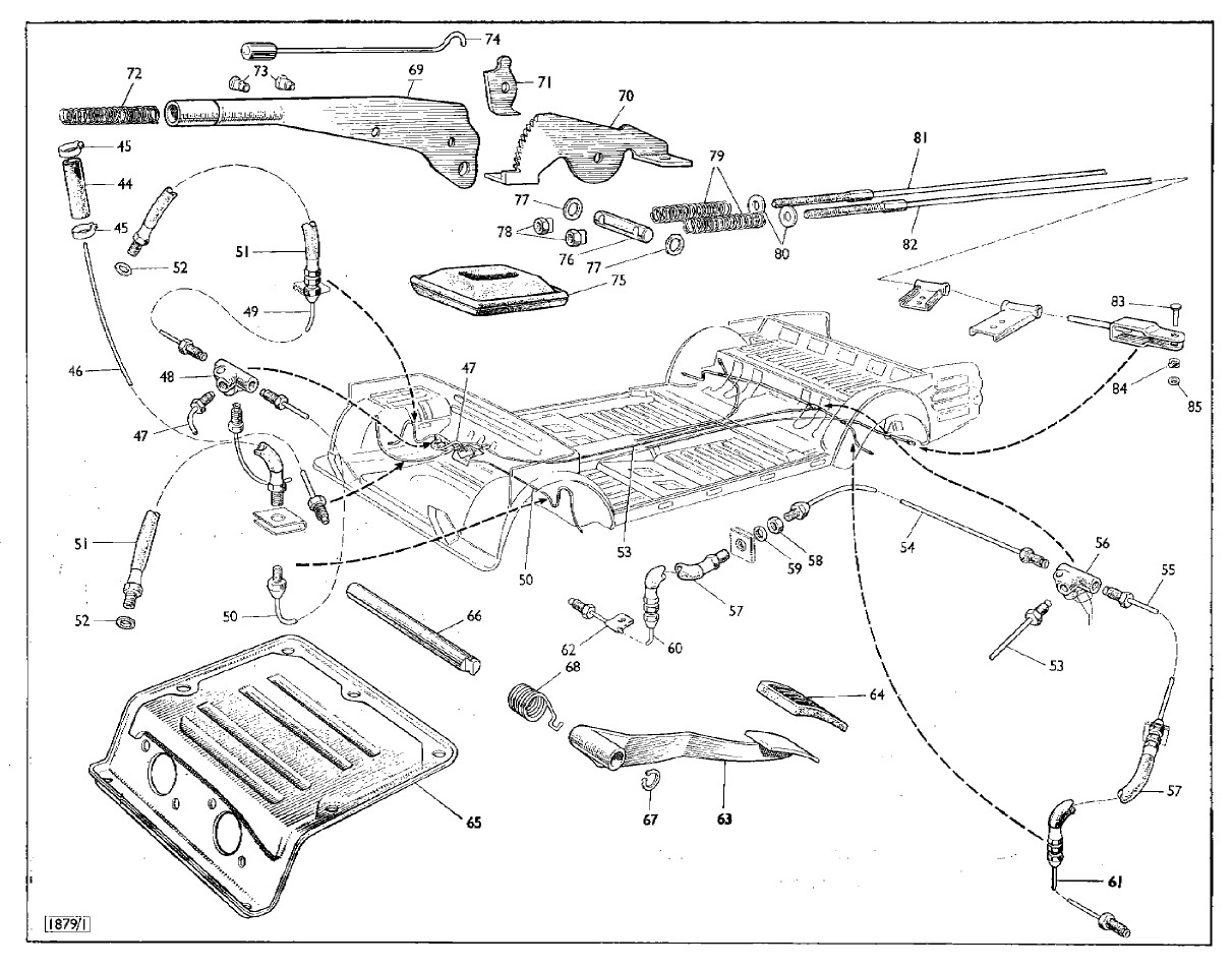

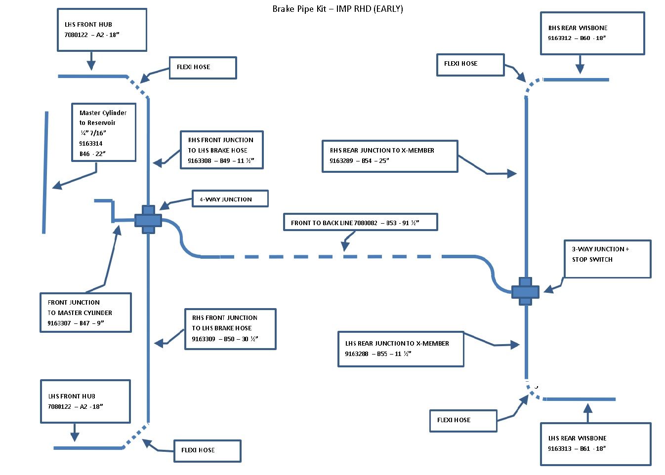

Something I keep laminated in the brake pipe drawer in the tool box. It does however assume you know the required unions needed. I will post those when I get time
