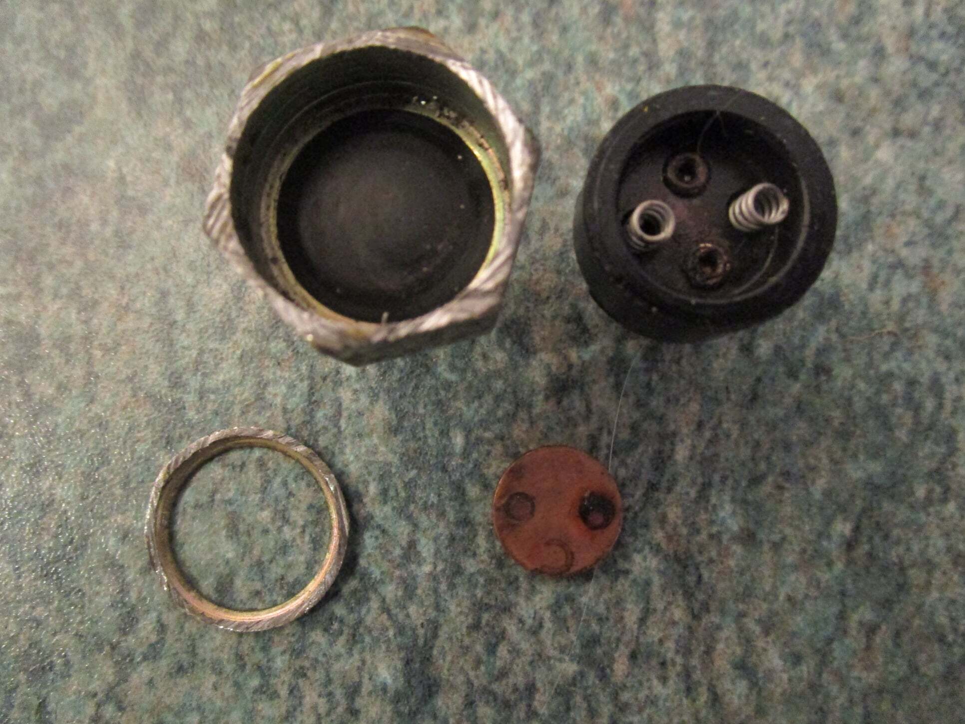

    Last weekend the Singers brake lights went all to pot and only came on if you really braked hard .
    Ive fitted a new switch and its now working as it should .
    Anyway just to show you what goes tits up in them ive cut the old one up .
    You can see brake fluid has leaked inside the electricery part , the copper contact is burnt especially on one side and the two small contacts on tother end of the spade terminals are black and corroded - springs are the only bits that are still OK .

    Nice one Dave, never actually dissected one
    These actually switcha fair bit of juice, 42W so I reckon at least 3A plus for a lot of operations, I am actually surprised they last as long !
