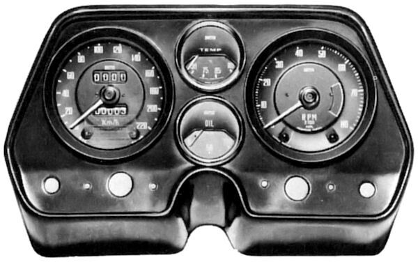

    Lots of folks sorting themselves out works dash binancles these days.
    What instruments were actually used and was there ever a manual or works instuction on how they were configured ?
    Temperature, Oil Pressure and RPM, very posh.
      Just dont worry about fuel in tank or oil pressure, oil pressure pretty important in a screamer
      They always had extra guages
        Original gauges were off something rare IIRC
          Lotus cortina i believe

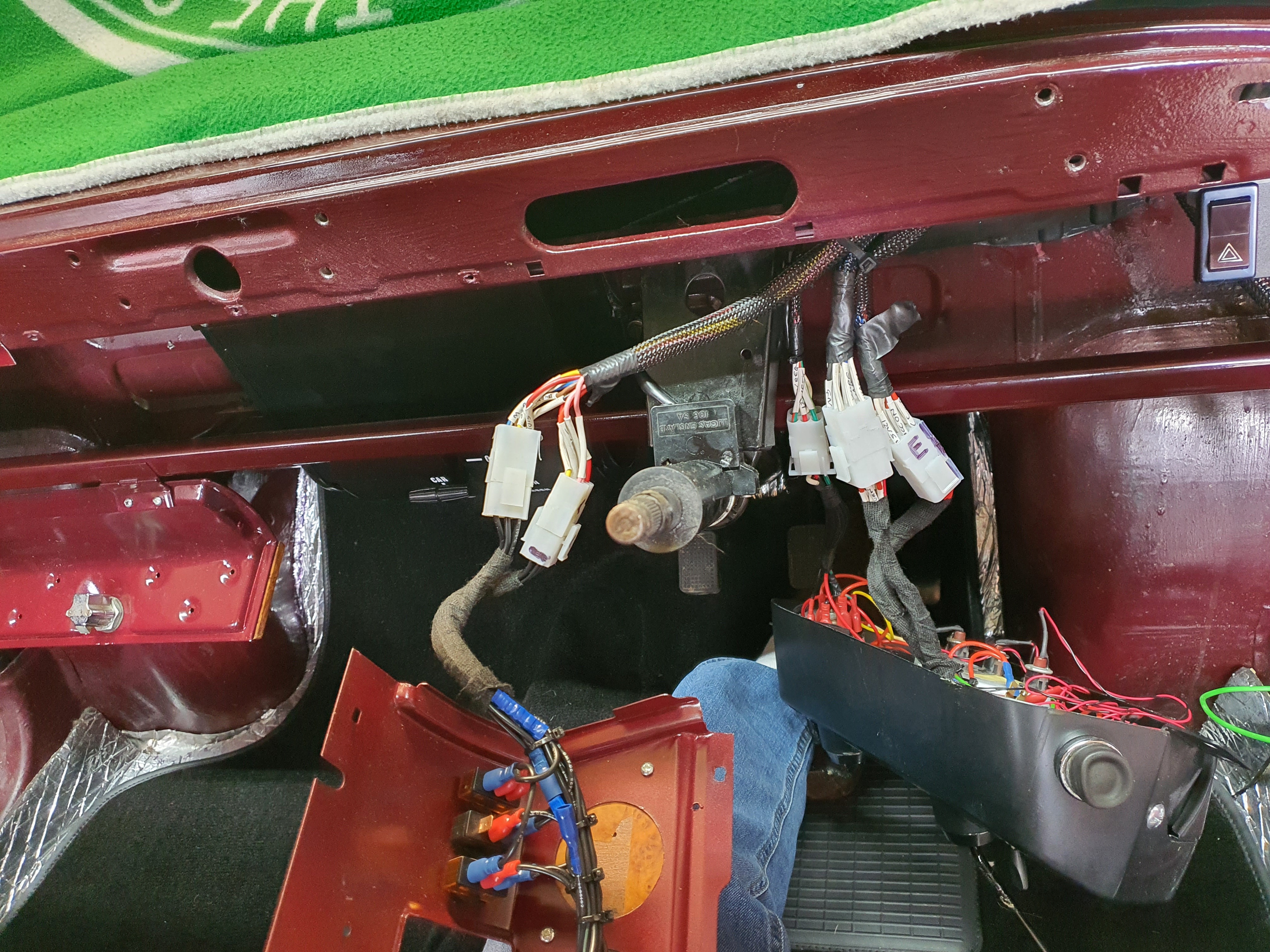

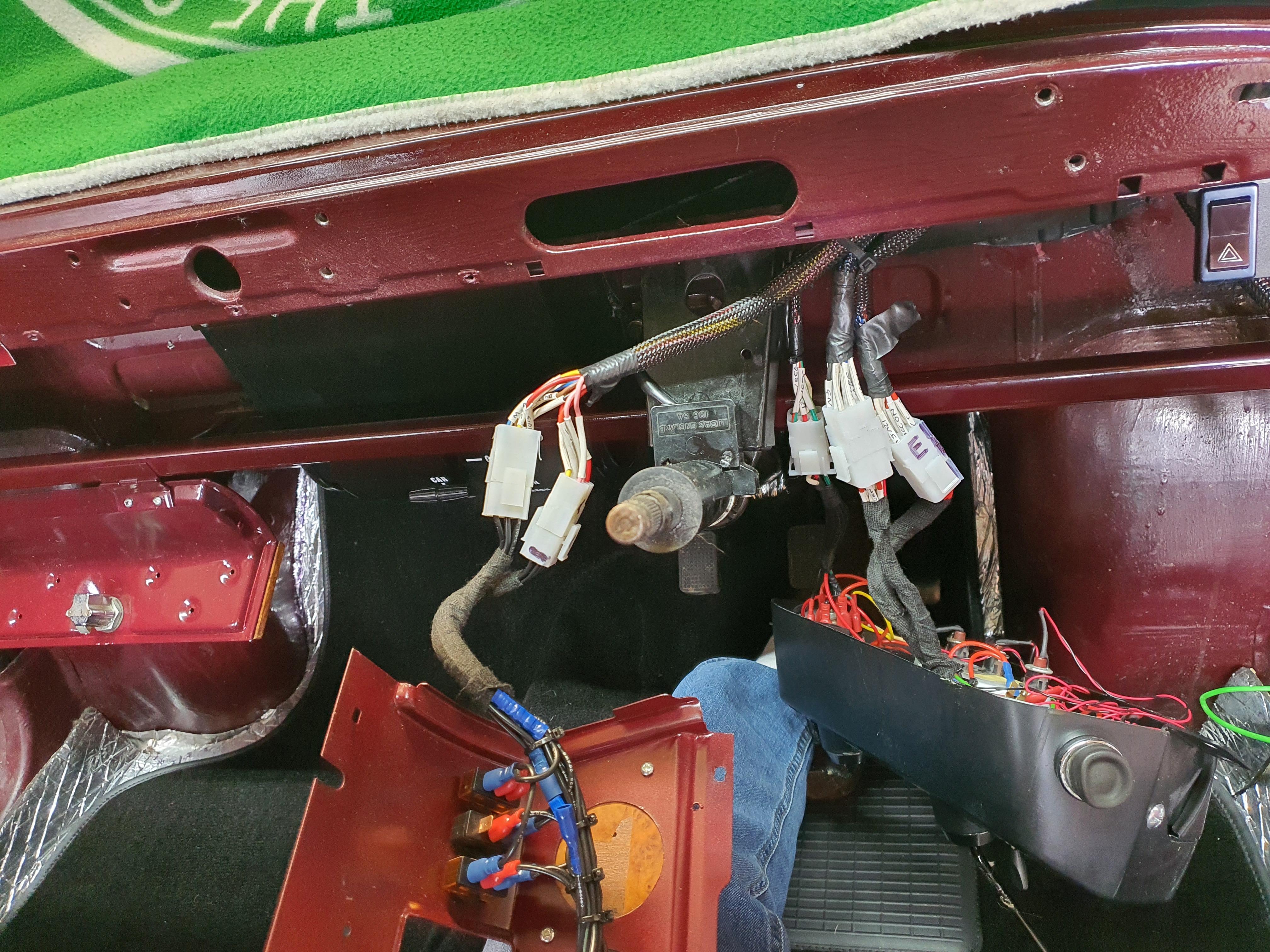

                  I would only consider fitting genuine rebuilt lotus clocks if it was going to be a true replica or a restoration of a proper works car or if the customer wanted them. There are plenty of period looking gauges if you just like the style and layout of the works dash. I would use the more available 80mm clocks as the dash is very cramped with 100mm gauges. The best thing you can do when doing this conversion is wire all the clocks and lights etc and fit a multi plug so if a lamp fails it is easier to remove the whole binnacle rather than risking knocking wires off when reaching into the back of the dash and then trying to work out which goes back on which spade. I can have my dash binnacle out and on the bench in minutes i designed the installation in such a way everything is captive. in fact the whole car is designed in such a way that 1 man can dismantle the whole car as everything that is bolted to the car is captive nut, stud or on quick release fittings. On rallies i do you do not have a service crew and on the road sections you 30 mins lateness so anything that can be swapped in say 25 mins can be done (i.e. no point carrying a spare dive shaft) I only carry 1 allen key 3 spanners and a flat and posi screwdriver and anything that can be fixed in 25 mins can be swapped. Anything more than that you are out of the rally anyway.
                    Mike
                    My binnacle is already on multiplugs, as is the chammy centre section, as you say, out / in in minutes

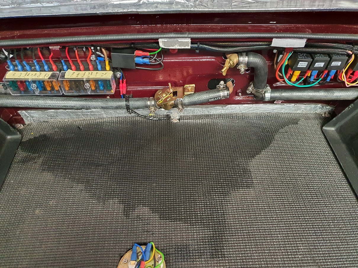

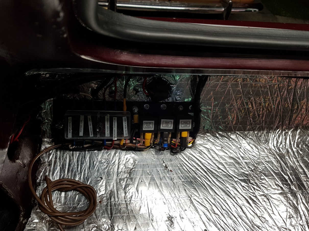

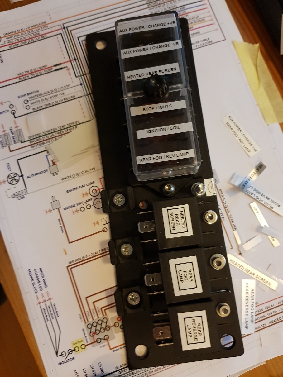

                        I wired the whole car modular Mike, all controls for stuff at back is at back including point of load switching and supplies and fuses, most cables now running around are just control cables.
                        Back control module and fuse bar

                        Front relay bar and fuses.

                        Back realy bar in place, all the wiring is now internal as I had the back wings off I added channel for them

                          Does have one screw up somewhere though, schematics are fine, but must have one of the relays wired wrong as have 100ma or so drain when ignition is off. Just need to get a hand one day to find it.
