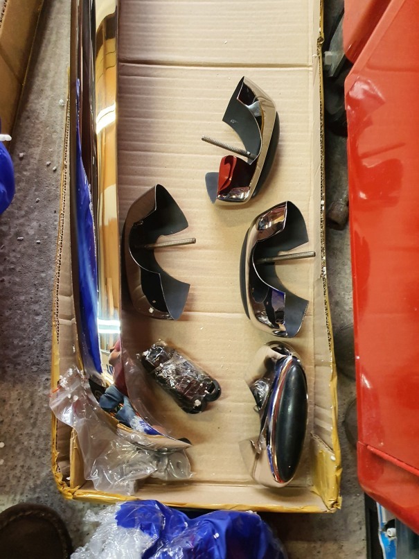

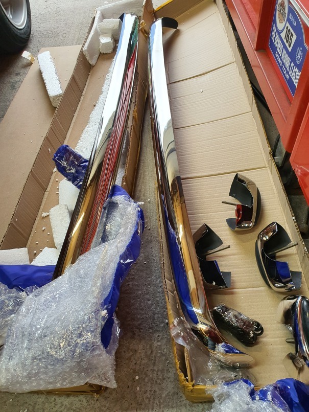

    I had already seen these fitted to bill penmans Imp and I know Peter Nunney has a set. Both reckon quality wsa good but both had to do work on the bumper irons.
    When I ordered these a few weeks ago they asked for confirmation of hole locations, which was duly provided and also if I wanted the hole in the rear for the old crank style handle.

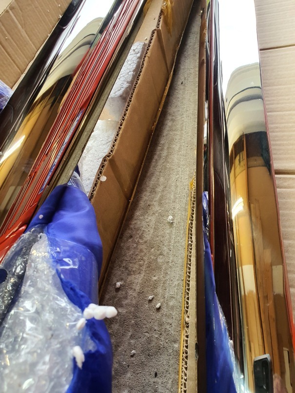

    The packing was great, everything was bubble and cloth wrapped and all the new hardware was supplied with the bumpers.
    Shape wise they are a little different but not so much the shine cannot hide it
    Here are a few pictures of them unwrapped, I will add them to the car later and do a compare for folks to see in more detail the differences and judge for themselves.

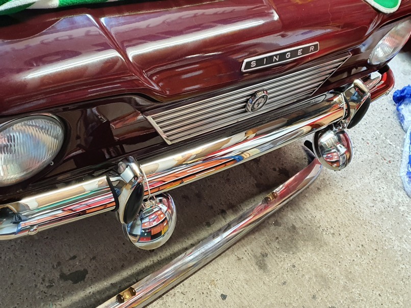

    Well front went as planned, pefect fit onto the bumper irons.
    That is except the over riders, see next post

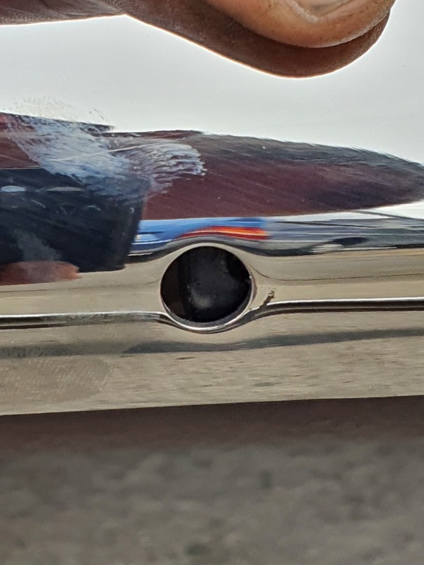

      Rear bumper, despite all the checking before hand and the people at Harringtons were great service wise, something still happened to the rear bumper
      Such is life with hand made parts
      First the "inner" holes were too close together despite emasureing, I think ththat perhaps the measure was used around the curve rather than straight
      Anyway end result is the same, standard rear bumper irons will fit on outer holes but inner still too short
      This is a lot closer than the ones Bill received as he had to effectively make his own bumper irons (modified fronts I believe)

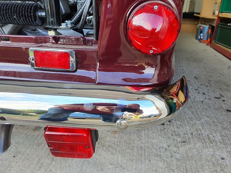

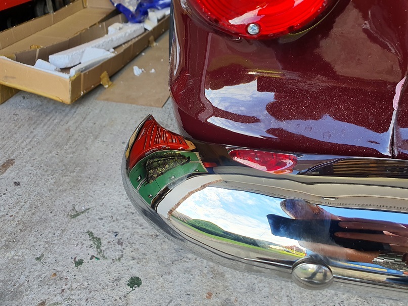

      Second is rear bumper seems to have a twist which i will need to investigate more

      Now that shows the more or less mirror finsh and as I said the images fdo not do the finish justice and in stainless it should stay that way for a very long time !

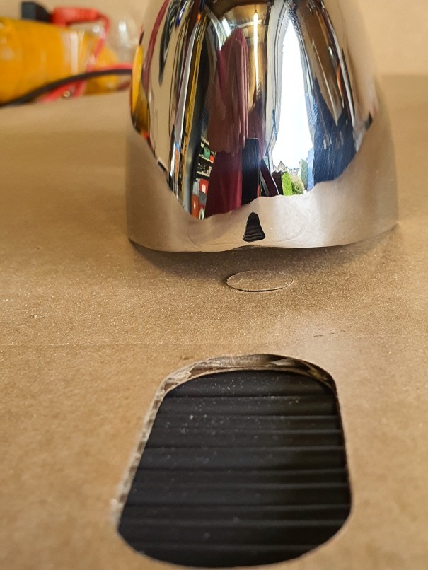

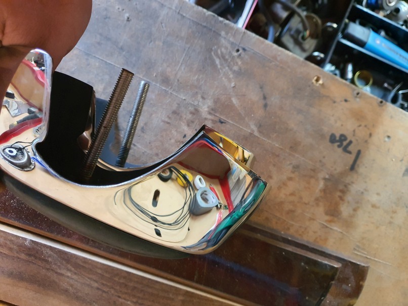

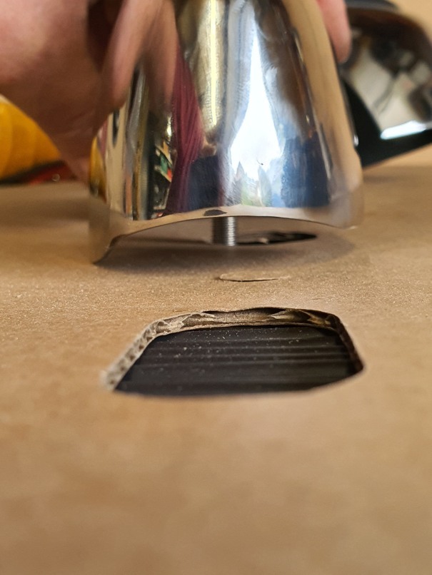

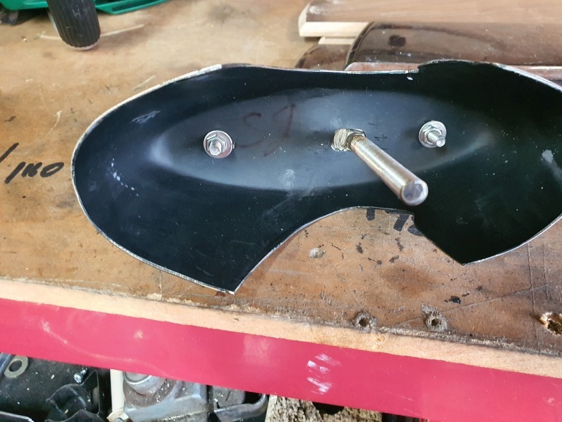

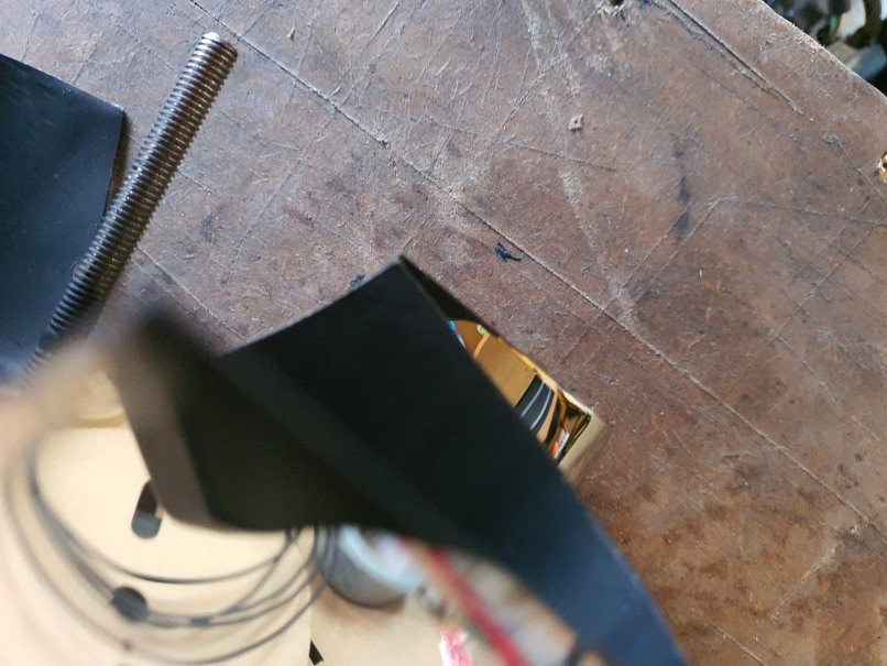

      But by far the biggest issue
      The over riders, two were identical and fitted to front. What can i say, I have no luck what-so-ever !
      However quality control went right out the window on the other two which were both different shapes which can be seen easy by eye.
      Different shape, different offset so sits round in place looking very odd and one with a slot.
      See difference left to right. Image on left seems to be missing the end tip and right edge !

      Difefrence in top edge easy to see again

        Like you say ,quality control ? they're nowhere near good enough , you just wouldn't be happy sending those as a matched pair, do people not think about possible future orders?
          They obviously care as they acknowledged issues on bumper holes and wanted to check before sending. I did not bring it up with them.
          But yeah, the over riders are a mile out. There are two that are spot on.
          Not sure on the process if the emtal is heated, stretched or oversized then buffed back.
          Certainly the one with the slot is no good

              Yes £1,500 to re-chrome and its still a chance, Pat had a look at my whinging on the over rider quality and agreed, cant be fixed or fettled, so need them to replace them.

                  Bumper looks like it will twist back to where it needs to be on rear once bolted down.
                  The over-riders tho are toast, so two new ones on way today I believe.

                      Ultimately the front bumper set was a non issue and all is well. Drops on perfectly
                      The rear bumper however, the inner holes to the irons are slightly out and will need massaged, but unlike issues before which other rported, no custom irons are needed. The holes are sonly 10mm or so off, I think they took the new measurements and rather than roind bumper, they did a extrude and straight line, landing them to far "inwards"
                      The over riders however, two were not even same shape as reast.
                      They have acknowledged the issue and sending replacements
