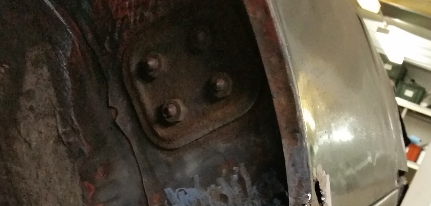

    The lower hinge plate screws are always a royal pain in the backside for me.
    I rarely now try and remove them, instead I cut back the exposed threads as they are normally so swollen with rust they will never pass back through the captive nut and let the heat work its magic on getting any other rust loose.
    Dont go further than the surface of the captive nut otherwise you will need a new hinge plate
    Worst case some of the freezer spray for electronics that you can buy online sprayed on the head of the screw can also help in stubborn ones
    Never had one fail to come away by doing this, chewed plenty screw heads, cussed, turned air blew and still had to cut it off trying.
