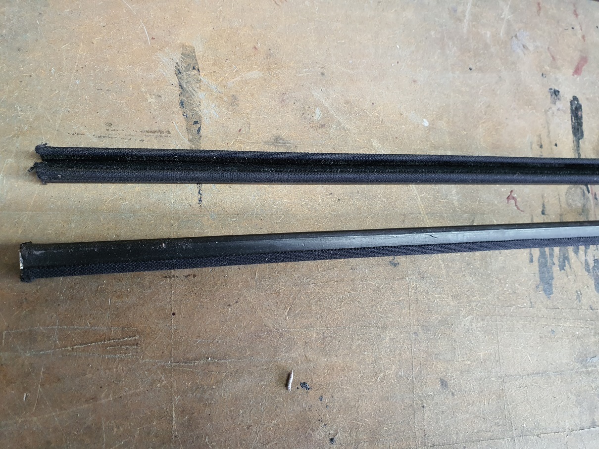

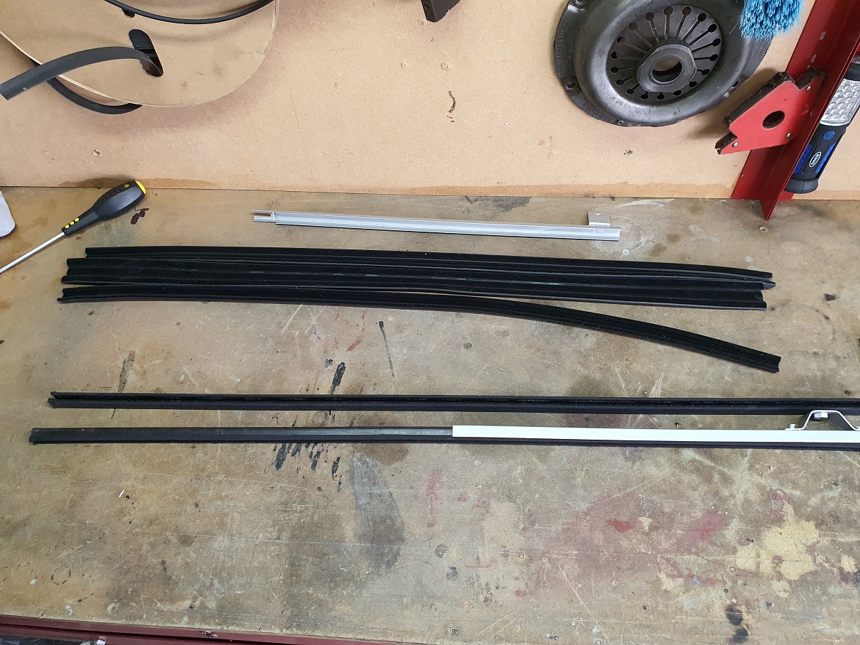

    I have some seals here but also have some rigid channel that fits both the guide and the door, althrough the door is a tad tight but the old one ws no picnic to get out in first place.
    The rigid channel came from Frank / Roger but i only have two sections.
    This is it so far, as can be seen the rigid channel fits nicely. More to follow as I need to find good glass for the 1/4 lights first and do those with new seals

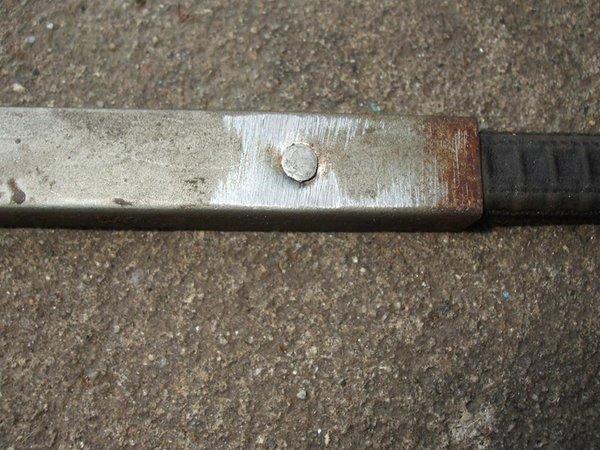

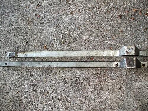

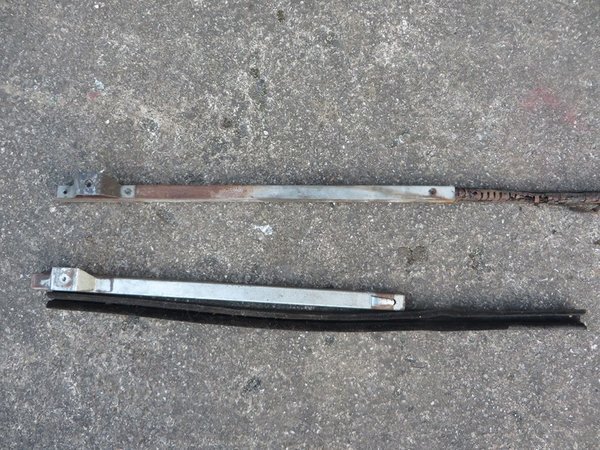

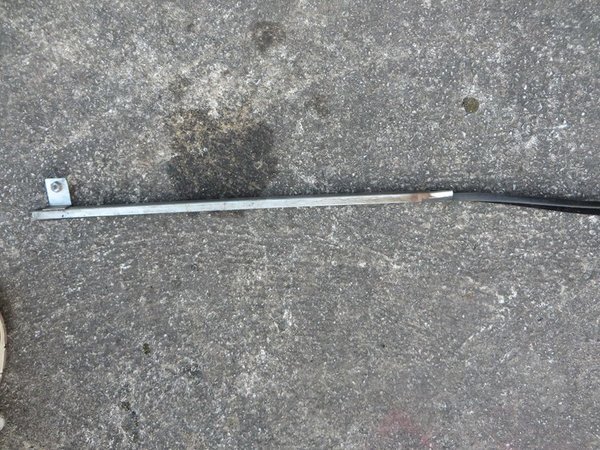

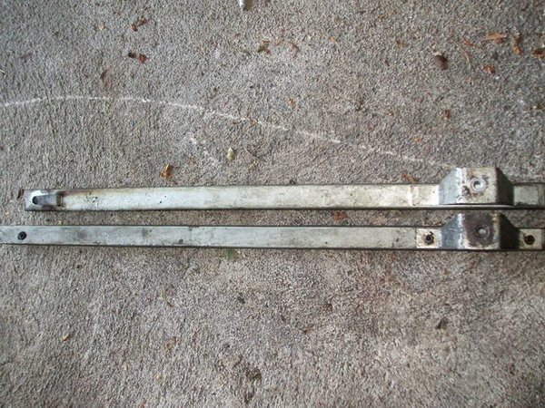

    Someone has asked about door glass channels and variations so i thought it might help if i did this to show the differences between early Rootes and later Chrysler channels .
    Fitting info , in other words what will and wont fit what .
    You CANNOT do the following ---
    Fit the later fluffy rubber glass runner into the early channel at the lock end
    Fit a later channel into an early door at the lock end .
    Fit a later fluffy rubber glass runner into the shorter EARLIER quaterlight channel .
    You CAN do the following ---
    Fit the later fluffy rubber AND its LONGER channel into any door regardless of its lock at the quaterlight end but they must match.
      Click image for larger version  Name:	18342082_10213152243580357_4336626295444719277_n.jpg Views:	0 Size:	97.7 KB ID:	15218
      Later rubber channel and runner - quaterlight end

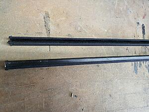

      Click image for larger version  Name:	18342742_10213152217379702_5475256306269820112_n.jpg Views:	0 Size:	103.9 KB ID:	15219
      Close up of fluffy rubber

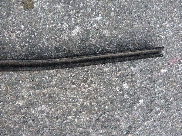

      Click image for larger version  Name:	18342484_10213152216019668_718773238447859151_n.jpg Views:	0 Size:	37.6 KB ID:	15220
      Early cotton covered channel
      Click image for larger version  Name:	18301590_10213152212739586_1124640248596096554_n.jpg Views:	0 Size:	76.3 KB ID:	15221
      Riveted to the metal runner
      Click image for larger version  Name:	18342529_10213152205819413_3921950235647513073_n.jpg Views:	0 Size:	104.8 KB ID:	15222
      Late type at the top , early below - this is the lock end channel
