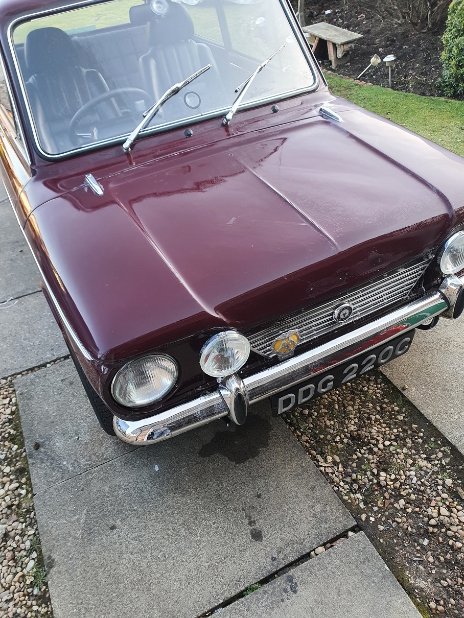

    Still, shows up every imperfection now so may as well keep going, the fibreglass bonnet, well I hate it so decided to see how thick before I attack the roof . If I screw the bonnet up, it is easier to fix than the roof

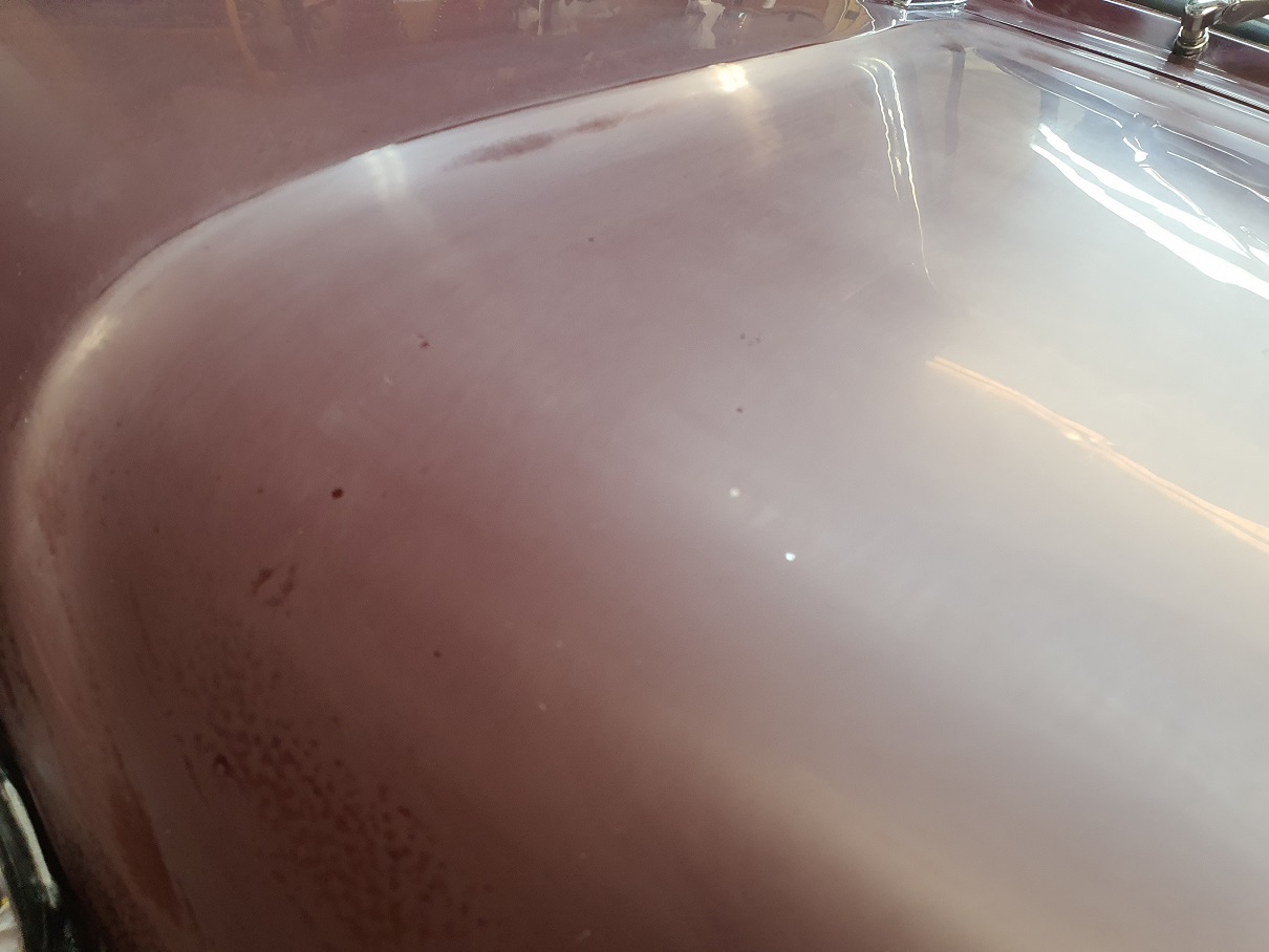

    Here is the bonnet wet blocked at 1500, still hardly made a dent in it, just shows how durable clear coat is these days.
    OK it is still a little wet, but you would be horrified to see what it looks like dry !

    Should you be afraid to attack your original paint like this, absolutely !
    Which brings another comparison with the cars on original paint vs modern paint, especially clar coat and leaving them outside. Modern paint, no problemo
    Still, blocked out still there is a huge amount of annoying bits where the coating on the fibreglass has sunk or been pitted, seems my barrier coat did little.
    The small dimples can be seen still shiny , will be completely flat later
