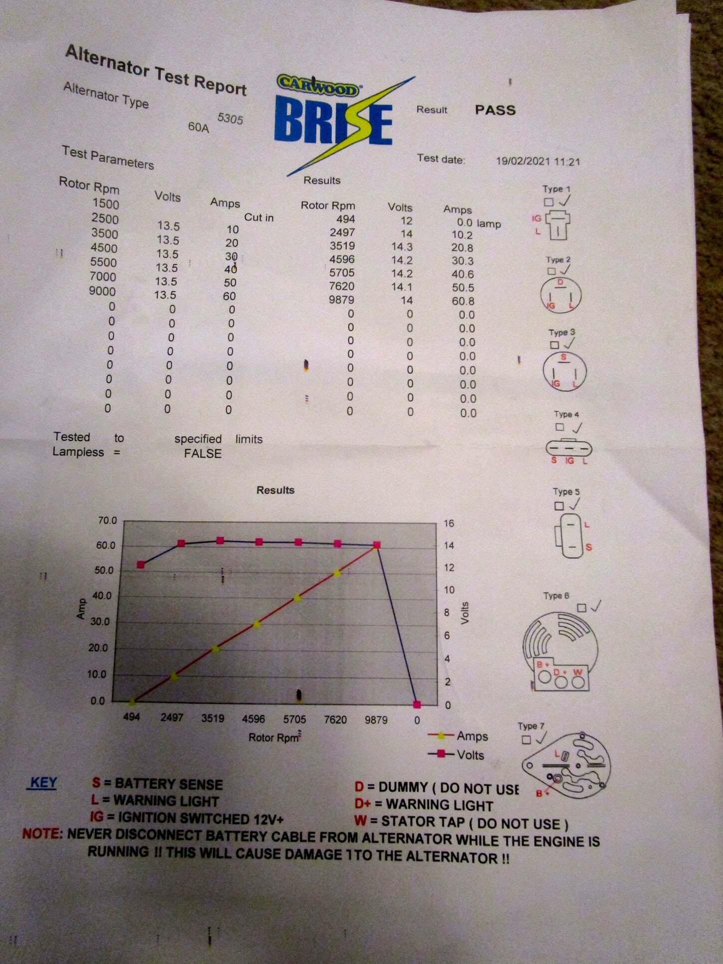

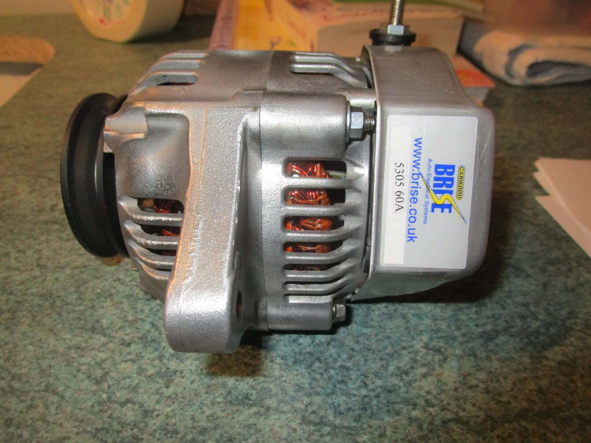

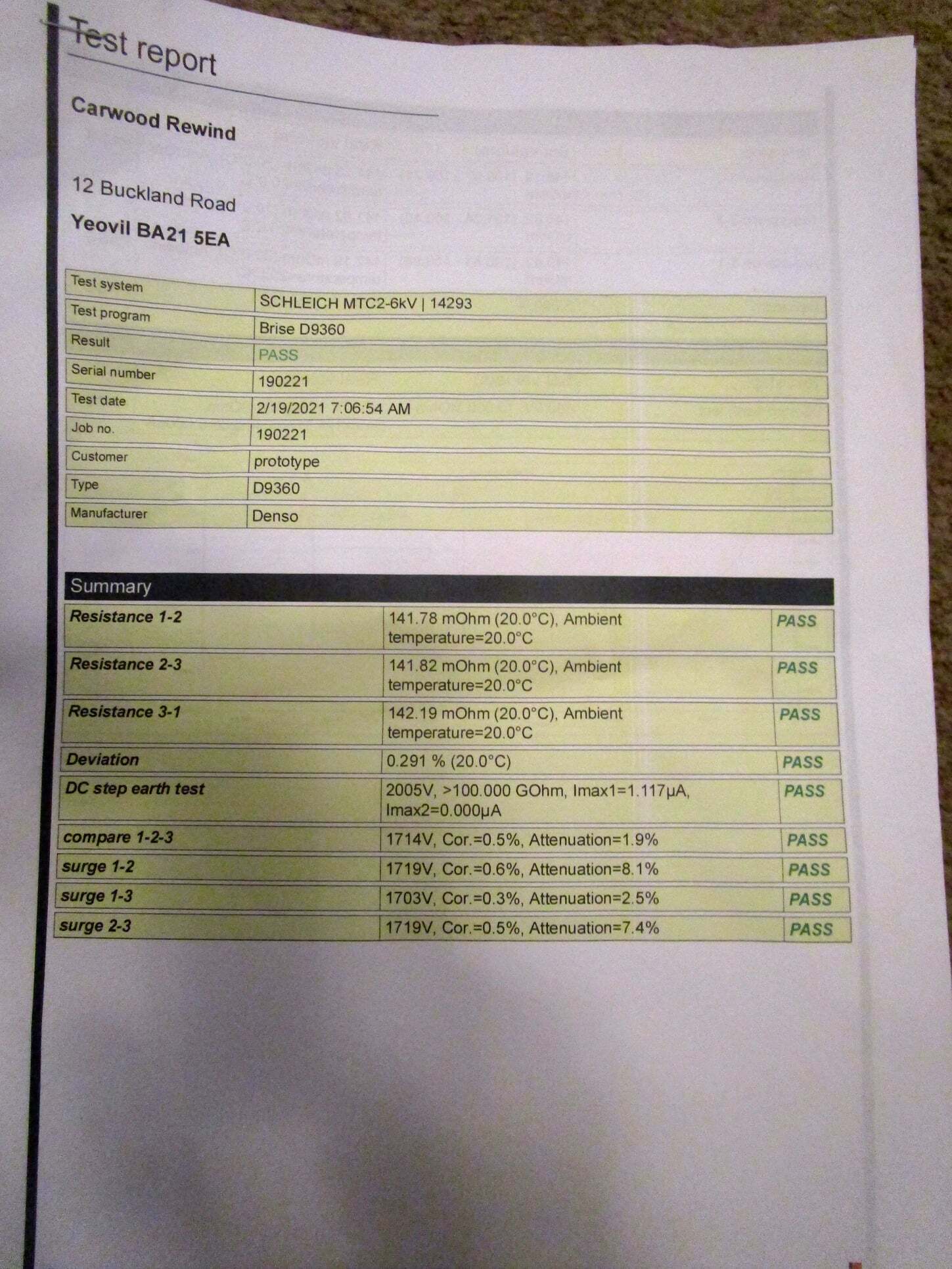

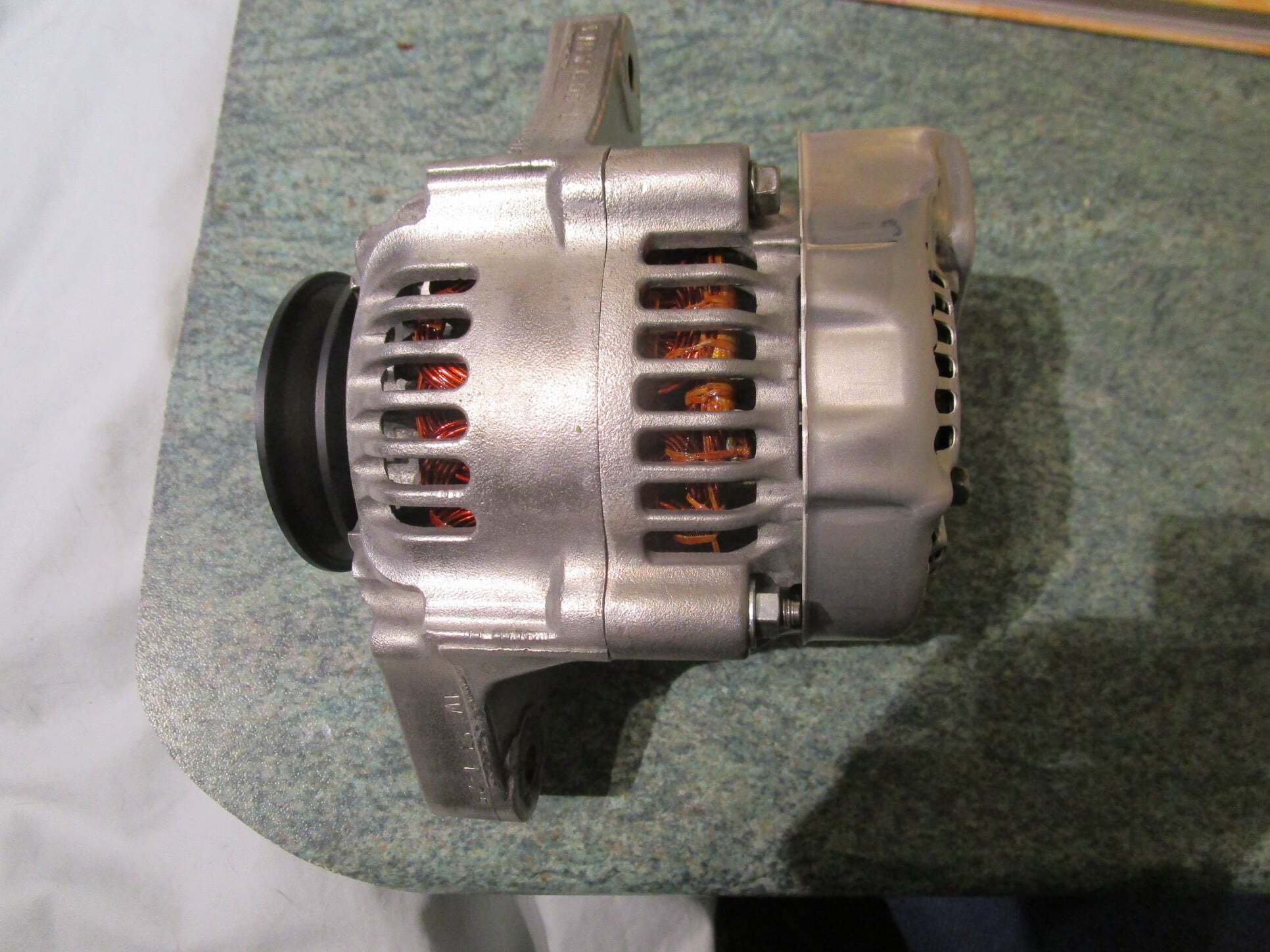

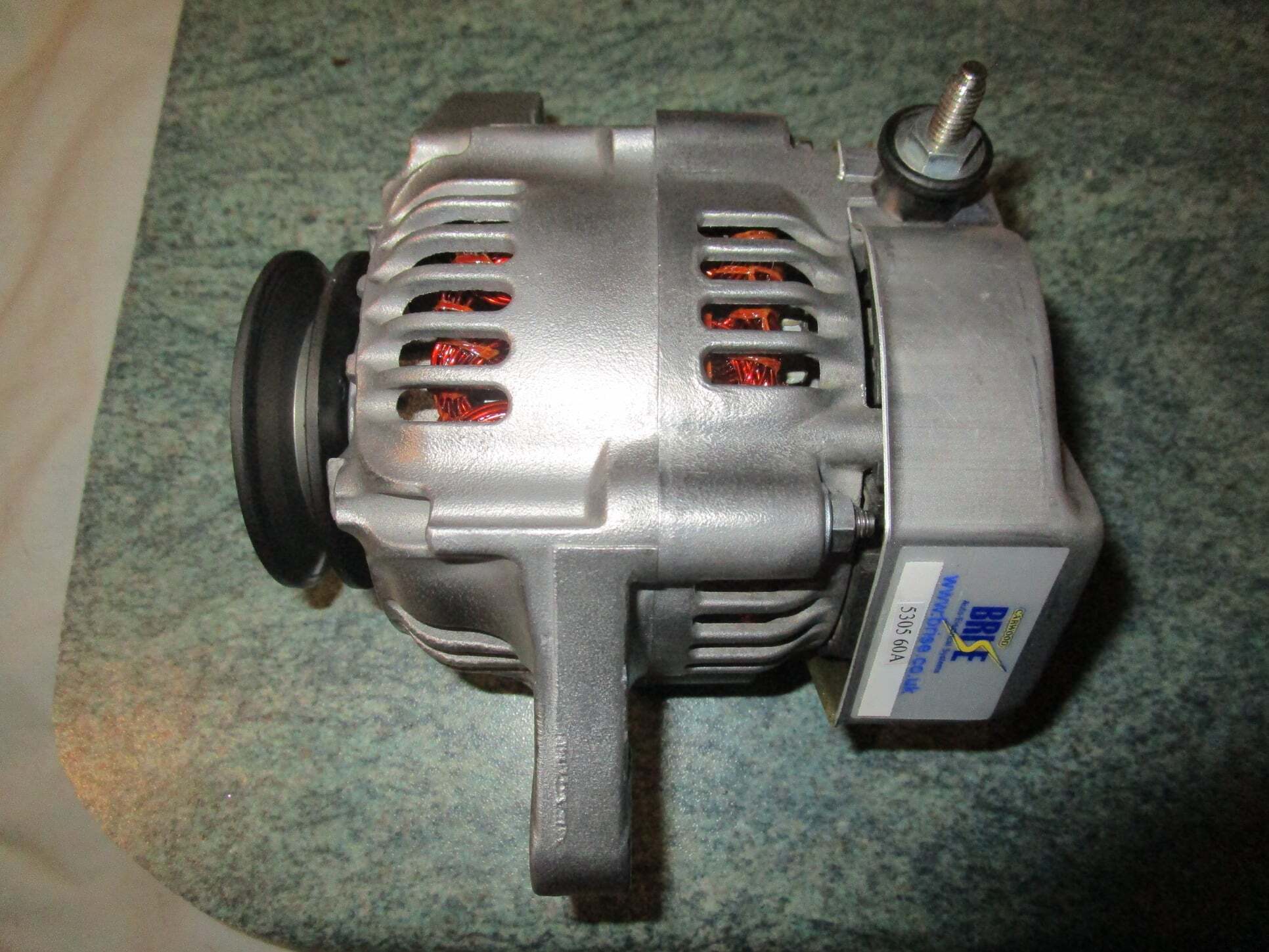

With the Vusky not exactly going anywhere anytime soon ive taken the opportunity to service and upgrade the little alternator .
I originally upgraded from 40A to 50A but have gone a stage further and upped it to 60A , Should help with the twin halogen headlights , hazards , upgraded wiper motor etc etc .
Ive also moved the main terminal post 180˚ so its at the bottom , more room at the top as its a bit tight on a Van / Husky .
Might fit it this weekend if i can be bothered
