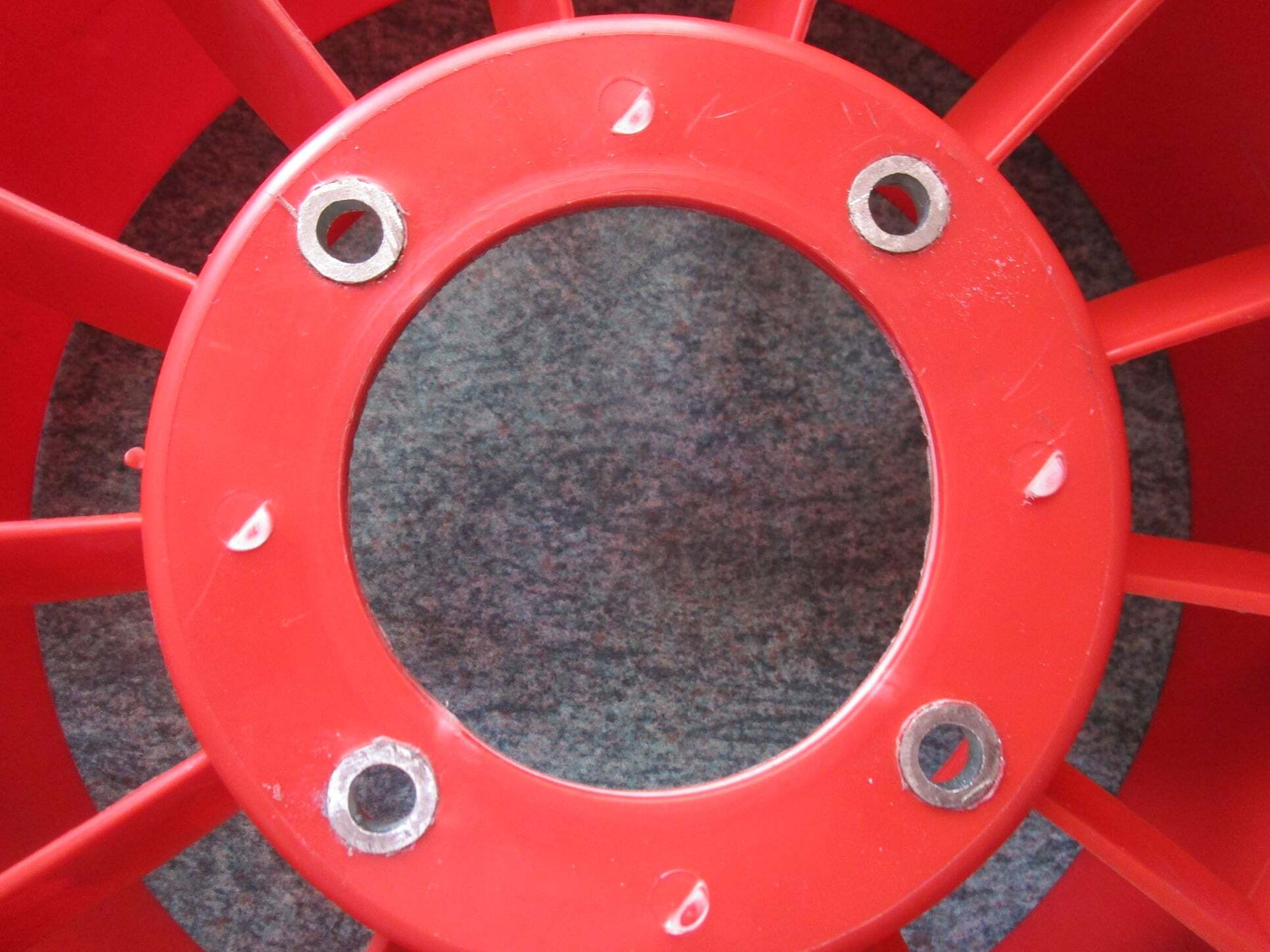

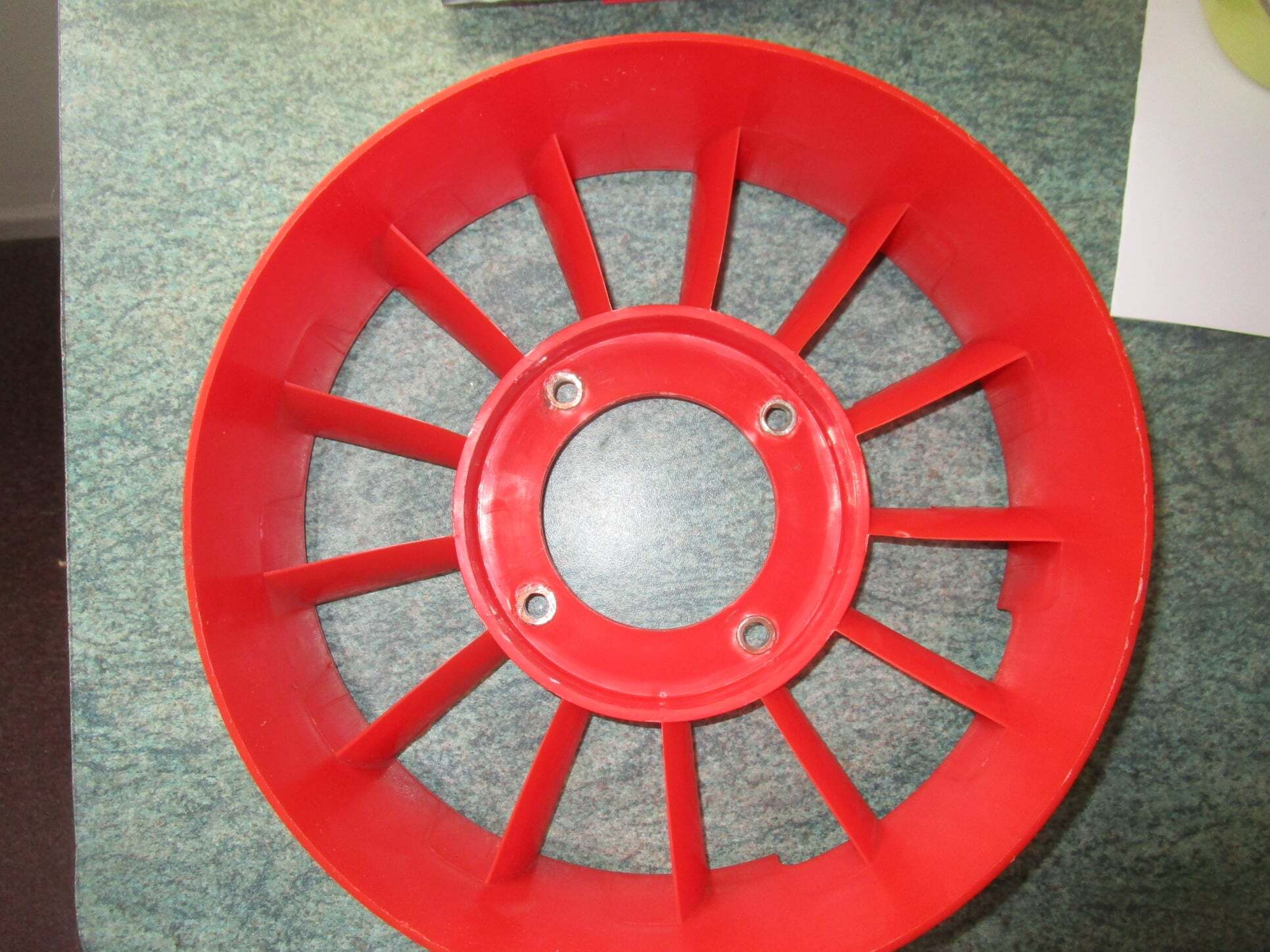

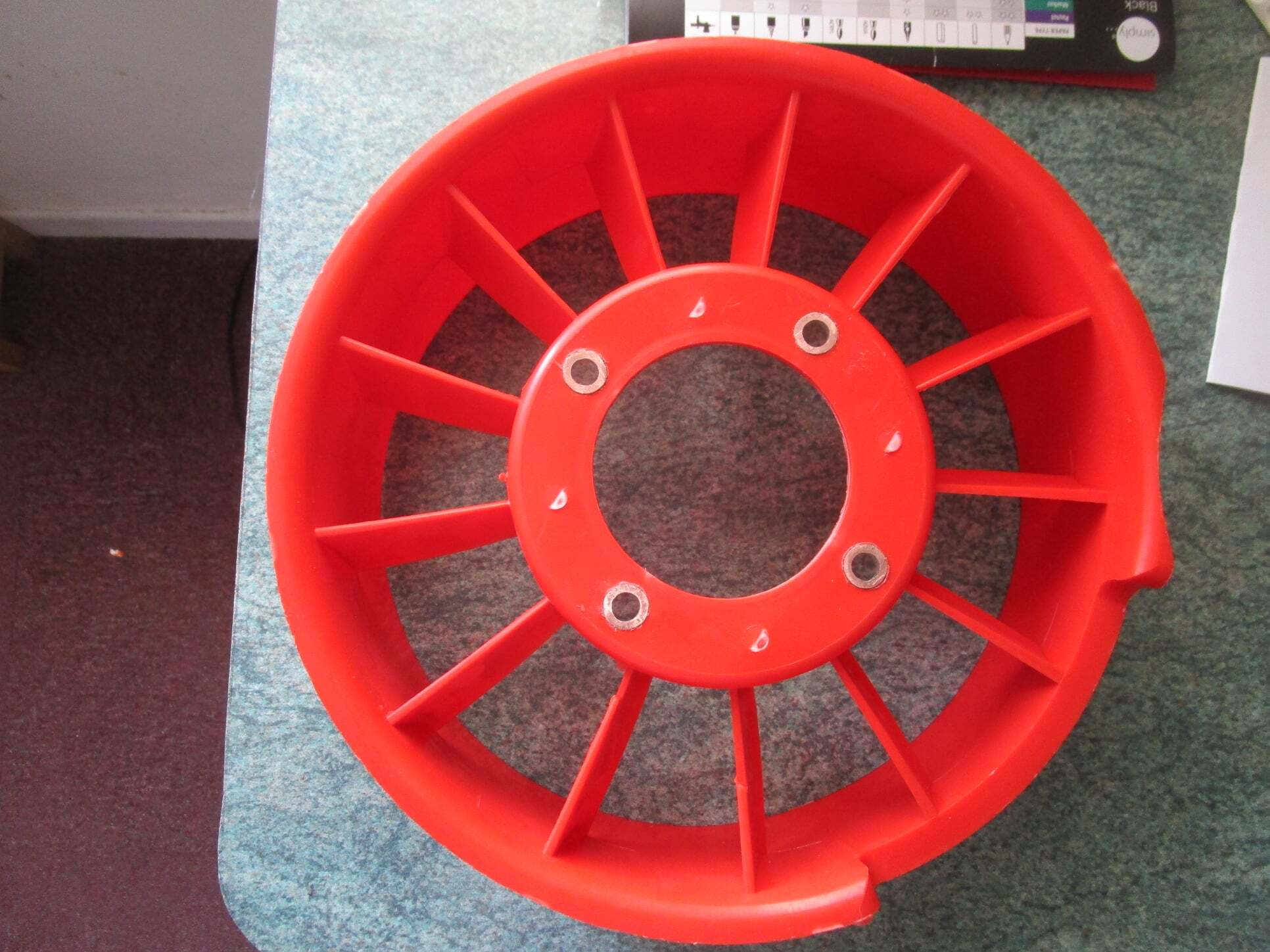

Always thought the water pump mounting a crap idea .
Its in the right place however having the two halves of the pump tightened up on the red plastic cowl just seems utter crap .
The plastic squashes , splits and generally gives up if you over tighten the four pump bolts which is often done to stop a gasket leak .
Anyway the Vuskys pump is on its way out and the cowl is split and cracked all to feck and fit for the bin .
Ive got two NOS cowls here but the thought of the plastic just cracking when fitting the pump just seemed stupid .
So ive sleeved one NOS cowl on the mount holes , these are pressed in and very tight and with thin washers either side should prevent the cowl moving , get the pump bolts tight and generally be a better idea - they are copper BTW .
No idea if it will actually work but we will see i guess

Nice work on the sleeves Dave. I tried that but made the mistake of trying to crimp things in, when tightend up made it even worse

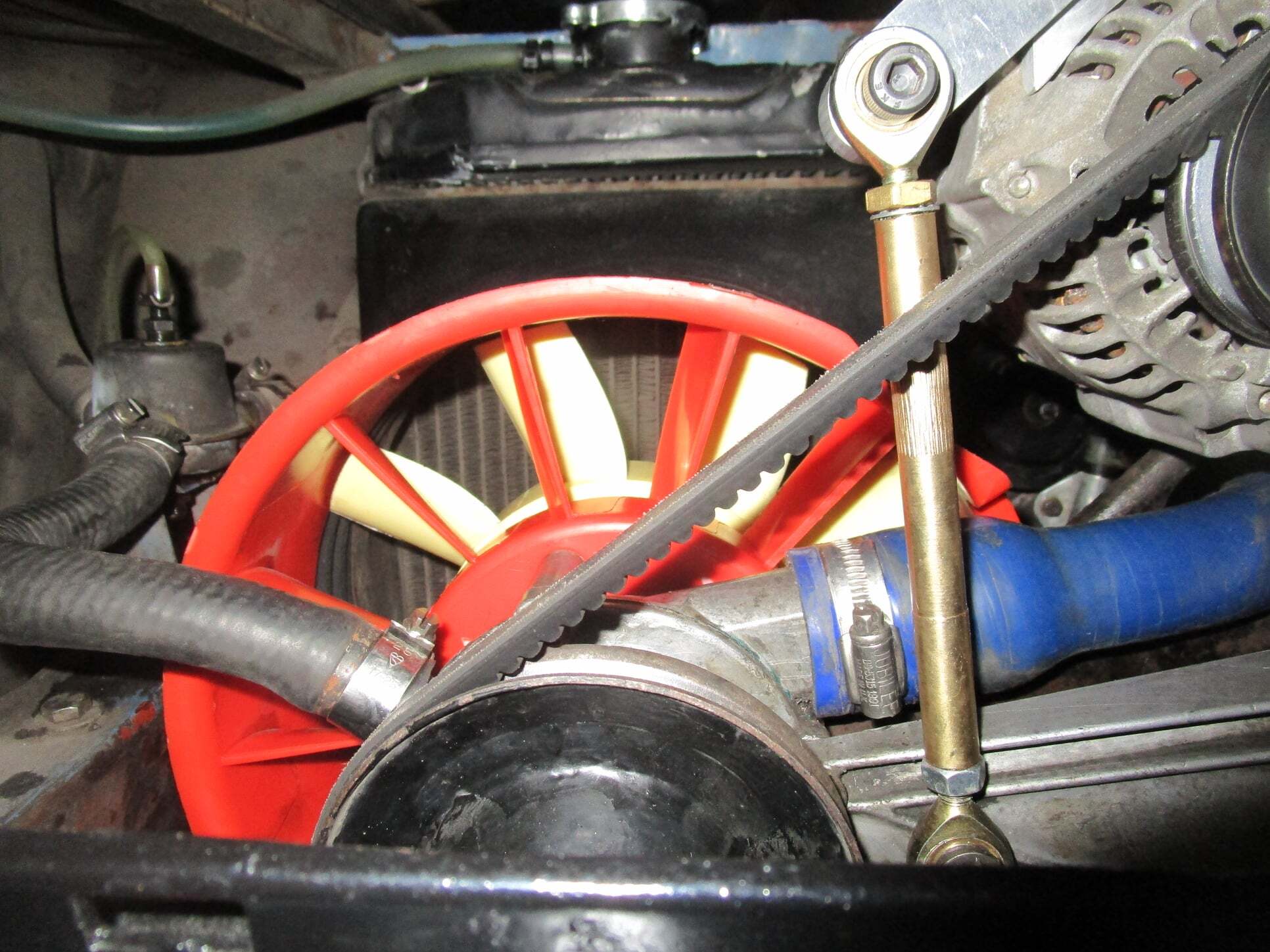

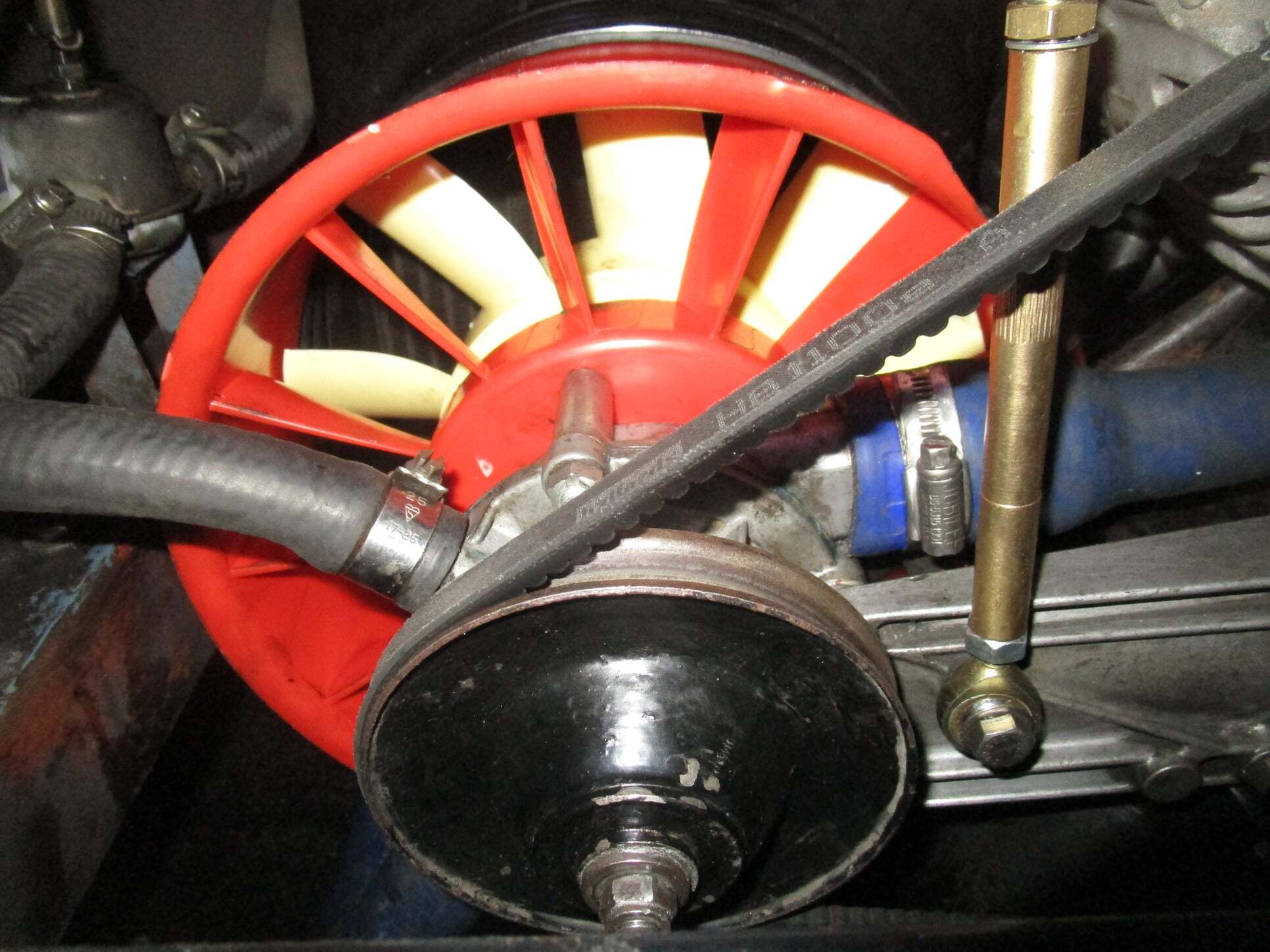

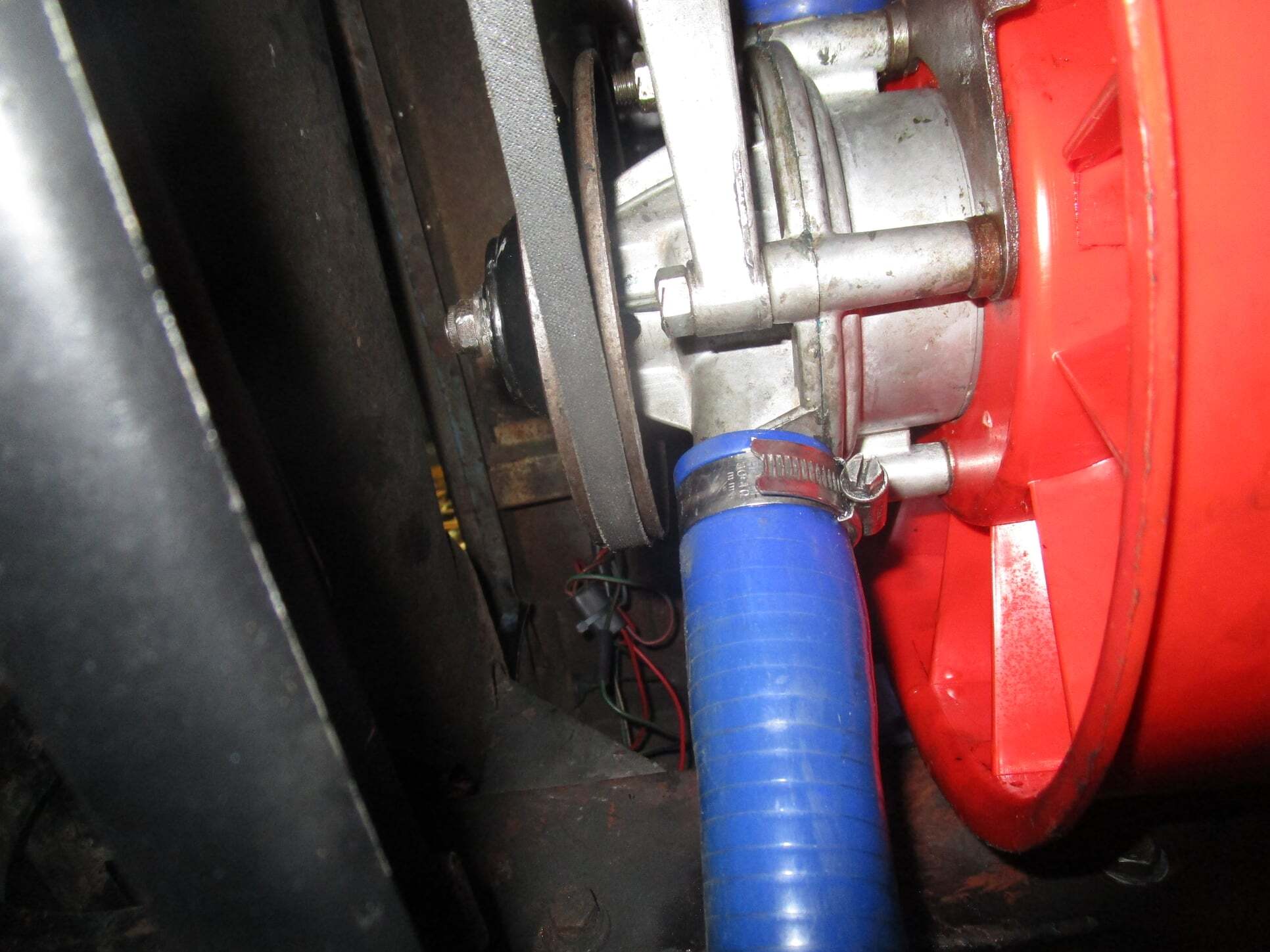

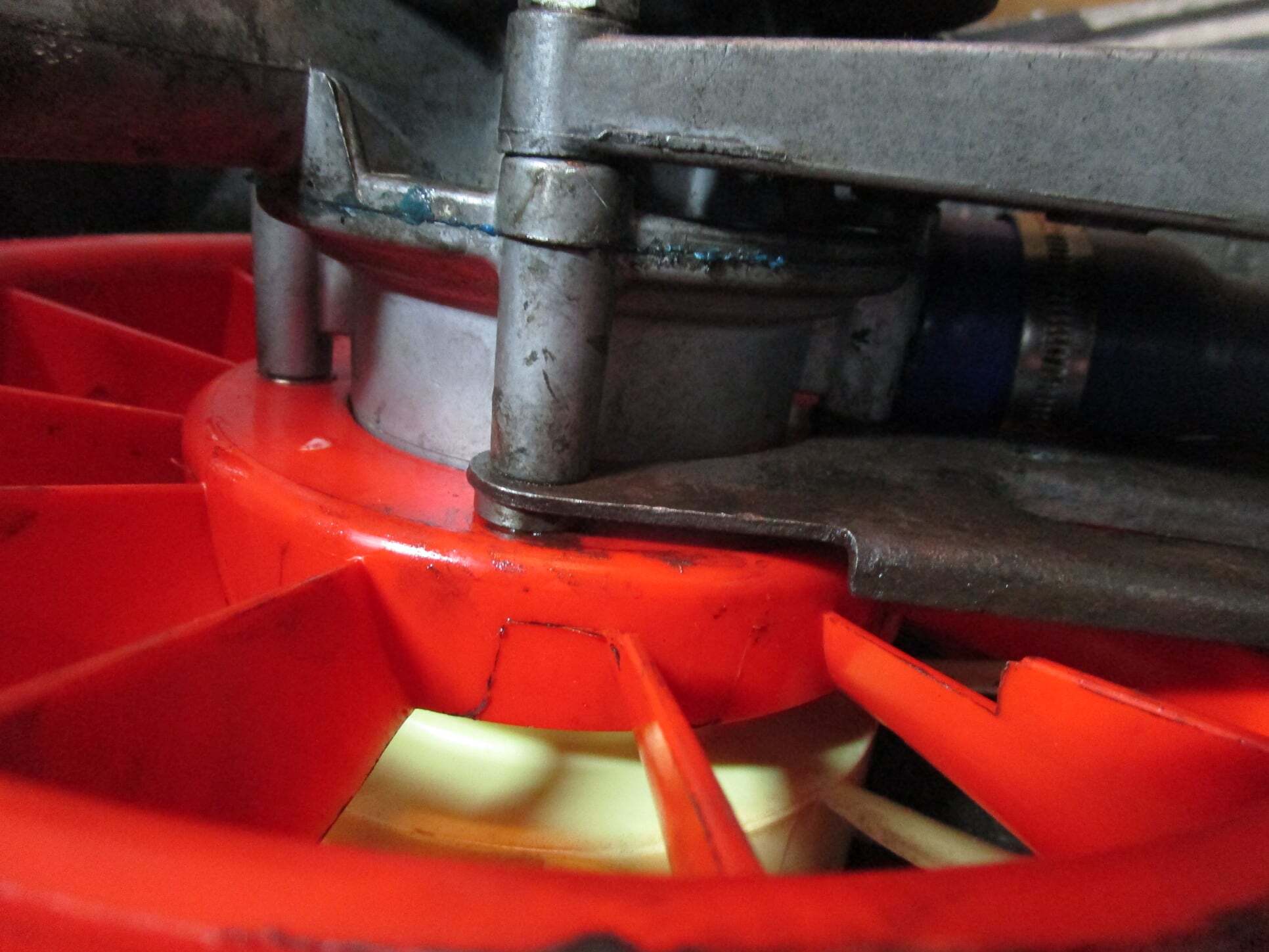

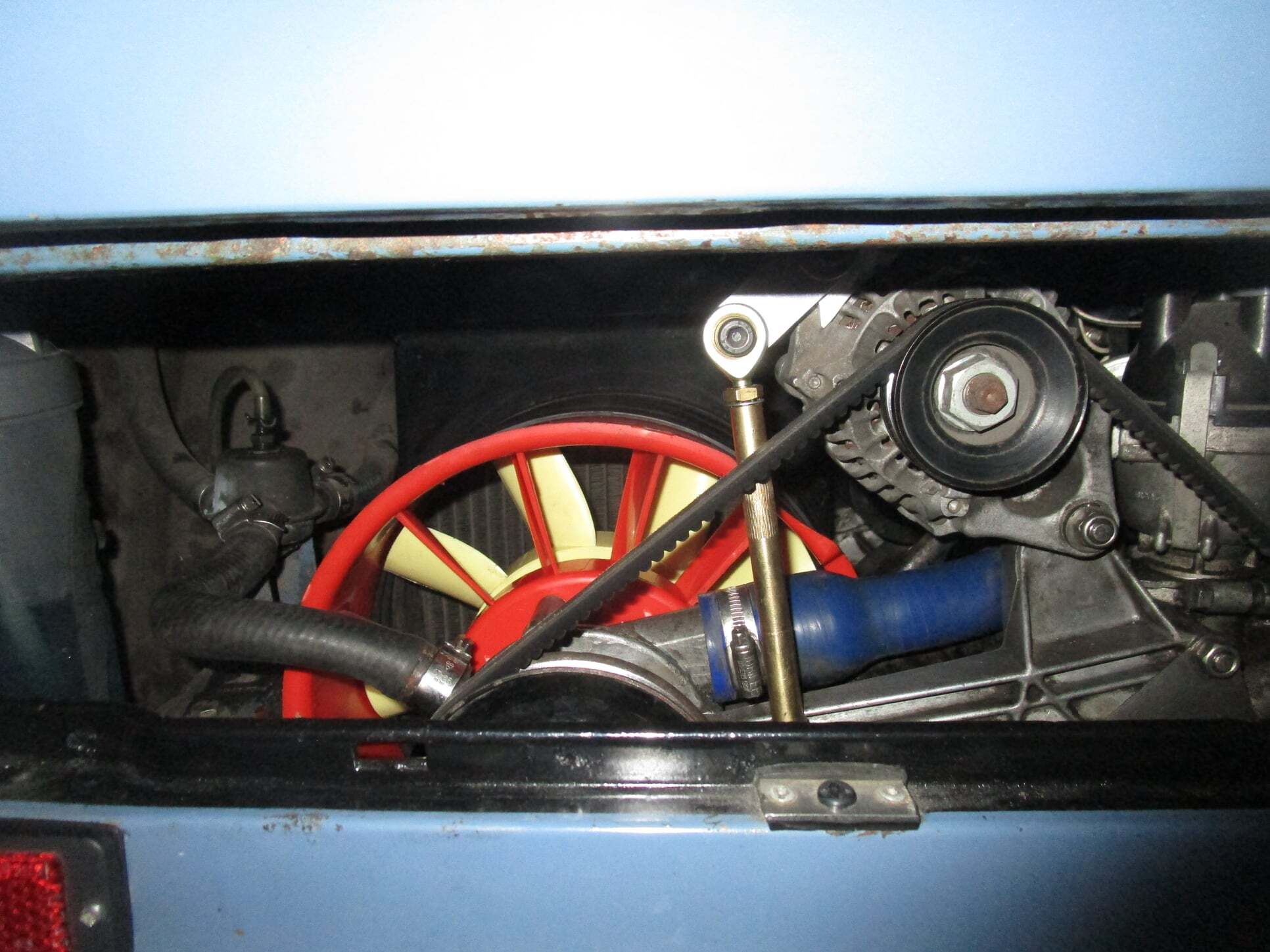

New cowls in

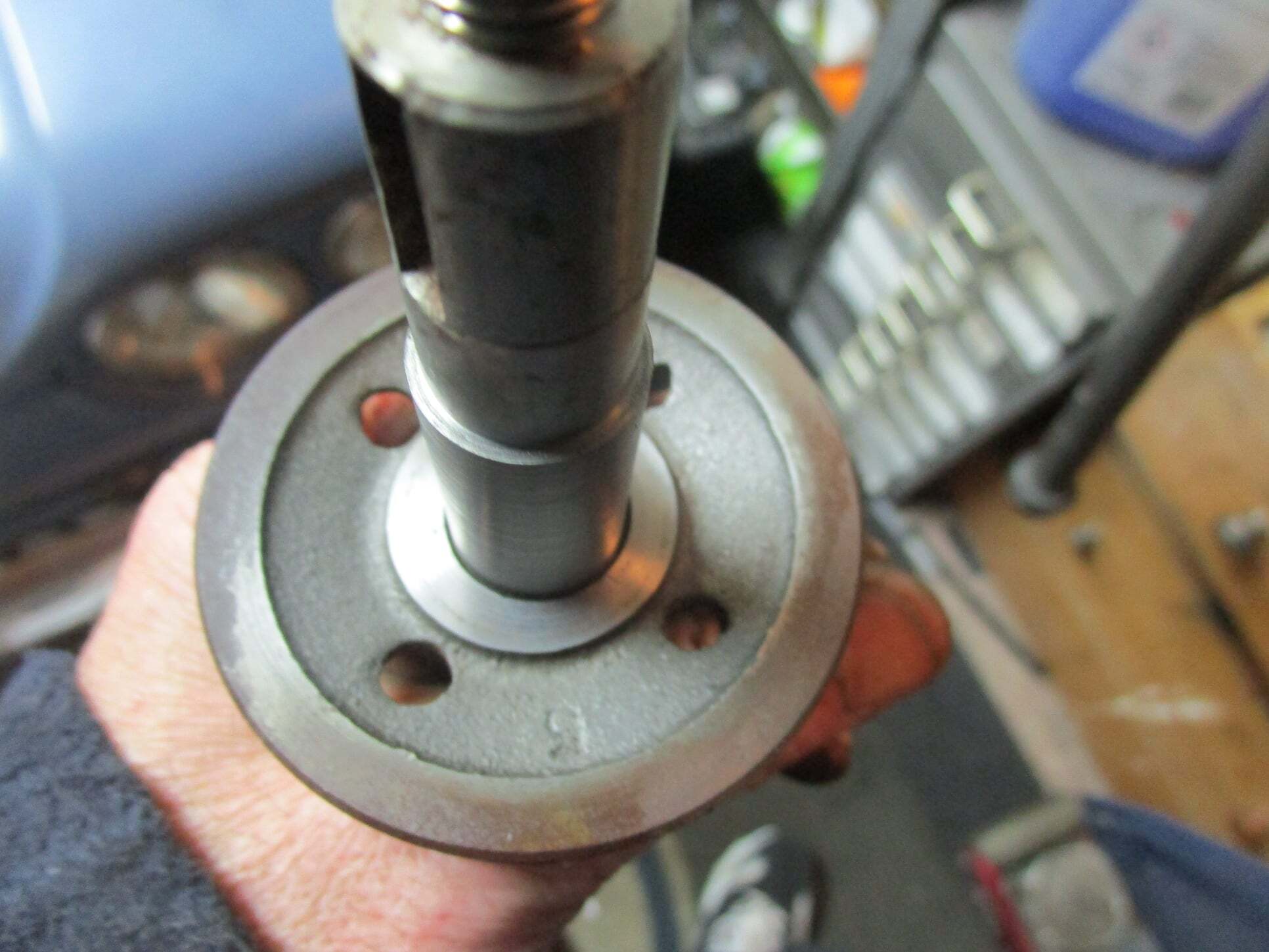

Pump seemed fine and leak free however pulley end bearing felt iffy so ive replaced it , Sadly I didnt have two bearings in stock .
Put a new fan in as well .
Been for a quick blast - il check the level and for leaks tomorrow .

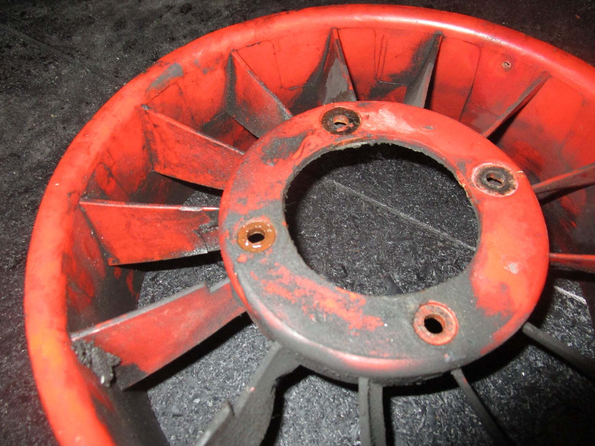

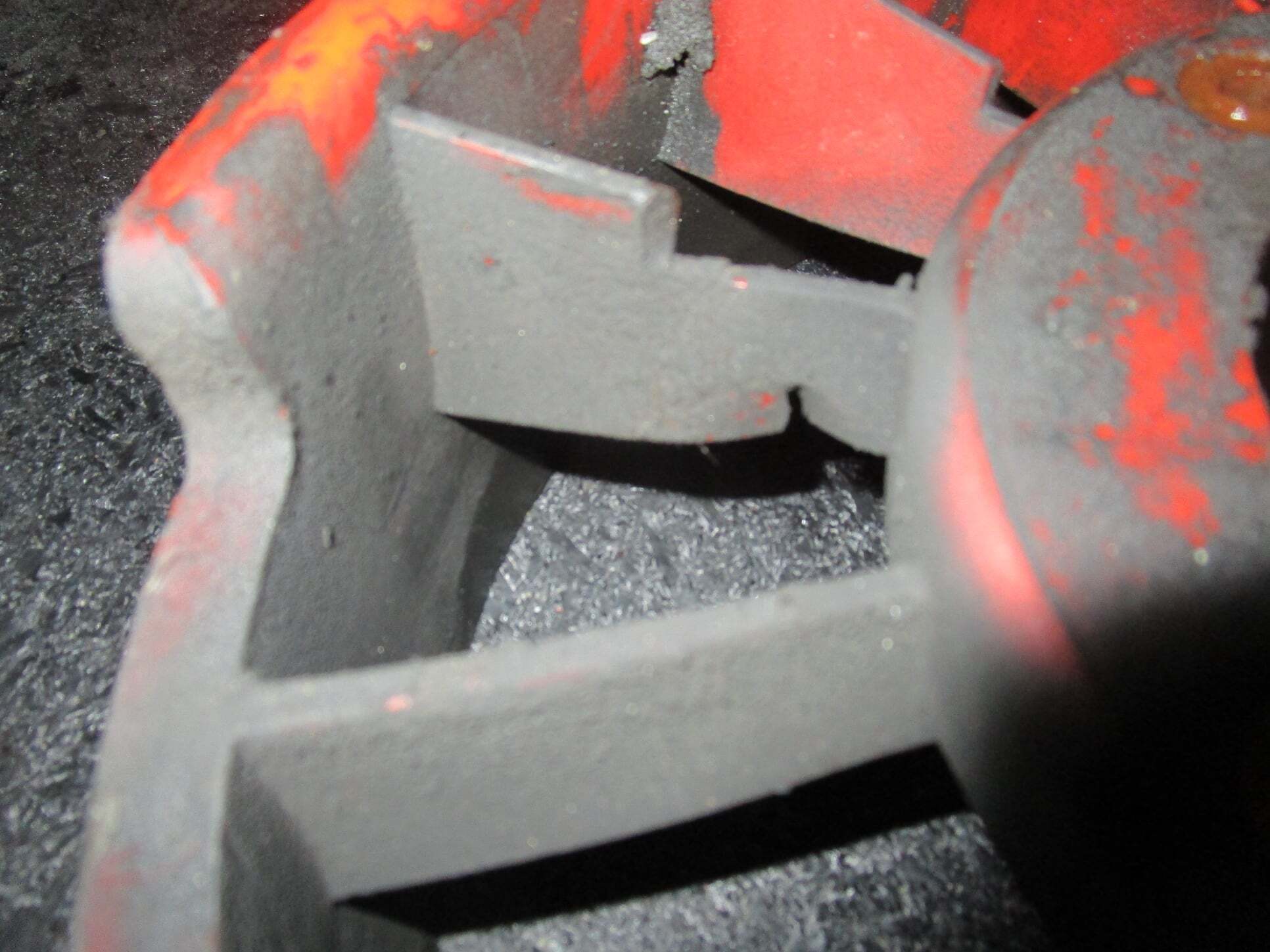

Old cowls been in the wars , one blades split right through and ones been twatted by something
The old one is definitely a bit fooked.

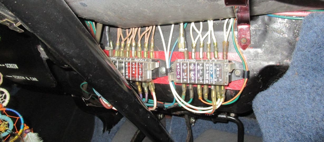

Dave, how about changing the fuse holders out for ones with rear entry, would just be a few standoffs and you could have the fuses doing just a peek-a-boo through a cover
Just an idea/ John
Also need to get rid of things like Radio. :)Originally posted by John A. Ross View PostDave, how about changing the fuse holders out for ones with rear entry, would just be a few standoffs and you could have the fuses doing just a peek-a-boo through a cover

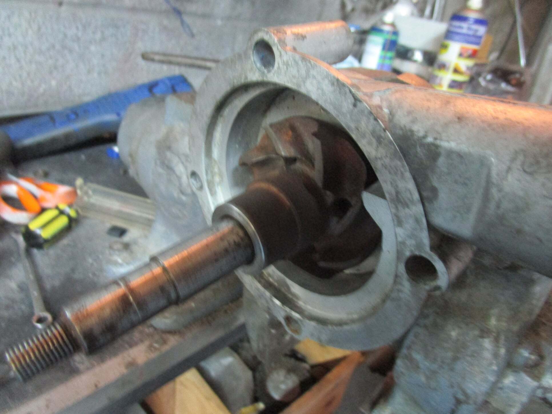

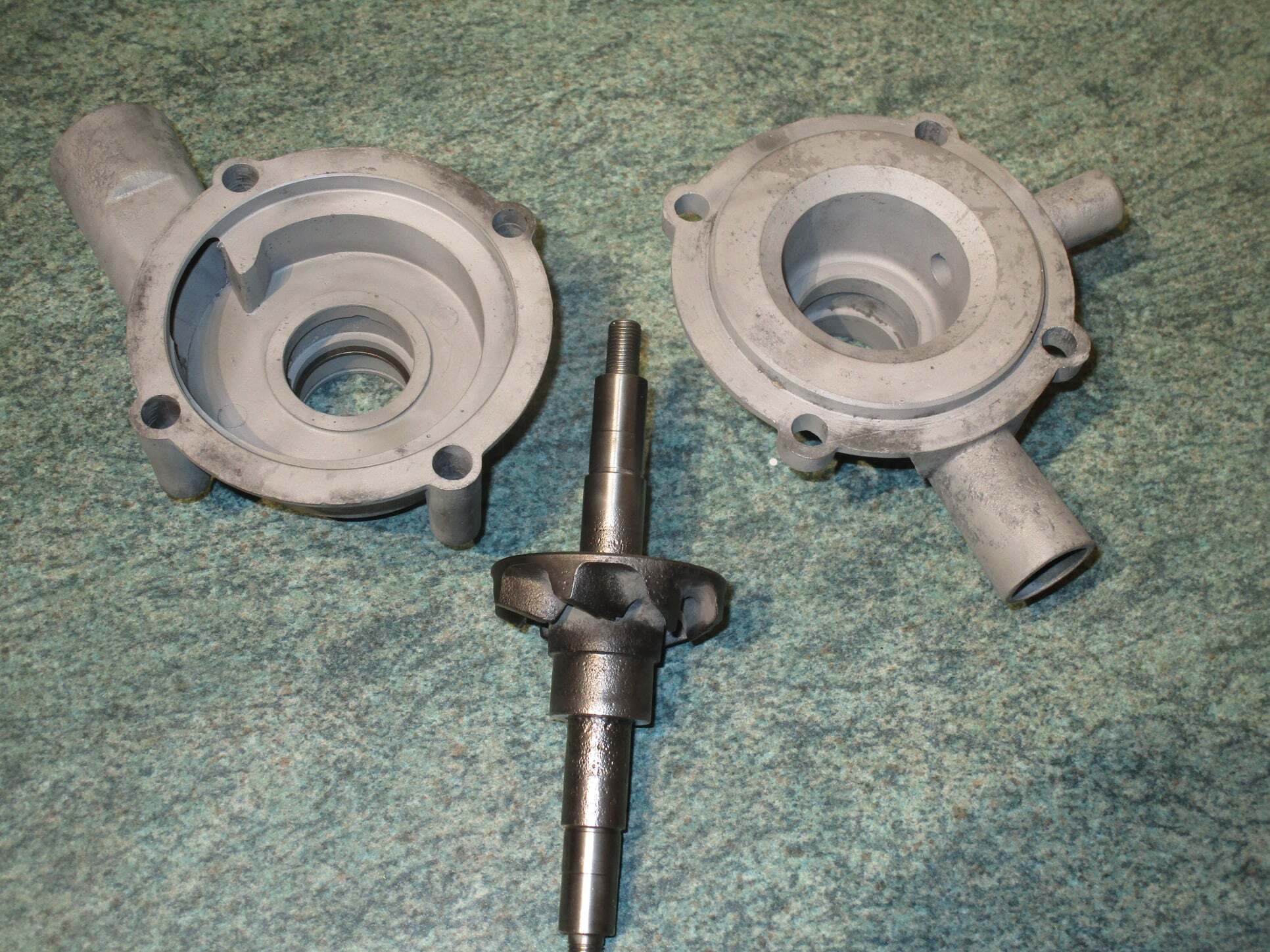

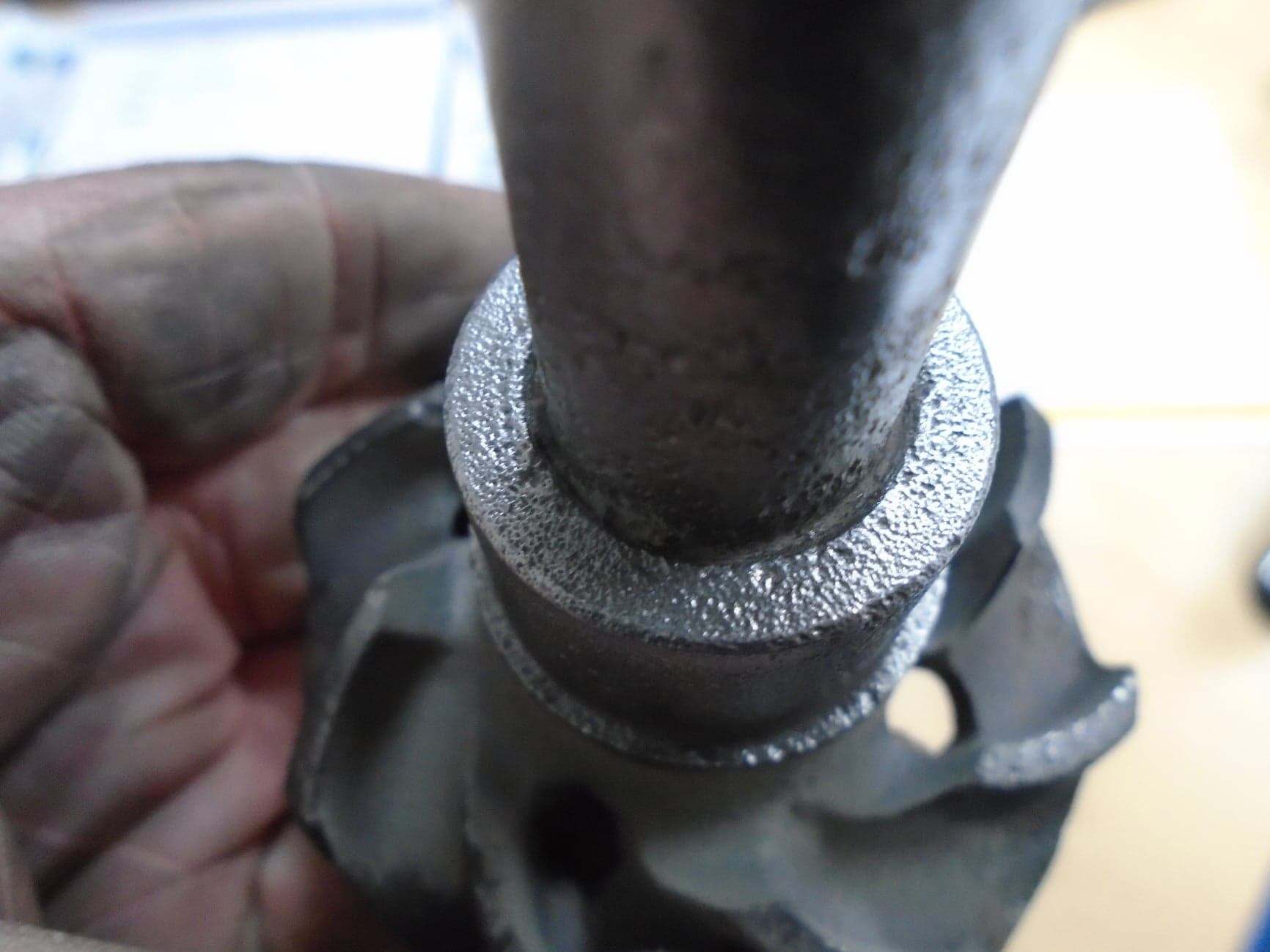

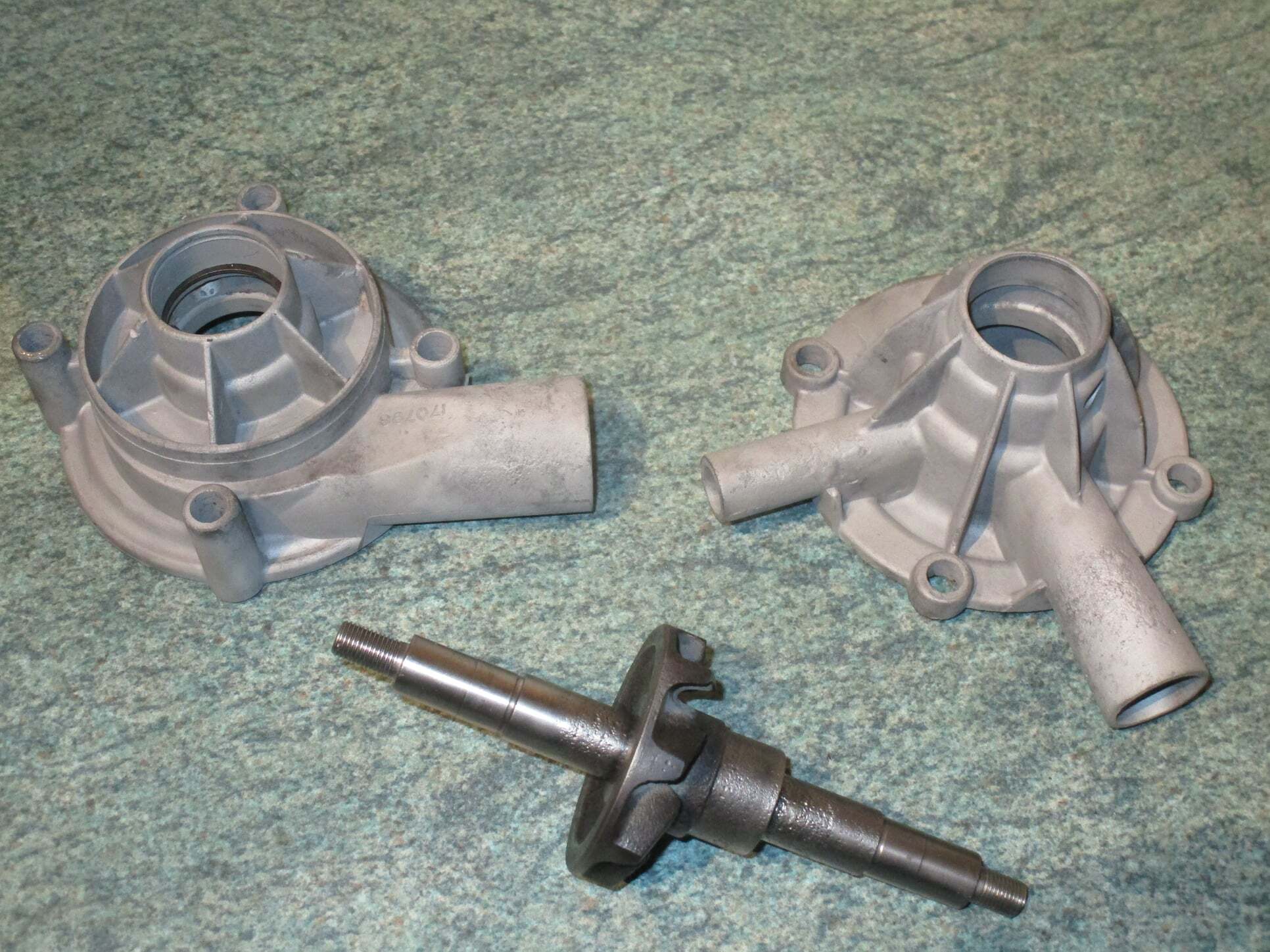

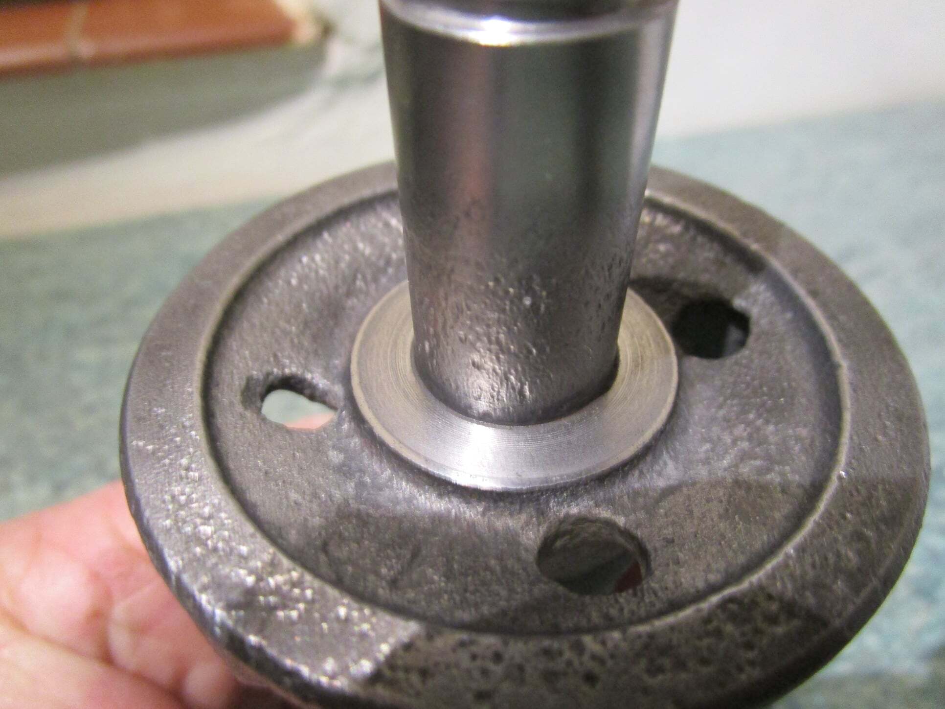

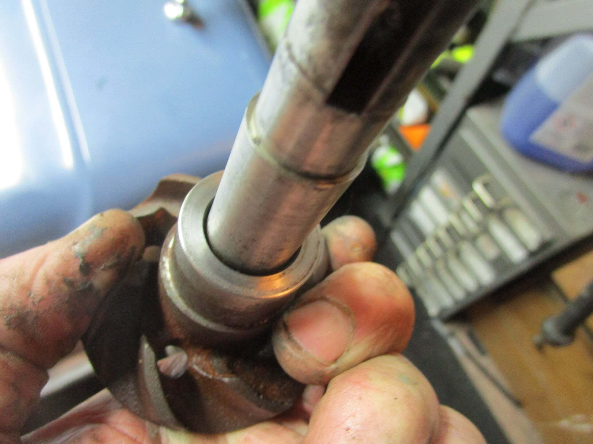

With the new pump thus far leak free attention turned to the leaky one .
Its been fitted over 12 years so something has given up.

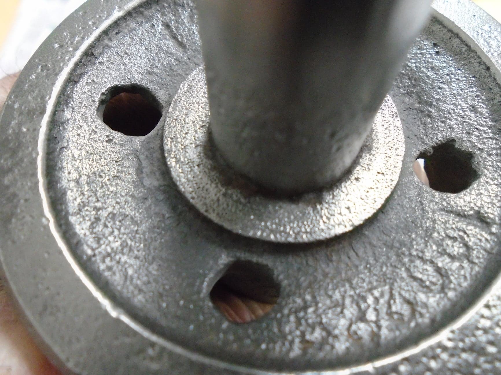

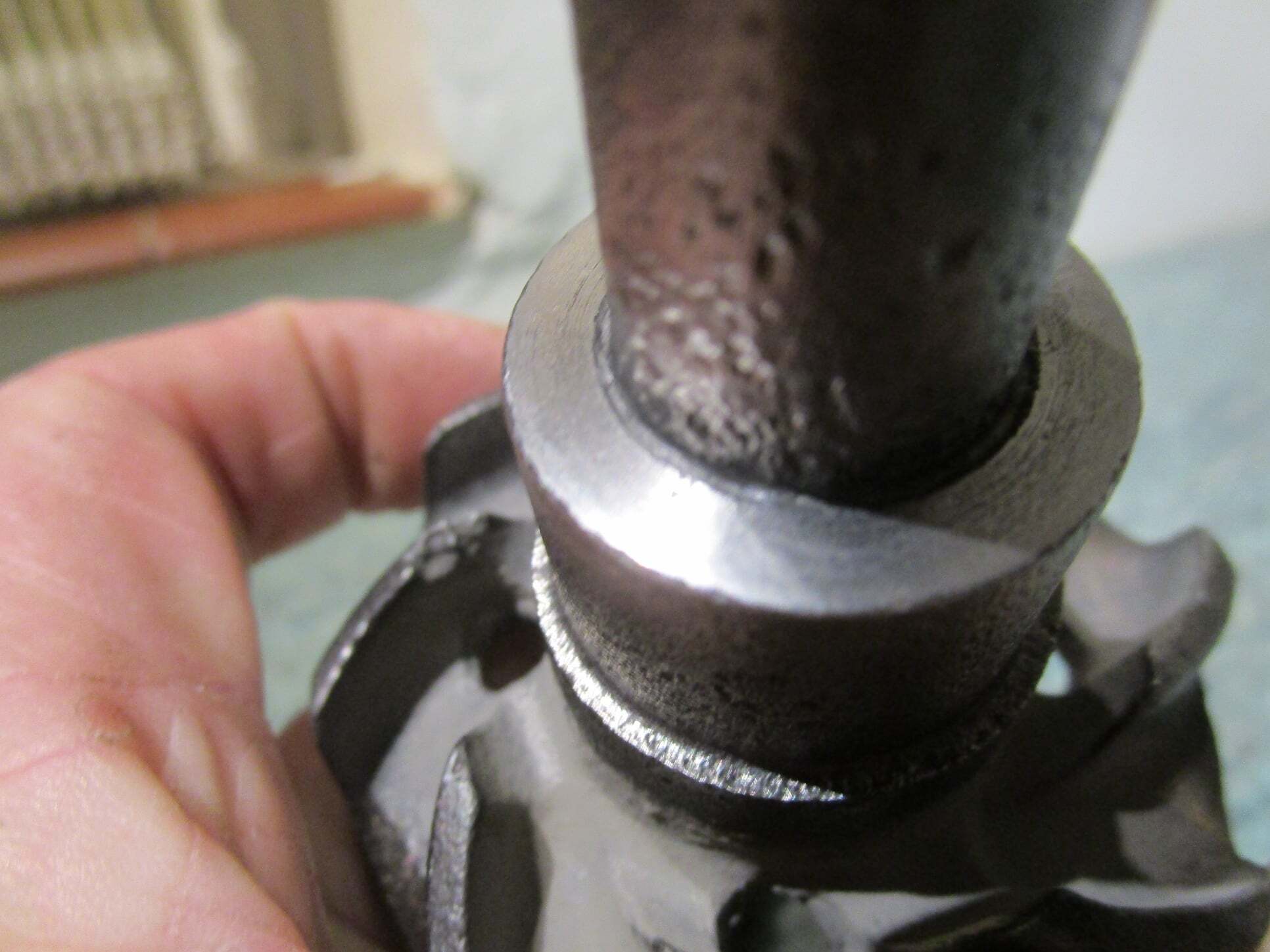

After stripping down and a good clean up the cause soon became apparent .
Seat mating surface on the shaft was royally knackered - still a few minutes on a lathe soon sorted that out .
Case has been cleaned up - just waiting to fit the rebuild kit at some point
