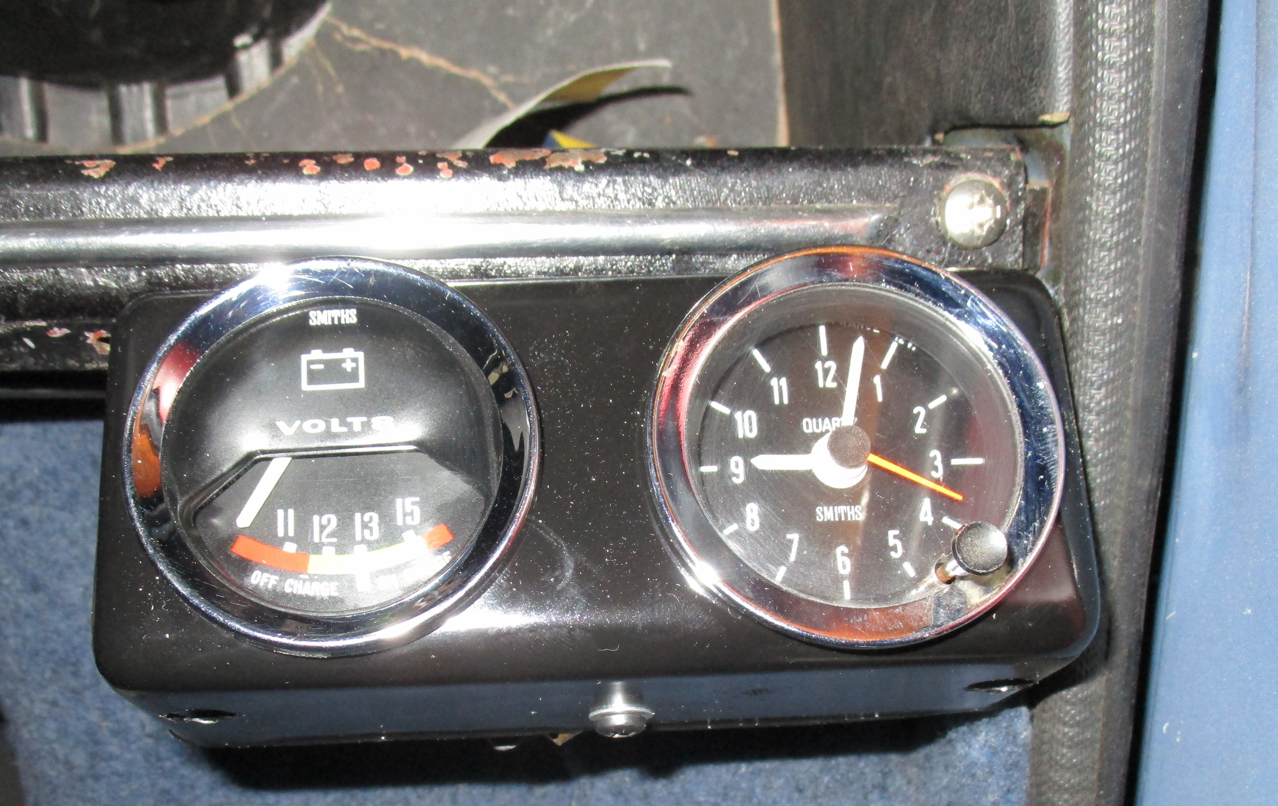

    VOLTS - Easy to fit , needs a switched live and an earth , gauge doesnt even care which terminal is which . Tells you what the dynamo / alternators doing - either charging , undercharging or more importantly overcharging . theres even posh ones saying battery condition

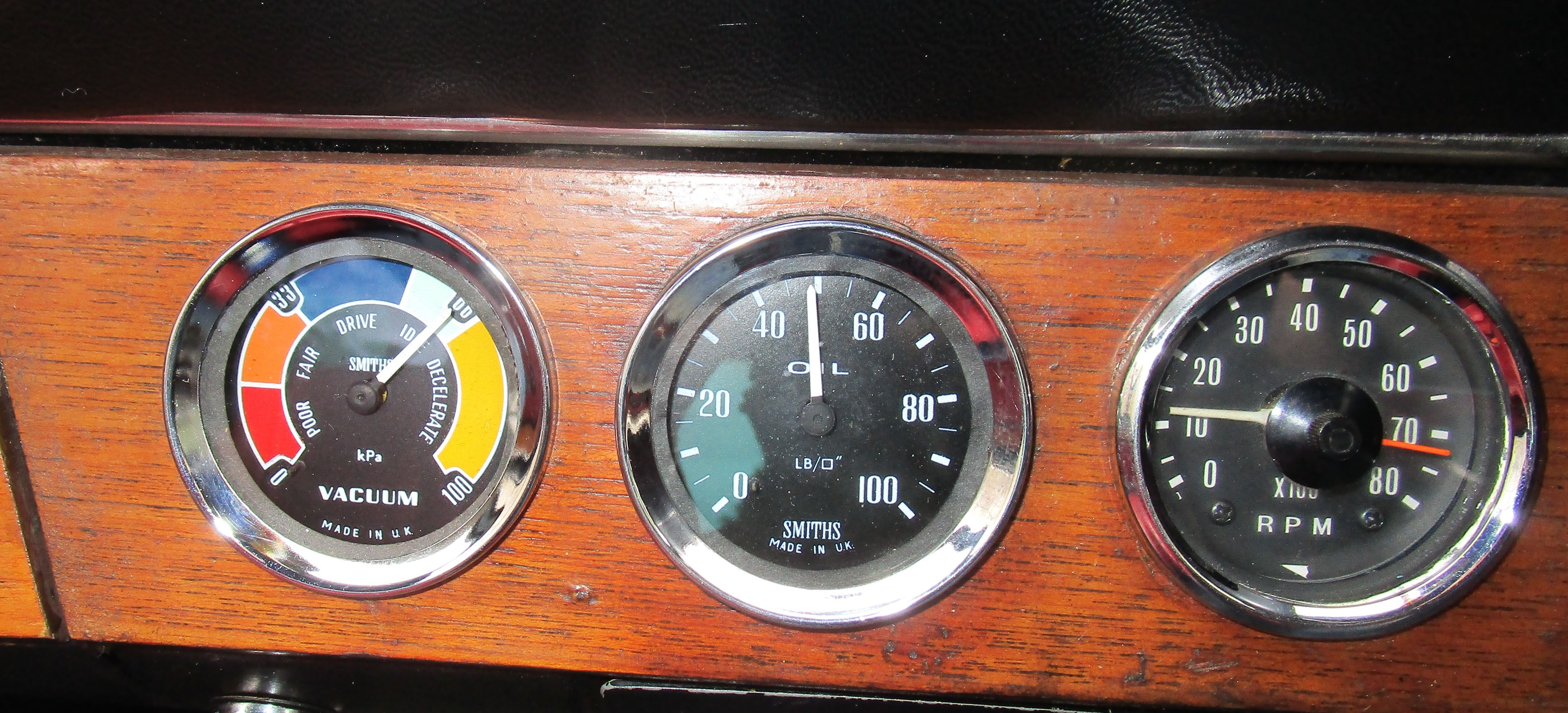

    OIL PRESSURE - Go for full faced ones as they are more accurate in either electric or oil fed , mine are oil fed .

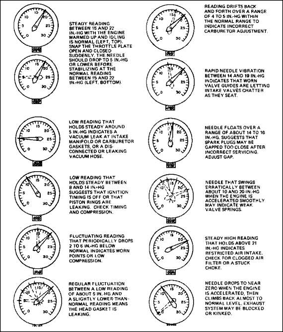

    VACUUM , really handy , only fitted in the Vusky as the SU inlet had the fitting for a servo , tells you how the engines working , you can set the timing , mixture and it will even tell you if a cylinders got issues , again go for full face , there are half faced ones about . Its not really about where the needle points although it does on mixture and timing but how it reacts

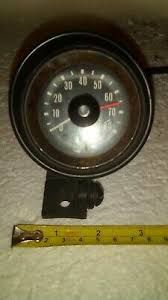

    REV COUNTER . Smiths never did a 52mm rev counter - only an 80mm one however Yazaki did , these are very reliable and accurate , if you can find one in a pod then mount it on top the dash , they will run on 4 or 6 cylinder and top end ones do 8 cylinder as well - 4 wire connections on all of them - one for the light , gauge earth , one for coil positive and one coil negative , they are happy on pertronics ignition too

    CLOCK - Well why not watch your life fade away early ones are transistor and not great , some have remote time altering but i went for the later Quartz ones - very accurate save for most have wobbly seconds by now

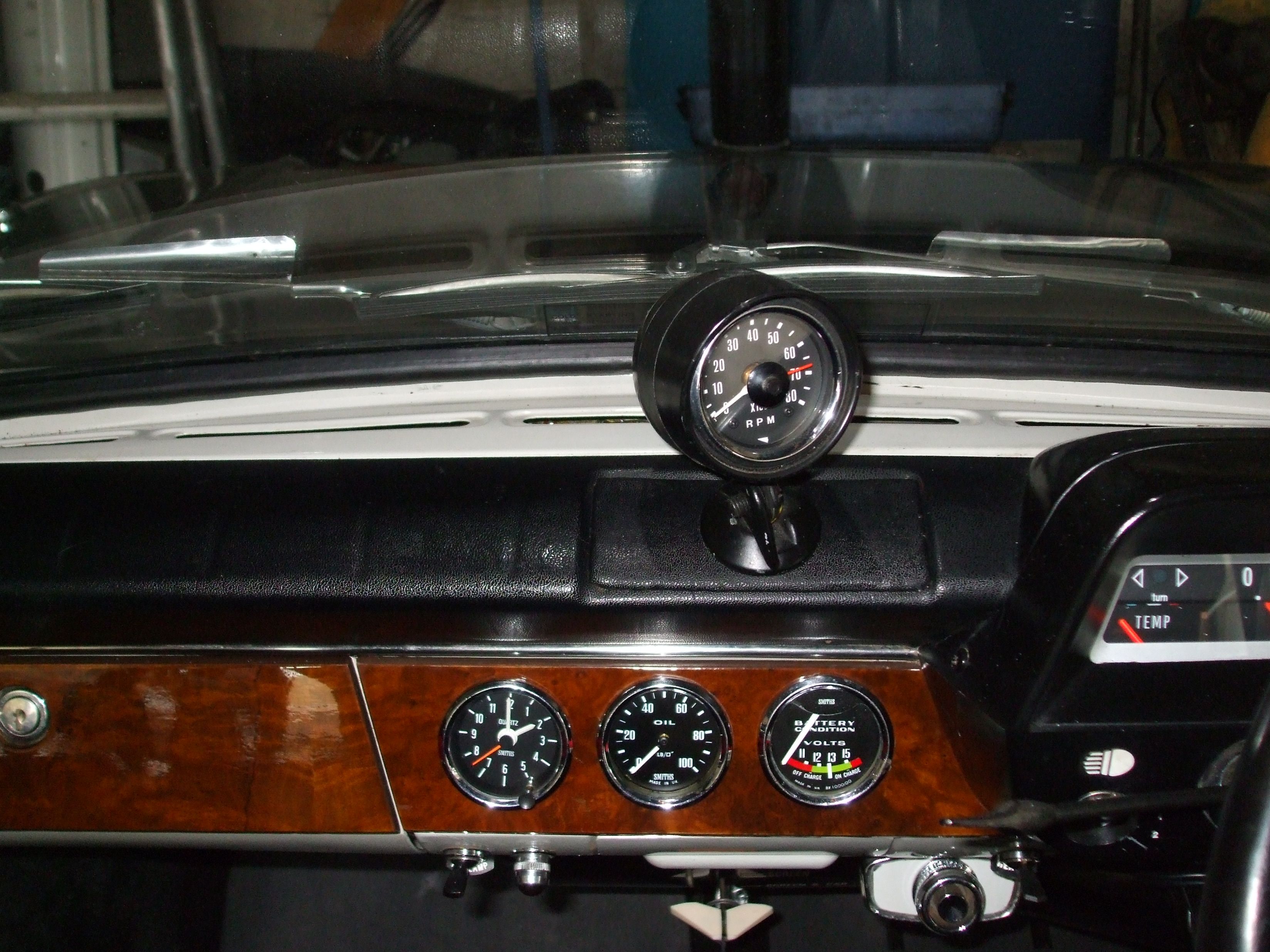

    Theres two types of chrome bezel , rounded on early and flat on late , they can be swapped about easy and a Stiths bezel will fit on Yazaki gauges so you can make them all match , ive got all round in the Singer and all flat in the Vusky
    Click image for larger version  Name:	DSCF4220.JPG Views:	13 Size:	992.3 KB ID:	7554
    Vuskys set up
    Click image for larger version  Name:	IMG_2560.JPG Views:	12 Size:	1.49 MB ID:	7555Click image for larger version  Name:	IMG_1016.JPG Views:	12 Size:	1.35 MB ID:	7556

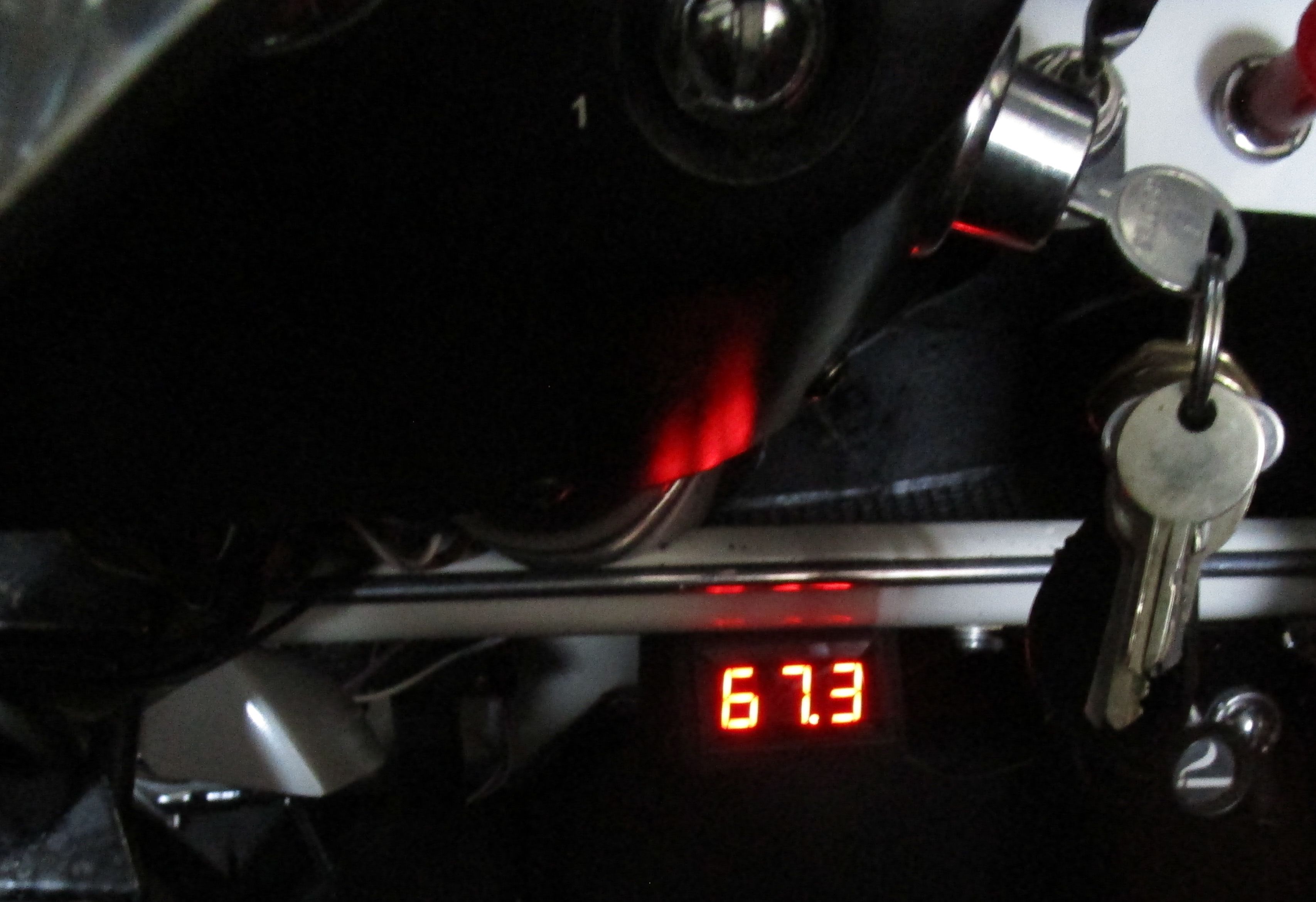

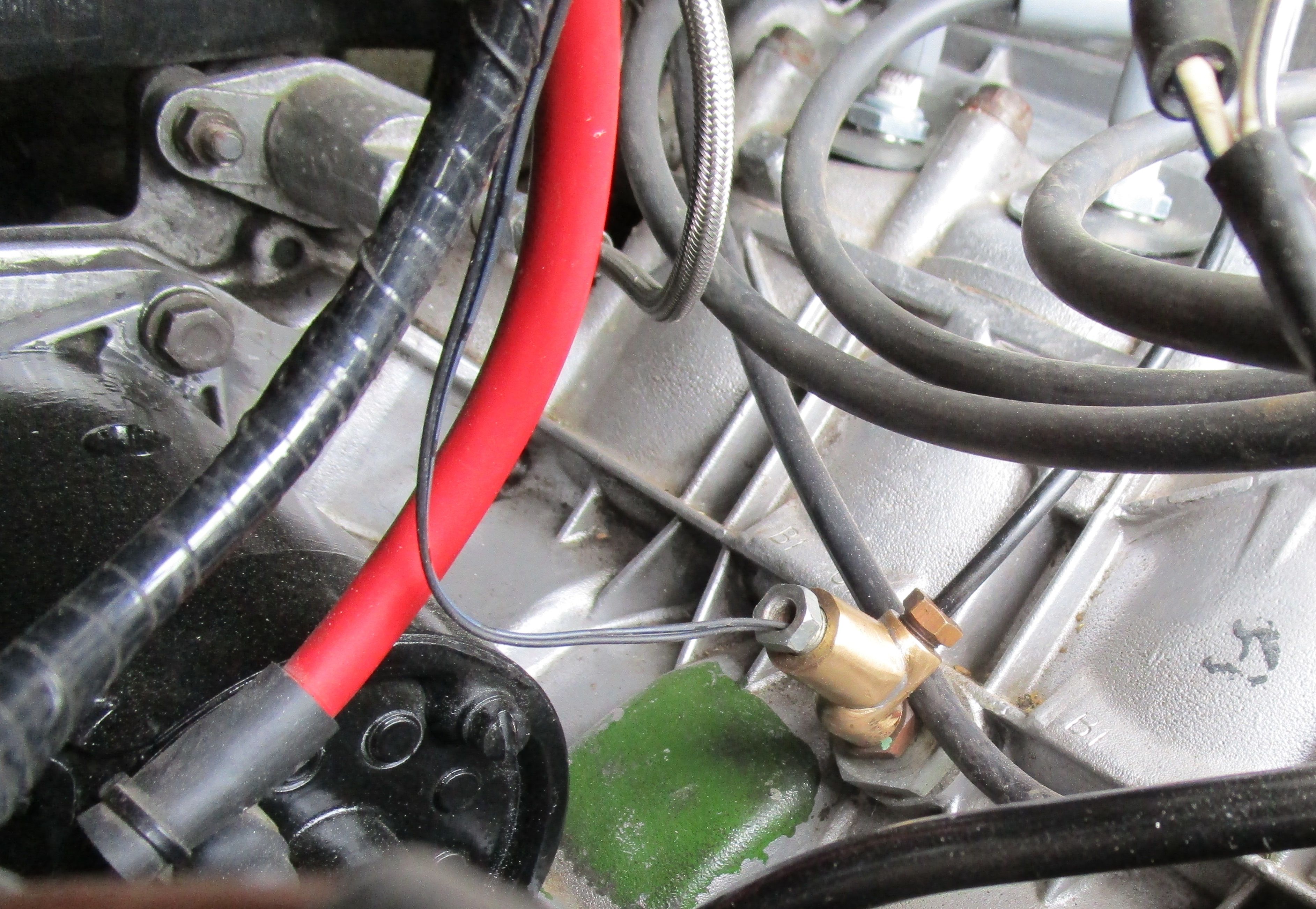

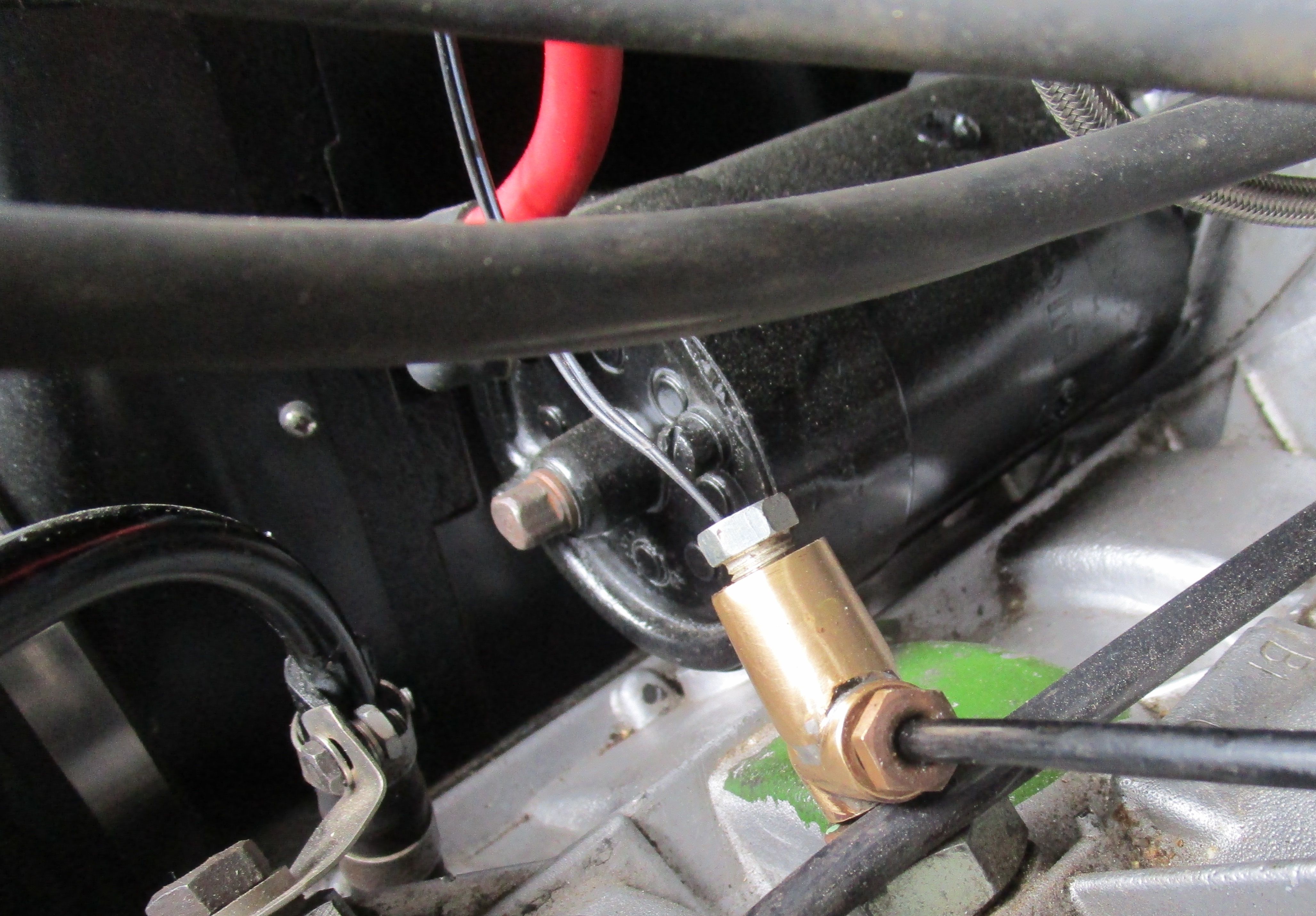

    I recently added a digital gauge and am experimenting with using it as oil temp - smiths dont do one long enough for rear engines , its a cheap Chinese thing , Sensor must not touch the metal .
ID:	7559Click image for larger version
ID:	7560Click image for larger version

        Digital gauge looks great in there Dave
        PMCG fasten seat belt one for Mildred some nice gauges there Dave, did not even know half of them existed ! Extremely cool

          So ive been over to my parents to cut the hedge so naturally took the Singer .
          Having checked my random records the stat fitted is a 72˚C one .
          Anyway the oil temp ( assuming its correct gauge wise ) reads between 68˚C and 72˚C .
          Top of rad was 72˚C - bottom of rad was 34˚C.
          So it seems the oil temp mirrors the water temperature which mirrors the stat rating ( assuming whats stamped on it is correct.)
          Just goes to show how important the stat is
            Its running sweet by the sounds of it Dave, even better when 3 gauges are in agreement and the rad seems to be doing its job well even in the heat
              Yep , communication agreement is good
