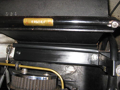

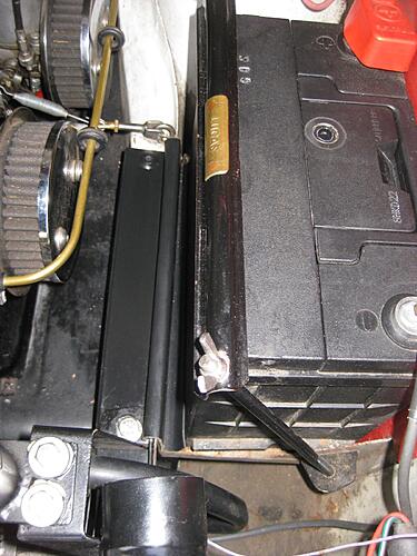

    Passenger side done to match , bit of lateral thinking as i didnt want to drill any more holes

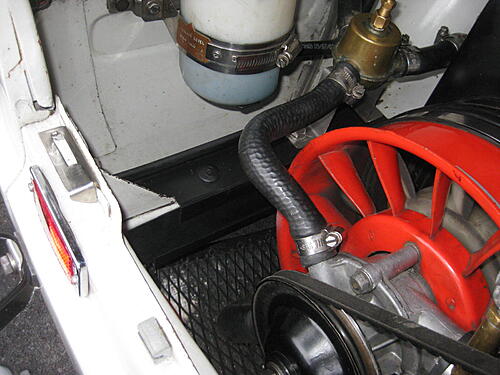

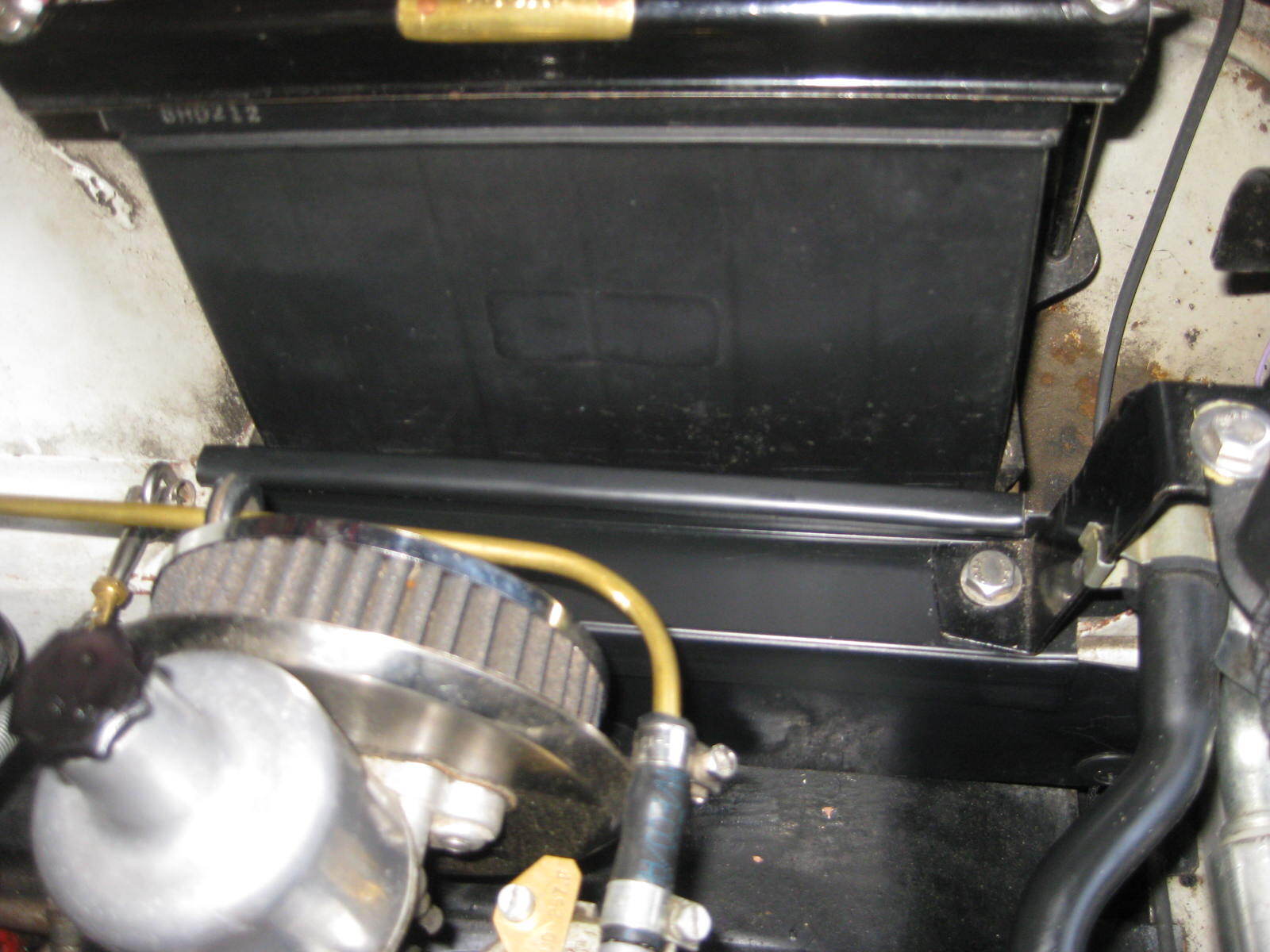

    This might be a controversial mod as basically im hiding something rather than do it properly .
    Well I have done it properly previously and quite a few times .
    That is sort out the paint on the battery side chassis leg doodab .
    Somehow I keep twatting the paint on it and over a few years it just gets chipped again , being a light colour it all gets a bit messy
    looking .
    Anyhoo Ive covered it in black plastic using trim clips in the holes already there from factory to hold it in place .
    Had to think a bit laterally and even do some " remoulding " with a heat gun .
    By the by anyone know why the holes are on the drivers side leg but none on the drinkers side .
    I give you bodgery at its finest

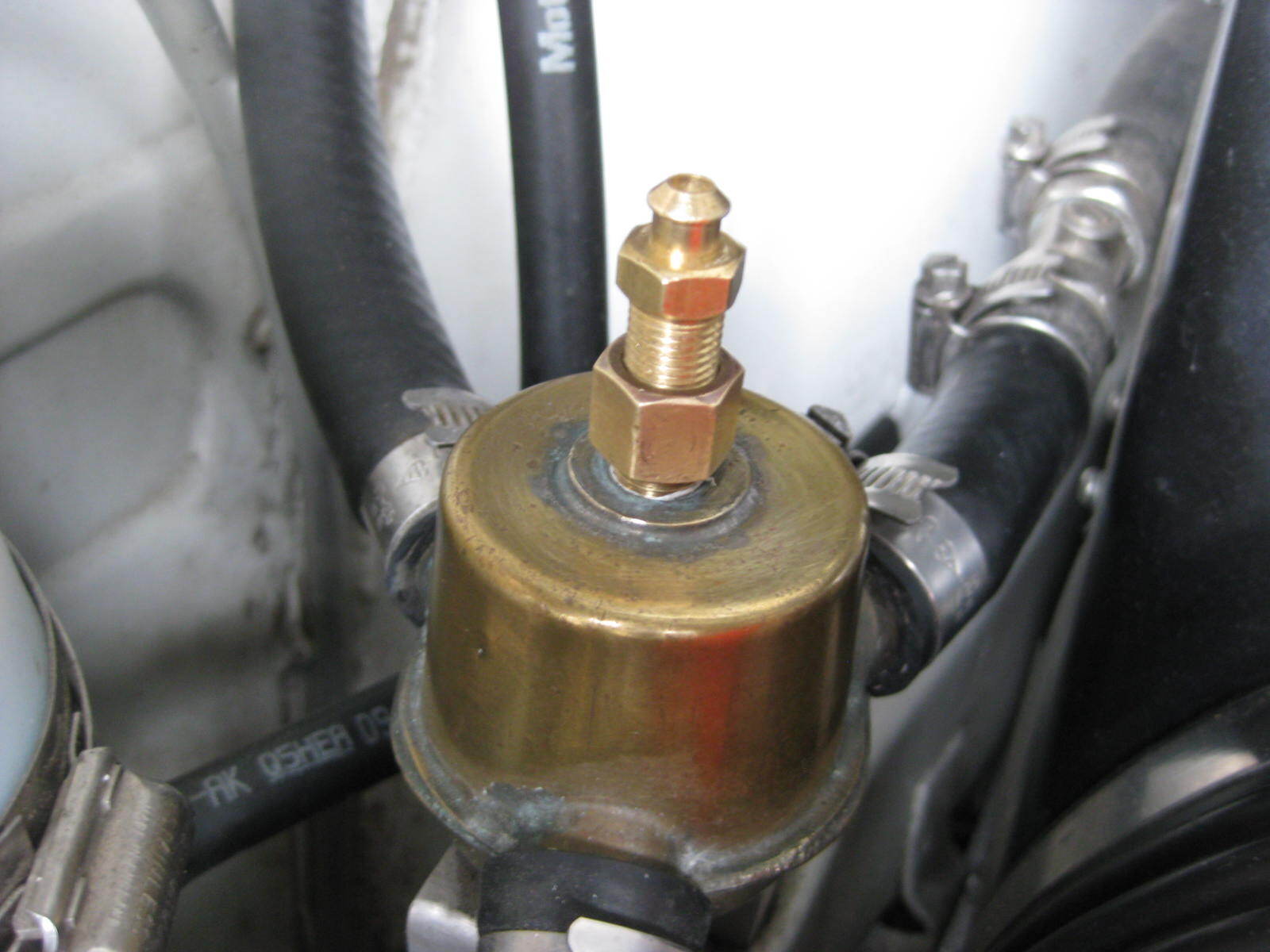

    Further to the different bleed valve i fitted on Barnaby ive found some brass brake bleed nipples so have done the Singer .
    Ive run it up and its leak free , i think its a better set up however ive only got two of the NTP to UNF adaptors and these seem to be made of unobtanium - otherwise id do the block drain as well

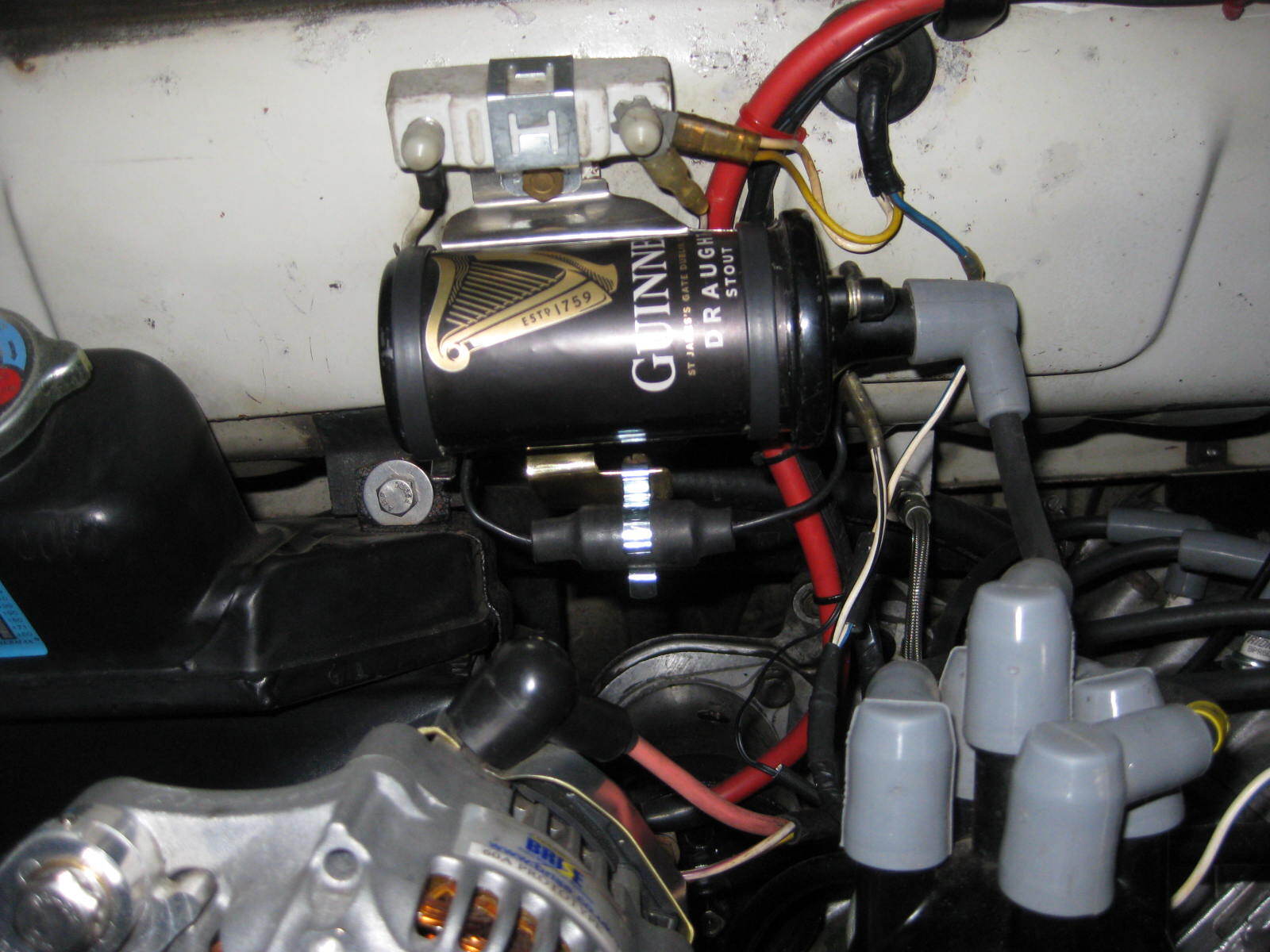

    I think ive made the most over engineered external condenser holder oner ever

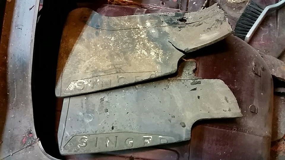

    Dave
    I had original singer ones on DDG, in fact thats the reason the arches rotted in those places completely but I would like to get another set if I can.
    If you want to protect those areas I can recommend a good thick coating of Gravitex and overpaint white (you can get it in white as well but still needs painted)
