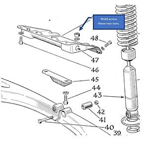

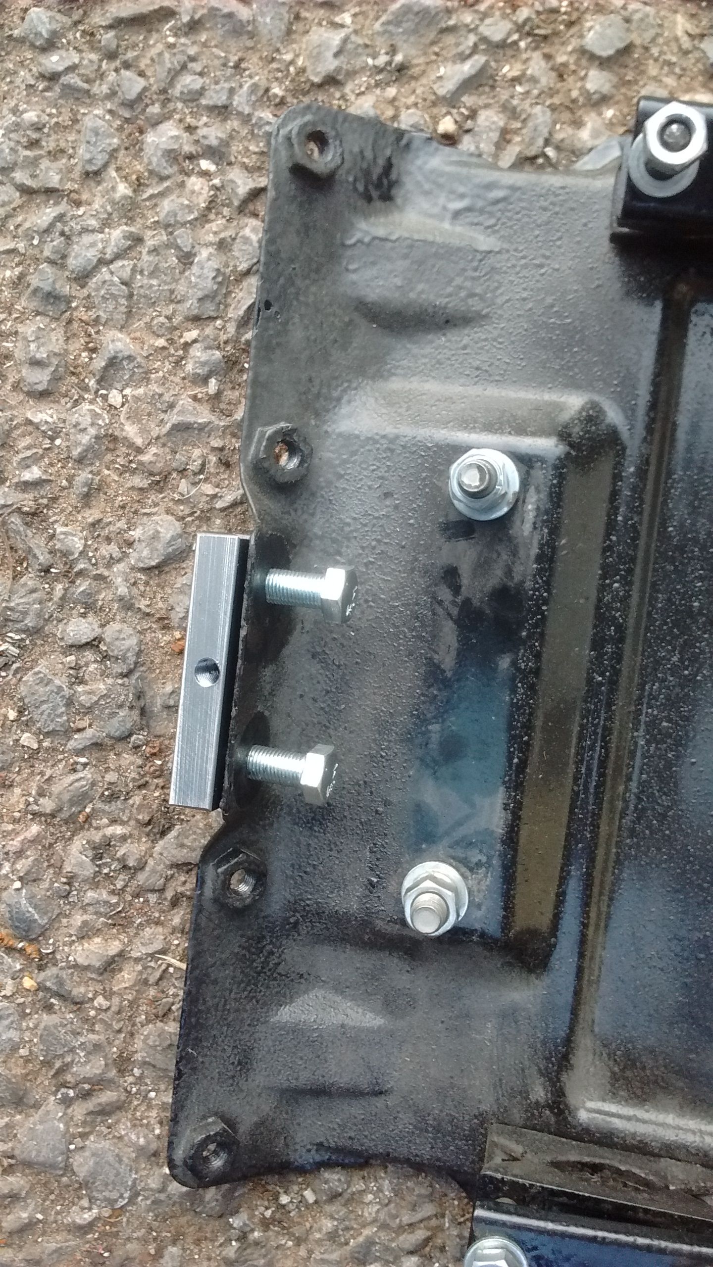

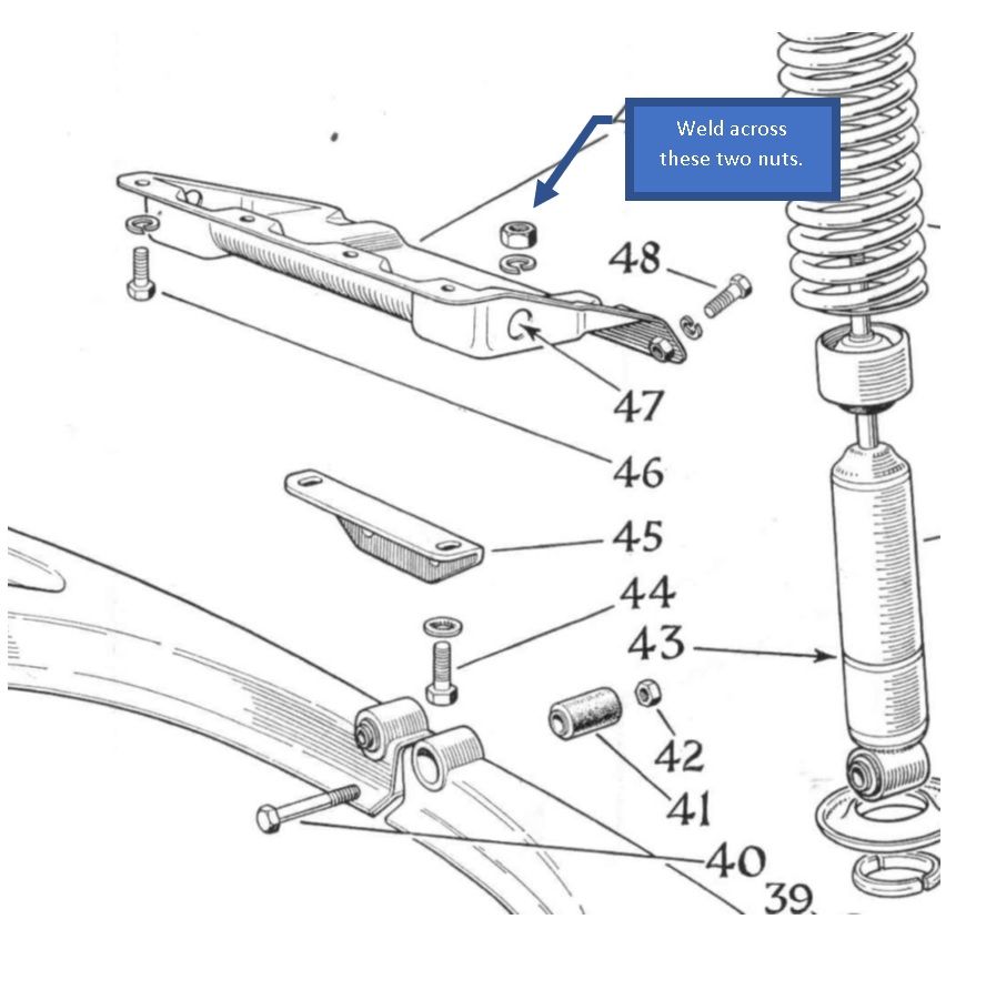

You wrote about welding bar across the nuts that are effectively above the mounting bracket when on the car , l was thinking of making a plate with tapped holes, possibly screwed in place by another screw , is it worth doing the same for rear mounting points ? from memory you can get a spanner up into slot ,but it is a bit fiddly if l remember correctly.. Need to have another look .

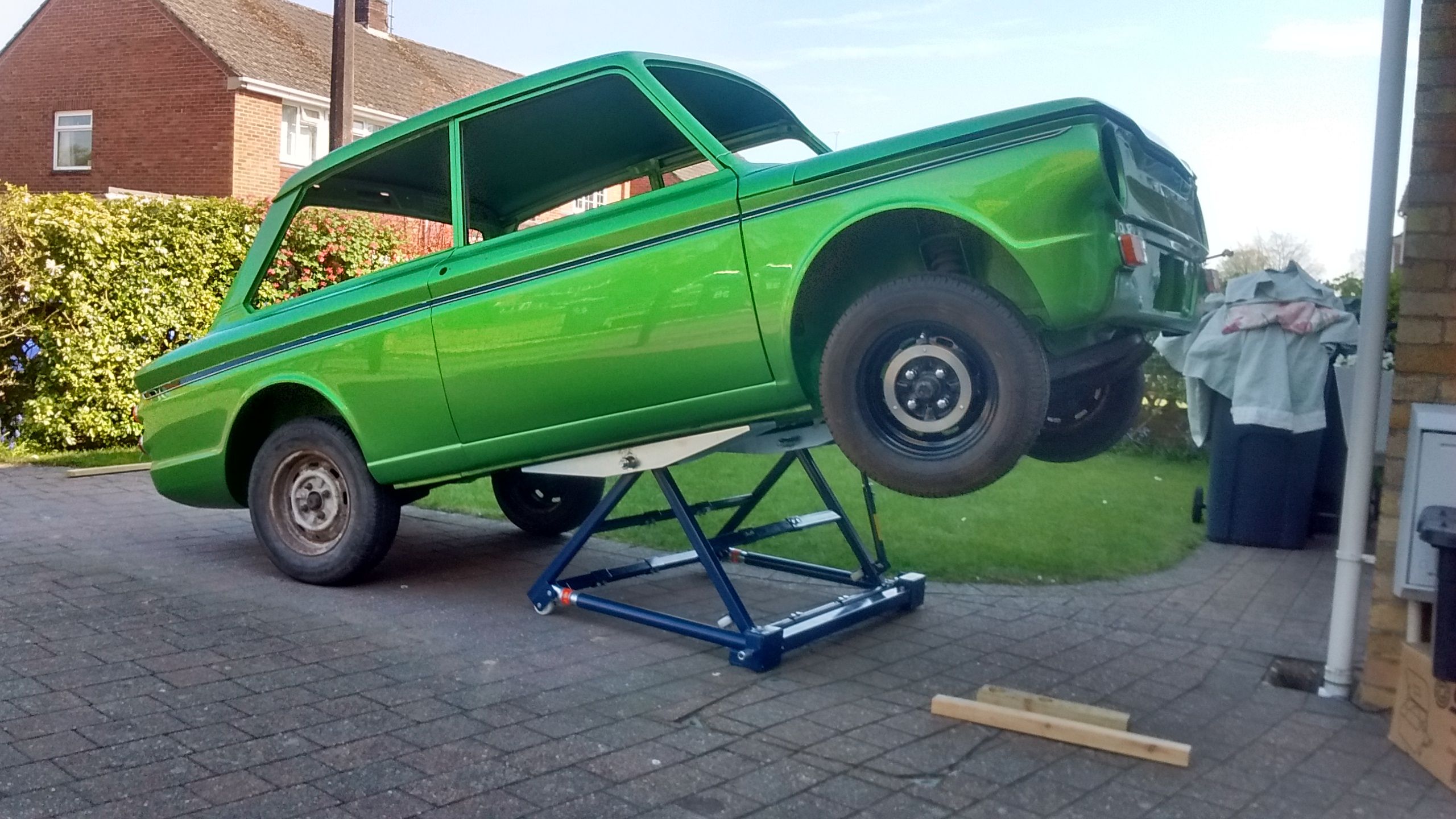

Springs and shocks will hopefully be here next week so possibly have her back on ground for next weekend
