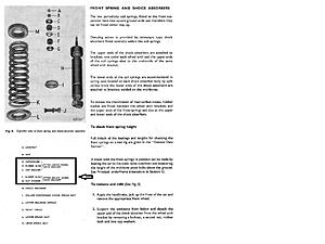

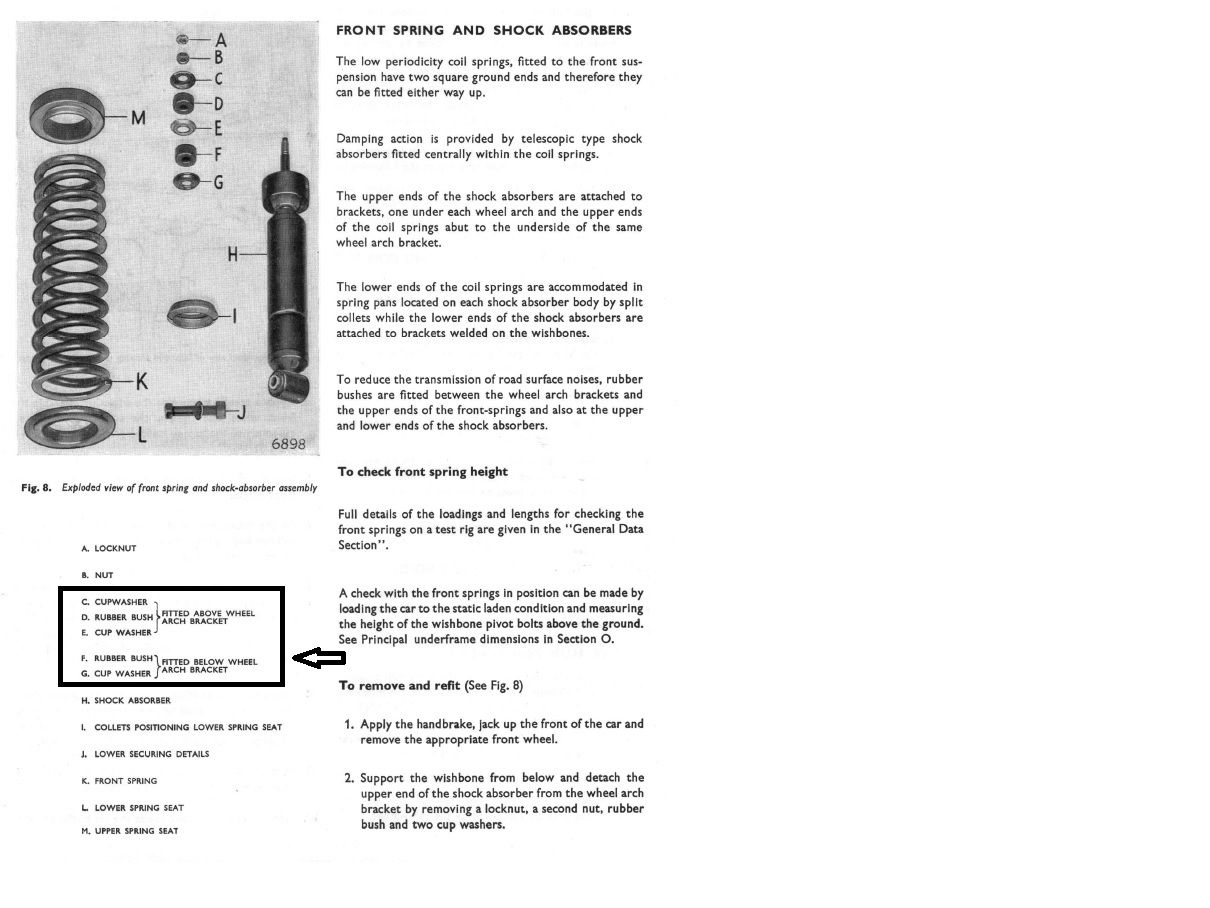

        First drawing here shows sequence but misses out the actual shock mount. Description is accurate
Name:	front assembly1.jpg

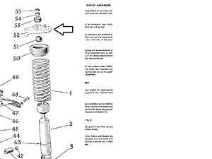

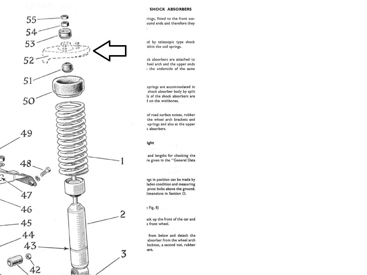

        Second one here is better and shows the actual top mount plate for the shock, you can assemble the lot off car and then bolt that plate in, two studs in inner arch area and the other two bolts are obscured by the fuel tank
Name:	front assembly2.jpg

          Yeah that's what l needed. Will see what l get and it should be obvious , looks like two steel washers and one rubber bush above then.

            Bob, 3 washers and two bushes bottom bush has washer pointing up calamped with lower cup of the top spring mount. Top side lower washer cupped up should have a ring edge to centre it on the top of the suspension mount, cup the bush and the top washer cup down to clamp.

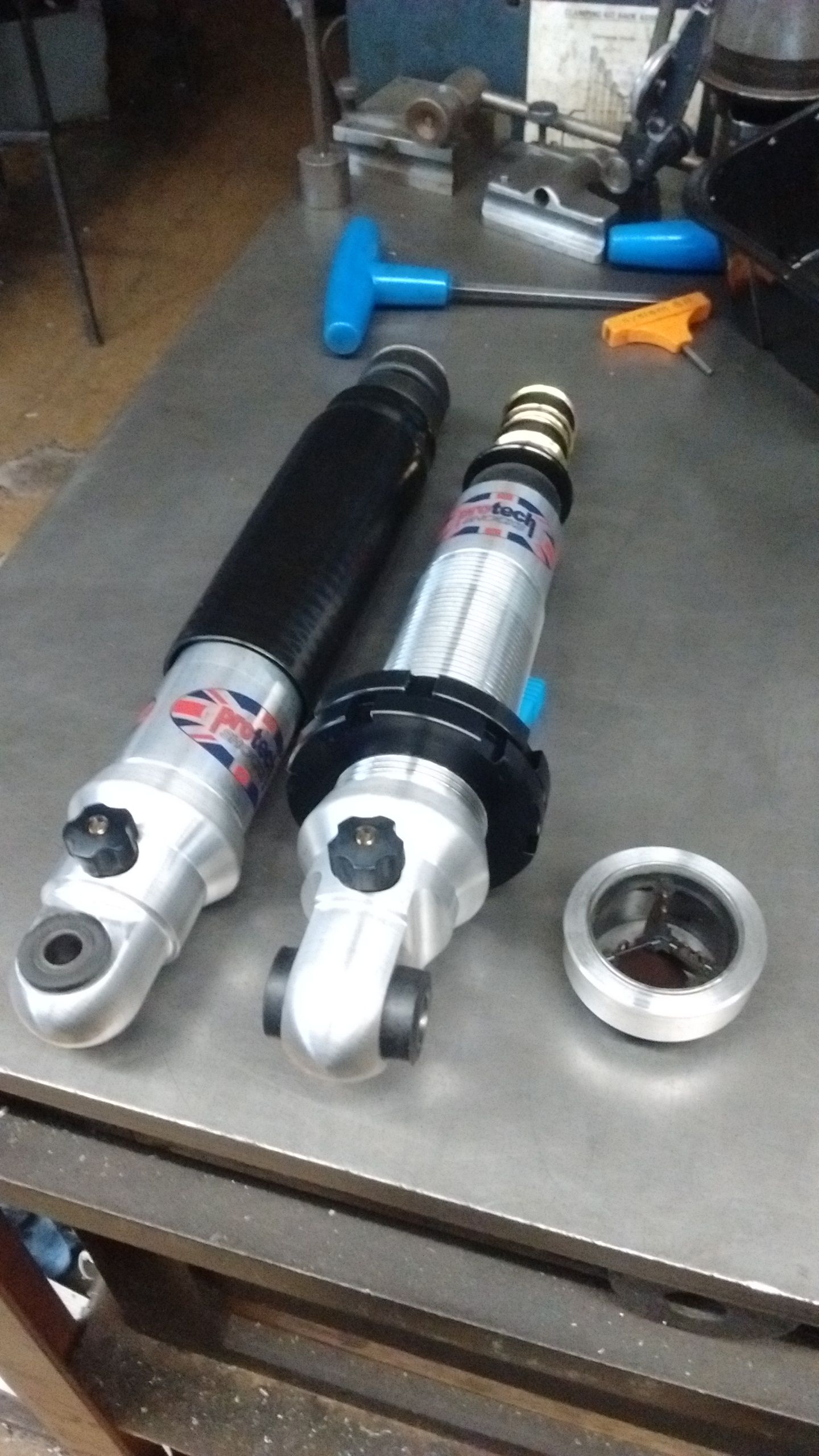

              The dampers are on the way. It is really simple to fit. I will do you some photo's and possibly a video of me fitting them tomorrow.

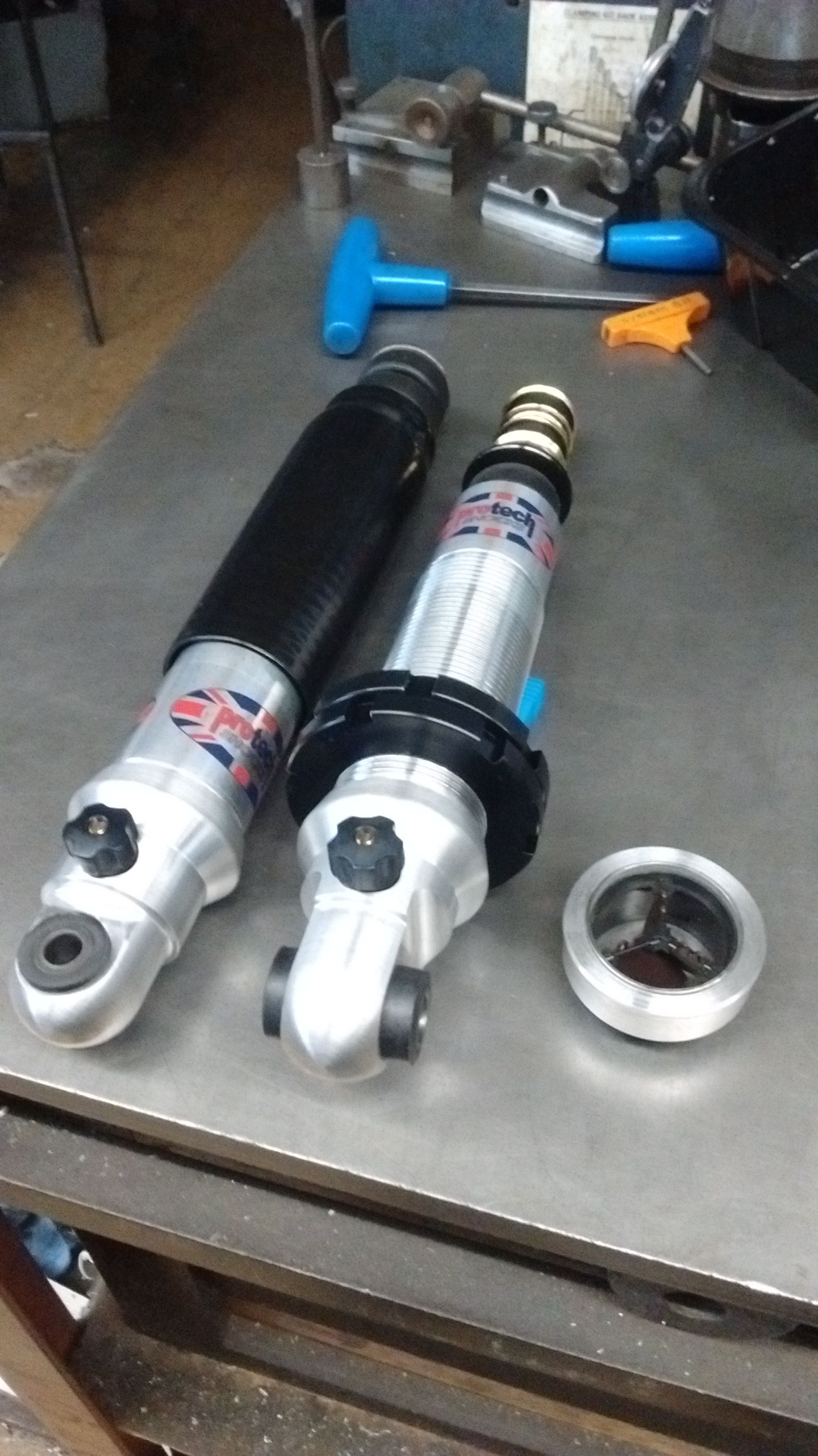

                  Nice new toys.

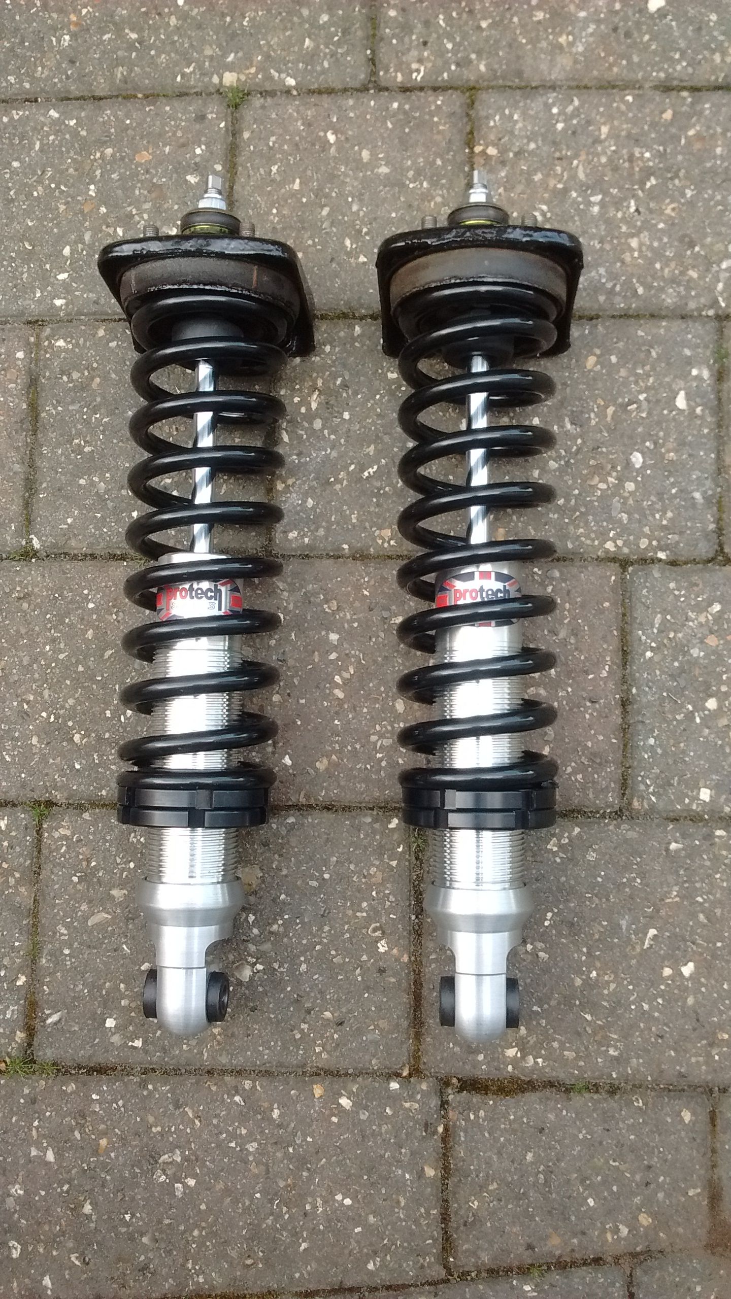

                  Thanks Mike Click image for larger version

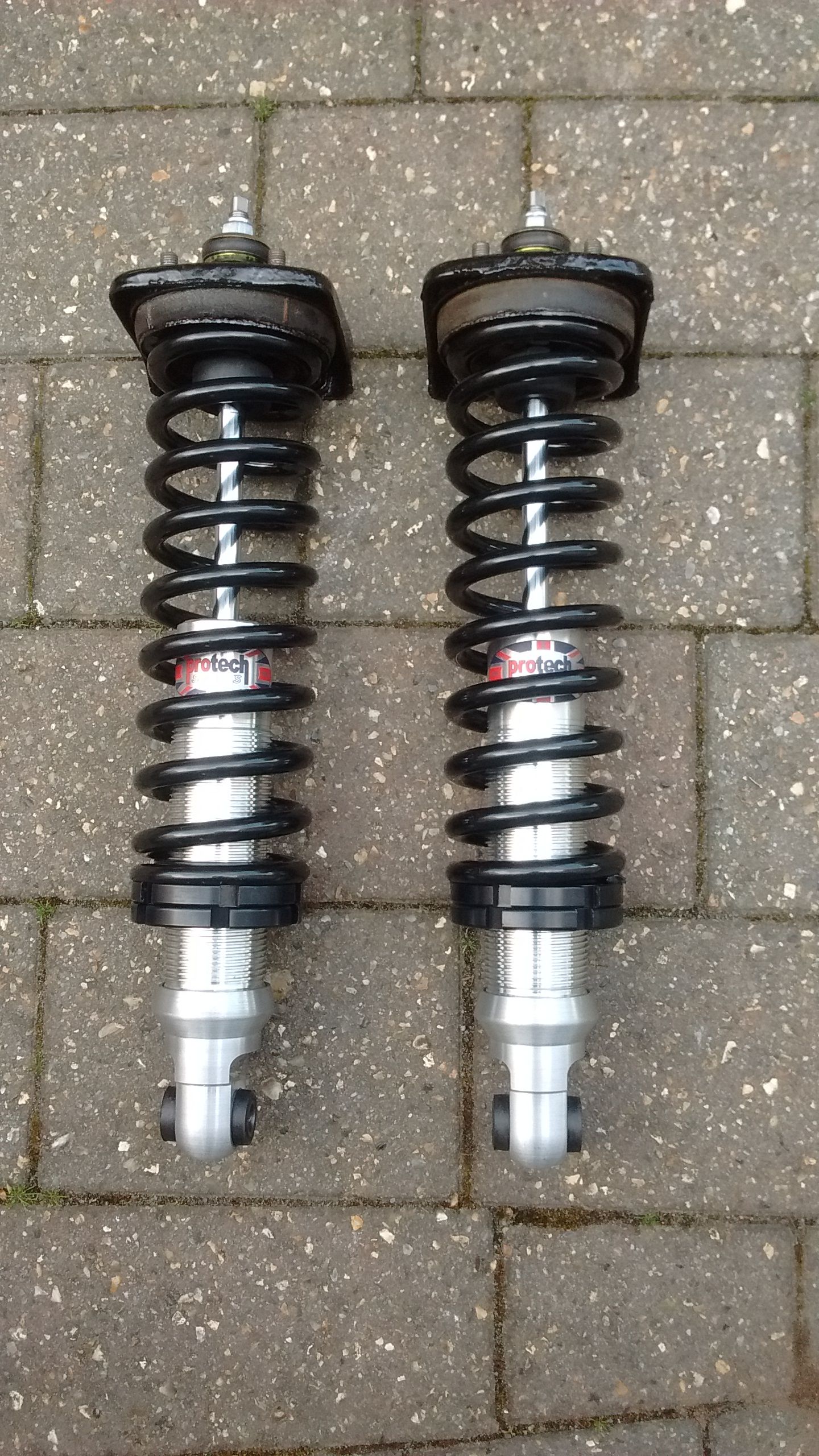

                    #39
                    Assembled new toys

                      #40
                      Lovely shiny Friday Bob. Will be great to see how it sits
