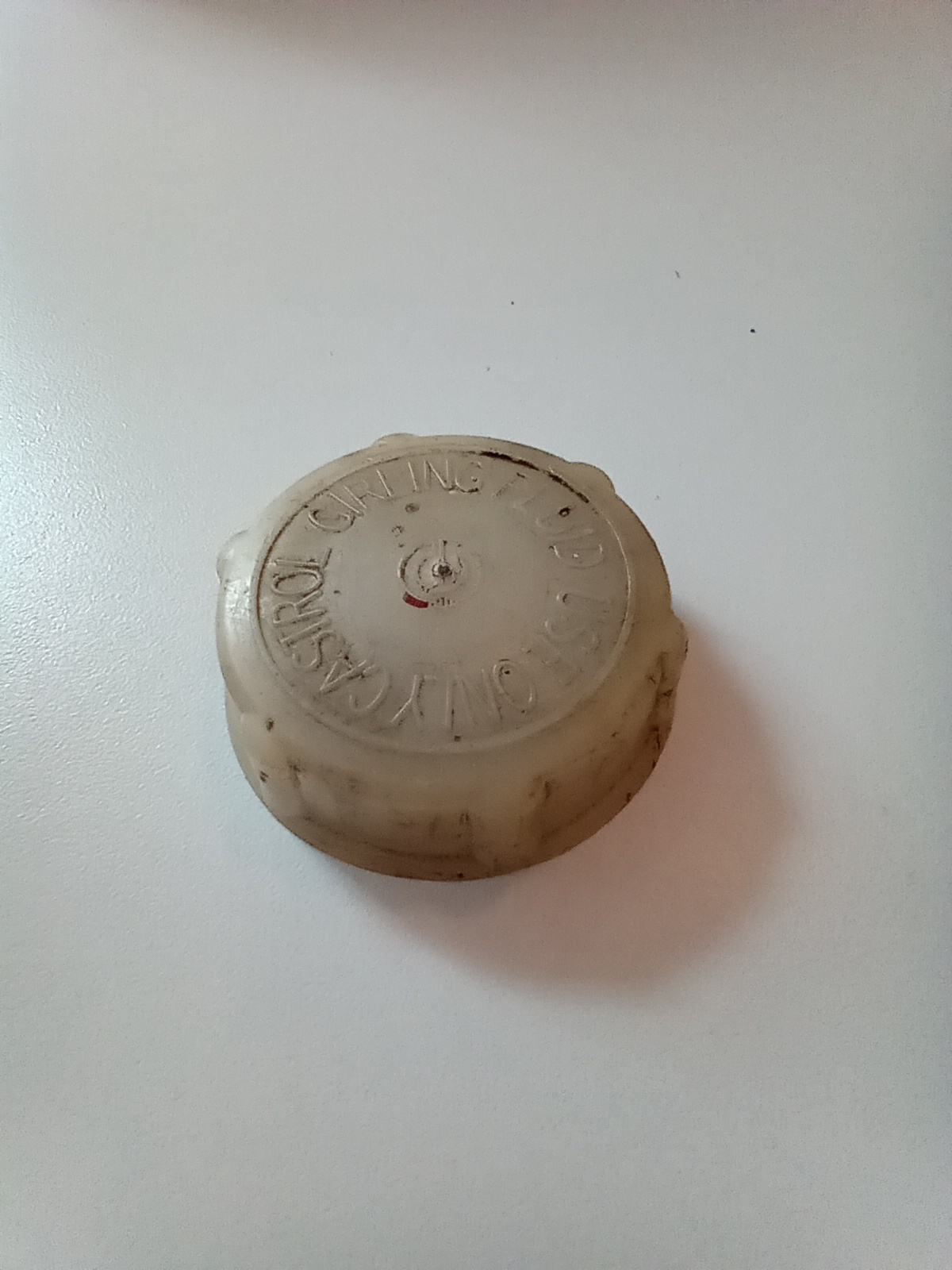

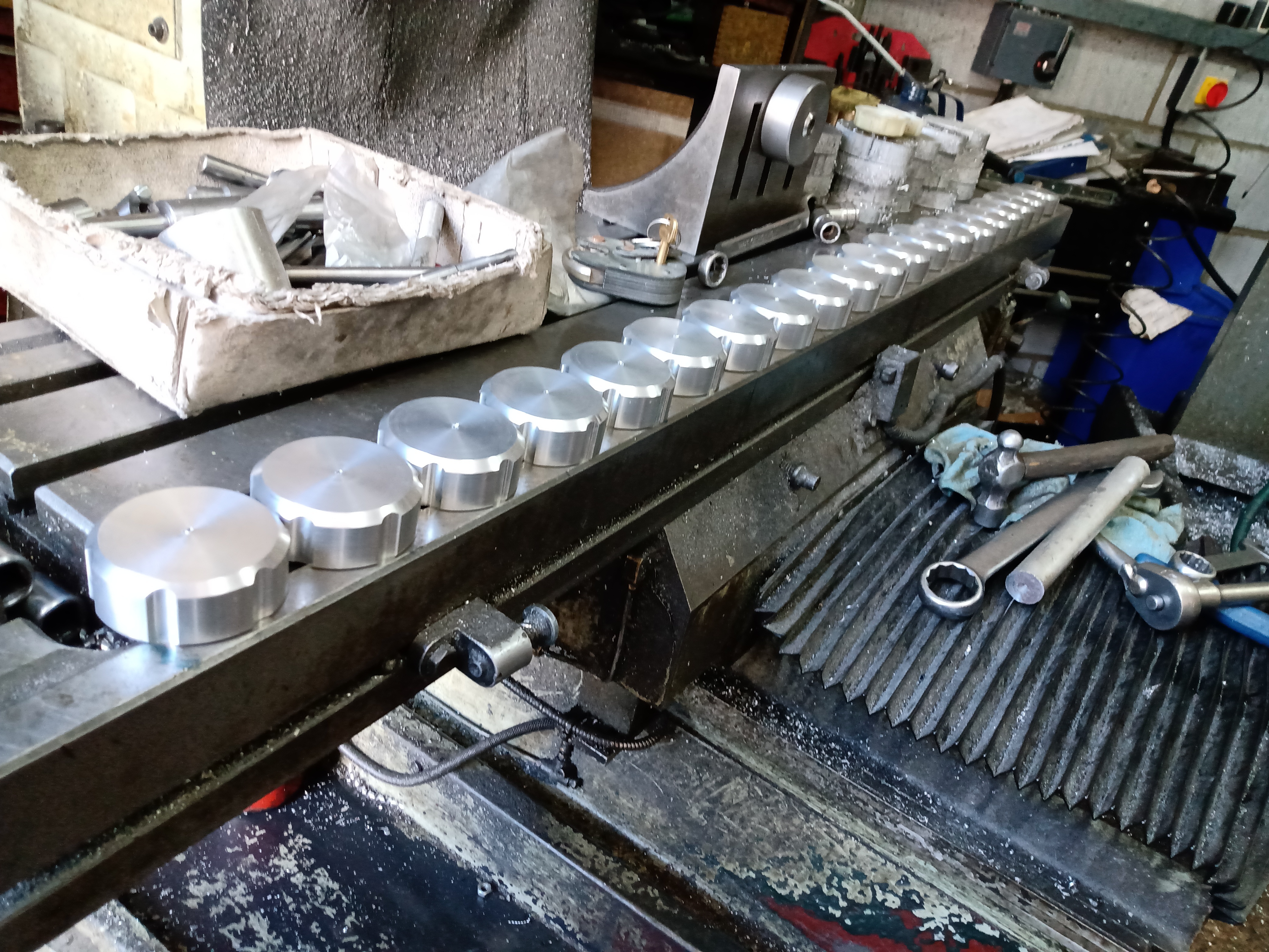

    Busy morning Click image for larger version
    Once polished changes this
    into this
    just by slotting aluminium cap over original plastic cap with a blob of glue placed in a ring on original cap.
    Filler caps tomorrow, well start them anyway. Same idea , glue them on to original cap.
    PS Trouble is back log of real work is mounting up!
      #62
      Very nice, can see these selling well.

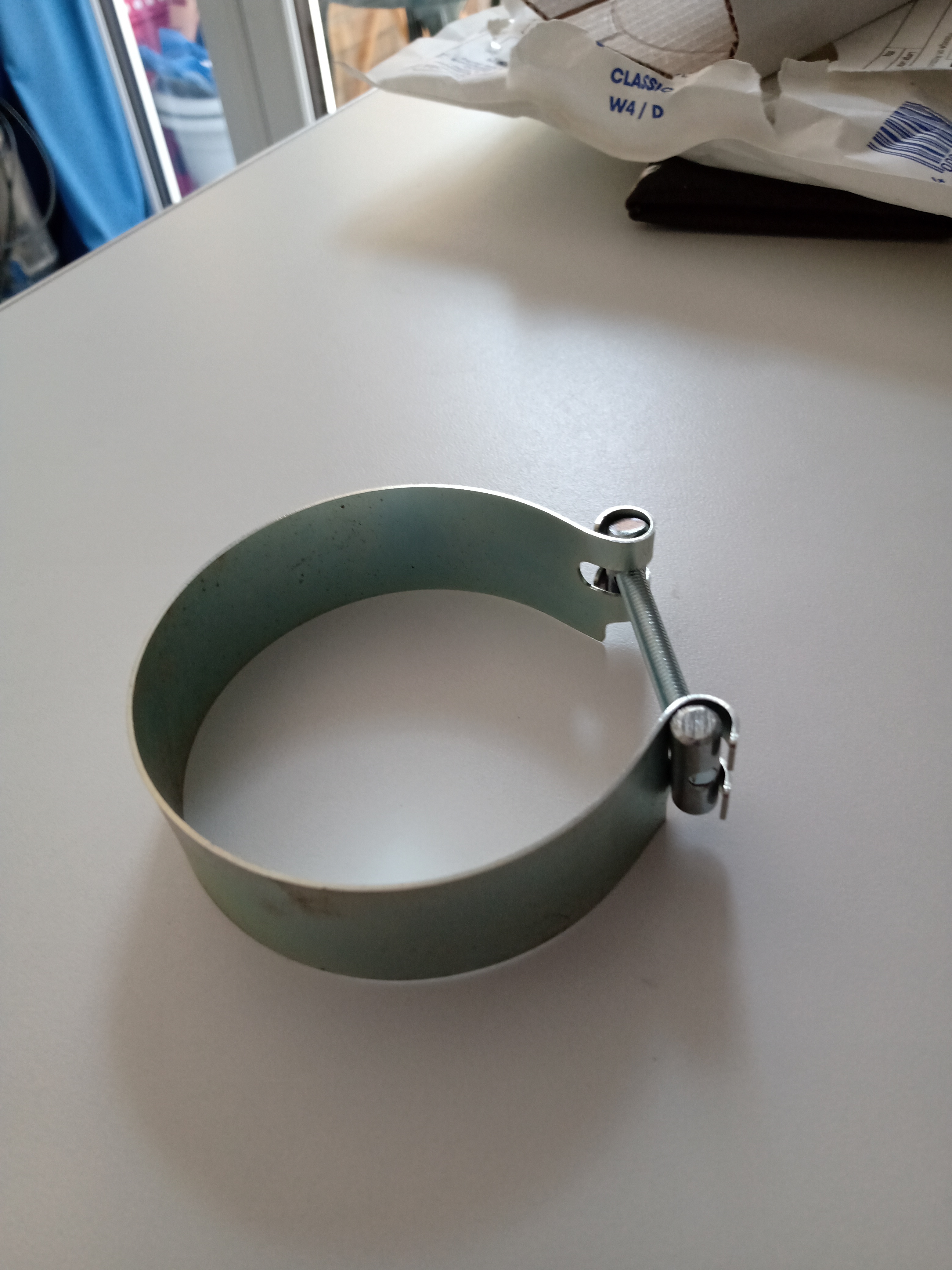

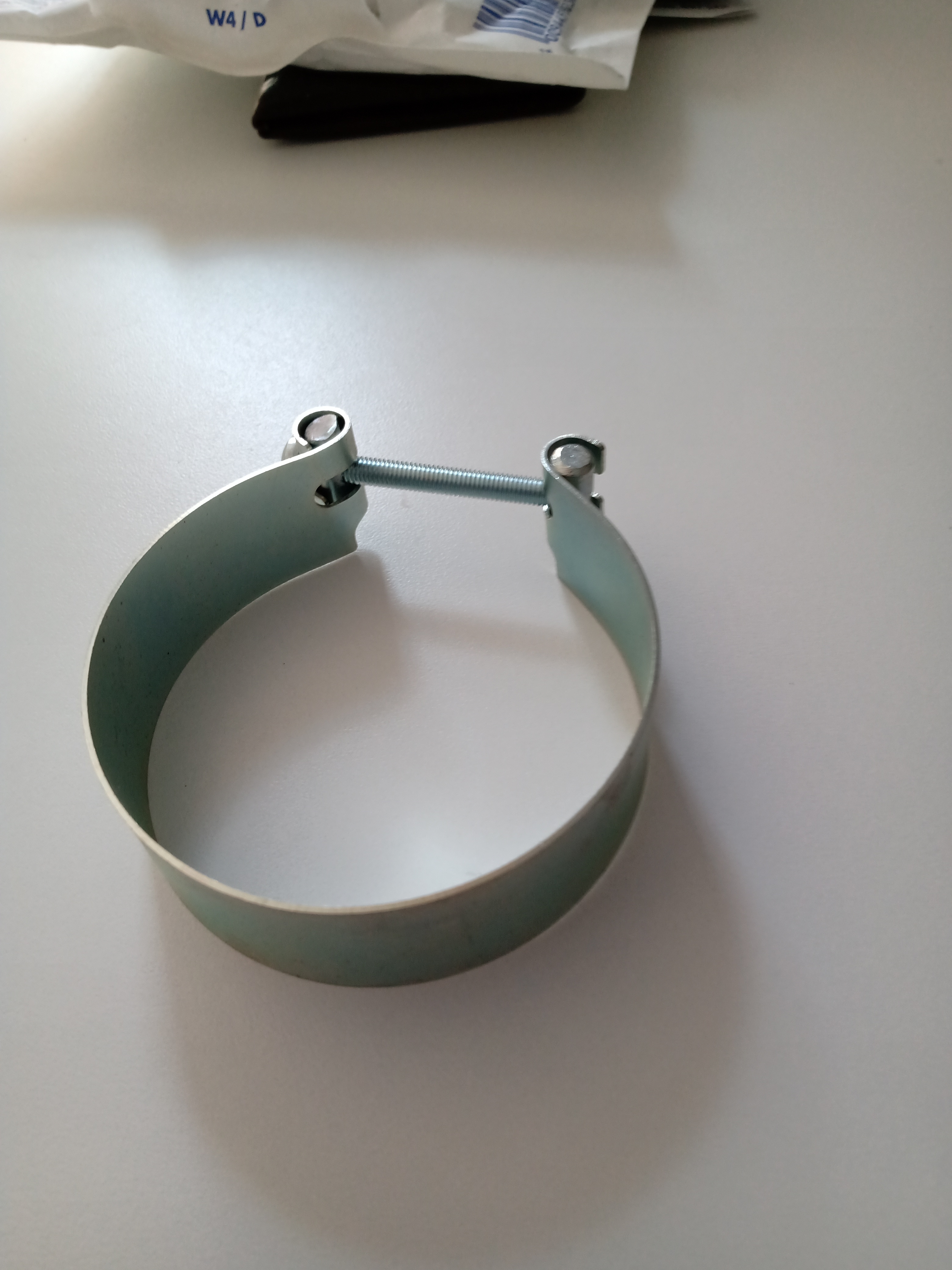

        First part bought for my 998 project Click image for larger version
ID:	16397 Click image for larger version
        I use this style on the AC engines and have never had a problem using it.
        Just need to source everything else , and decide if l'm doing bulk of work , should be fairly straight forward.

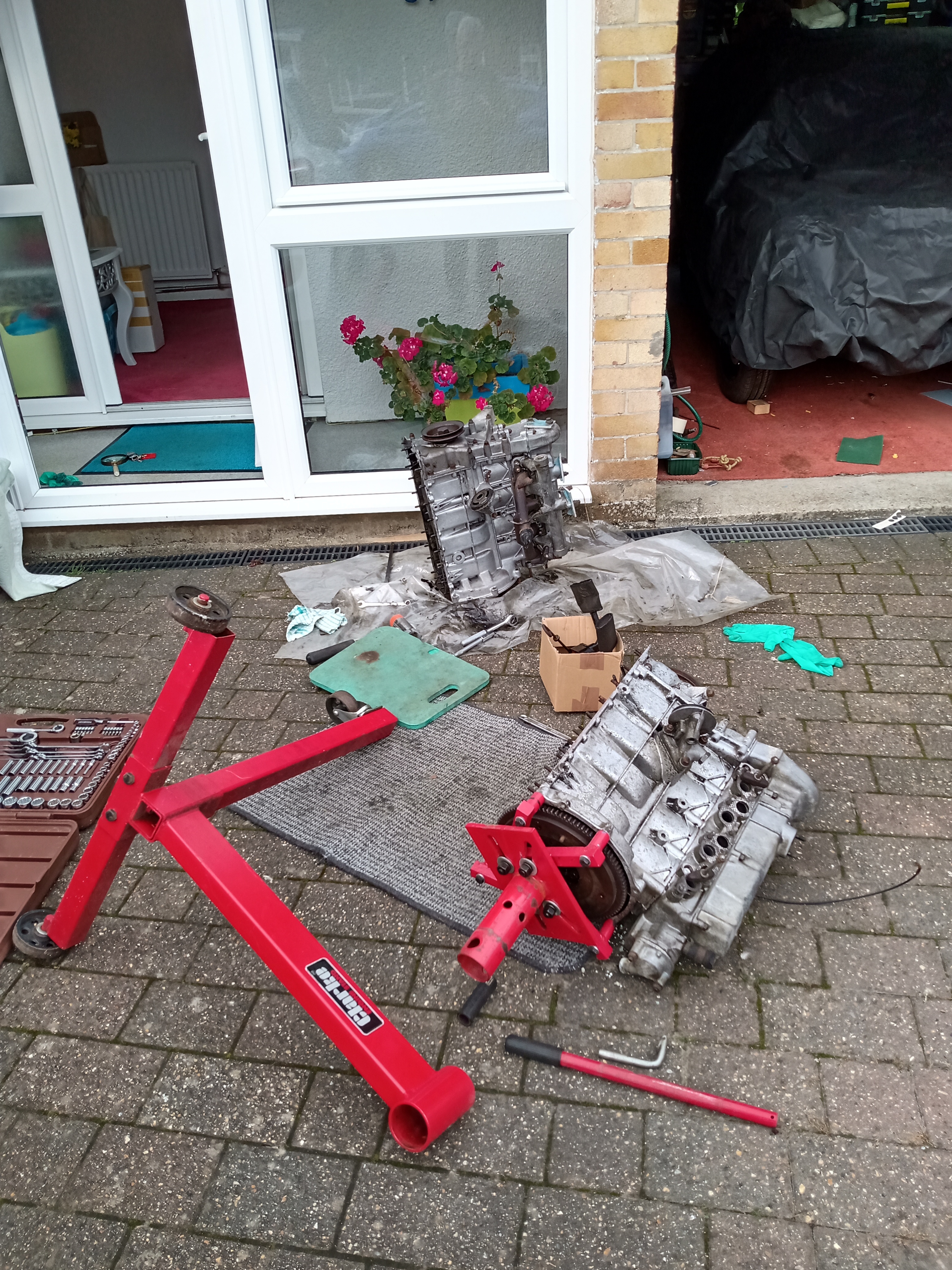

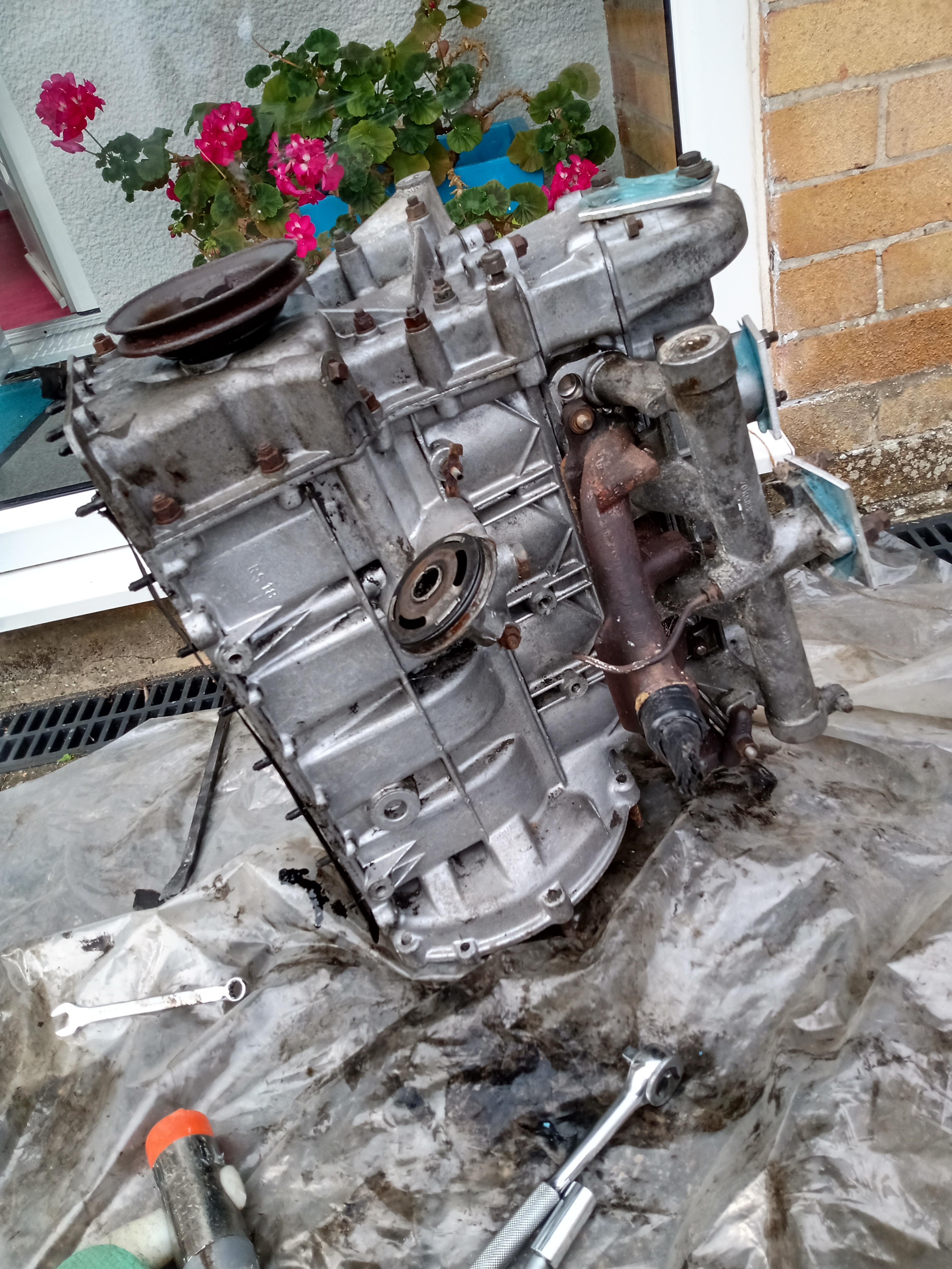

            #65
            What's point of engine cradle if wrong engine is loaded in it?
            Couldn't be bothered to change it over , once l found one in cradle was curly edged , other one is numbered 7010166 , but isn't curly edged (any details anyone?)
            now stripped, apart from crank pulley , don't have a puller here , intention is to covert to 998 .
            998 Block l bought measures up at 72.65 , so probably best opened up a tad (do oversized pistons go up by 0.010" in stages ? same as crank shaft journals?)
            Are the mains caps numbered? couldn't see anything , but covered in oil\crud, also noticed that there is a lug on side of main cap (just the one side) is it possible to put main caps on 180 degrees out ? haven't tried anything like that yet , but if they're not numbered ?
ID:	16407 Click image for larger version
ID:	16408 Yes nice flowers
            Will then really have to sort out engines , keepers and sellers , keep two 998s , have plus 30 block with all ready to be put back together , that can go now.
            Me thinks!

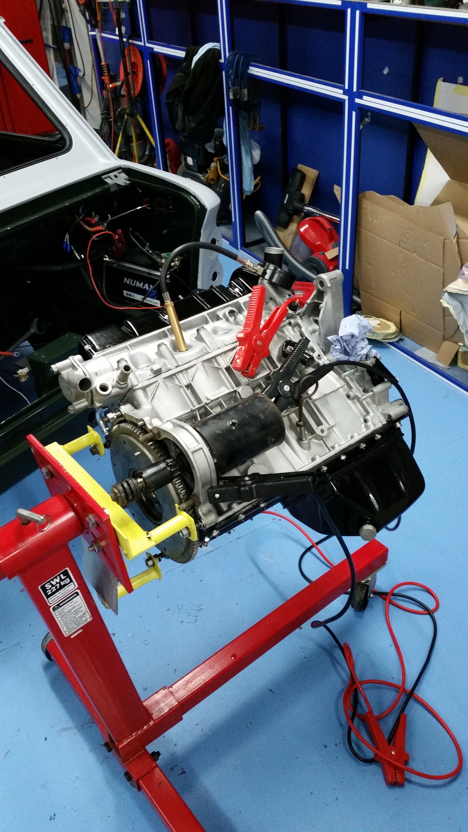

              Bob, did that fall over ?
              I made a dedicated plate for the imp engine as I found the universal legs useless, just used what scrap I had around

              The main bearing caps are line bored, so they cannot be swapped to another engine, nor swapped in place or reversed. They need to come in/out as they were built originally
              Same for CAM carrier.
                #67
                No it was rolled onto its side so l didn't have lift to engine off cradle , easier to get apart on floor.
                I DO realise that the caps need to go back as they came off , it's just that l couldn't see any markings , and as l say there is a lug on one side of cap , is this some sort of way of telling which way round they should go?
                The block l'll use needs the oil drain hole drilling and tapping .
                So you can run your engine up on that stand then , by the looks of it?
                GOOD IDEA.

                  #68
                  Bob you are an engineer so will match mark them during disassembly anyway! Rear main can only go in rear position. Centre cap is different to front as centre bearing has thrust bearings in block side, the tangs of the bearing shells go opposite each other. You will have to try very hard to get them in the wrong order.
                  The imp engine is no more complicated than any other engine. They do have their own quirks when you are getting very high performance out of them but as a standard engine right up to home built 998 with a high lift cam porting bigger valves etc, so long as someone who knows what they are doing has skimmed block, pistons, head and altered combustion chambers to get the compression correct for you the build is easy.

                    No, I never start an engine on that stand. Thats only a compression check after dry spin (no plugs, just get rpessure up) hence the starter

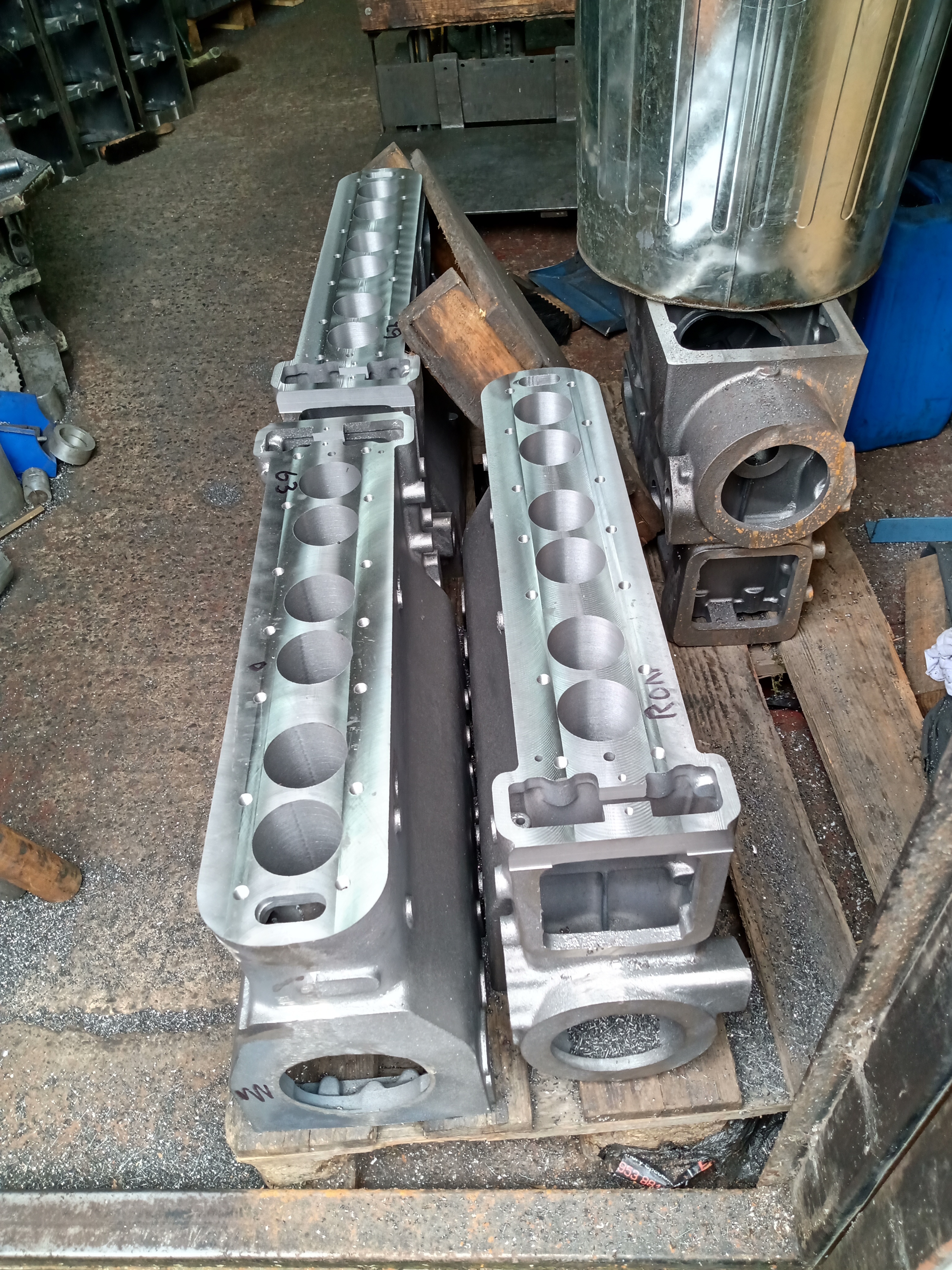

                            First op finished on block number 9 , one more left to finish top face.
                            10. 5 Stones in weight before any cutting , how many imp crankcases is that?

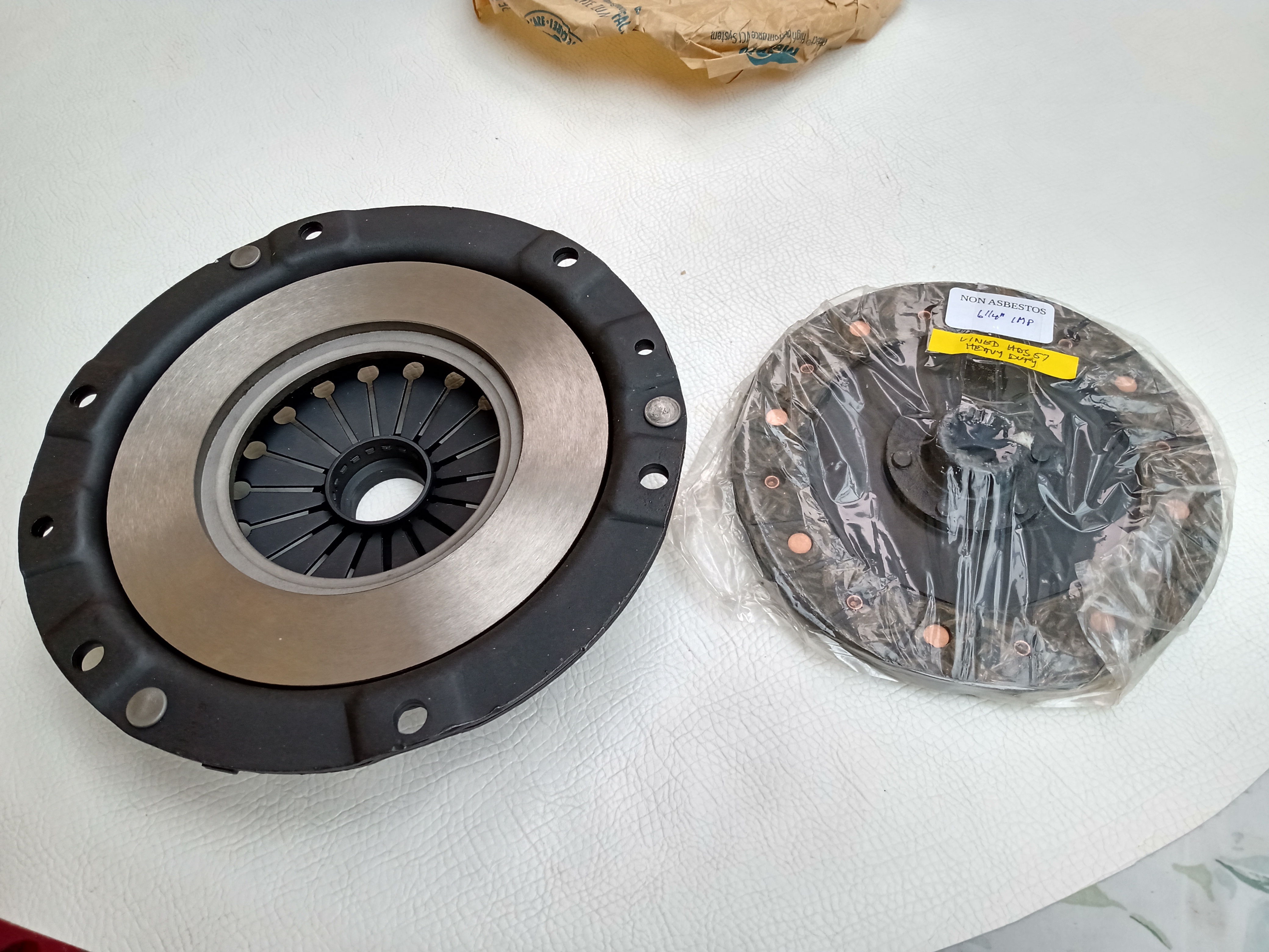

                              #74
                              The clutch pressure plate looks very clean.
                                #75
                                I should hope so as it's refurbished!

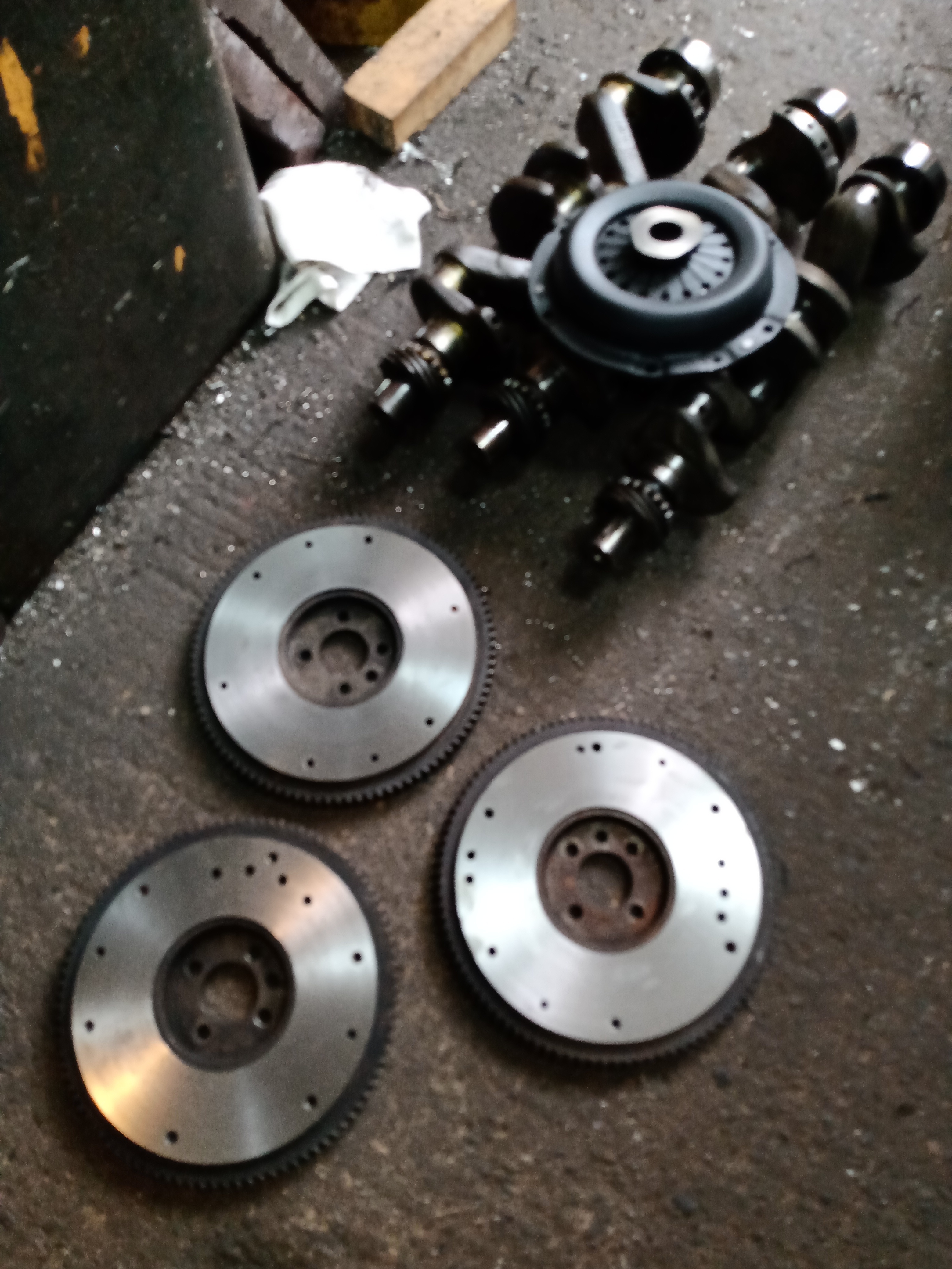

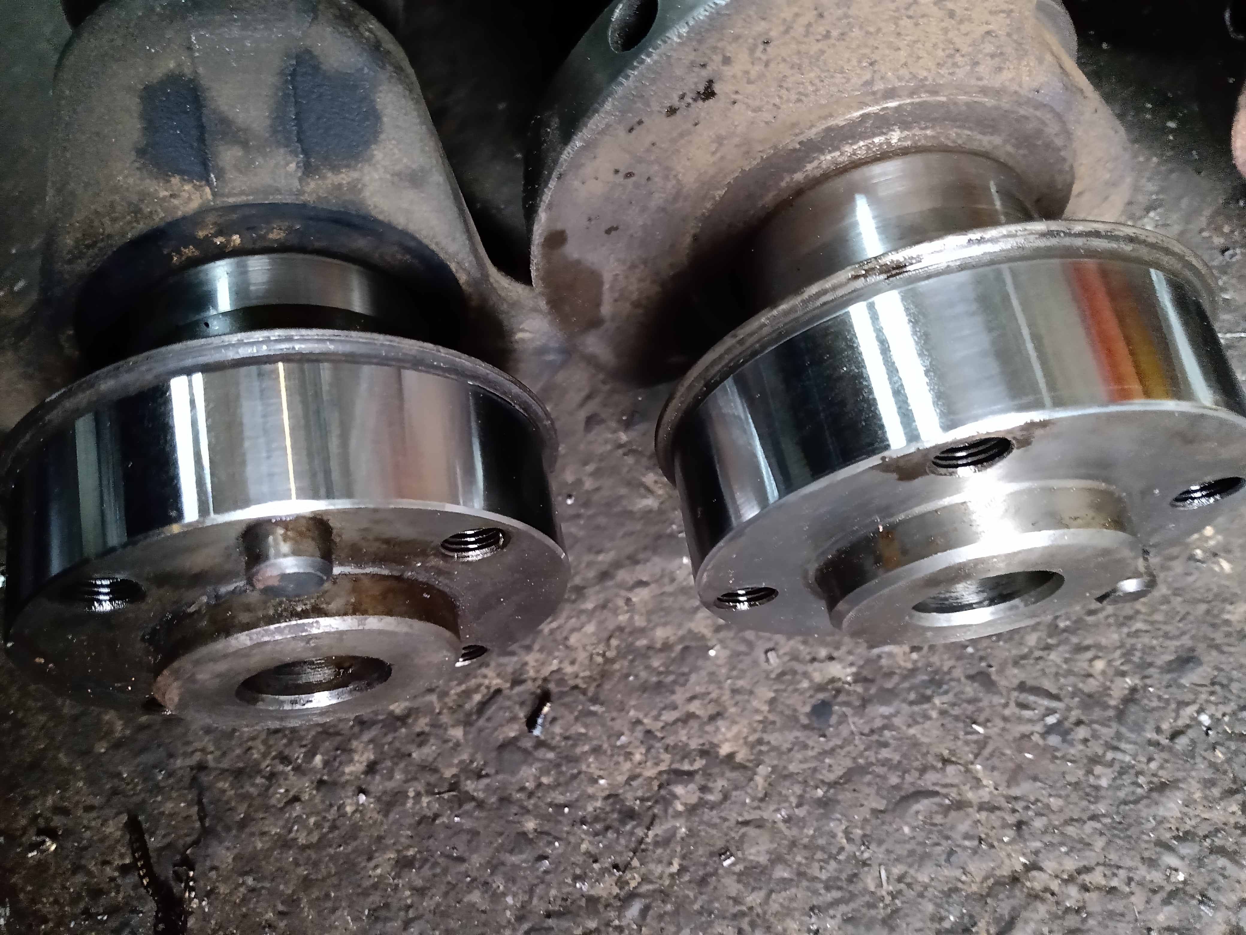

                                Latest Imp work , machined 3 flywheels (lightened) turned scroll off three cranks for rear oil seal conversion
                                intention is to convert 2off 875s to 998s , l already have a 998 bottom end which l'm going oversize on , then l can put one on shelf , one in car and flog one on as a kit
                                also making block strengthening kits for them At least the Imp blocks can be thrown around as they're so light, not like those cast iron blocks.
                                Nearly always something new to think about!

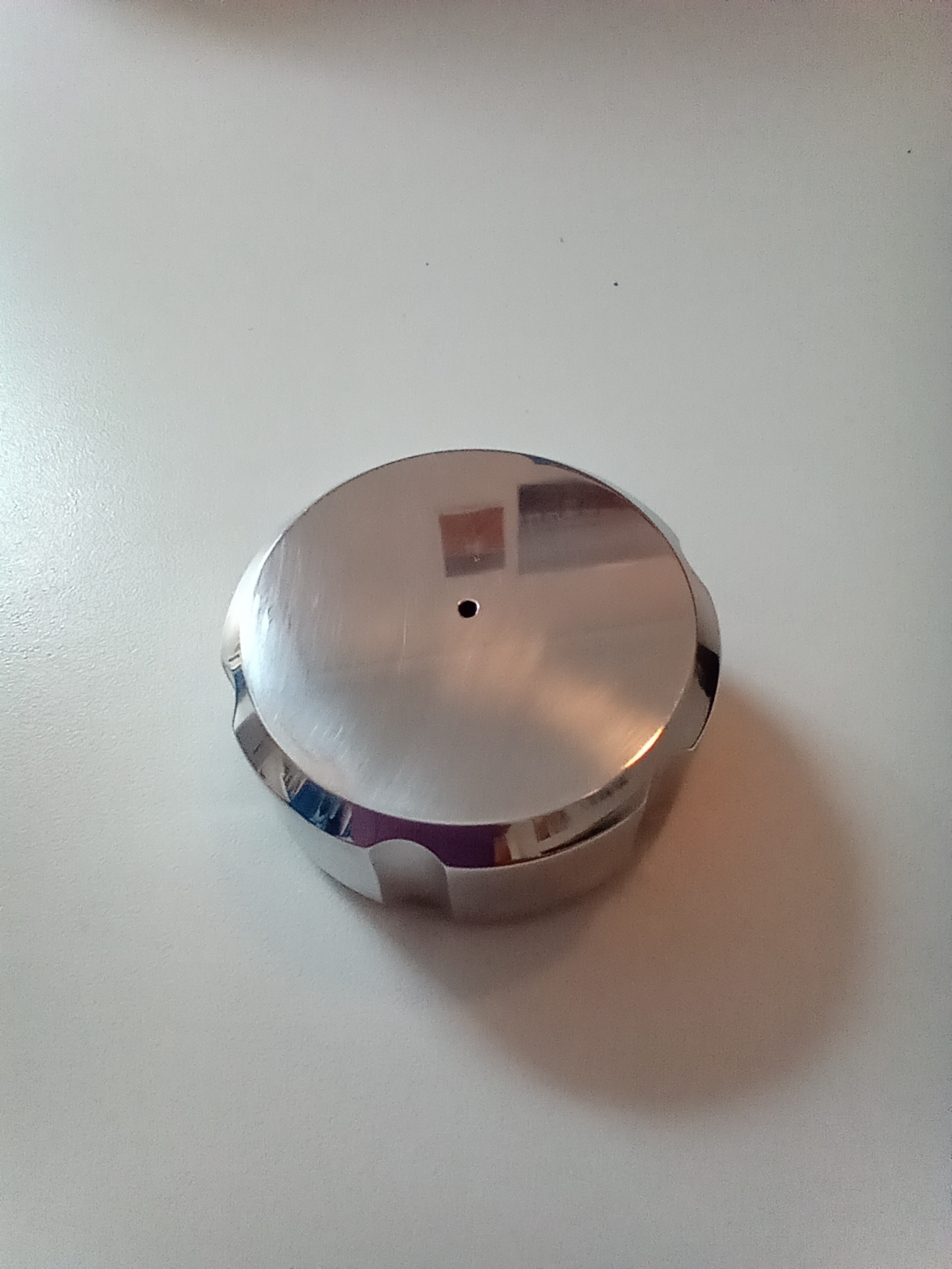

                                NOTE to self
                                Don't forget filler cap covers!
