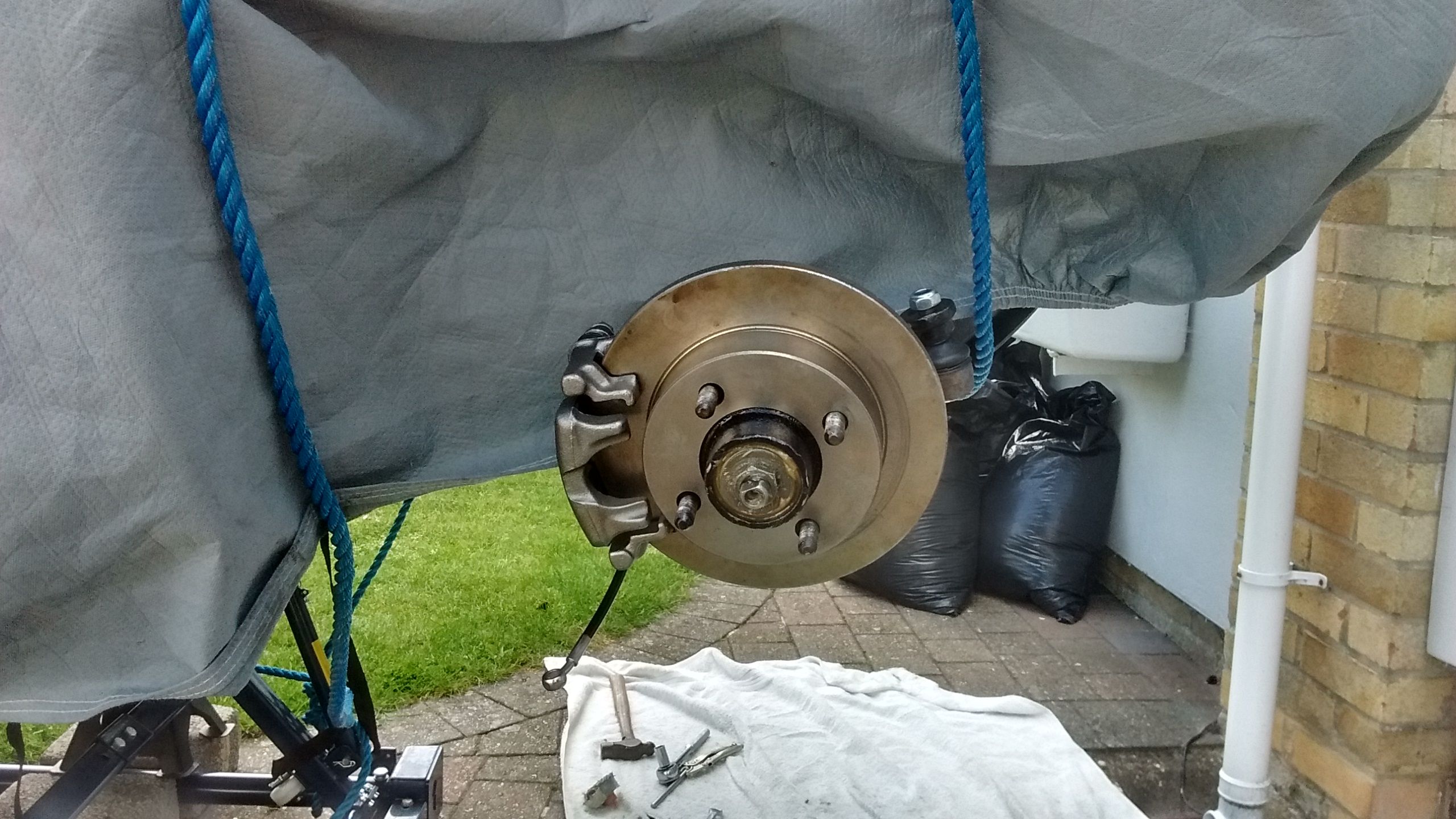

    Got so far . Needed to buy another torque wrench as one l had was higher torque so off to town .
    Just followed my nose to see how disc set up fitted Click image for larger version
    Just about got my head around it.

      Yes the hub nut torque is really small, could almost do it by hand, you can actually feel it anyway Bob by hand when you spin with a wheel on. Manual says do it wall with road wheel on anyway
      Looking good though, closer to being on the ground,

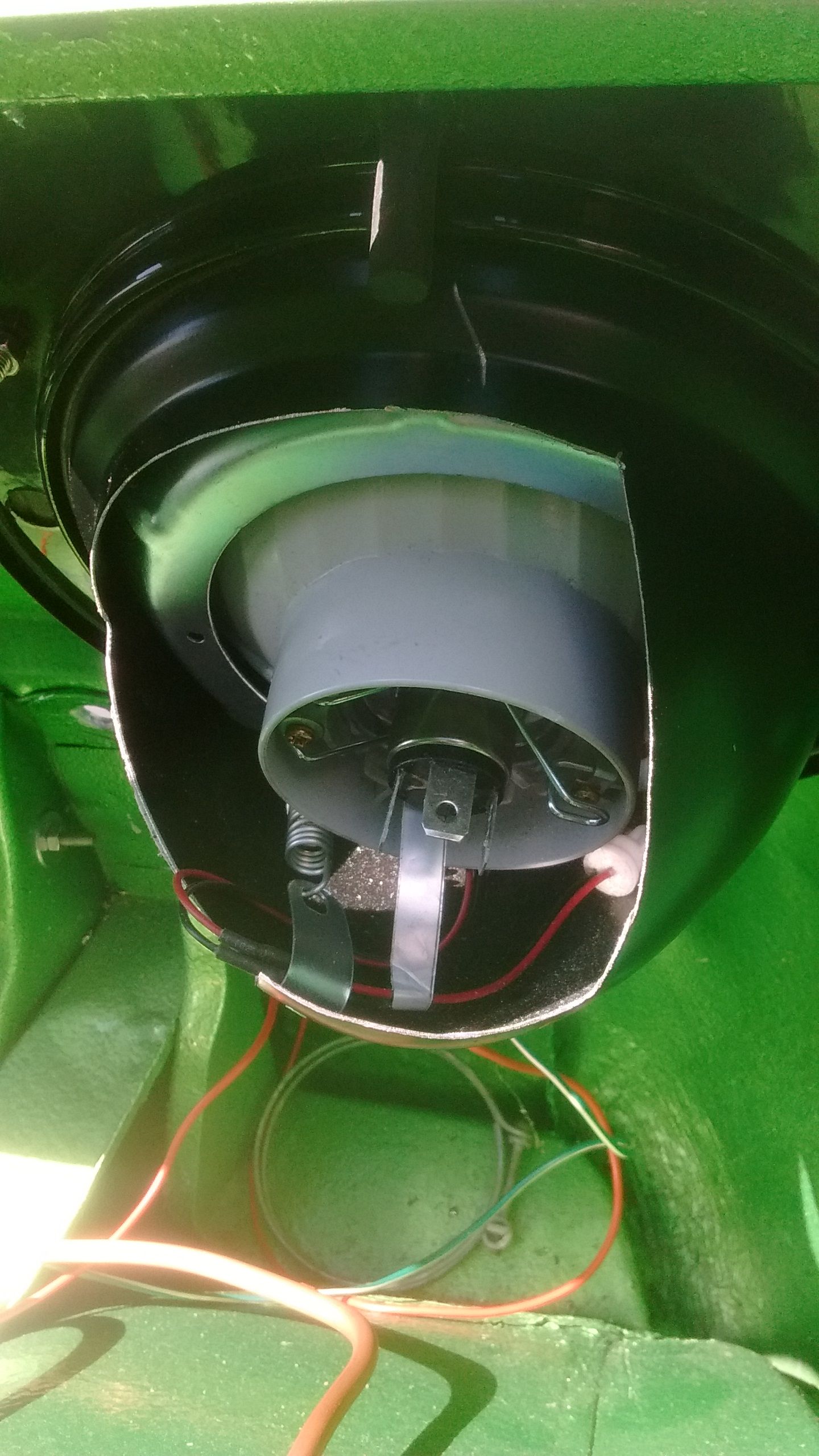

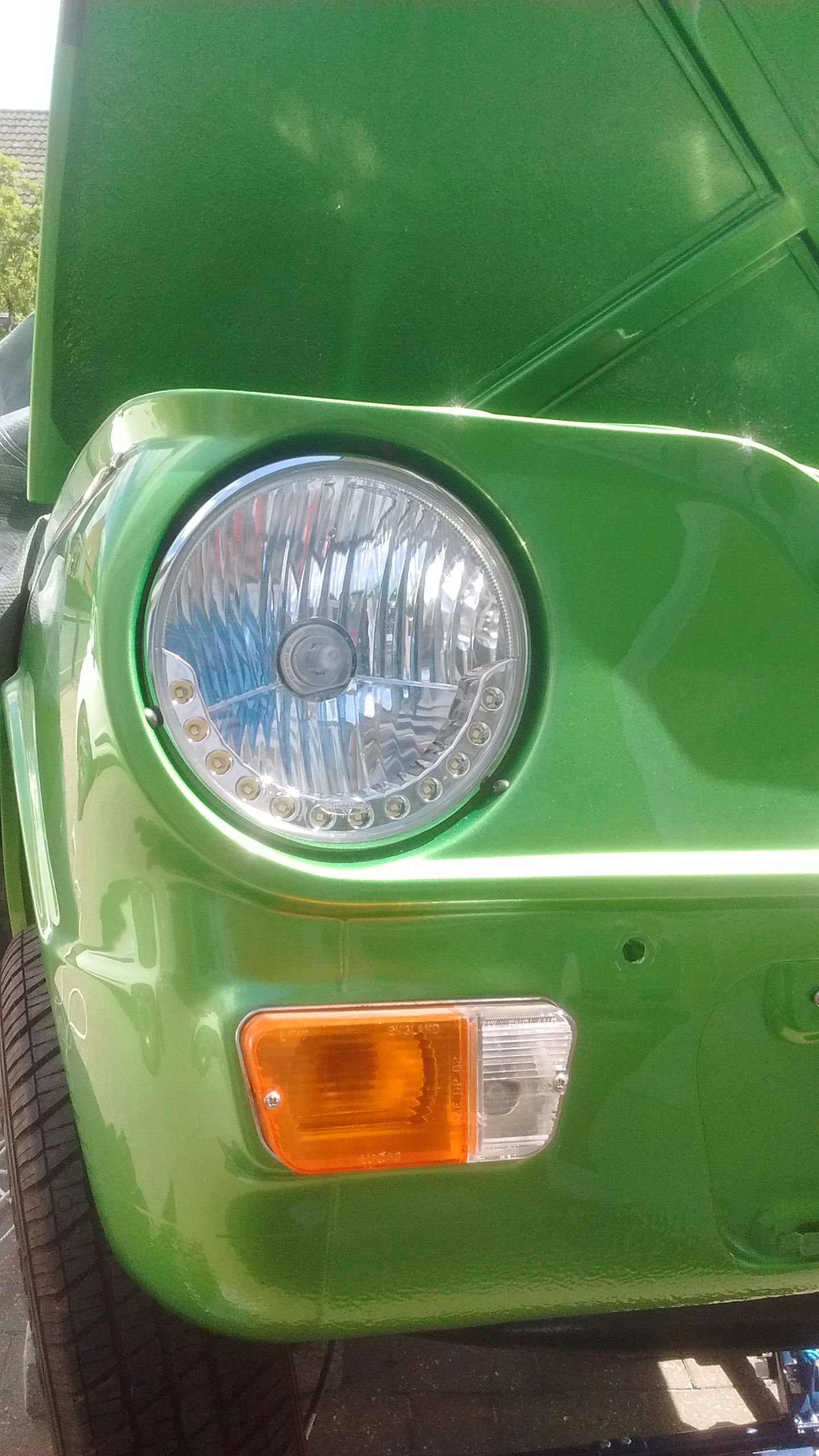

        Trial fitted one head light Click image for larger version
        Needed to remove it as the new assemblies l bought , the screws didn't have any way of fitting the small adjusting knobs , so modified the rear of the screws by grinding a flat either side until knobs fitted ,

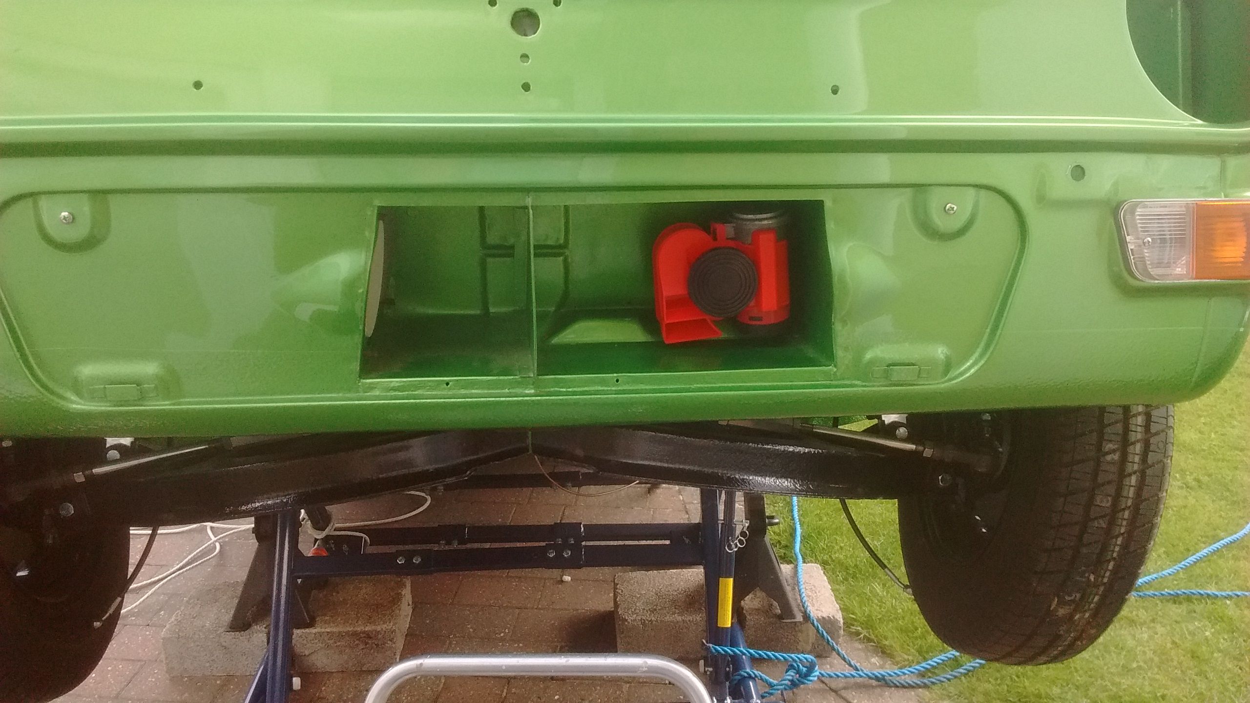

        Fitted nice NOISEY thing (l've always found that air horns and similar make people realise you ARE THERE , not like normal horns . (USELESS) Click image for larger version

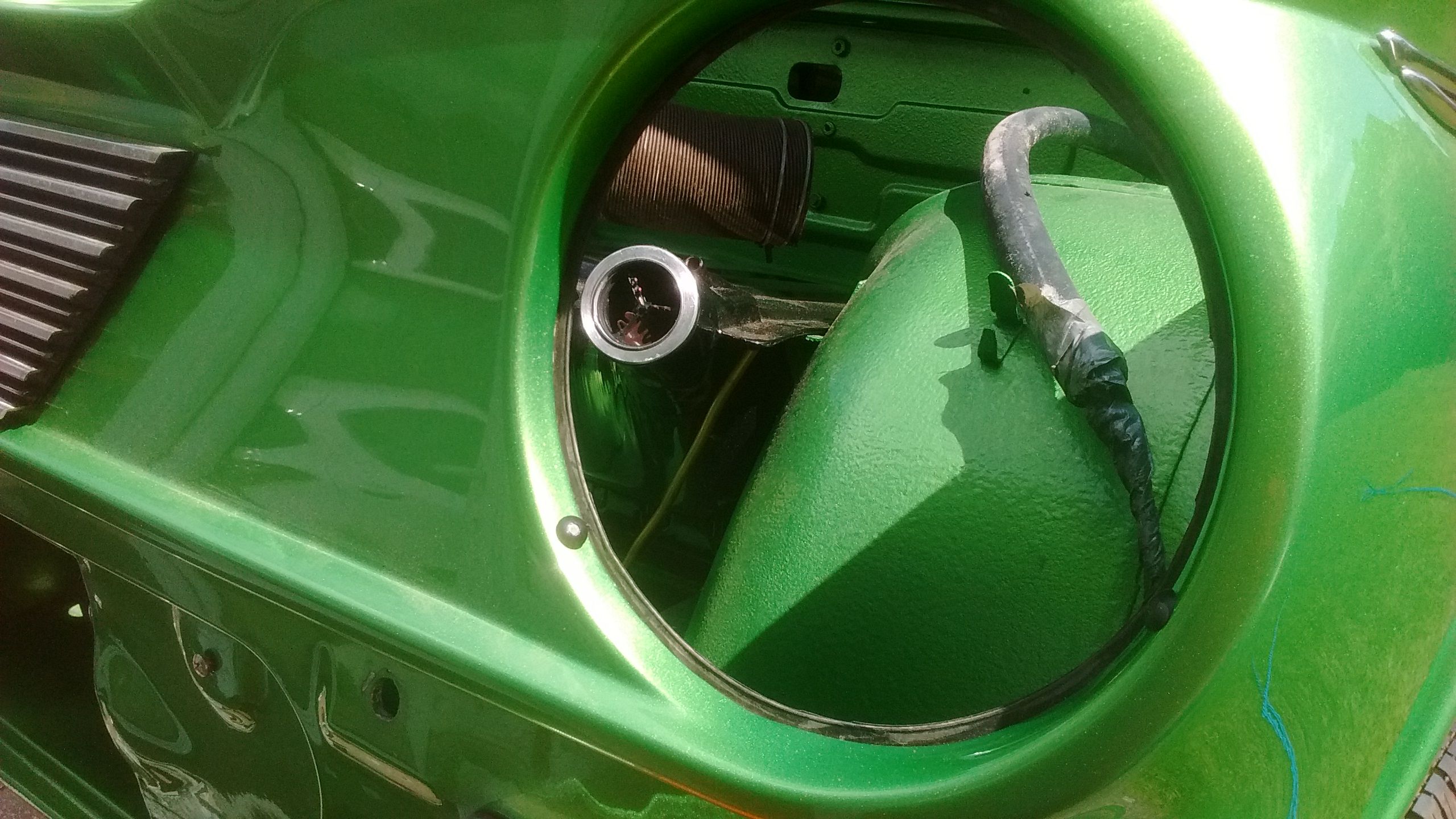

        Modified headlight bowl ala Dave Lane . Click image for larger version
        Need to fit plastic trim yet .

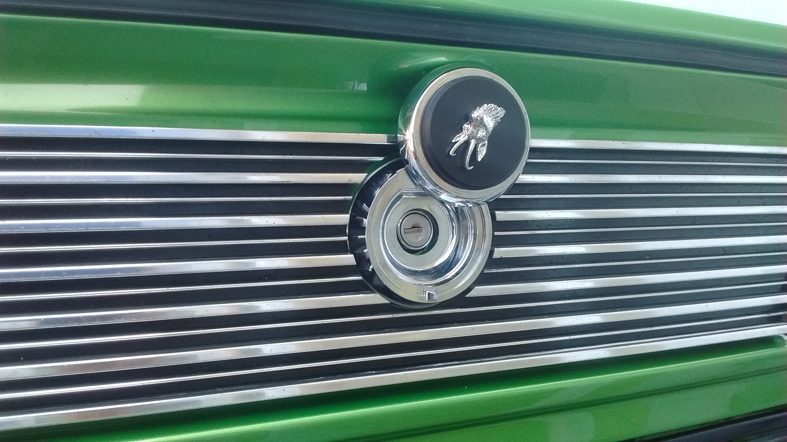

            I modified the lock bezel so that it pivoted upwards , my theory was that it wouldn't be correct swinging downwards to open it , I was wrong then , so l need to make a tapered ring to sit behind the lock bezel so that when l swing it to lock or unlock , it doesn't hit the bodywork .

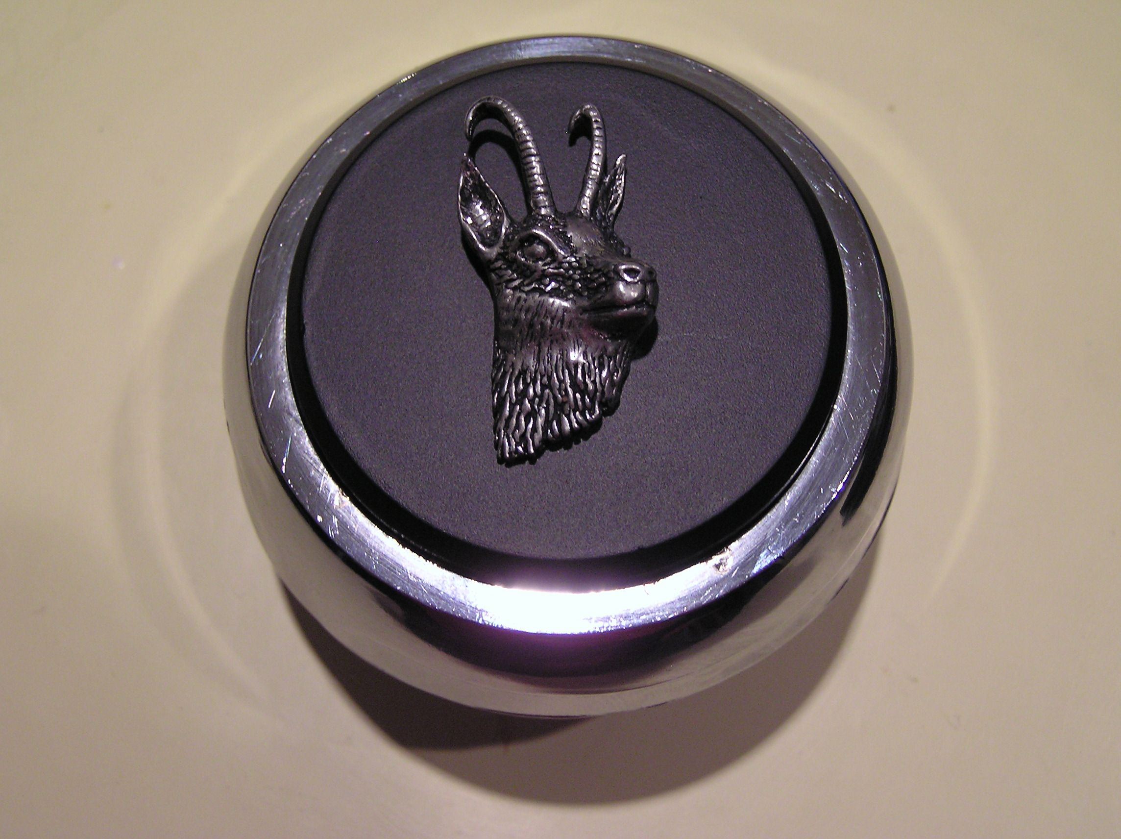

                Yes also got my customised badge to go on
                  #23
                    #24
                    Unique and really cool Bob, cant get a better combo than that
                      #25
                      Yes the uniqueness appeals to me .That's what l'm aiming for.

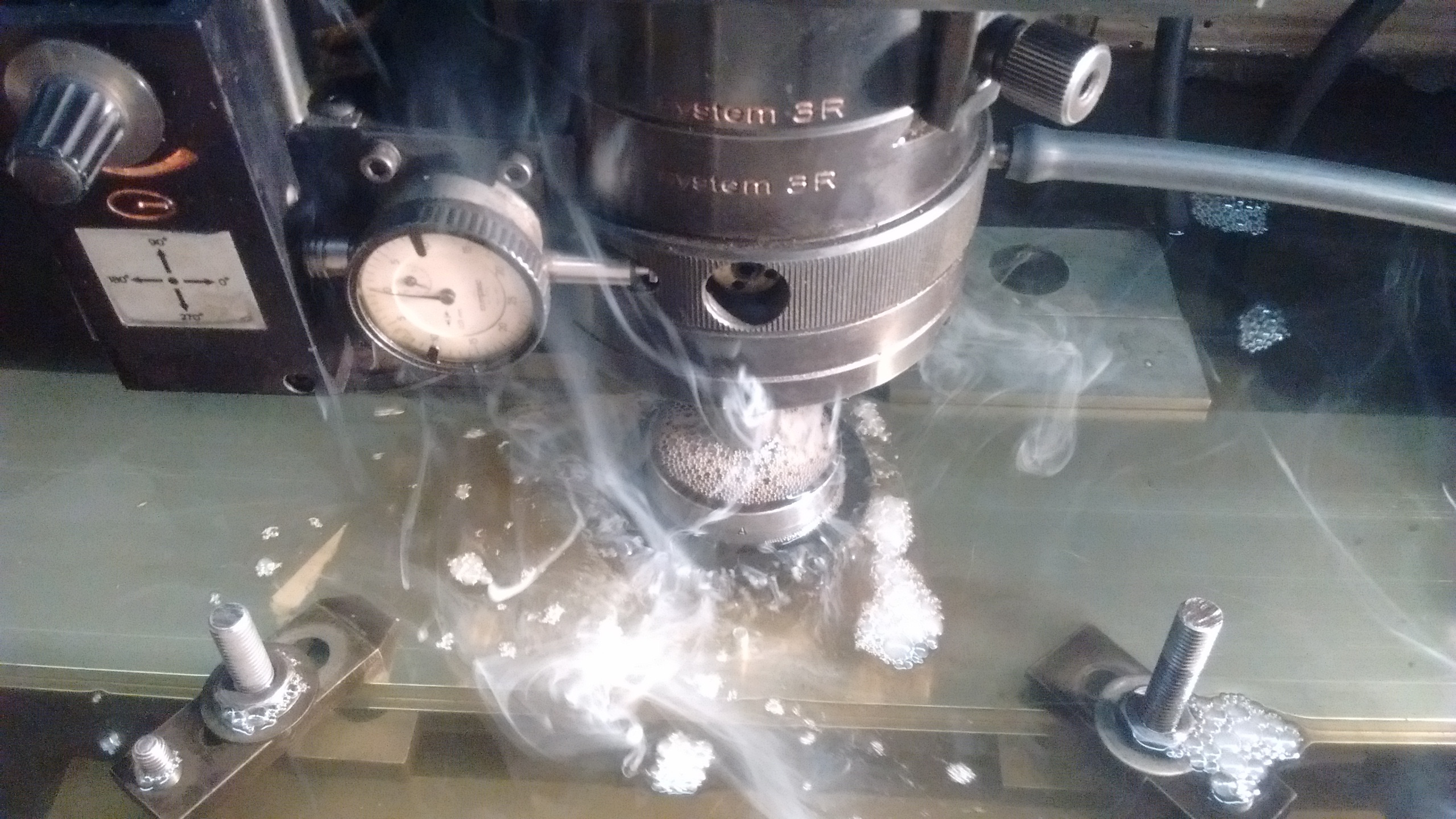

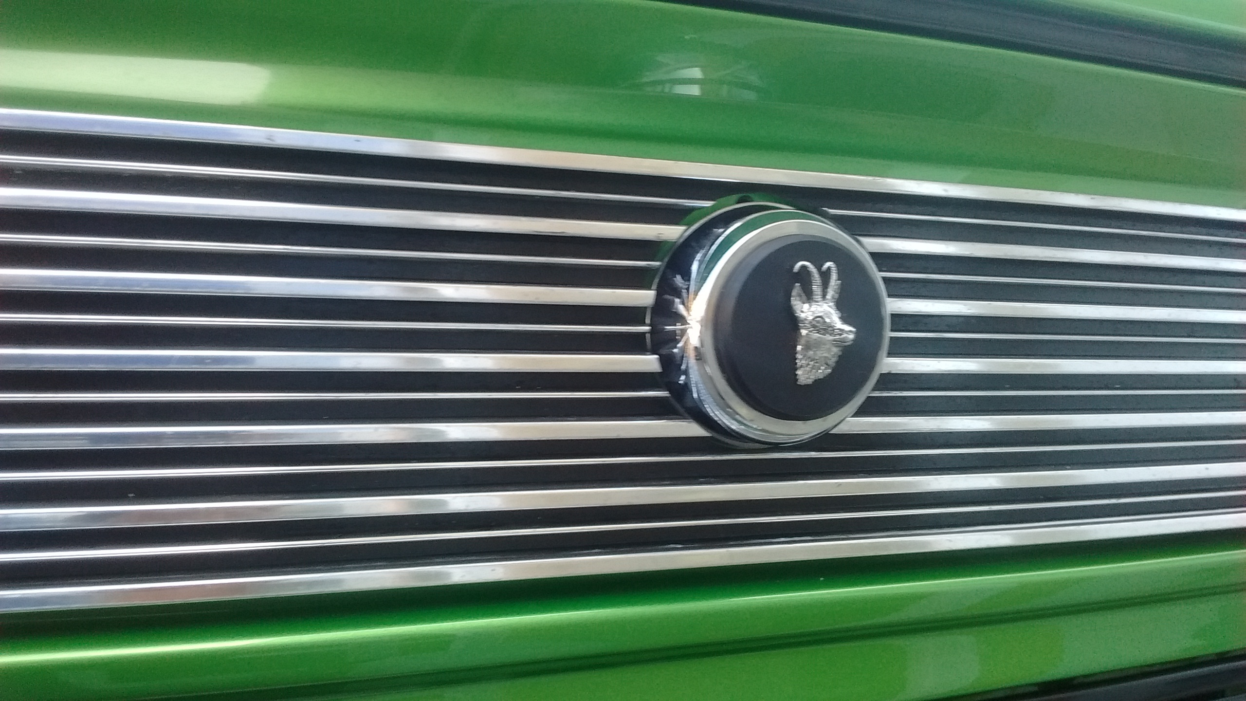

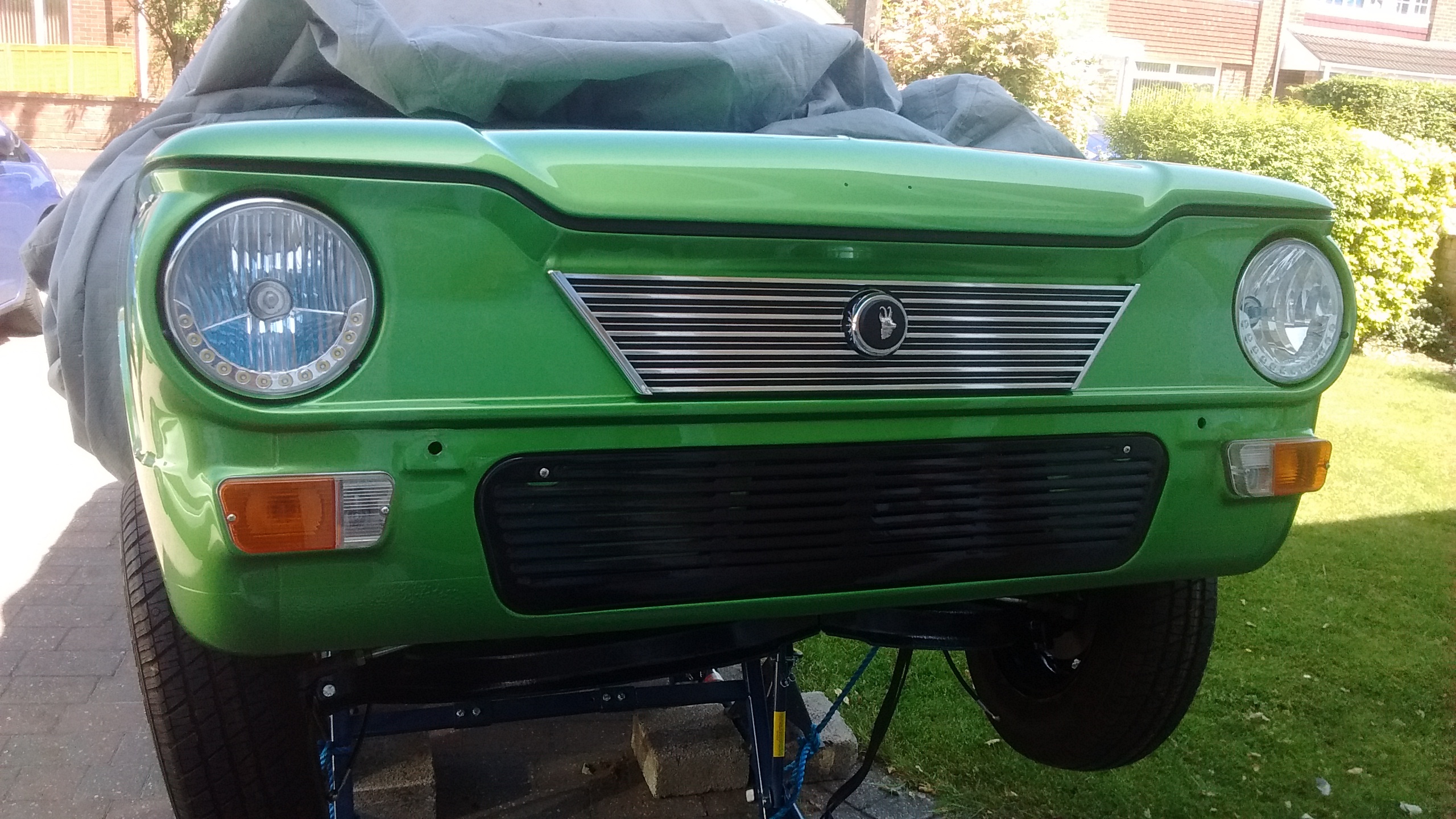

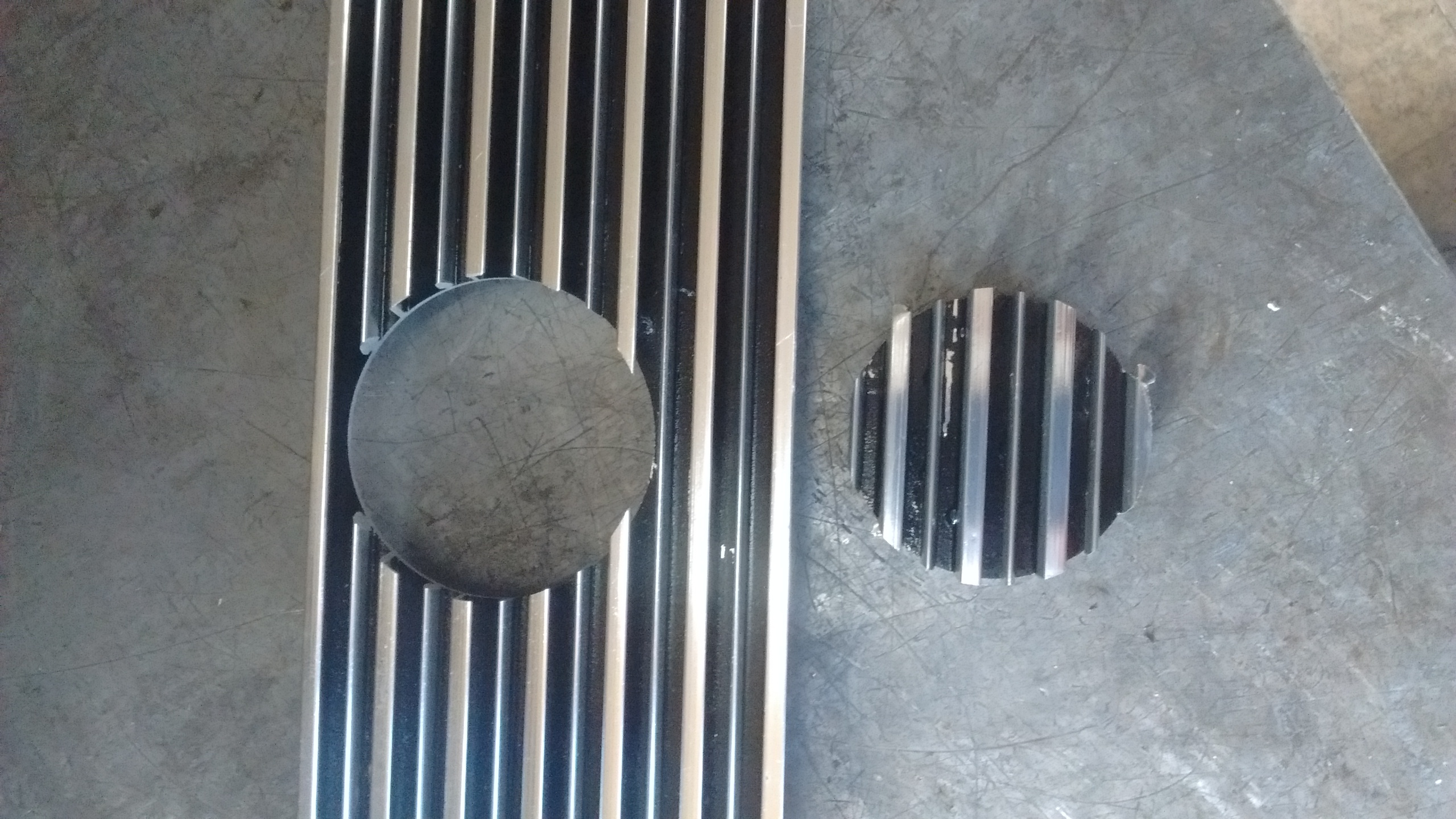

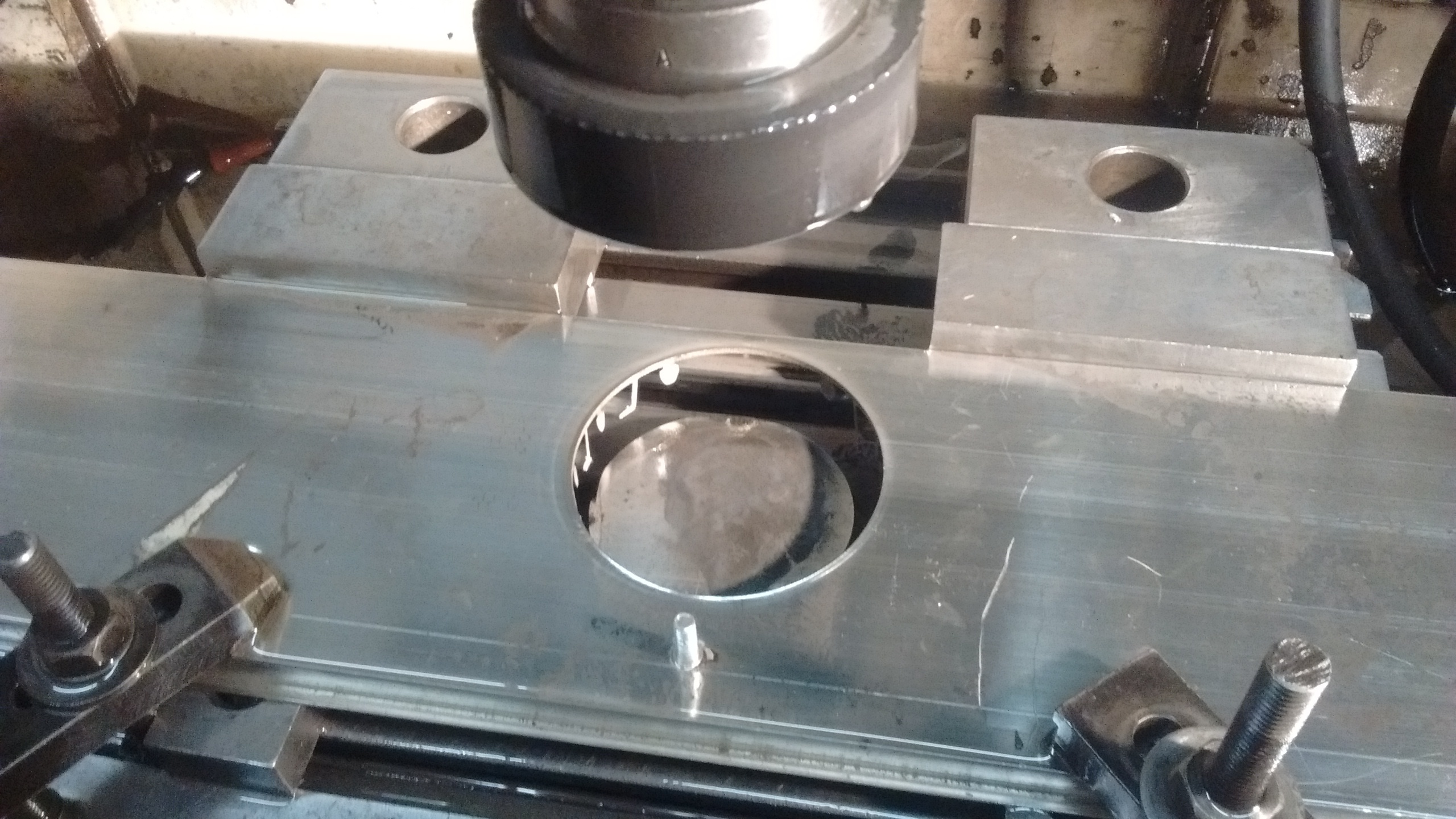

                        Been sorting dummy grills (l have a few to chose from)the best one needed a hole machining in it for lock\ badge bezel which l did today.

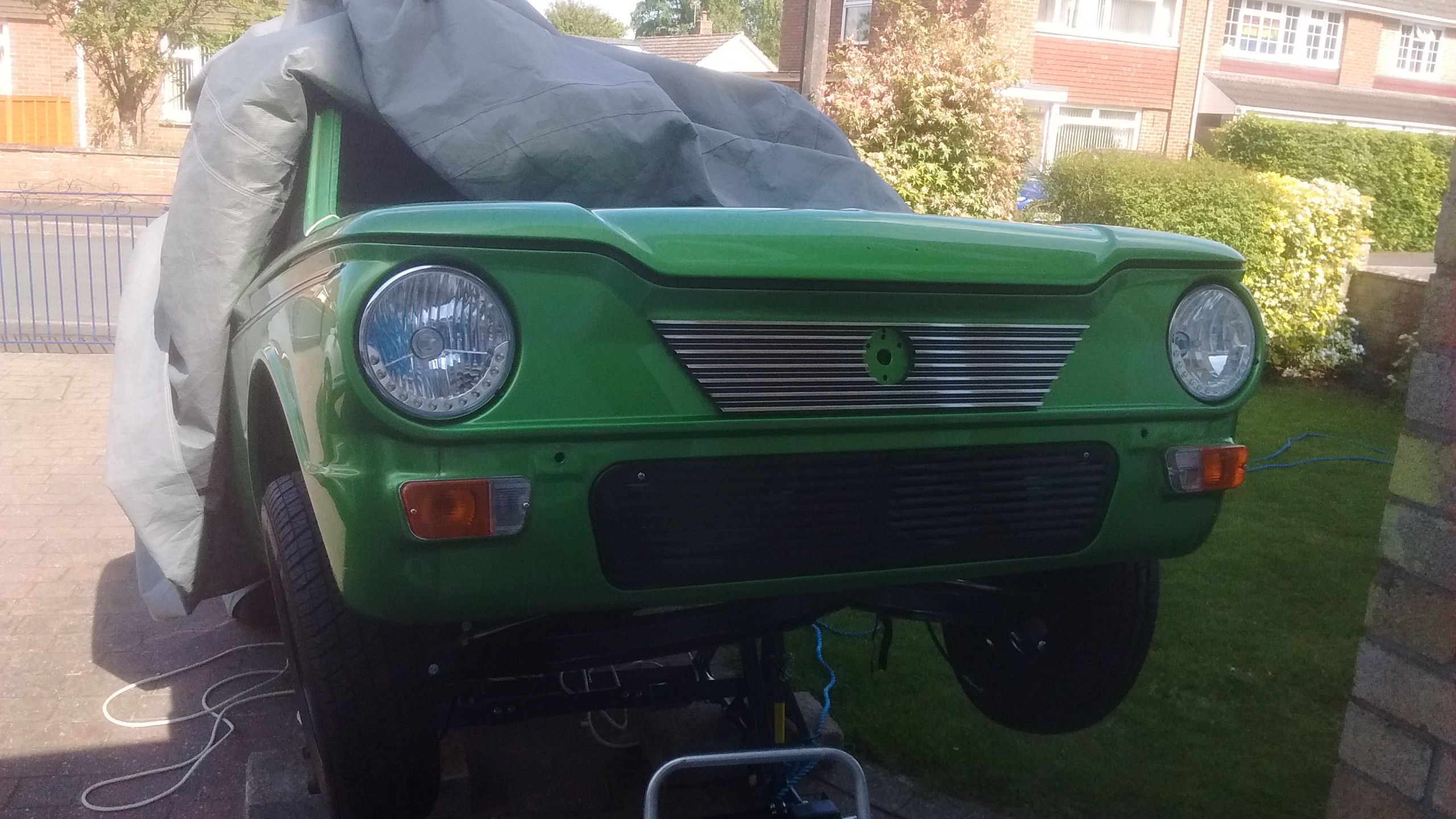

                        Pictured with second quality grill fitted to Pet

                        Yes l know the badge assembly is fitted upside down to normal , looking into how to fit fog lamps now , need to load bumper brackets and see what room is available for fitting something from bumper mount points, also awaiting parts for steering column and wiper motor clamp .
                        Sorting dummy grills to sell on now .
                          #27
                          Lovely piece of work bob, the badge just looks so much better than the standard one.
                          Jim did the same, he only had a grille with hole already in it and no lock, so just put a badge in.
                          Colour looks so much better in the sunshine !

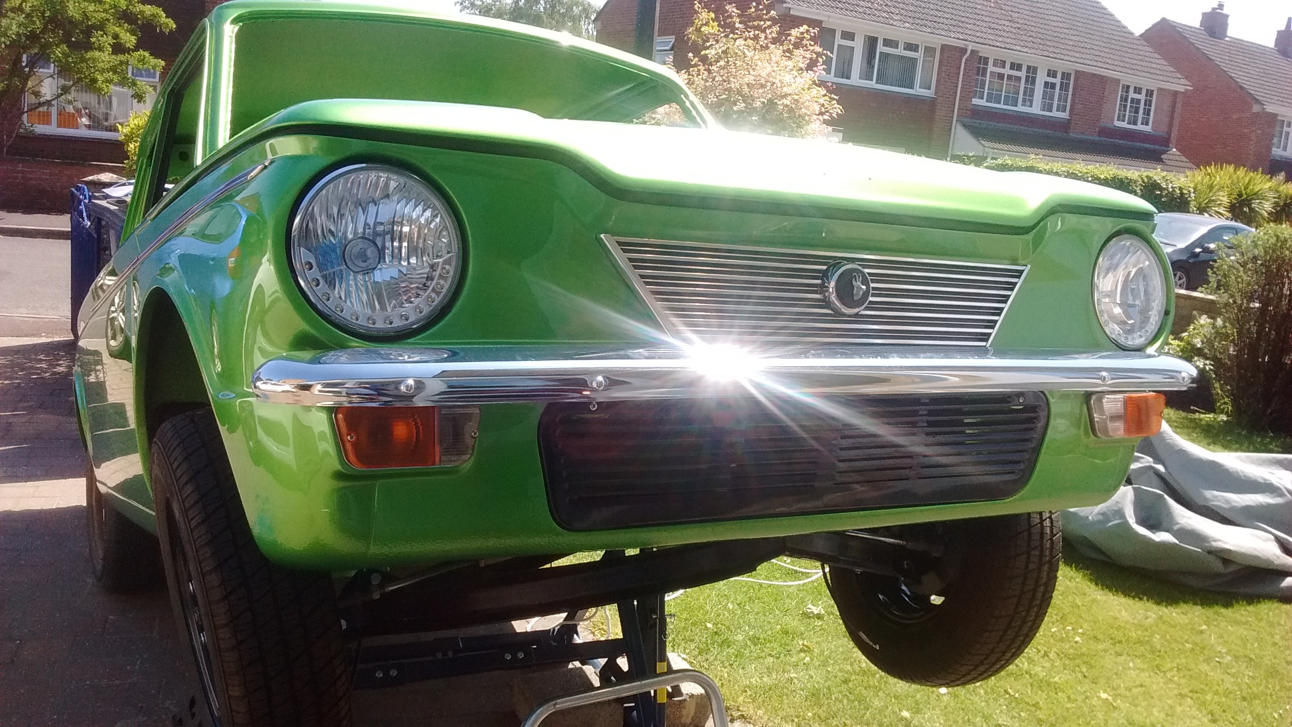

                            Lots of shine and l haven't polished it yet, think l've worked out best place for fog lights ,got to make up a bracket that attaches to bumper mount brackets .

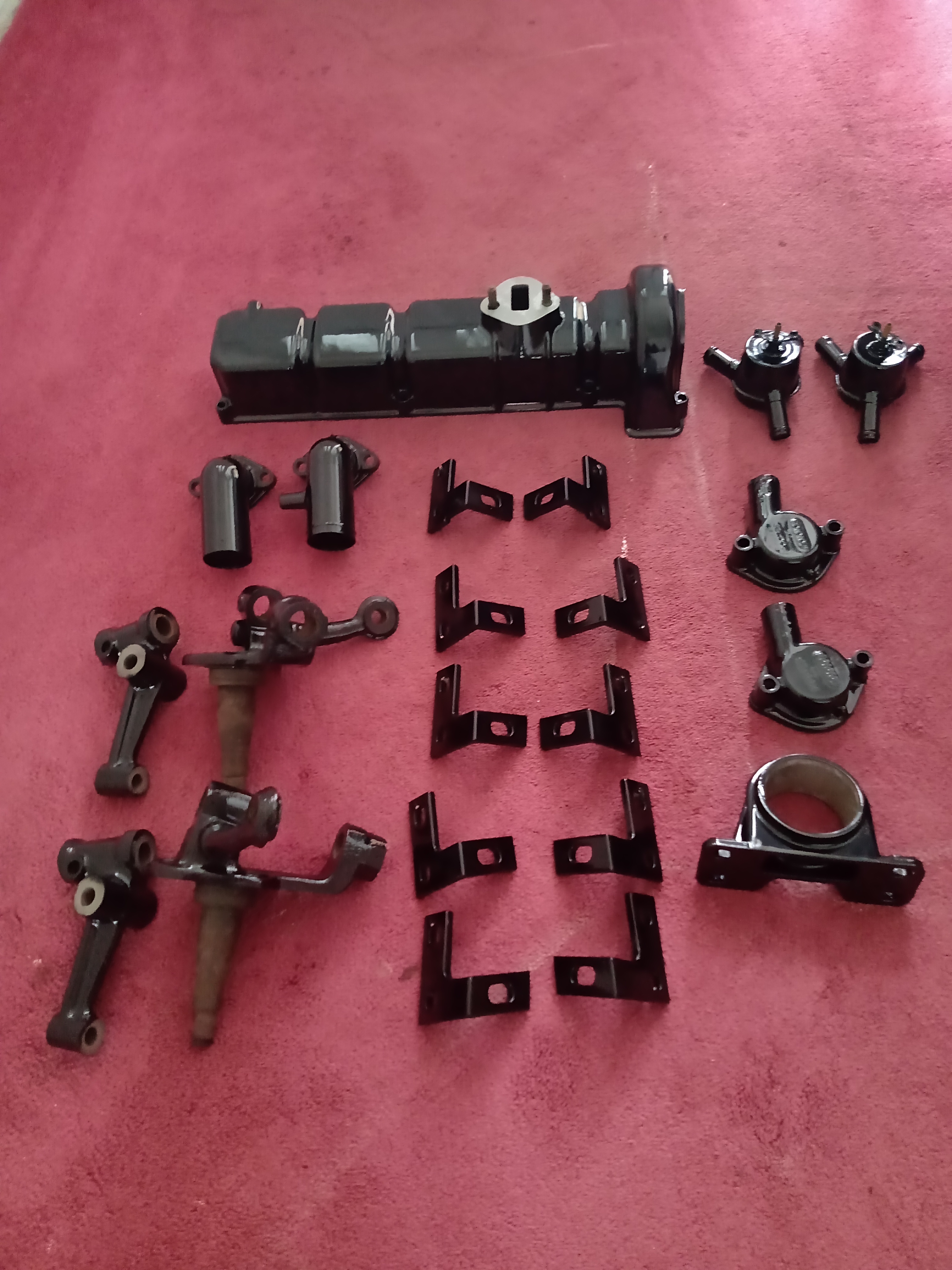

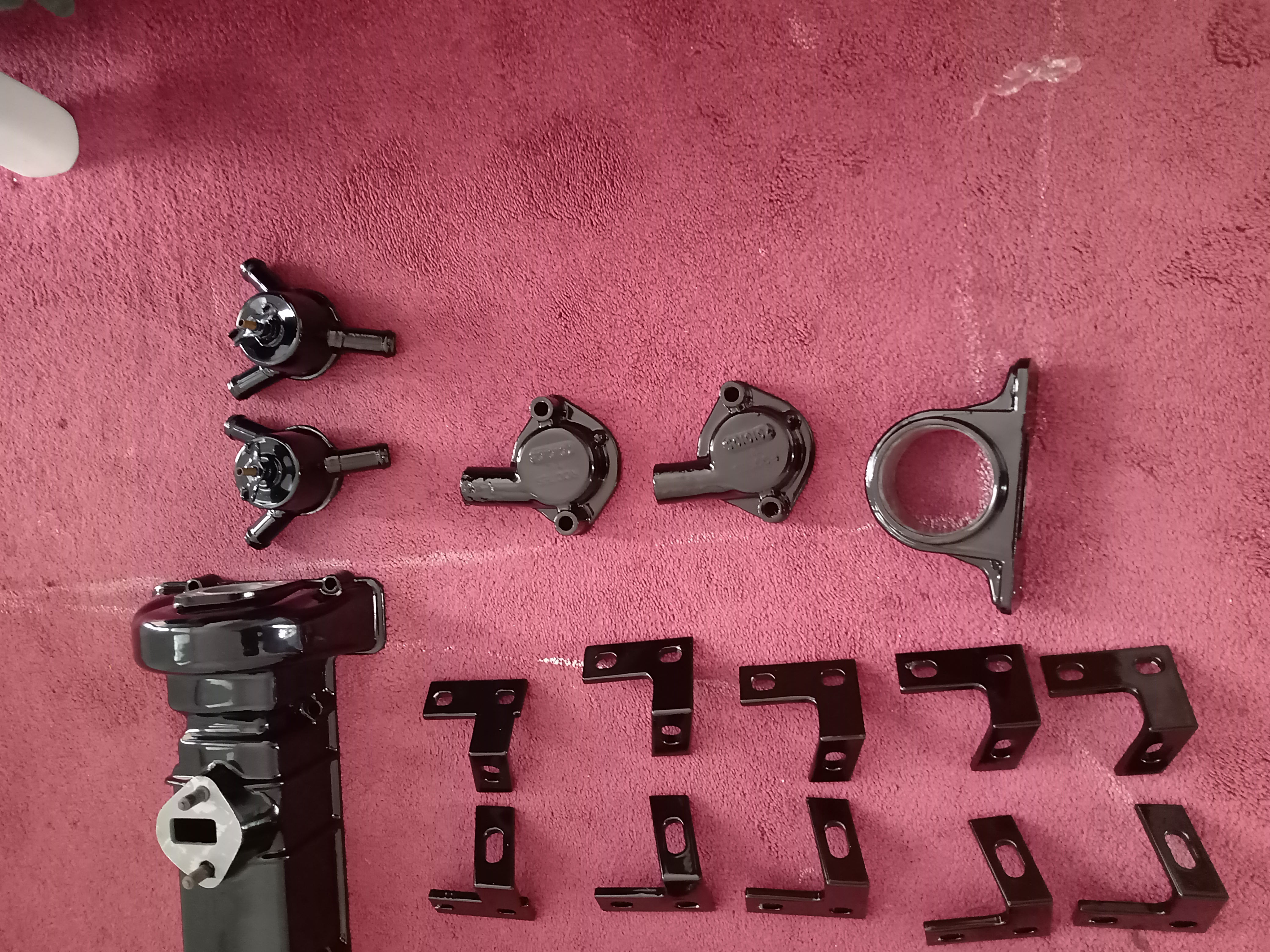

                                More Bling ?
                                Can you have BLACK bling?
                                Rocker box , stub axles , water connectors ,oil filler, thermostat covers, spot light brackets , rear engine mount.

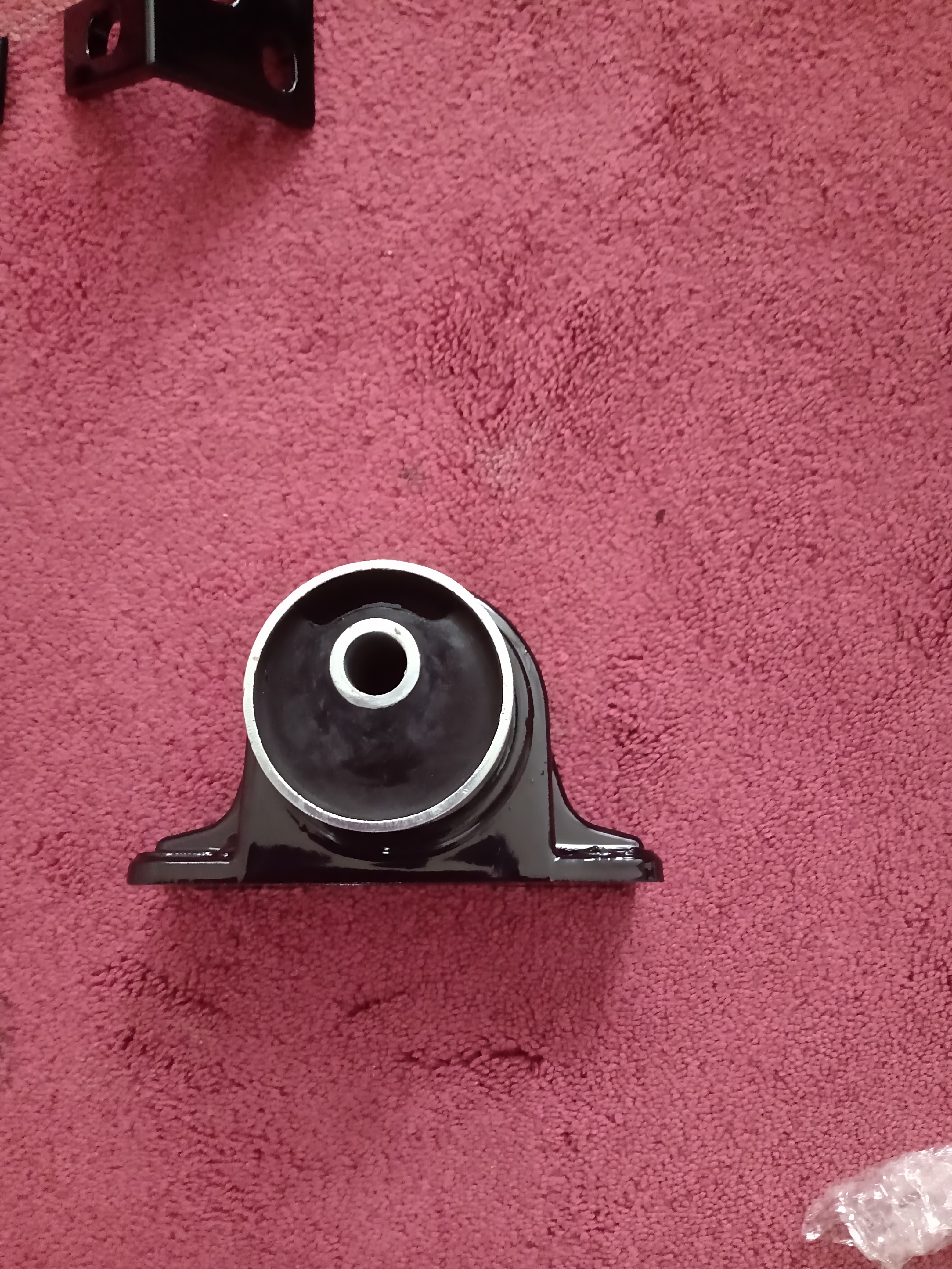

                                Rear engine mount have l put bush in place in the correct position so largest amount of rubber underneath?
                                Not sure whether to modify stub axles or leave until l am sure l'm happy with mods already made and on the car , as these latest ones are spares.

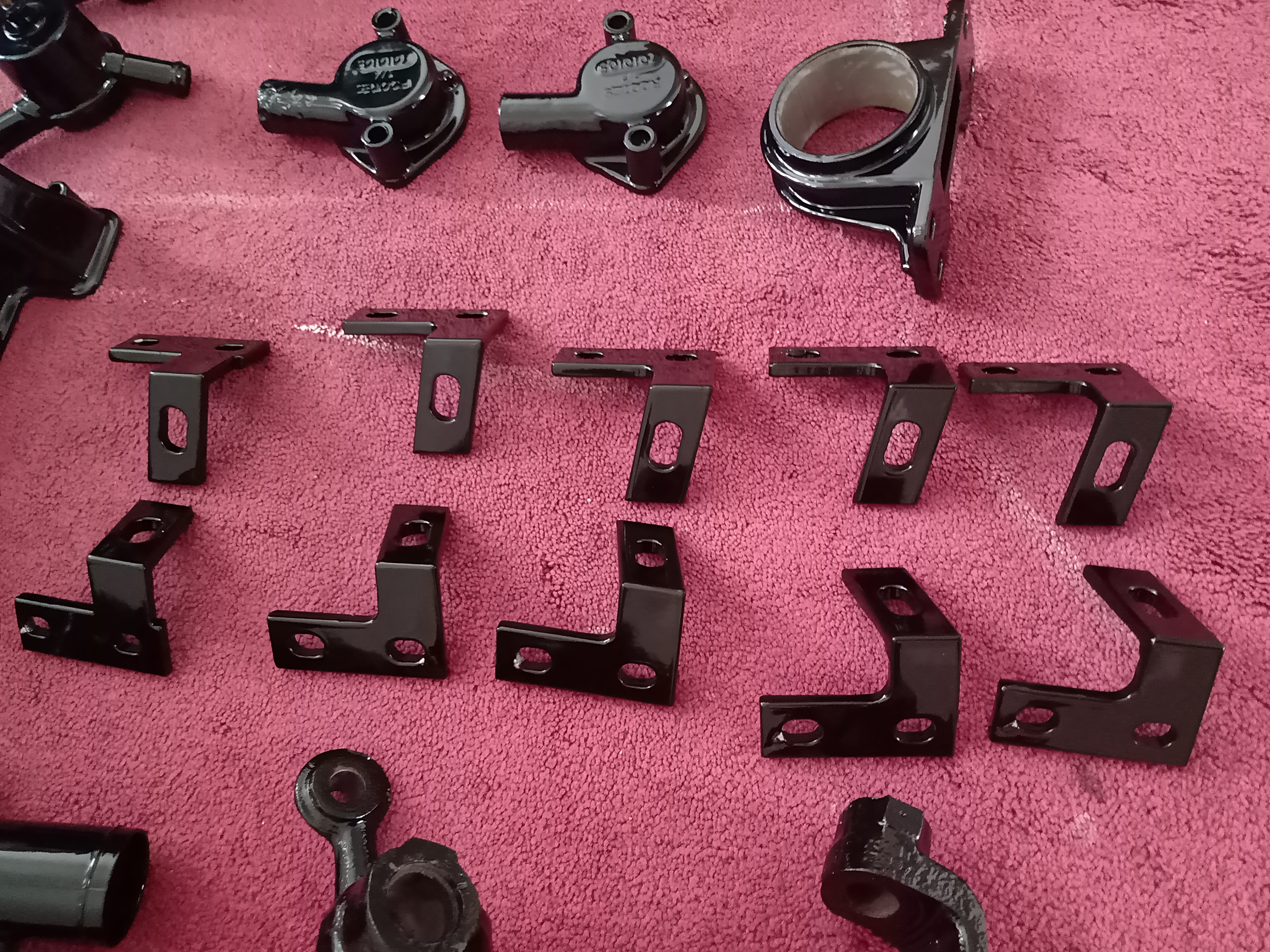

                                Decided to make a batch of spot light brackets as l was happy with them, maybe others would be ?
