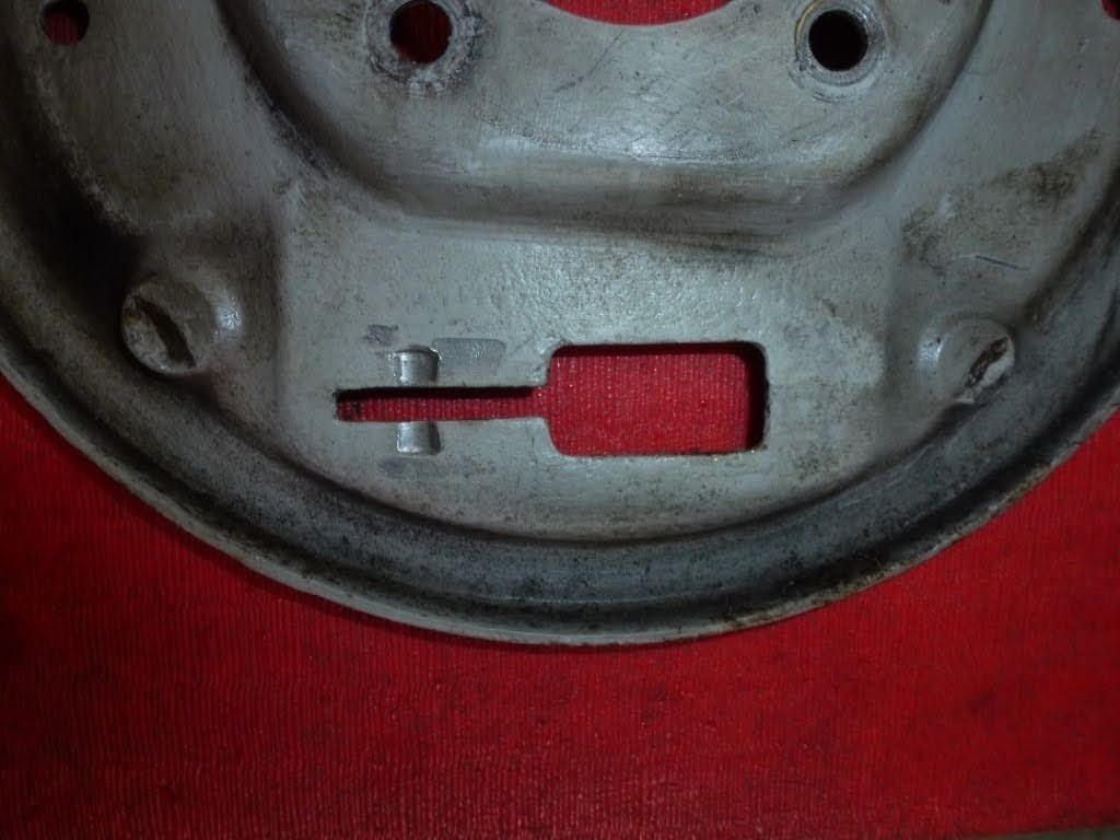

    This back plate has damage where the handbrake mechanism fits this stops the slave cylinder from sliding properly. The damage to the shoe edge support pads either prevents the shoes from contacting drum fully or the edge of the shoe lips over the ridge and lightly contacts the drum heating the shoe material up and causing a glazed high spot that makes that section of the material useless. You can lose 50% of your braking effort with these problems
