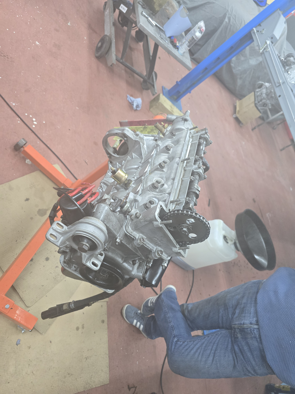

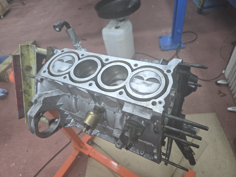

    Still first up was picking the spare 930 with a death rattle that was living in the corner.
    Click image for larger version  Name:	image.png Size:	4.38 MB ID:	25154

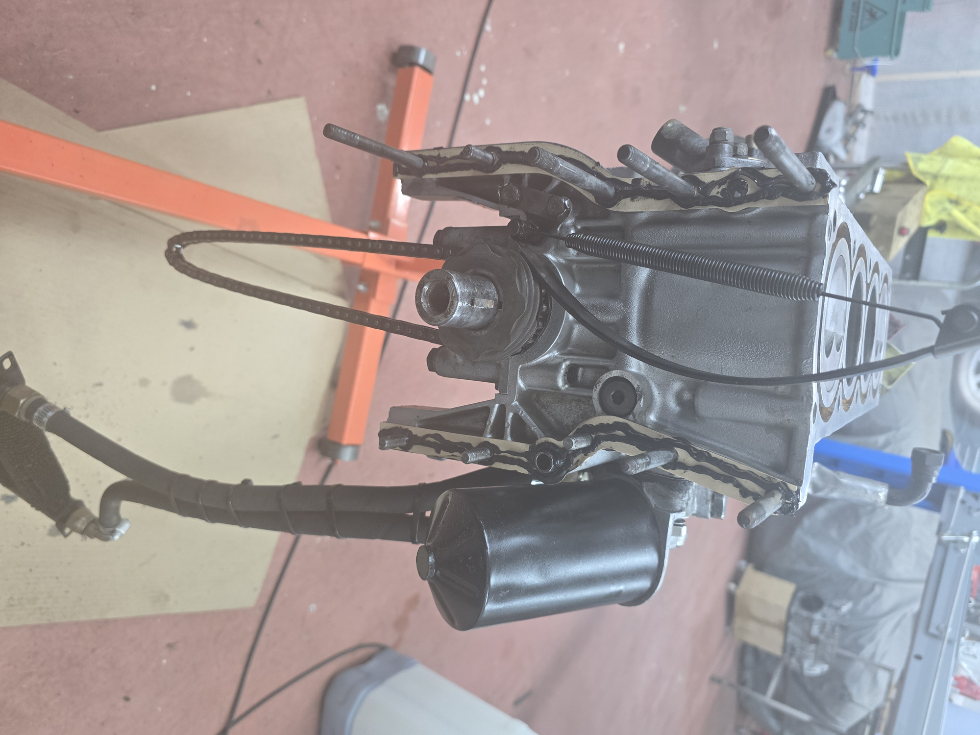

    So tearing it down it did not look too bad. Head was agoner though.

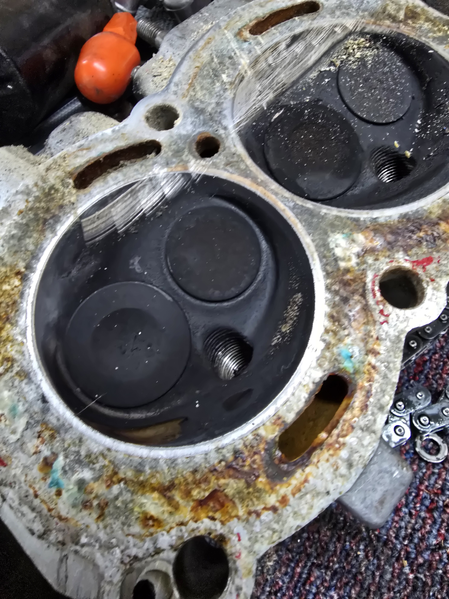

    It also had some running issues which i never got to the bottom of. Checked crudely to see if the valves were leaking, seemd ok static
    Click image for larger version  Name:	image.png Size:	3.67 MB ID:	25155
    A little bit of air and it was a differents tory

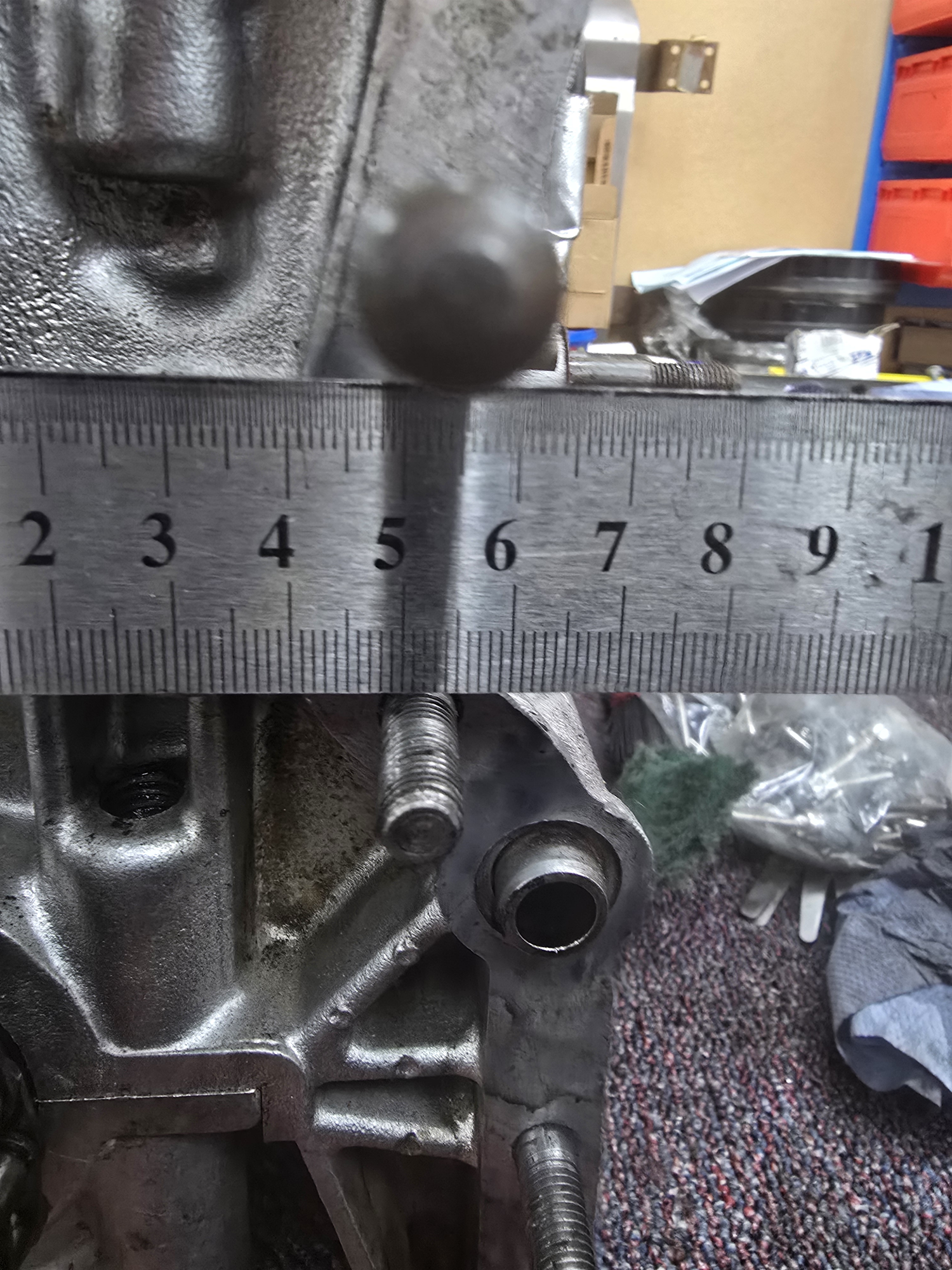

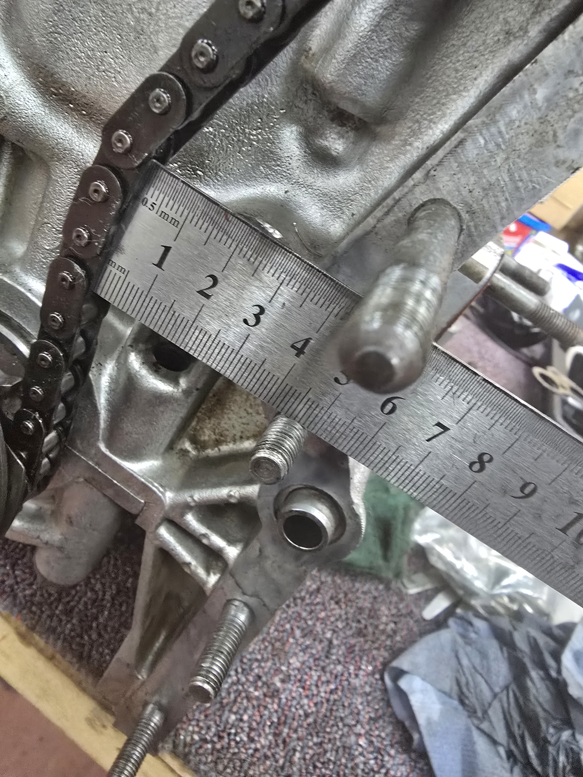

    Timing chain was next up so checked the old chain as it did sound like a chain rattle and a few witness marks.
    Old chain (crude check)
    Click image for larger version  Name:	image.png Size:	3.51 MB ID:	25156
    Just used steel rule to push chain till tight using the stud as a datum.
    Then tried another chain which I assume is good as I had kept it in oil.
    QUite a difference, add the chain issue to the over skim on the head, reckon thats where the rattle was coming from.
    54 to 47mm

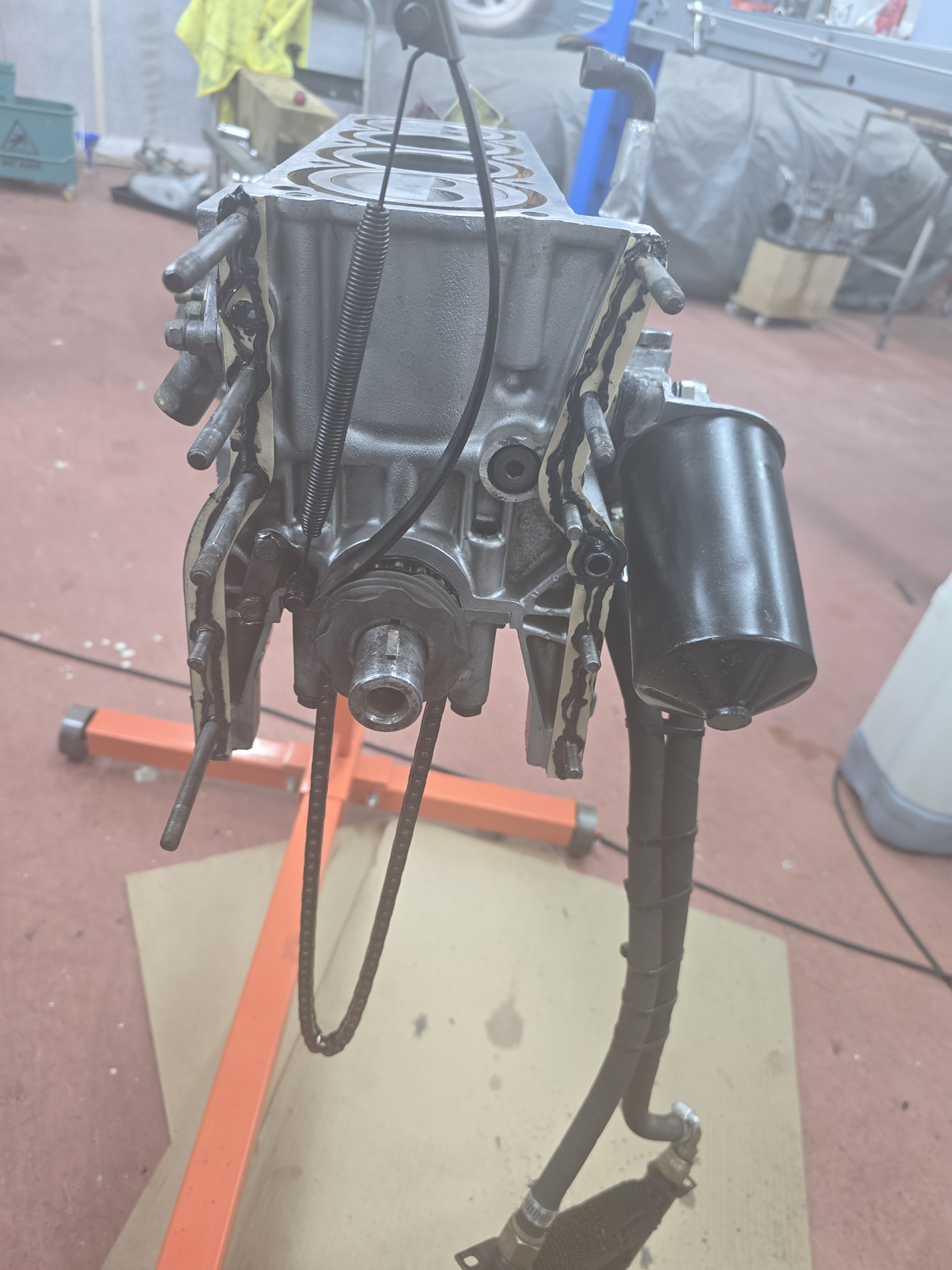

    So time to find a good head, the 180 head was still on Jimmys olde engien so time to pull that off and see

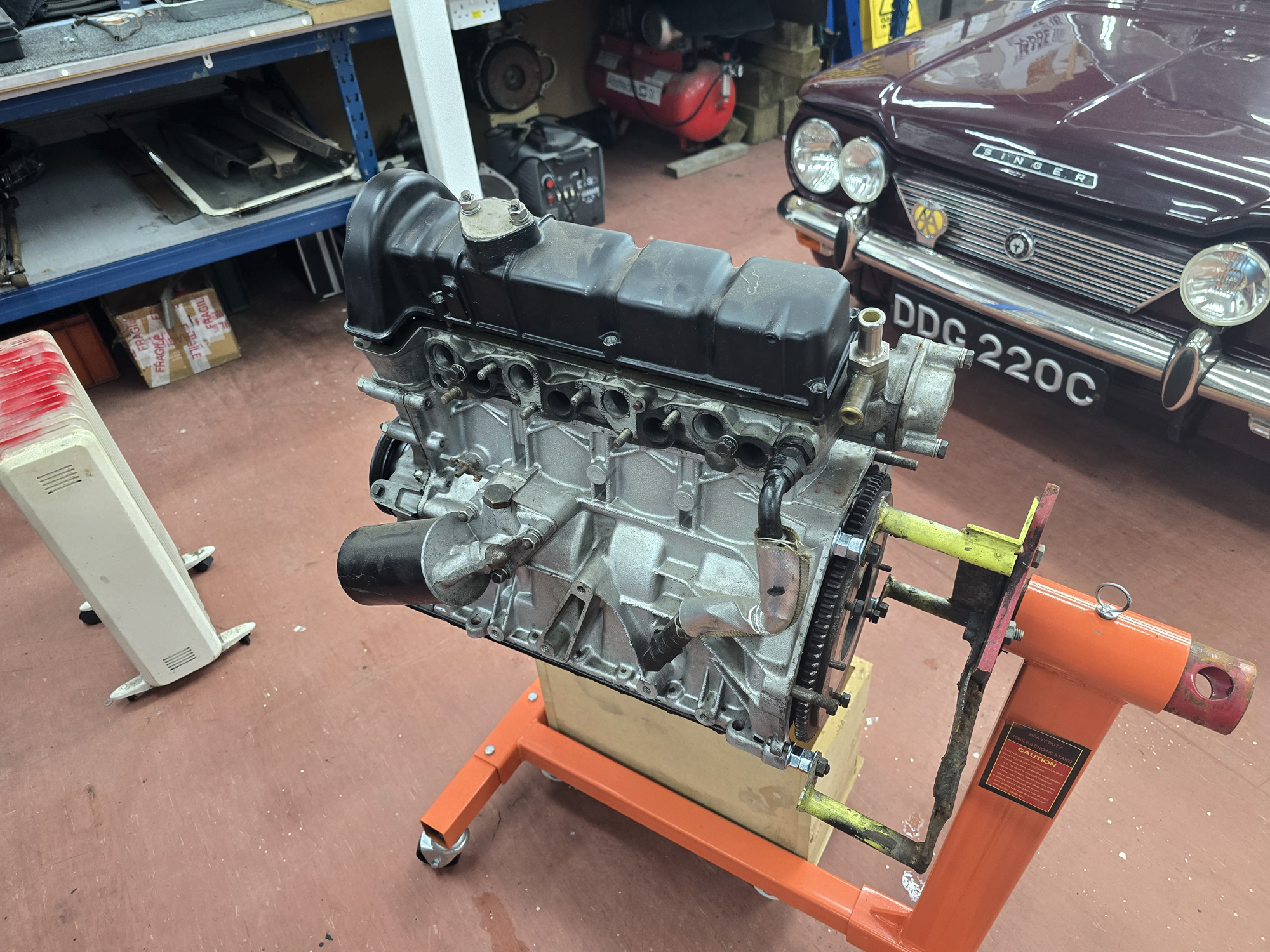

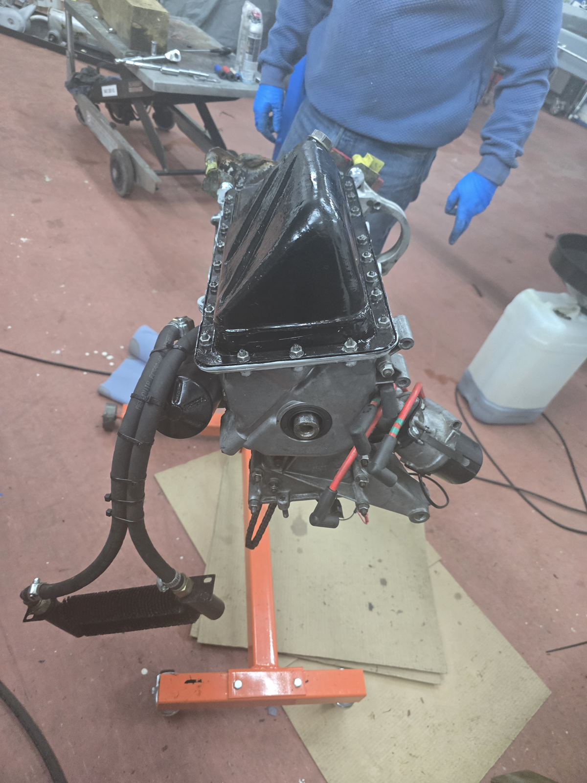

    And the night goes on, not a lot of time for images but the newer head at least seems to let us skip any valve lapping
