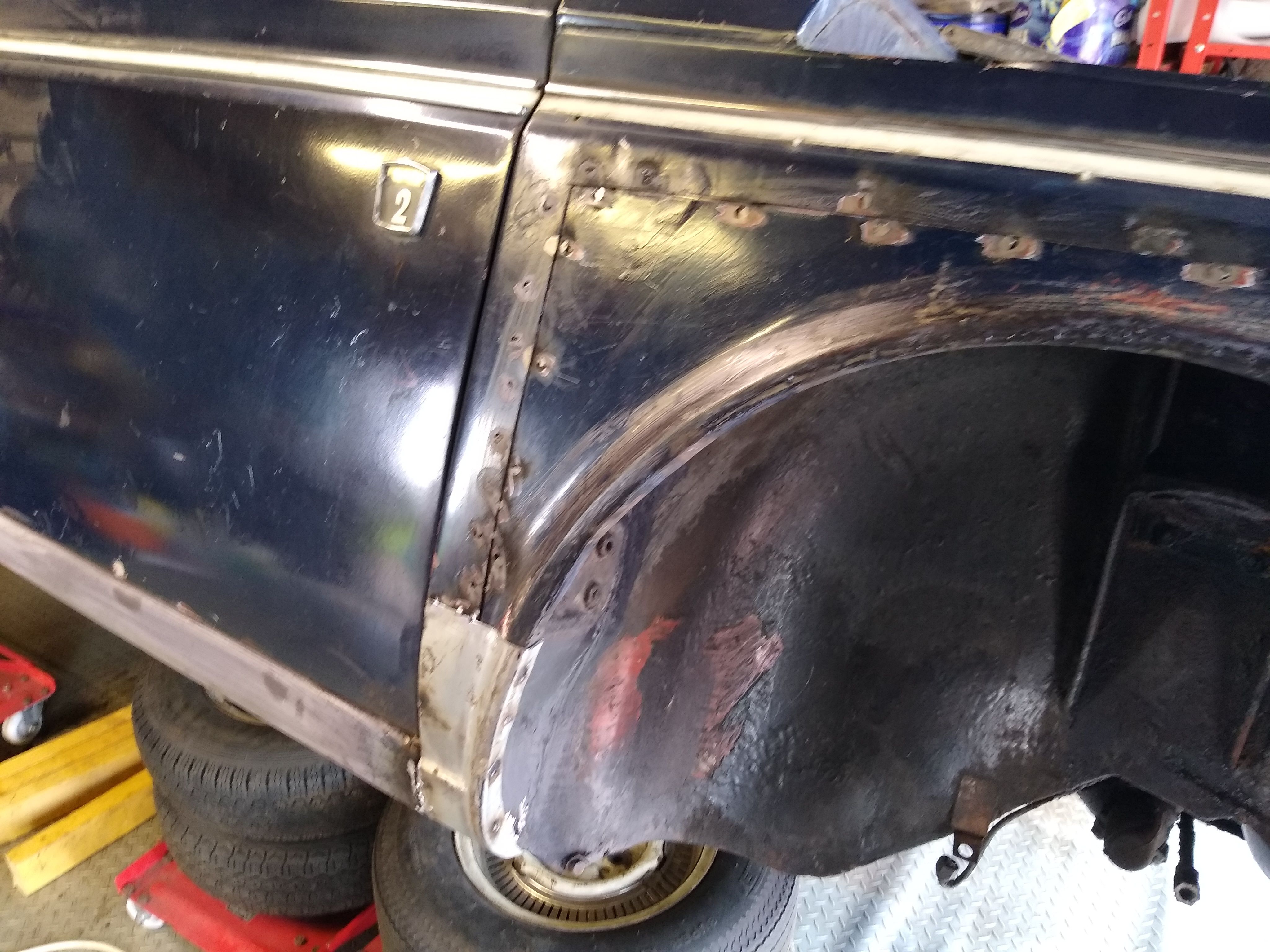

        #18
        Looks like salt has been sprayed in a line by the wheel?

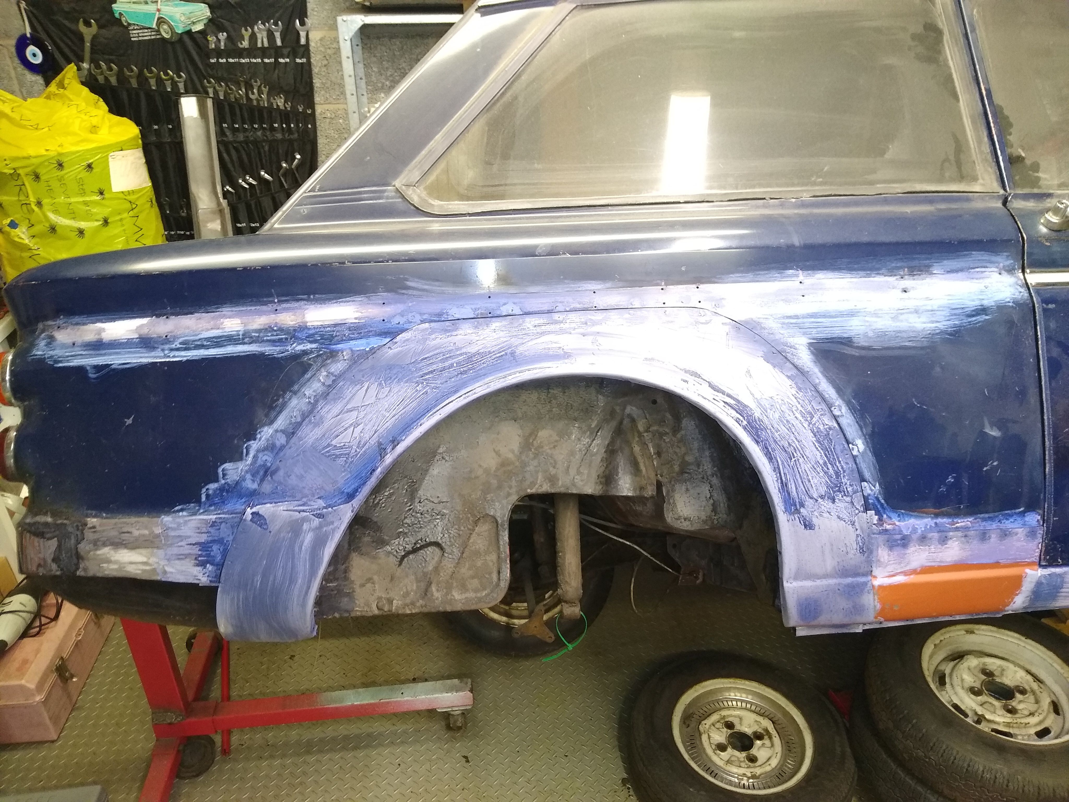

            #20
            Currently working on the front wing. Inner and outer need a bit of tlc!
              • 4881
              #21
              You see what Col Rooney does to save all the forming of the inner arch ?? Lot easier to attach and even easier to seal up after
              SEE POST HERE
              • lm57krm@gmail.com
                • 7 April 2020
                • 116
                #22
                Ah, I see doing it in sections as well. I will try that as I'm having difficulty getting it all lined up.
                  • 4881
                  #23
                  Keith, I have even started with a full panel which needed "fettling" and gave up on the red basket and ended up chopping it myself.
                  Unfortunately I do not have the ninja skills to get it in in one go.

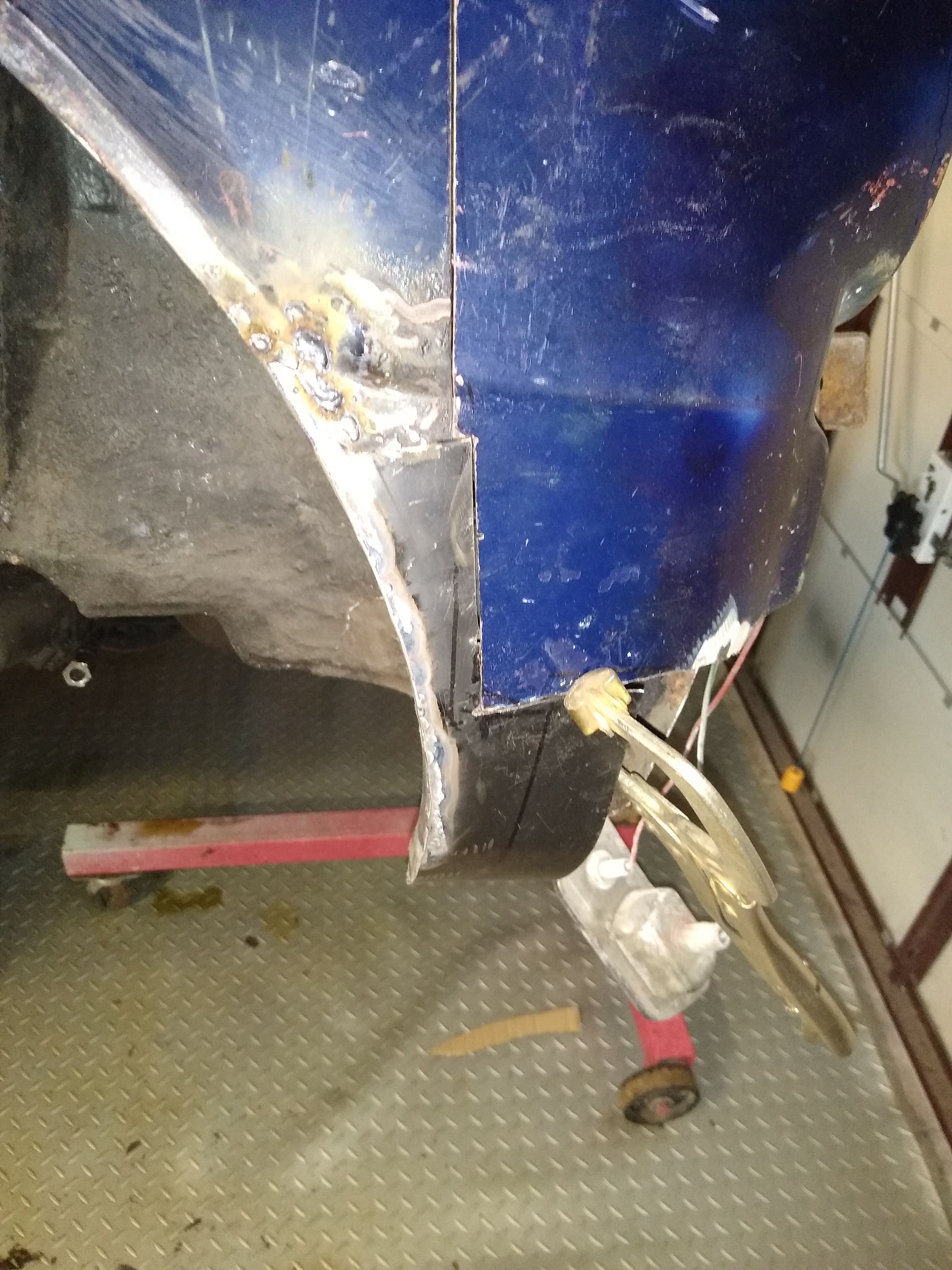

ID:	7322 Today's efforts. Stuck my wing back on with new lip I made and repair panel put on. Some filler might be smeared over this lot. ?
                      • 4881
                      #25
                      Keith, its in and its welded so sorted, inner arch looks OK at bottom to floor at least, always had to repair that lot.
                      Nice work Keith, wont be long, pin hammer and filler will sort the rest !
                        #26
                        Nice job, coming along nicely sir.
                          #27
                          Looking good Keith and coming along nicely one corner and arch at a time .

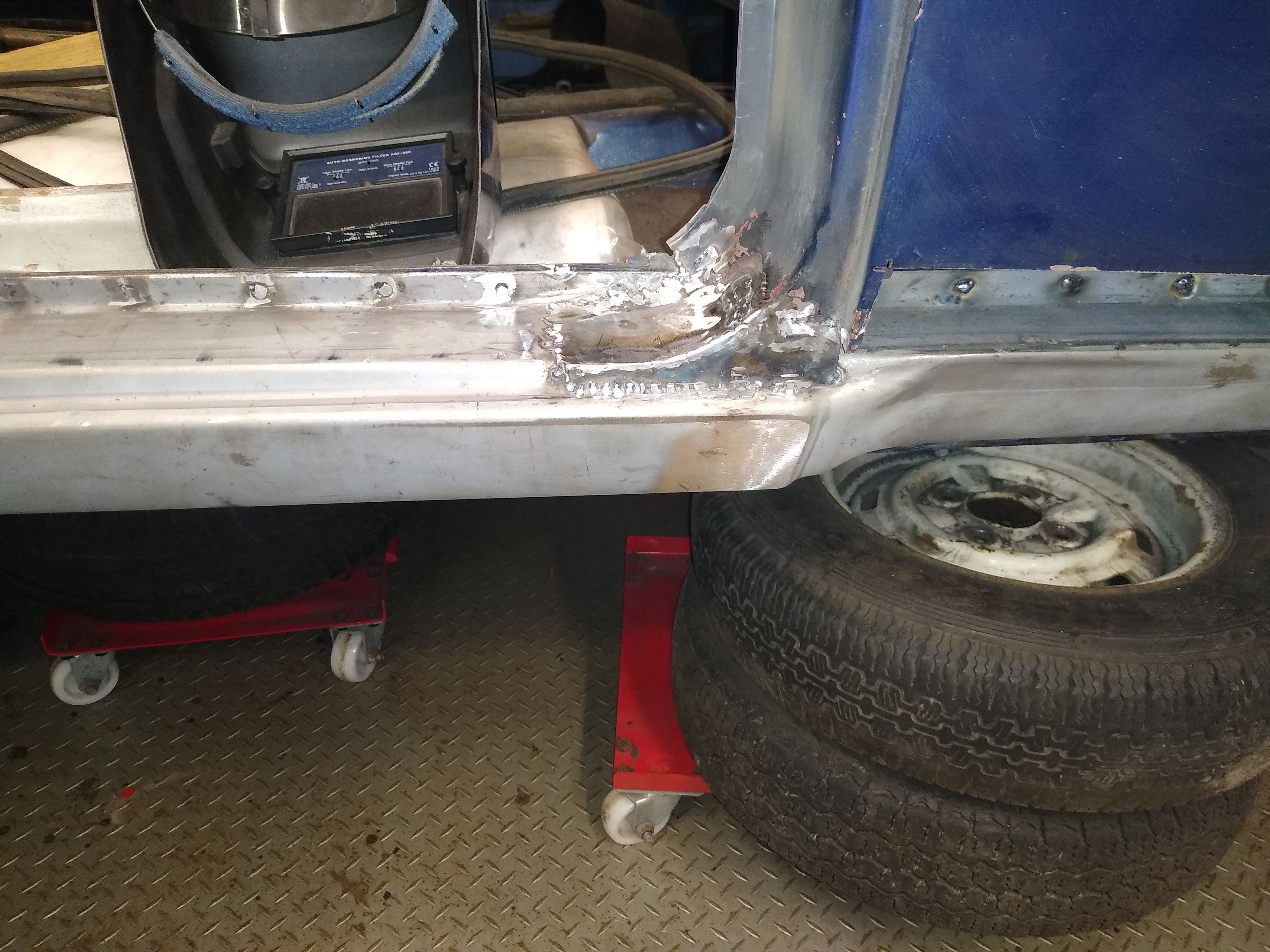

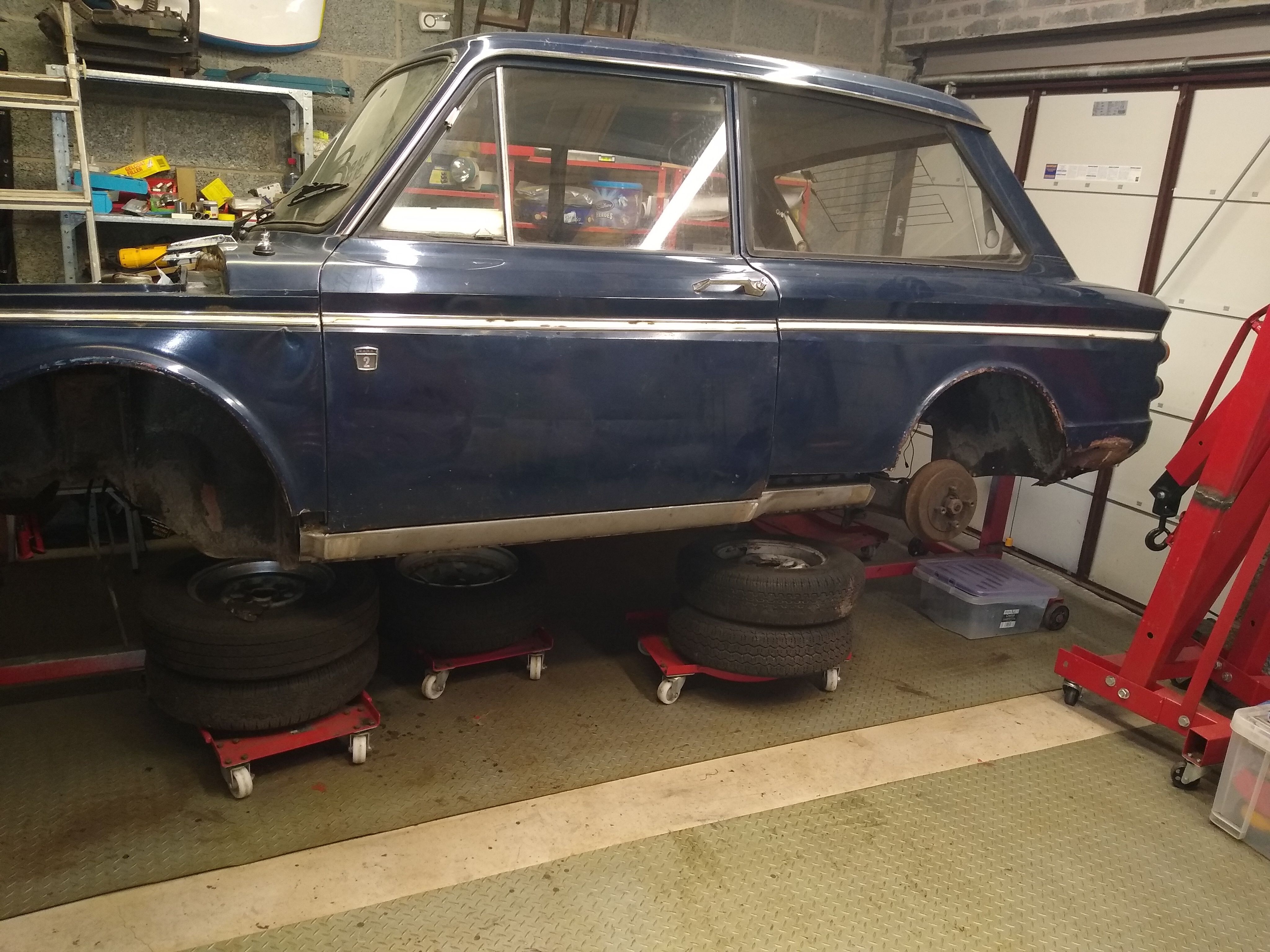

                            So doing the passenger sill now. It's good progress.

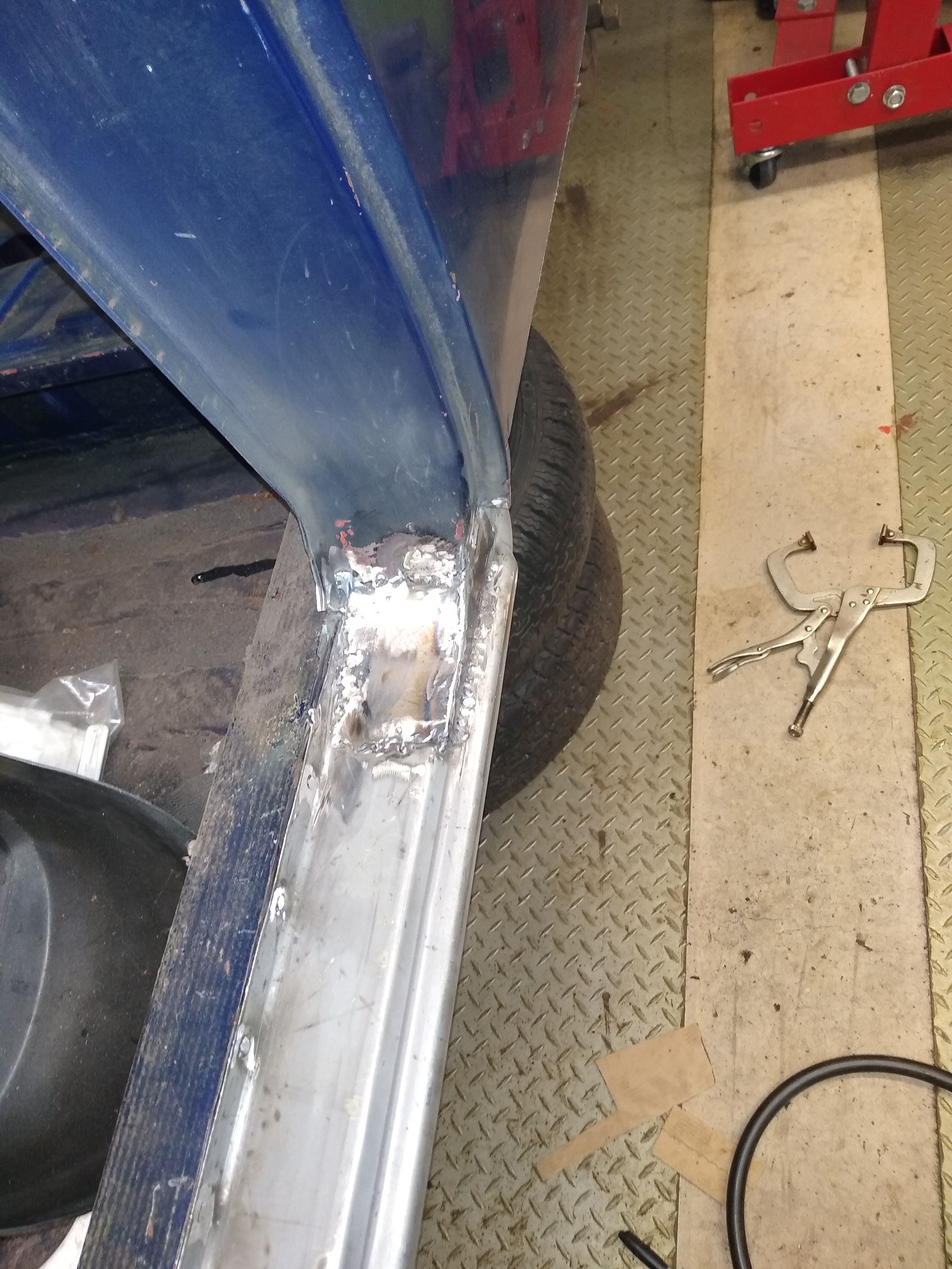

                              #29
                                • 4881
                                #30
                                Good progress indeed keith, the sill is a big chunk of panel and "springy" can be a right pain to position before sparking in, especially working on your own.
                                That B pillar section wont be coming back off again anytime soon, your making me feel guilty now as I only ever replace the spot welds plus a few !
