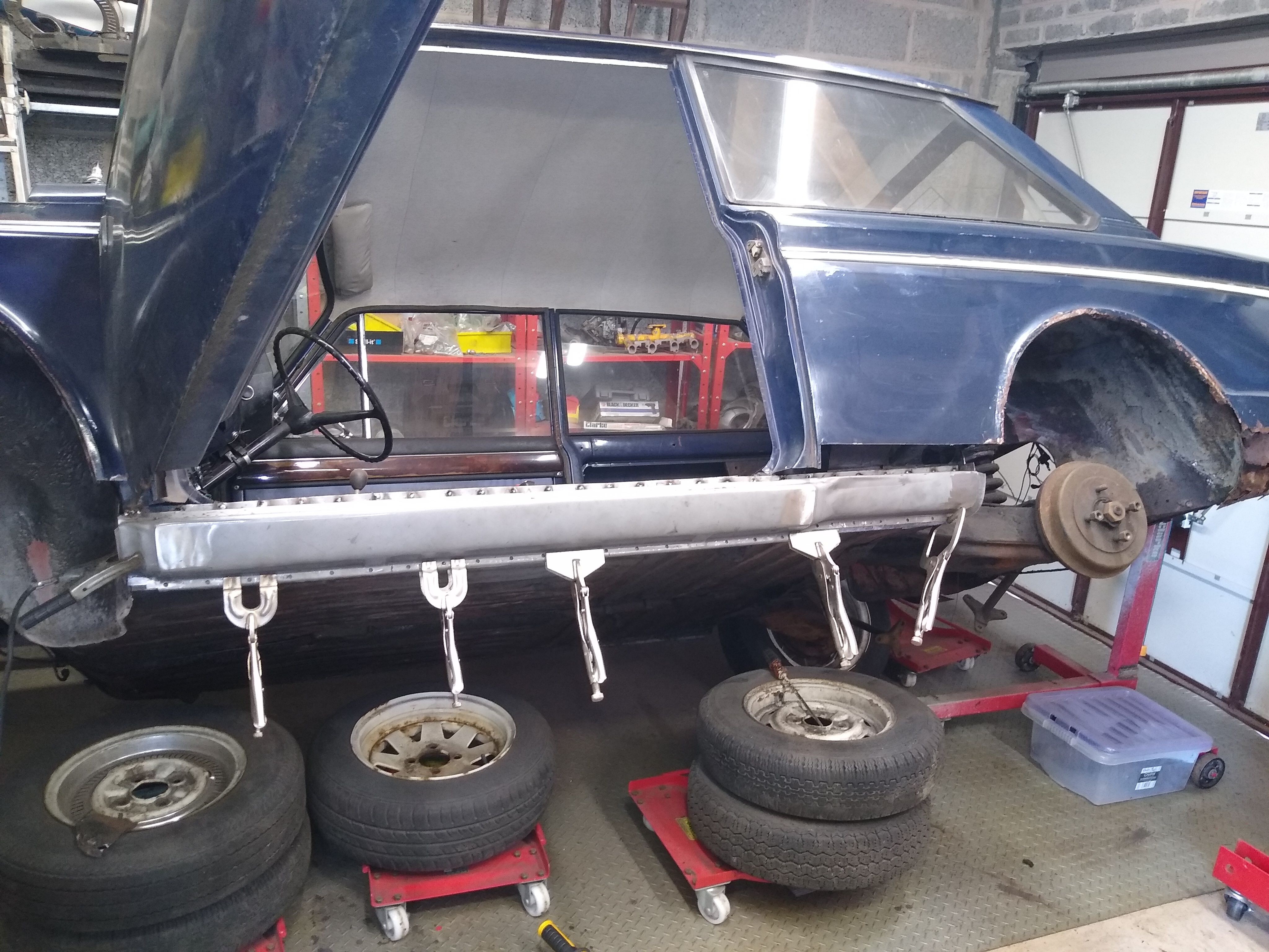

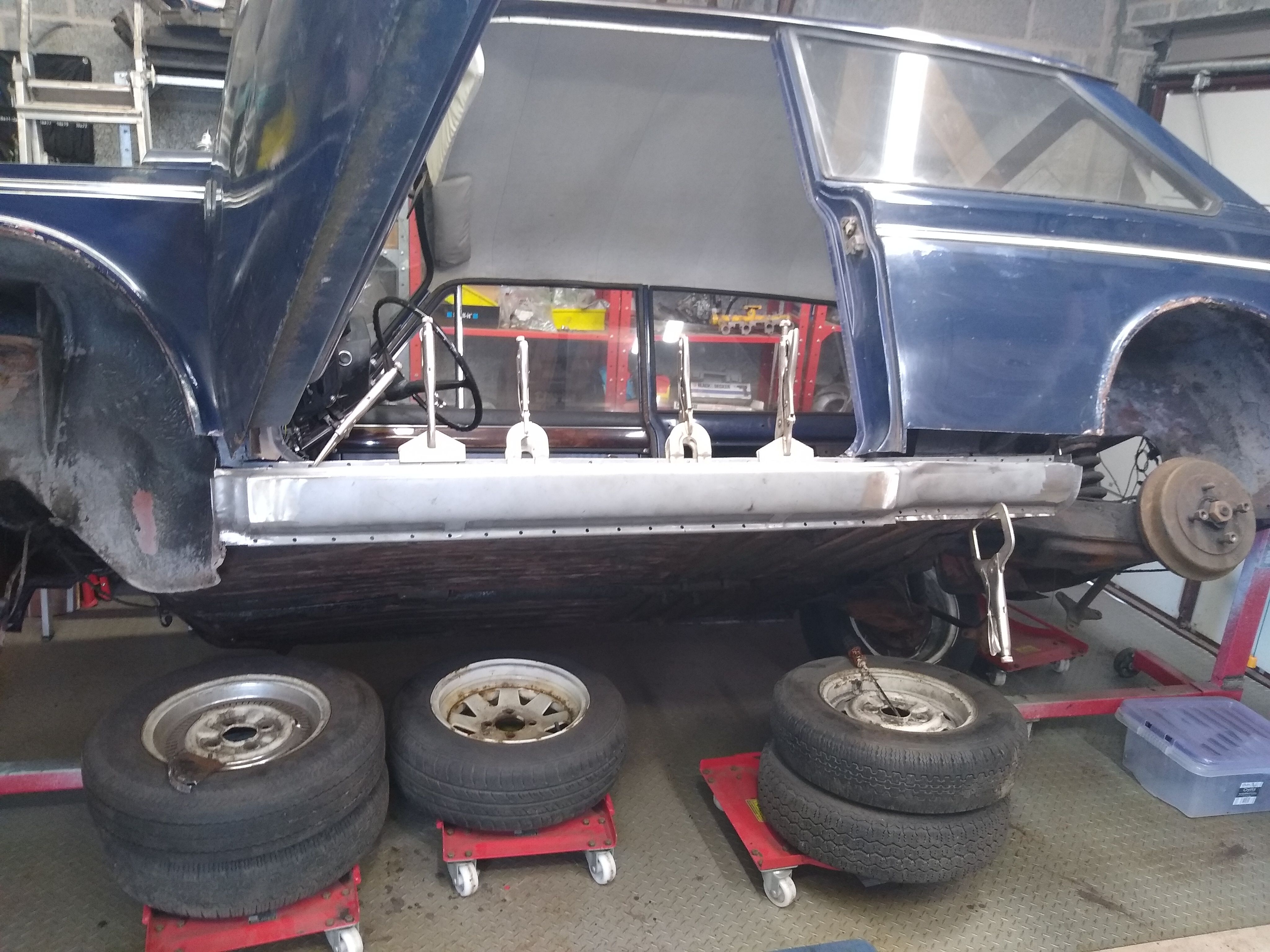

    Yes John, I made use of all my helping hands! Click image for larger version
      • 4881
      #32
      looks familiar Keith I ran out of helping hands had to put sonme self tap screws in themn move the hands along its in though, I take it the floor or inners needed very little work ?

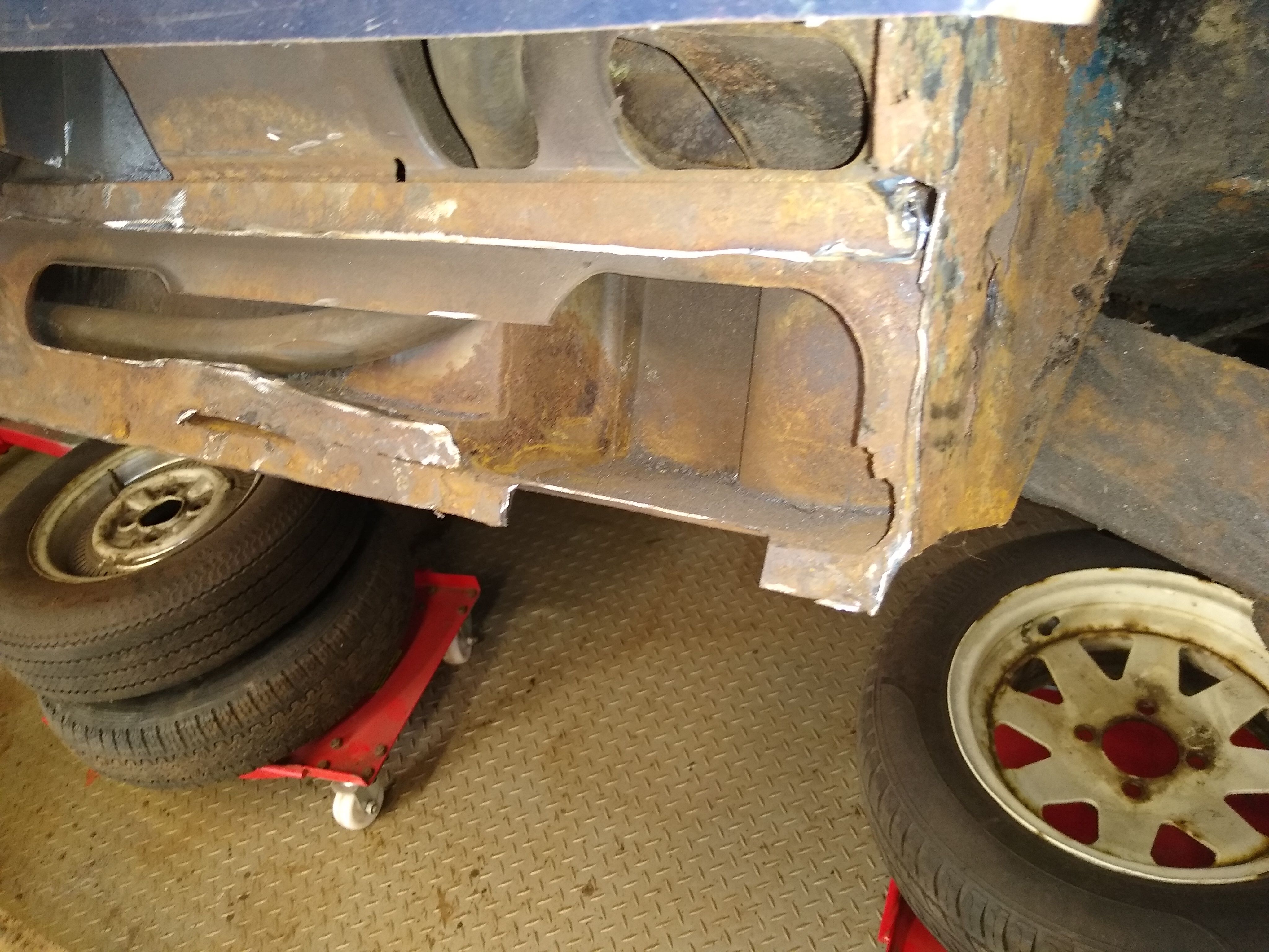

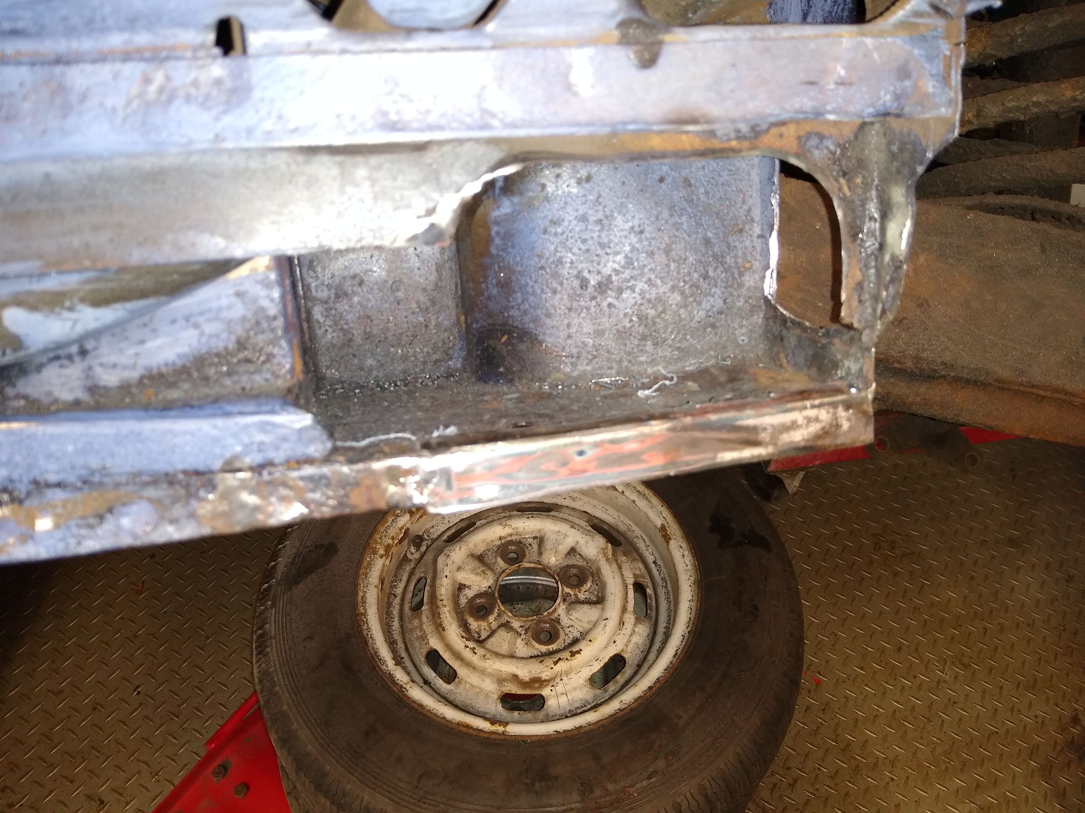

        #33
        Yes the floors are sound apart from a tiny repair at the back in the usual place similarly the inner baffle just needed a small fix at front and back (again in the usual places).

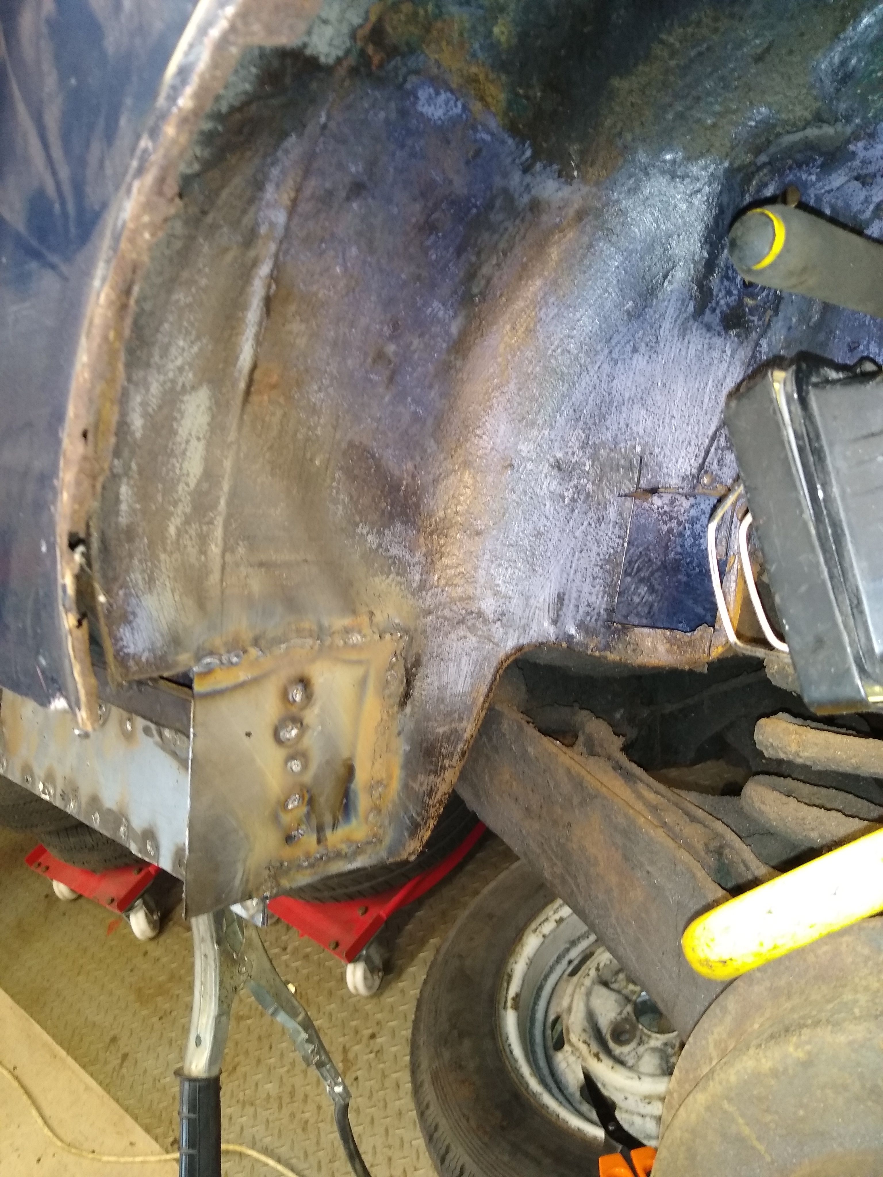

          #34
          Here are a few views. Also includes the repair at the back.
            • 4881
            #35
            Wow, was expecting a lot worse after seeing the state of the top of that rear wheel tub. Better than most I have seen !

              #36
              Ah that's the other side John, this site not nearly as bad as driver's side.

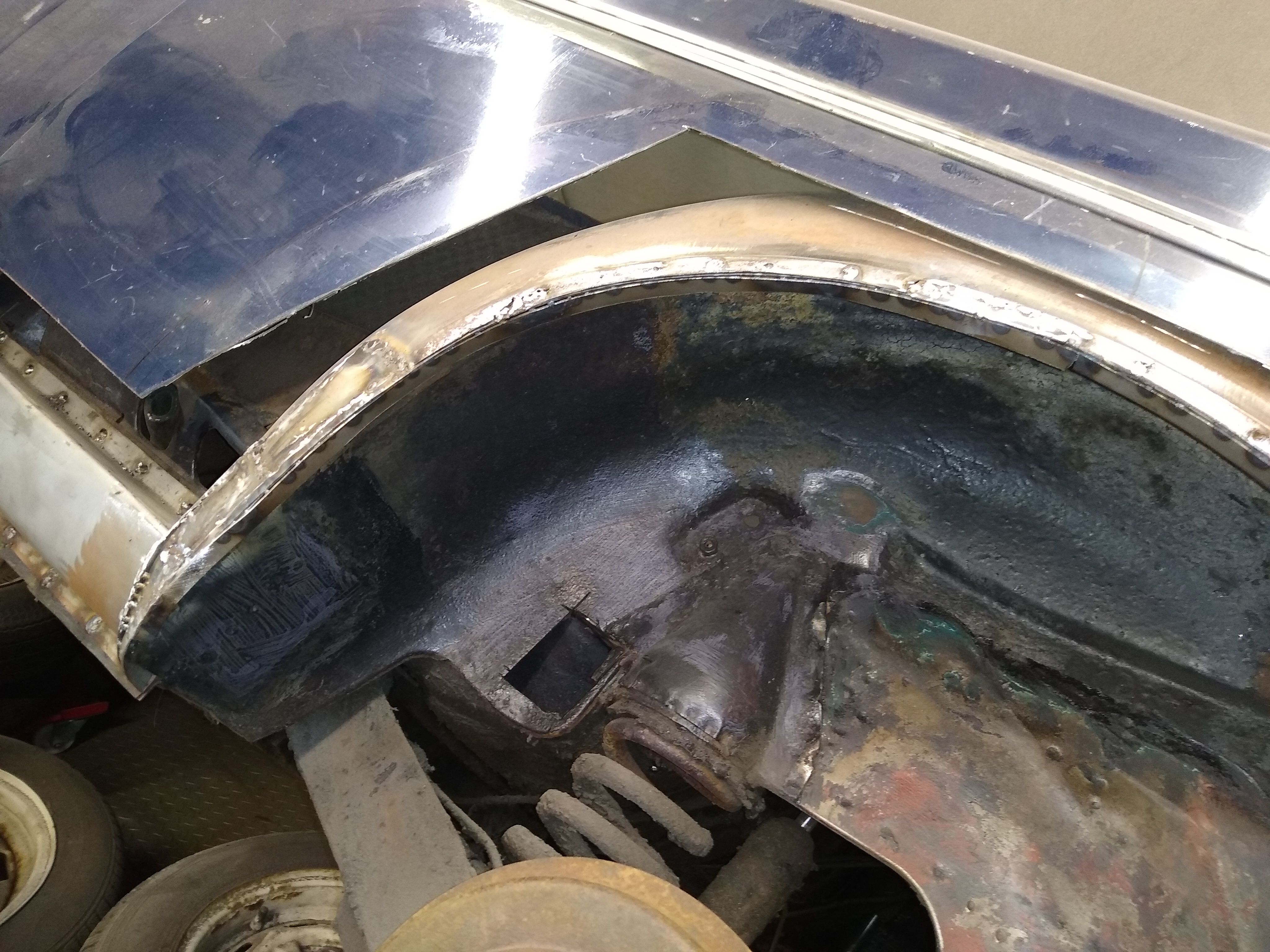

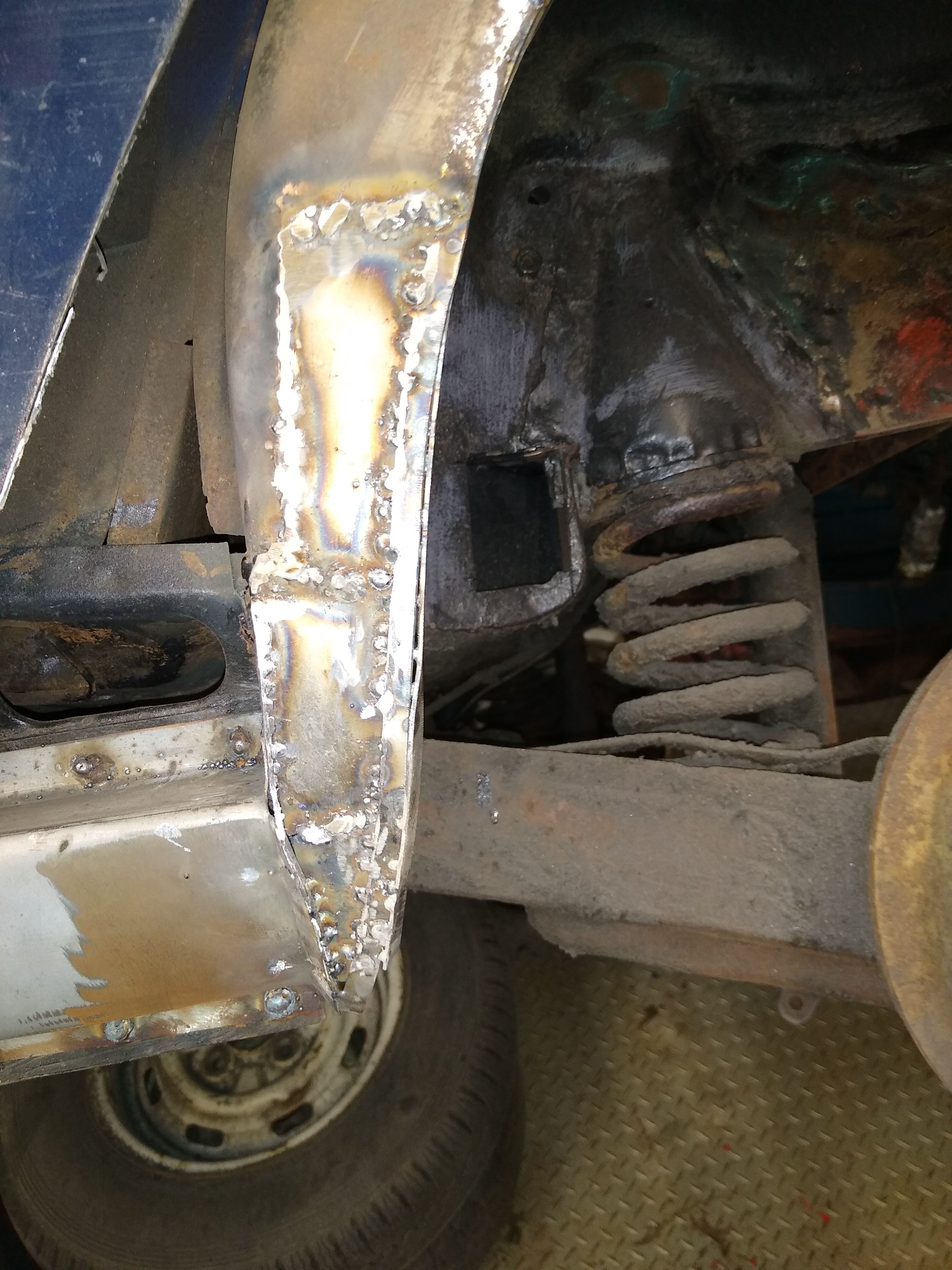

                So, now working on the wheelhouse. It's not pretty but hopefully functional!Click image for larger version
ID:	8190Click image for larger version
                  • 4881
                  #38
                  Looks tidy to me Keith, I have tried all manner of ways to try and form that lip and failed, heats, shrink, stretch..... started off from folded section and started to form but it was beyond me.
                  So i do sections as well, ugly but does the deed, seam sealer is wonderful stuff
