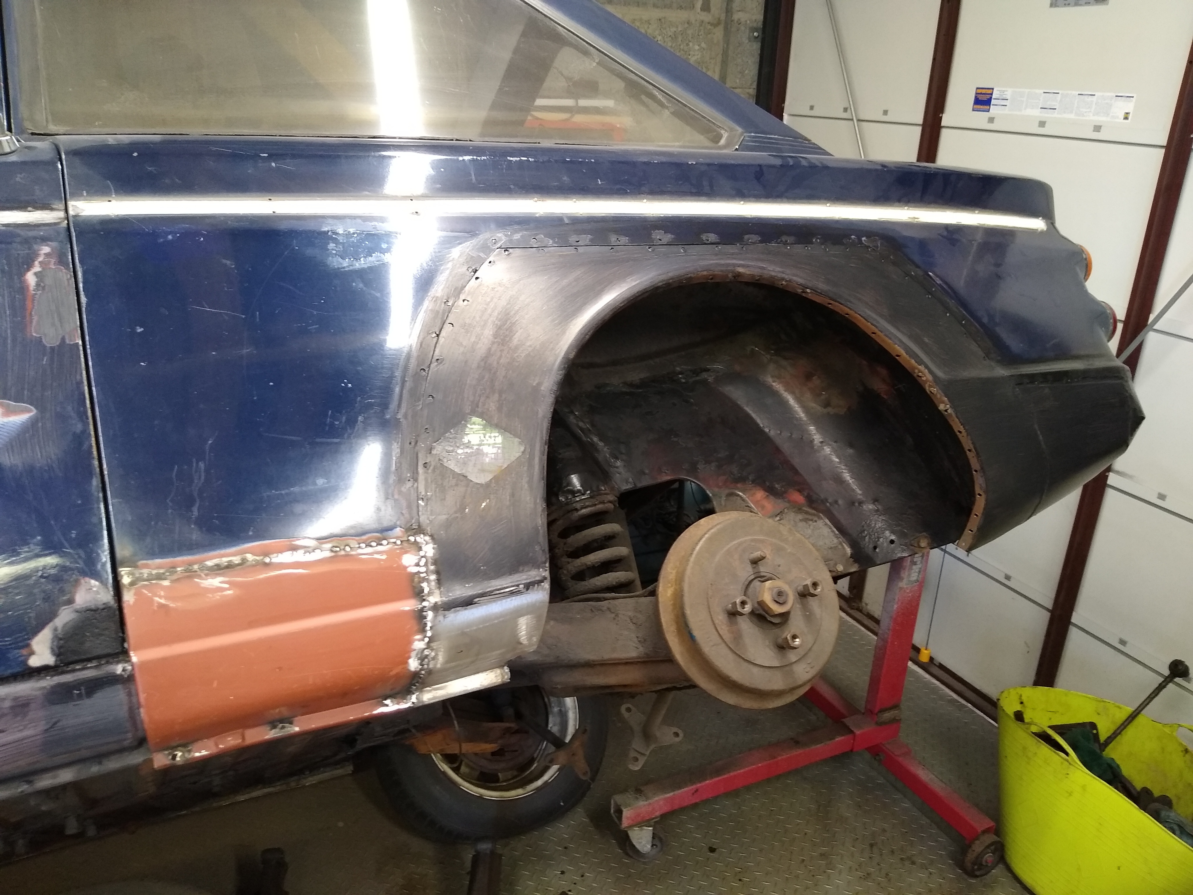

          #64
ID:	8841 getting on with the passenger rear quarter now.made the corner myself. It's close enough.

            #65
            Rear quarter. WIP

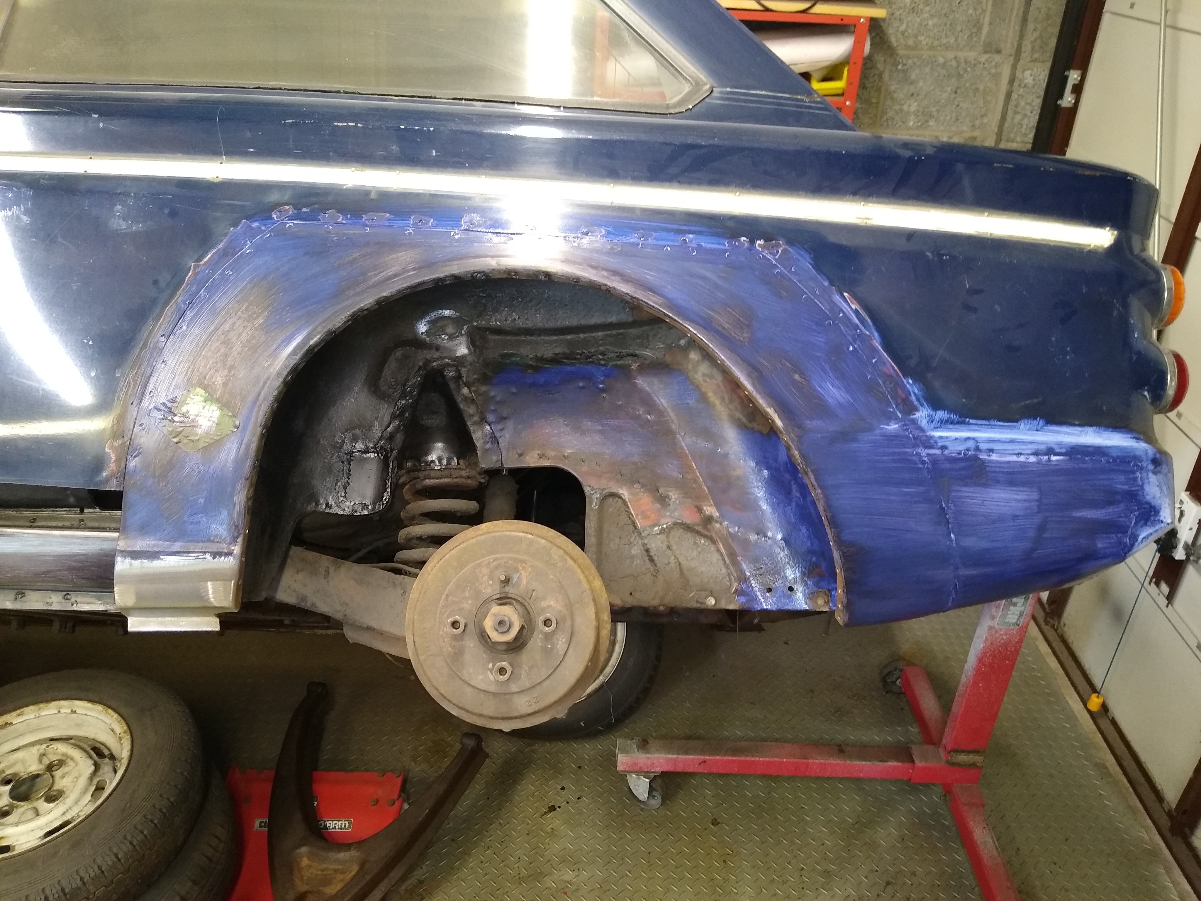

              #66
              Got the Radford panel to fit. Click image for larger version

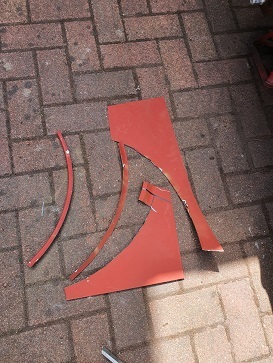

                #67
                The "red devils" are a challenge sometimes Keith, as i said in my other post, this is best use I found for them, chop up and use bits
                Click image for larger version  Name:	20200608_135748.jpg Views:	0 Size:	52.6 KB ID:	8887
                I amanaged to get onto the filling earlier keith, will post pictures later but wish I had just changed whole arch now as trying to match the profile of a fctory panel onto the repleacement bits is proving to be a bit of a chore.
                I hate the white stuff.....

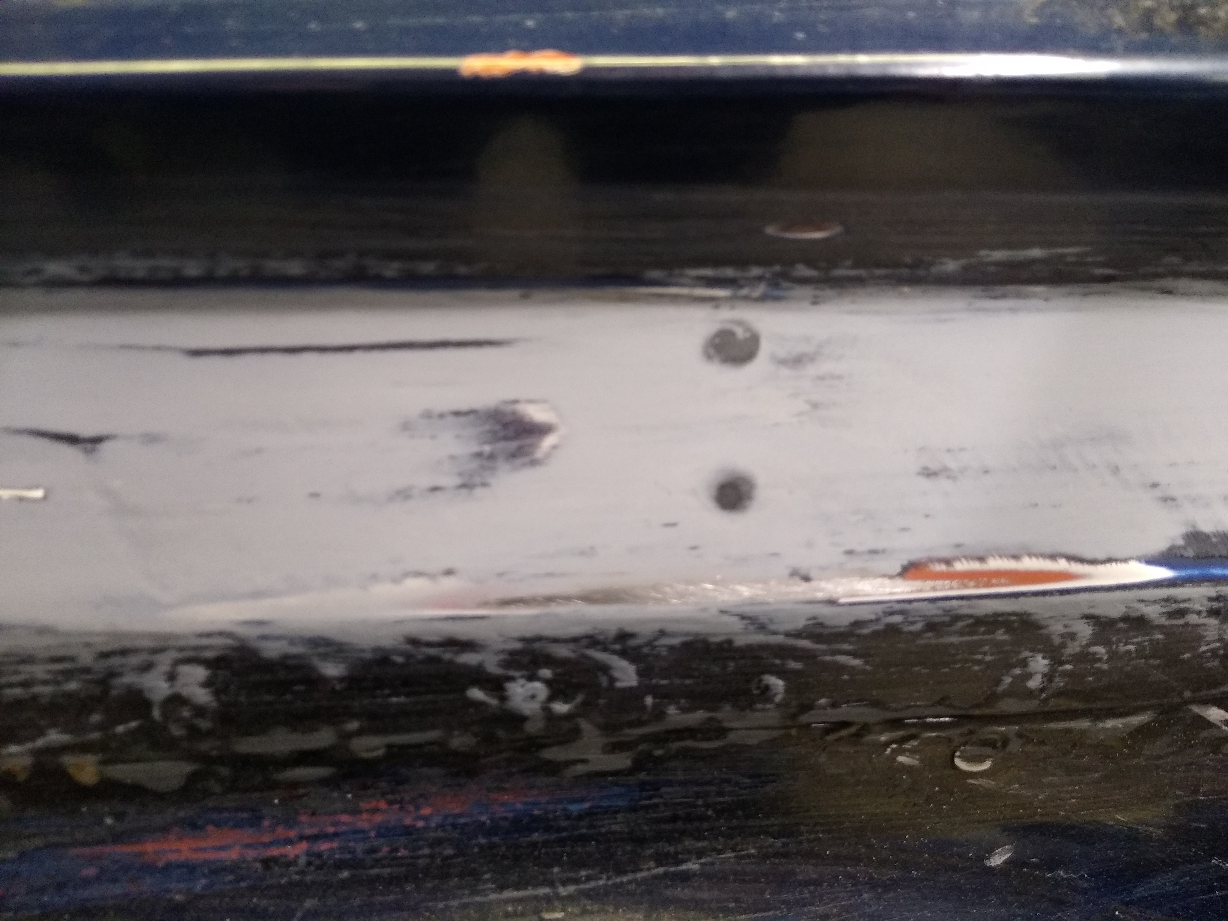

                  #68
                  Holes filled with epm121
                  ​worked a treat, thanks John. Click image for larger version

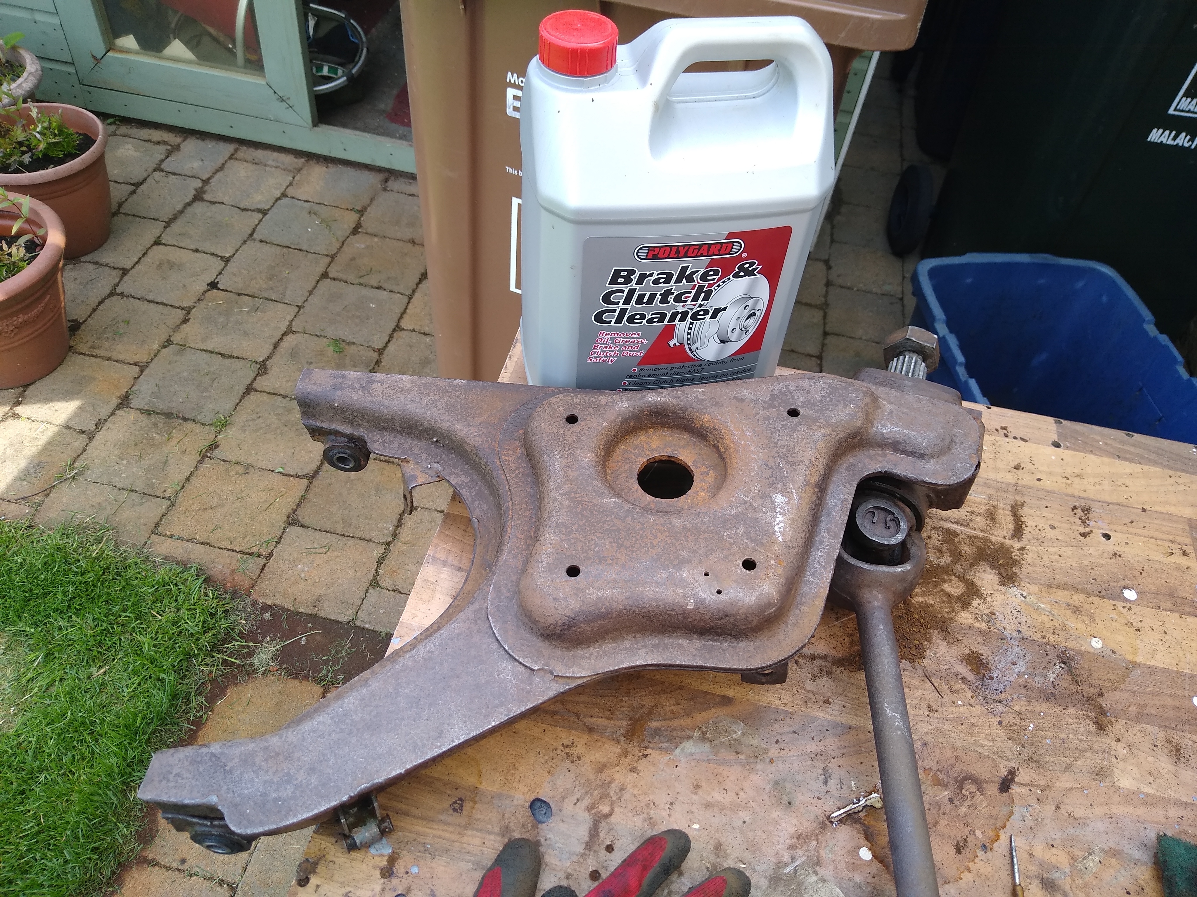

                      Made a start at getting years of thick grease off the underside. Very messy, I'm not enjoying this part. Click image for larger version

                          #72
                          Finally got through layers of grease to uncover rust. Phew. Click image for larger version
