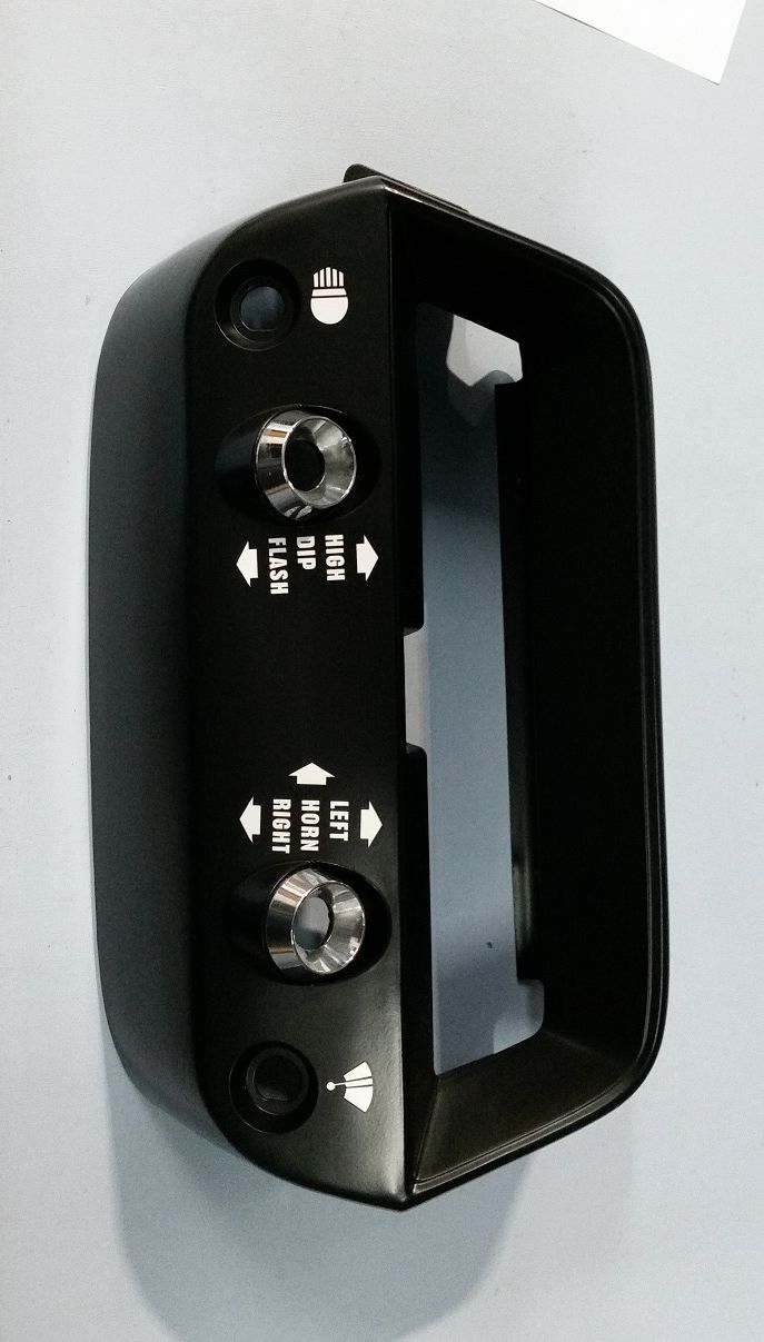

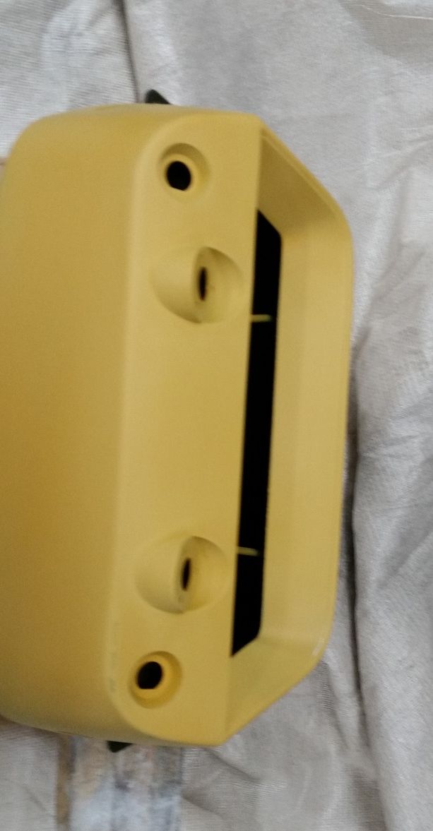

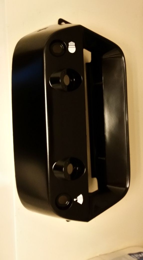

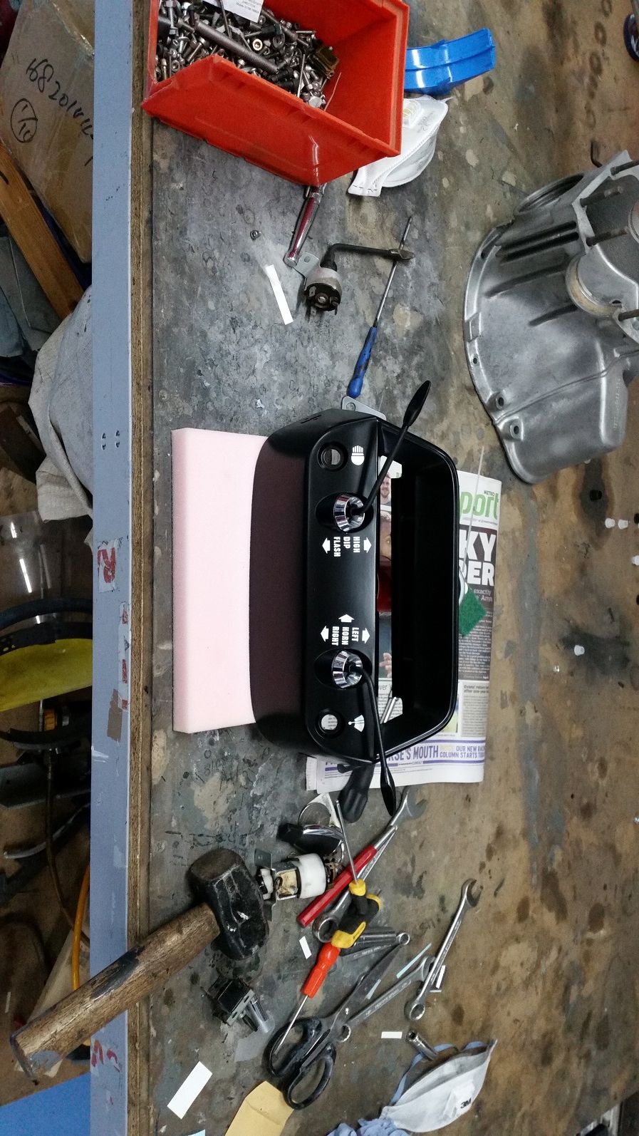

    And let us not forget the up front stuff !
    Binnacle stripped, refurbished (including guages) and a new set of high vis ecals again from Robin Human (check Facebook - The Hillman imp Group)
ID:	2961 Click image for larger version
ID:	2960 Click image for larger version
ID:	2964 Click image for larger version

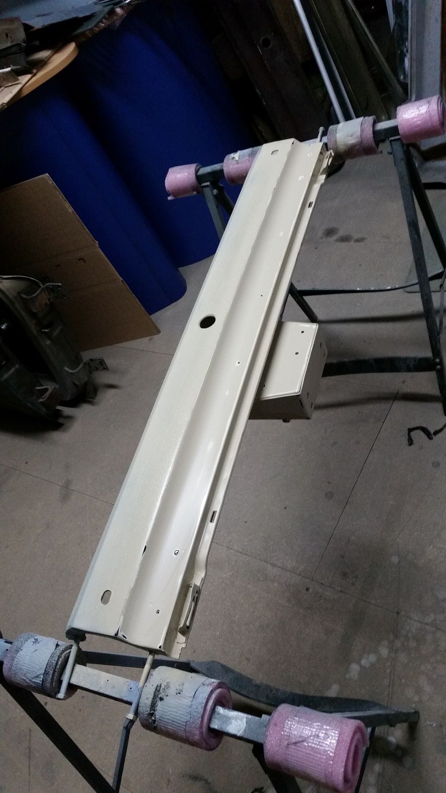

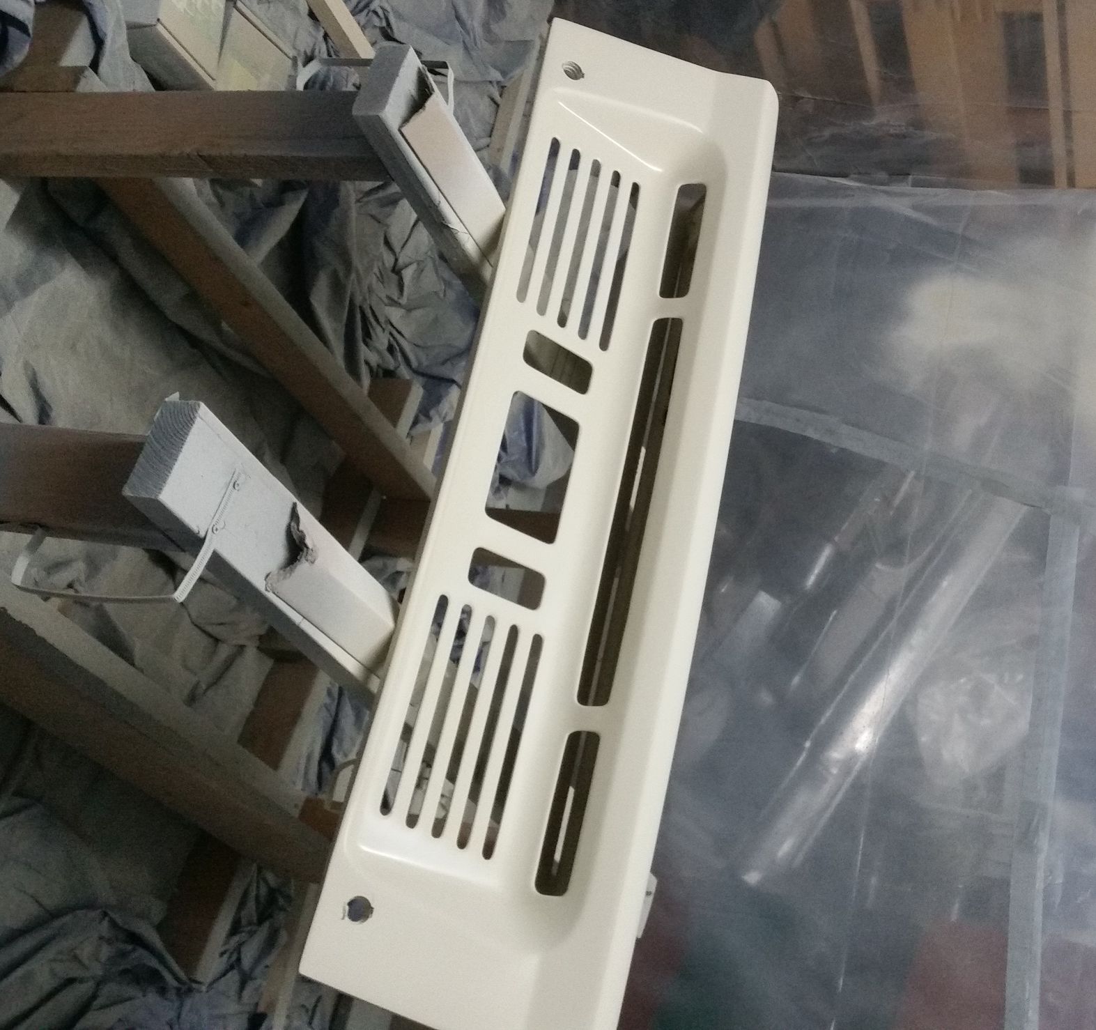

    And of course a few more bits like end of dash closing panel as it is a chamois

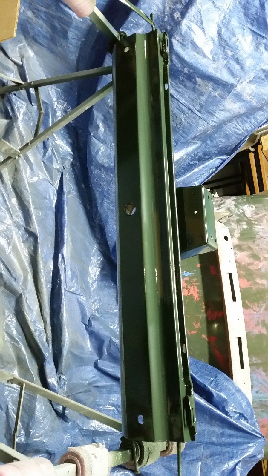

      #17

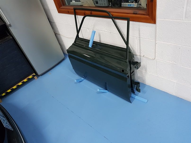

      Doors all ready and epoxy coated
      Click image for larger version  Name:	55 PIC-08141.jpg Views:	0 Size:	1.27 MB ID:	2967

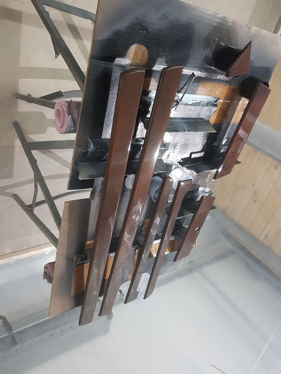

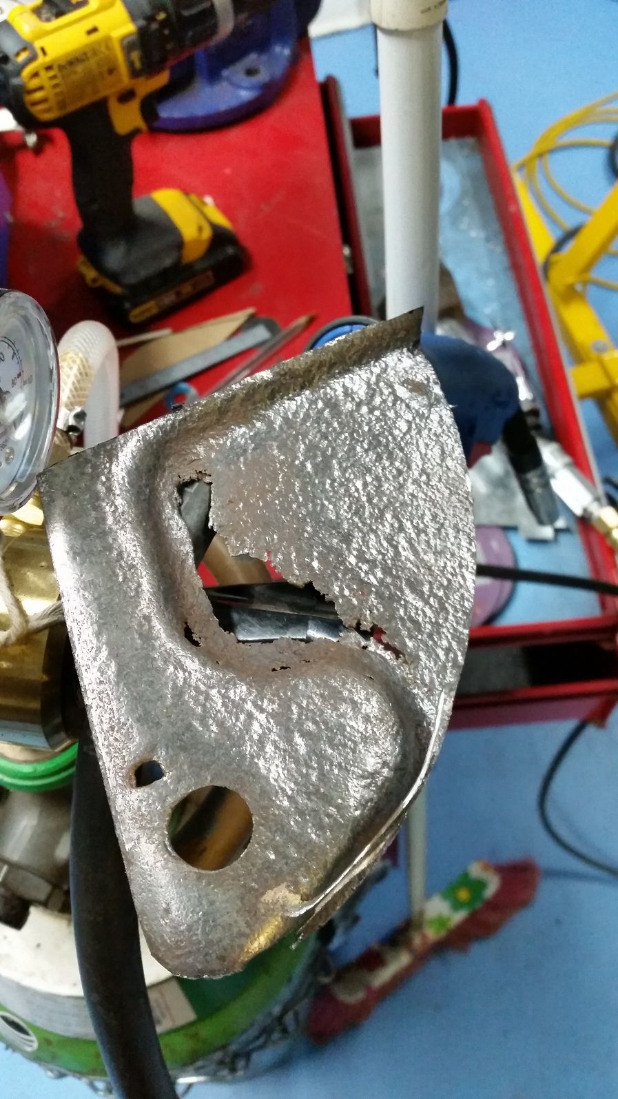

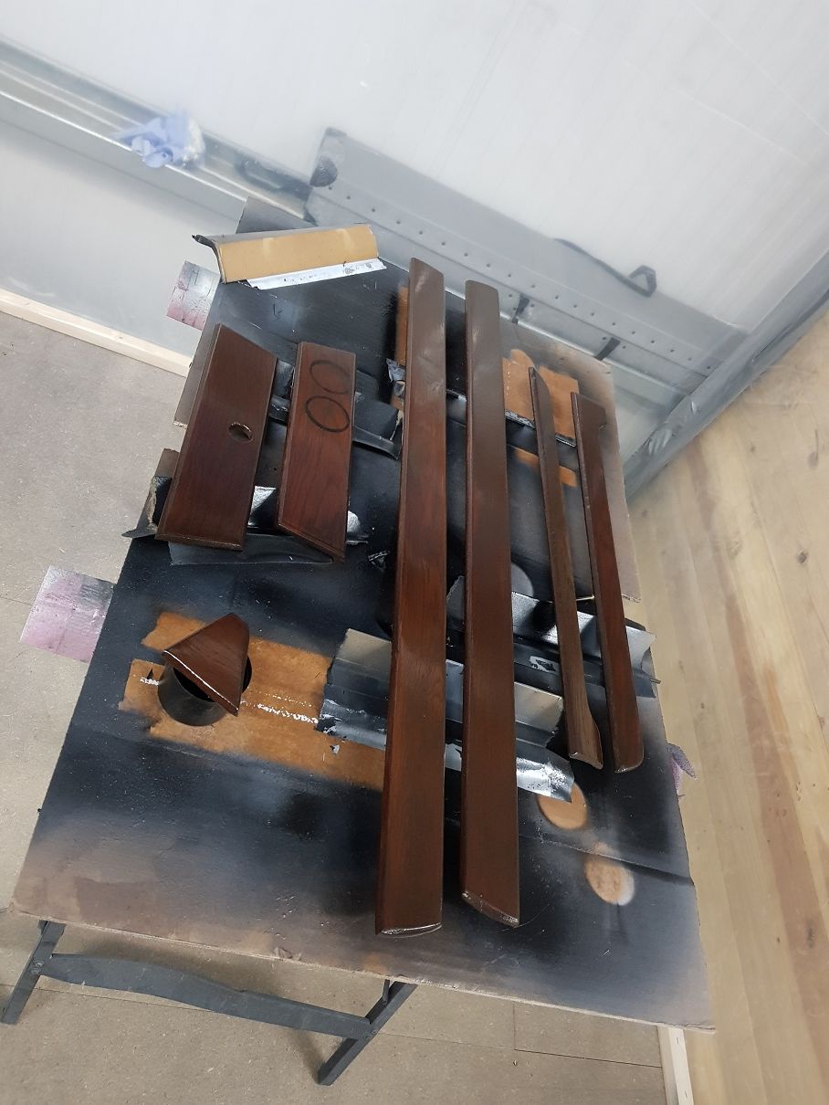

        And of course a really important piece of the puzzle in a Singer Chamois
        The walnut trim !
        This was a task and a half but highly rewarding ! I am honestly happy I tried it (advice well received Uncle Henry
        Must be 8 coats of 2K Acrylic lacquer on there, amazing how quicly it soaks it up and how pitted woord grain actually is compared to metal, if it was metal it would have been a skim of Dolphin Glaze of Easy gold wipe and paint !!!
        Even baked at 30 deg for 4 hours per coat afetr it flashd off the clear coat took ages to build up till it was truly flat.
        Click image for larger version  Name:	PIC-07620.jpg Views:	5 Size:	126.2 KB ID:	2969 Click image for larger version  Name:	PIC-07623.jpg Views:	2 Size:	166.0 KB ID:	2970
        Click image for larger version  Name:	PIC-07622.jpg Views:	3 Size:	1.06 MB ID:	2971 Click image for larger version  Name:	PIC-07621.jpg Views:	3 Size:	1.23 MB ID:	2972
        Big difference from the start !

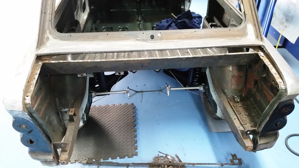

          #19

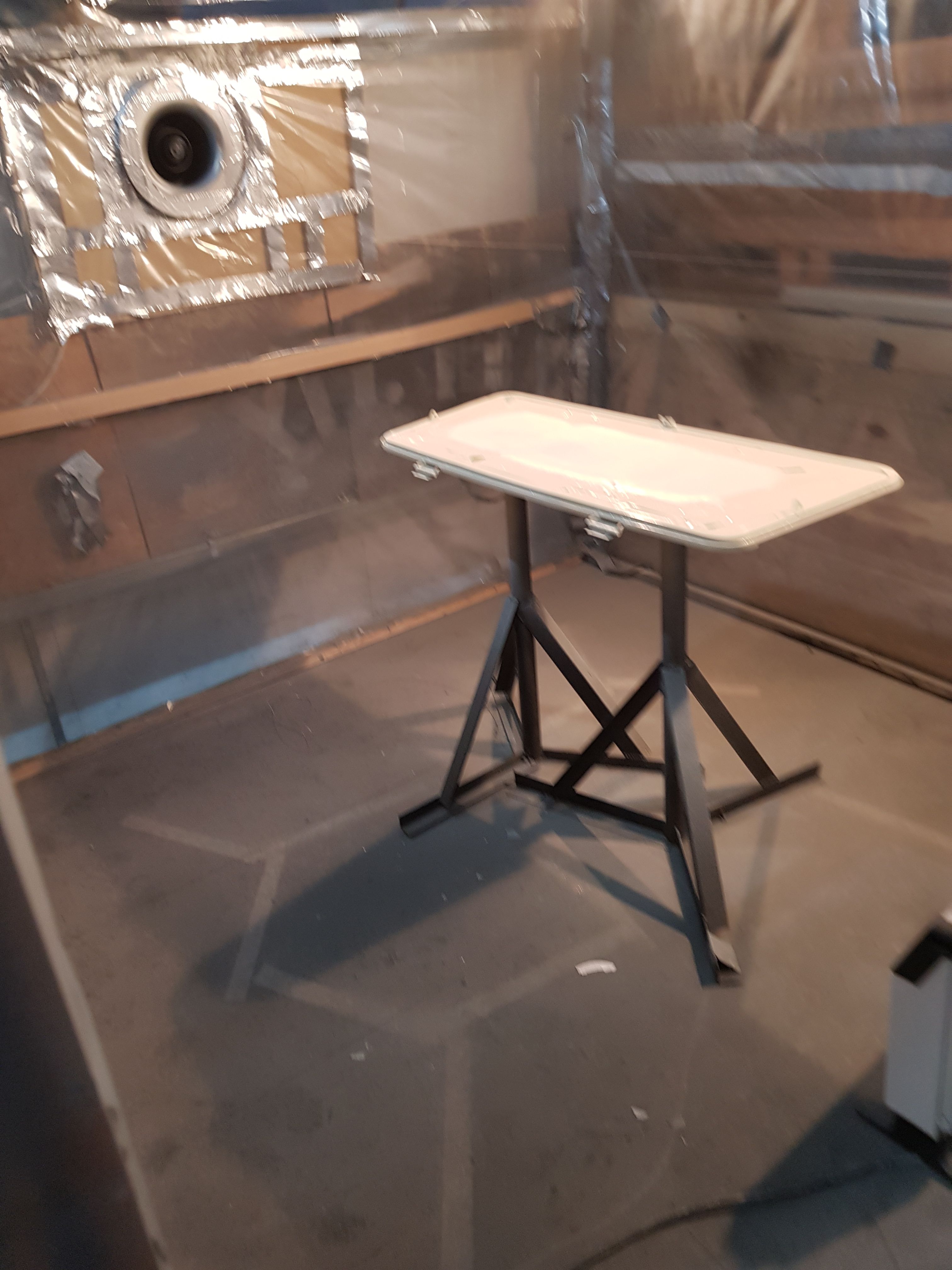

          And back to the back end with a quick transom repair and a fresh coating on the engine cover and the door pockets
          And not forgetting the rear hatch !!!
ID:	2979 Click image for larger version

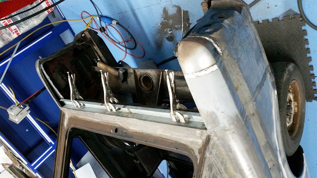

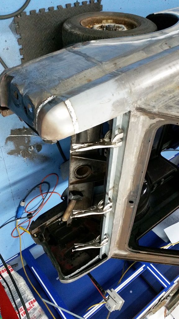

            OK, back to a little fabrication, drivers side window / door frame down to A pillar needed some love.

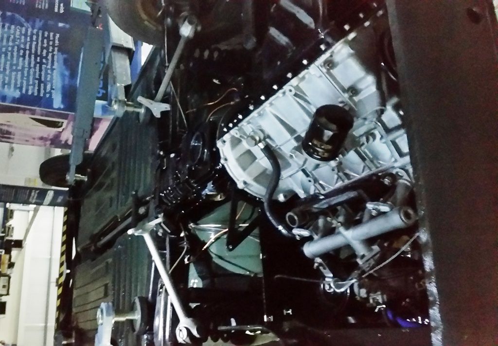

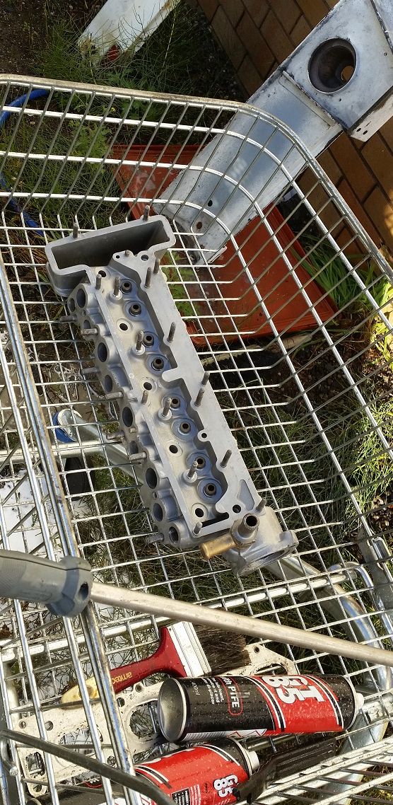

              And of course, time still to get the newly rebuilt L4 engine ready and tested
ID:	2986 Click image for larger version
ID:	2988 Click image for larger version
ID:	2990 Click image for larger version

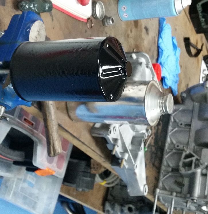

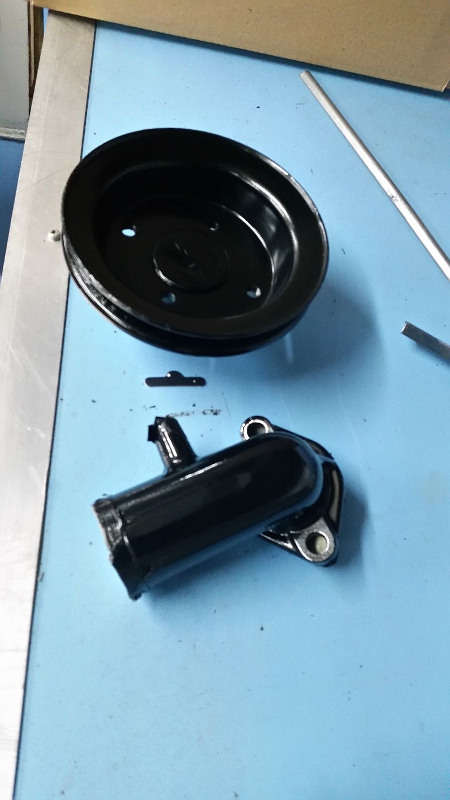

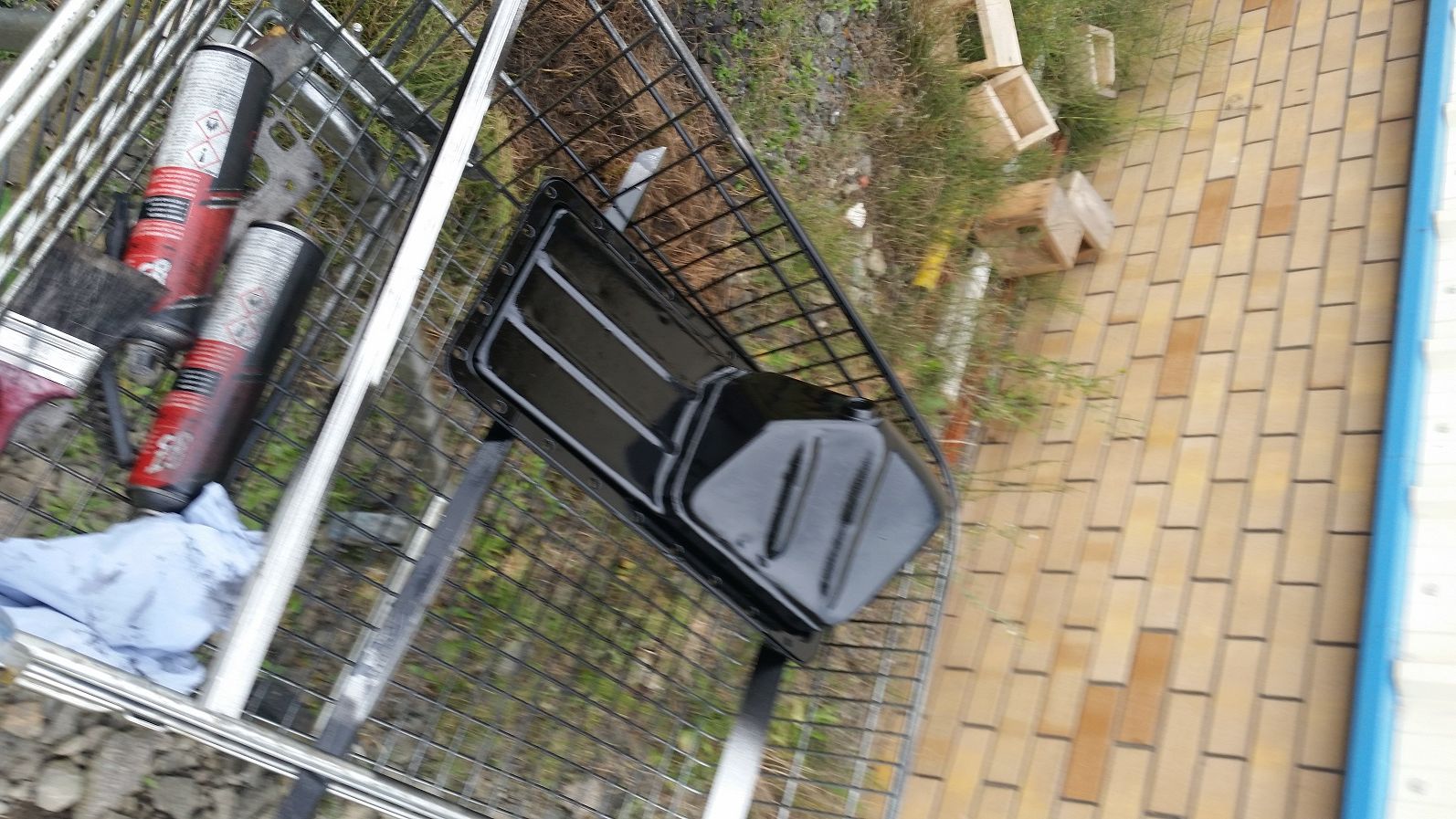

                And when it comes to building an engine clean clean clean and it is of course never ending !
ID:	2993 Click image for larger version
                Different gasket sets, go for NEW ones as the NOS ones, especially on the sump can suffer from shrinkage, complete bummer....

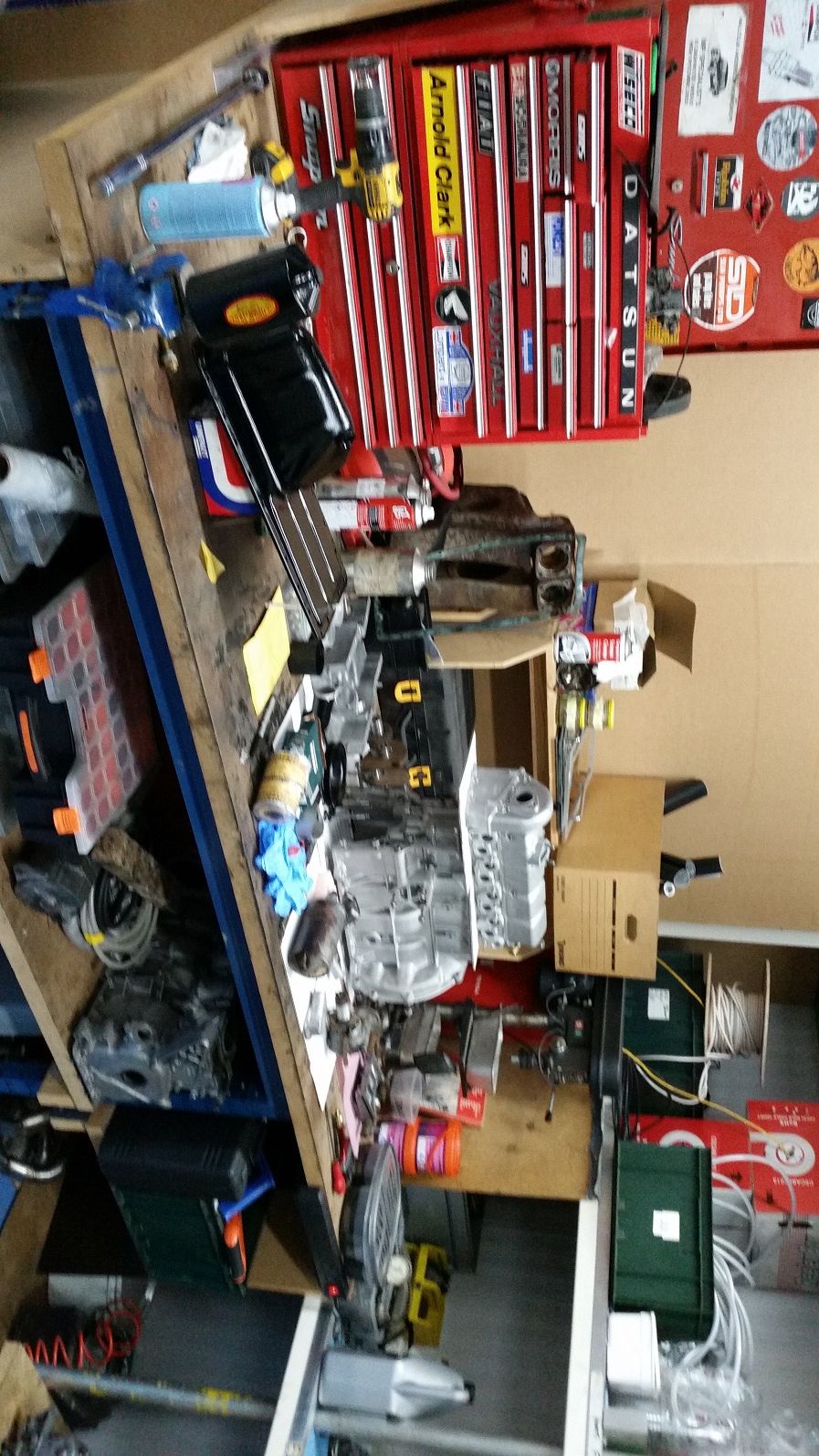

                  #23
                  Suprisingly there is quite a few parts ibvolved for such a simple engine, they are however quite robust when assembled and maintained properly (good oil especially)
ID:	2999 Click image for larger version
ID:	3001 Click image for larger version
ID:	3003 Click image for larger version

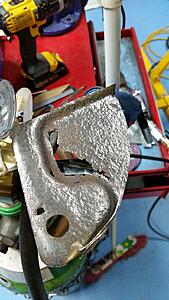

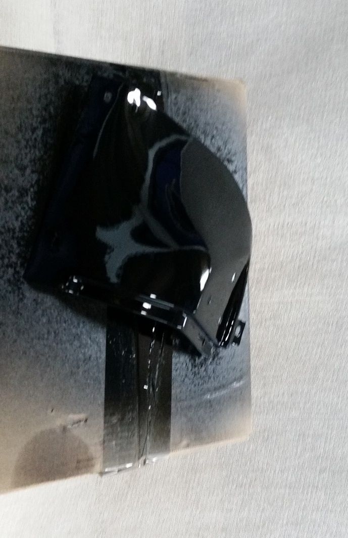

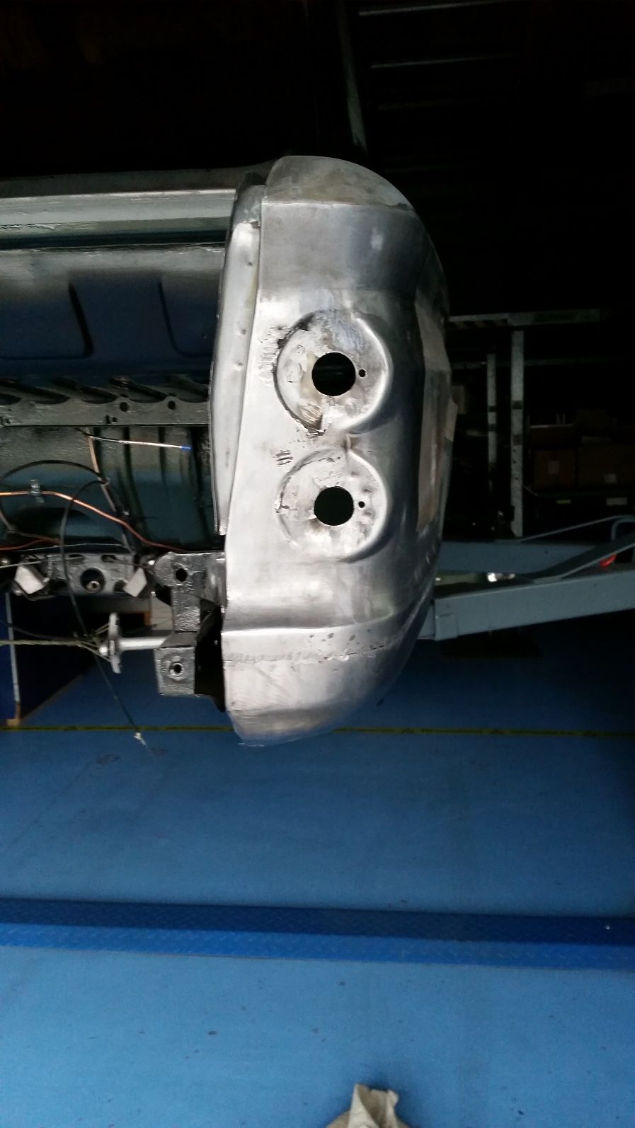

                        OK, some more fabrication, this time the back lights, what a fantastic former for light sections the oil filter key for the Mecedes makes !
Name:	55 PIC-06980.jpg
ID:	3020 Click image for larger version
Name:	62 PIC-08061.jpg
ID:	3021 Click image for larger version
Name:	55 PIC-08062.jpg

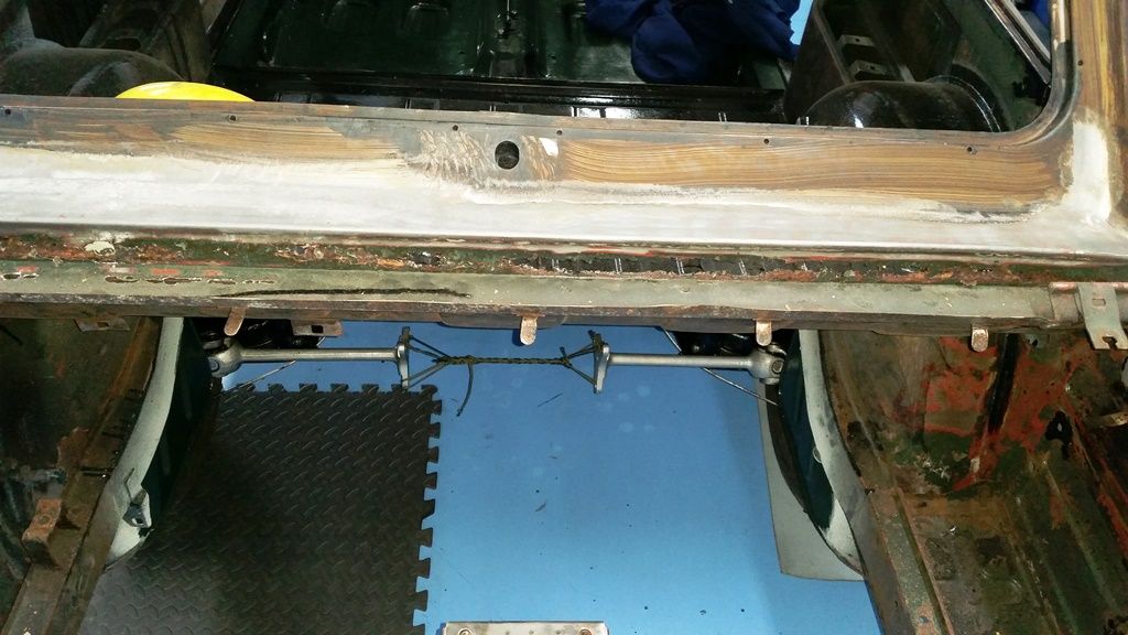

                                So back on the tin bashing,
                                Rear engine cover rain channel, another rot spot, single skin on parcel shelf and TRIPLE skin joint where it meets the rear hatch area.
                                Imps are bad enough with seam rot on 2 faces, threee is just tempting fate !
                                So out it be cut and new channels all round. I know Colimp66 remebers the pain of this one very well and if you look at CA Restorations images col rooney
                                shows how the professionals handle replace the whole rear section !
